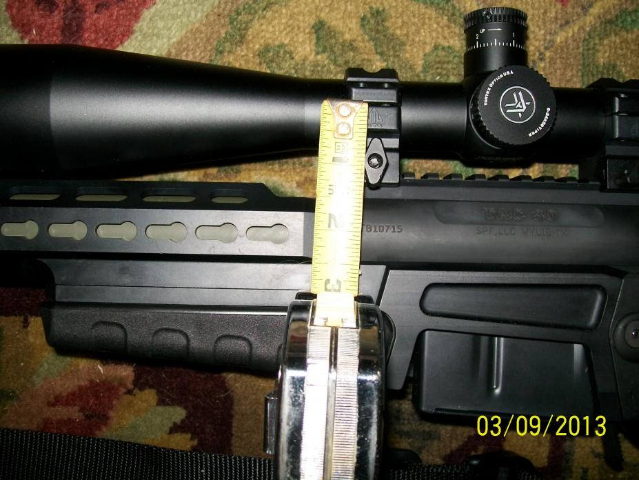

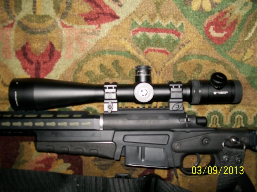

Here's the position of my PST. The eye releif works well for 13.5 LOP and I'm 6'. Because the AX handguard does not taper down or away the spacing is a little tight at the bell end. The sunshade screws on without any problems you just cant get the stock lens cover on there without shaving it. I had a #3 Varmit contour with an A5 with plenty of clearence. This scope is 2" above the centerline with medium rings.

Thanks for the pics. I belive the medium rings will work well for me then.
