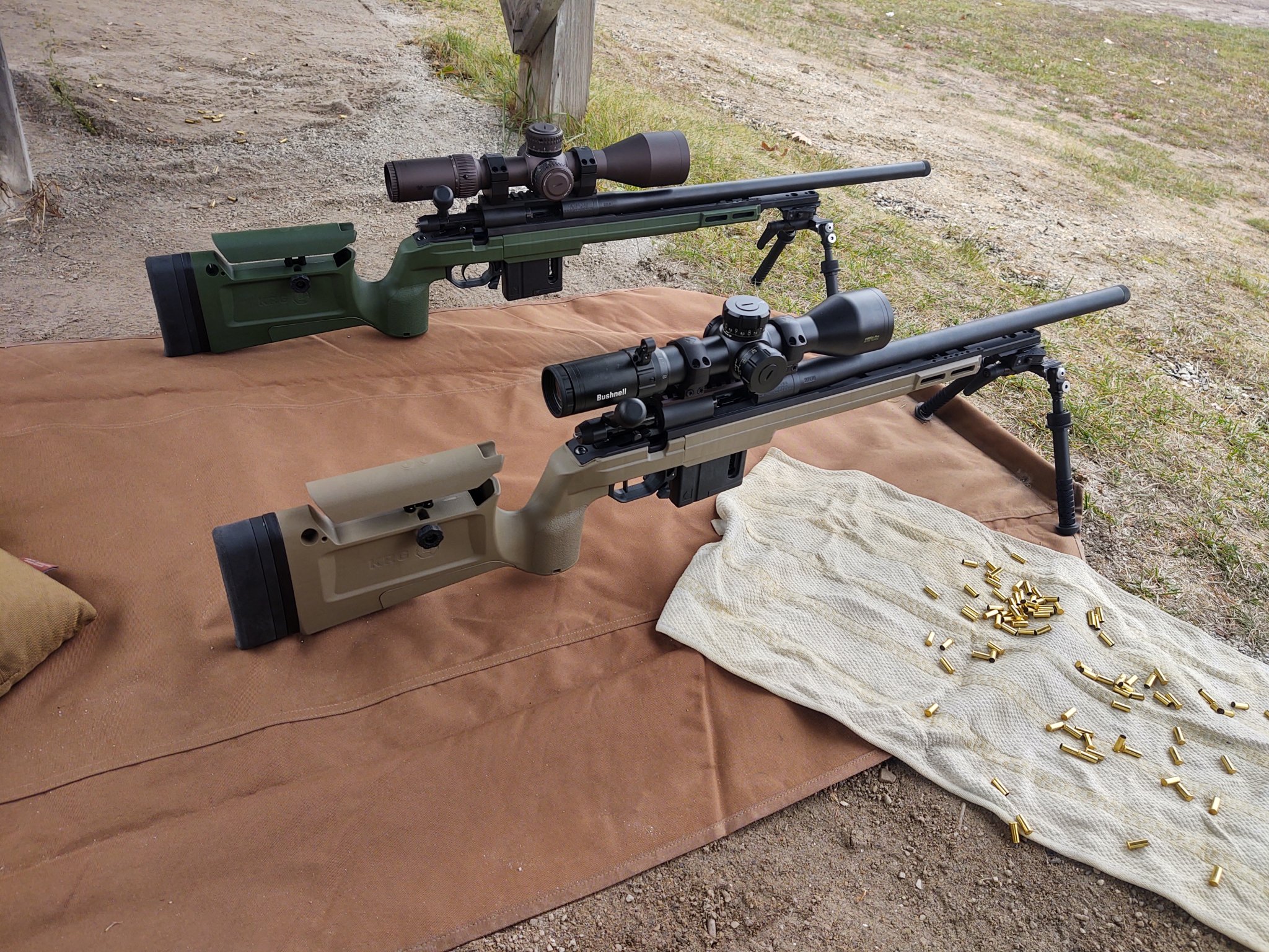

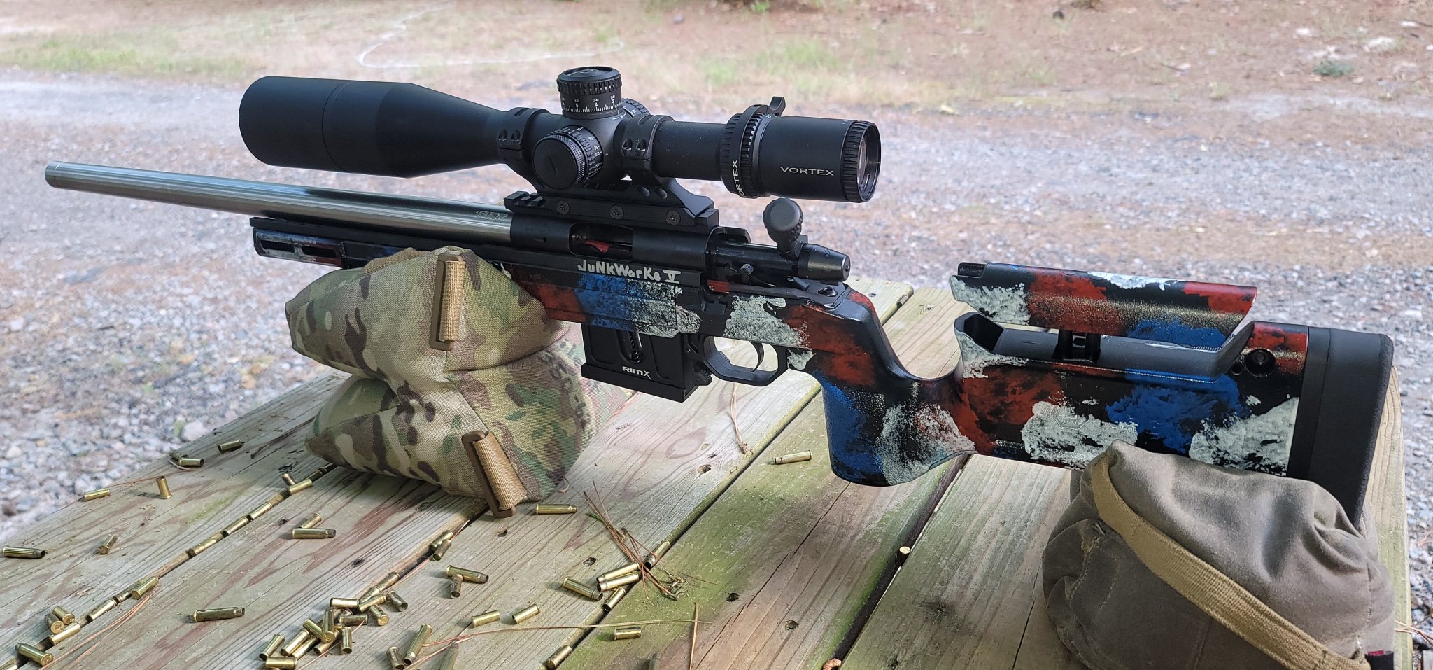

Well I'll share my xp with my rimx. I went the traditional route sending all my parts out to be chambered, and bedded all as one into a t4 with TT diamond.
I've probably shot about a bricks worth of varying ammo thru it to see what the barrel likes. I have not experienced any issues at all with the rifle other than getting time out to shoot it. I realize 500rds or so isn't a very high round count but so far I am very pleased with the way things are running.

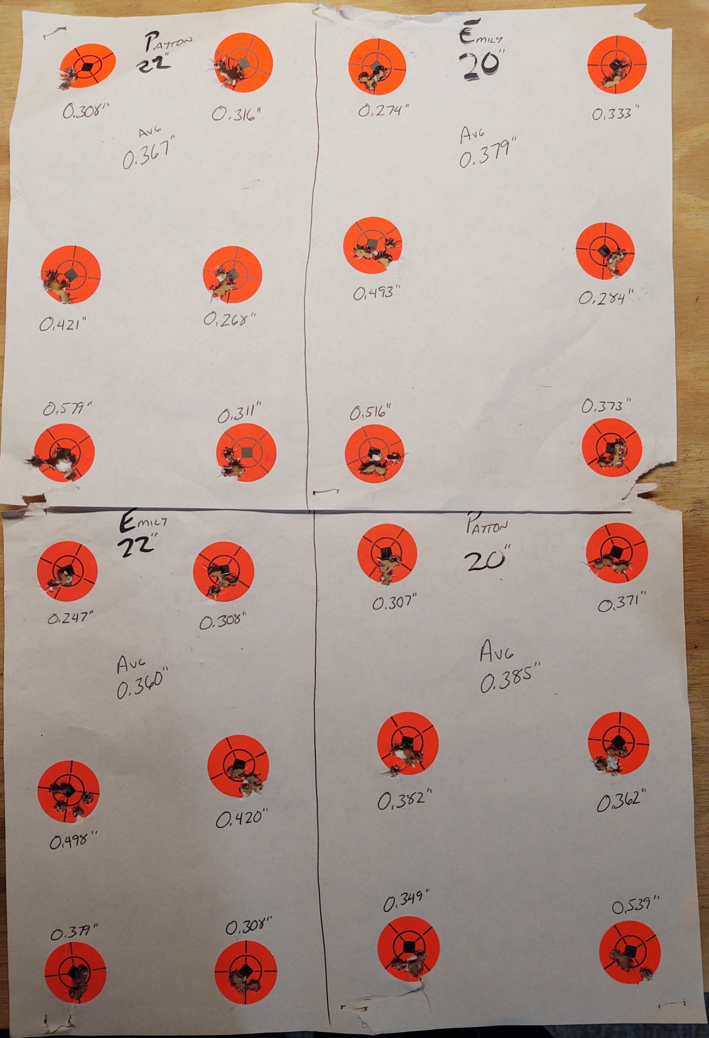

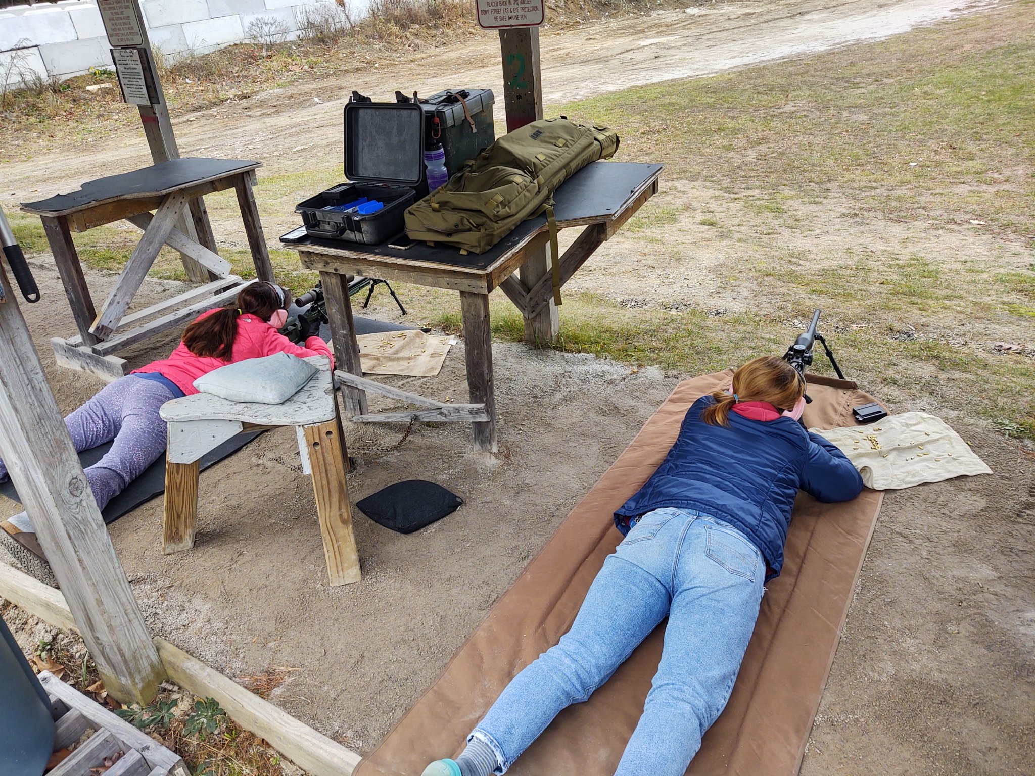

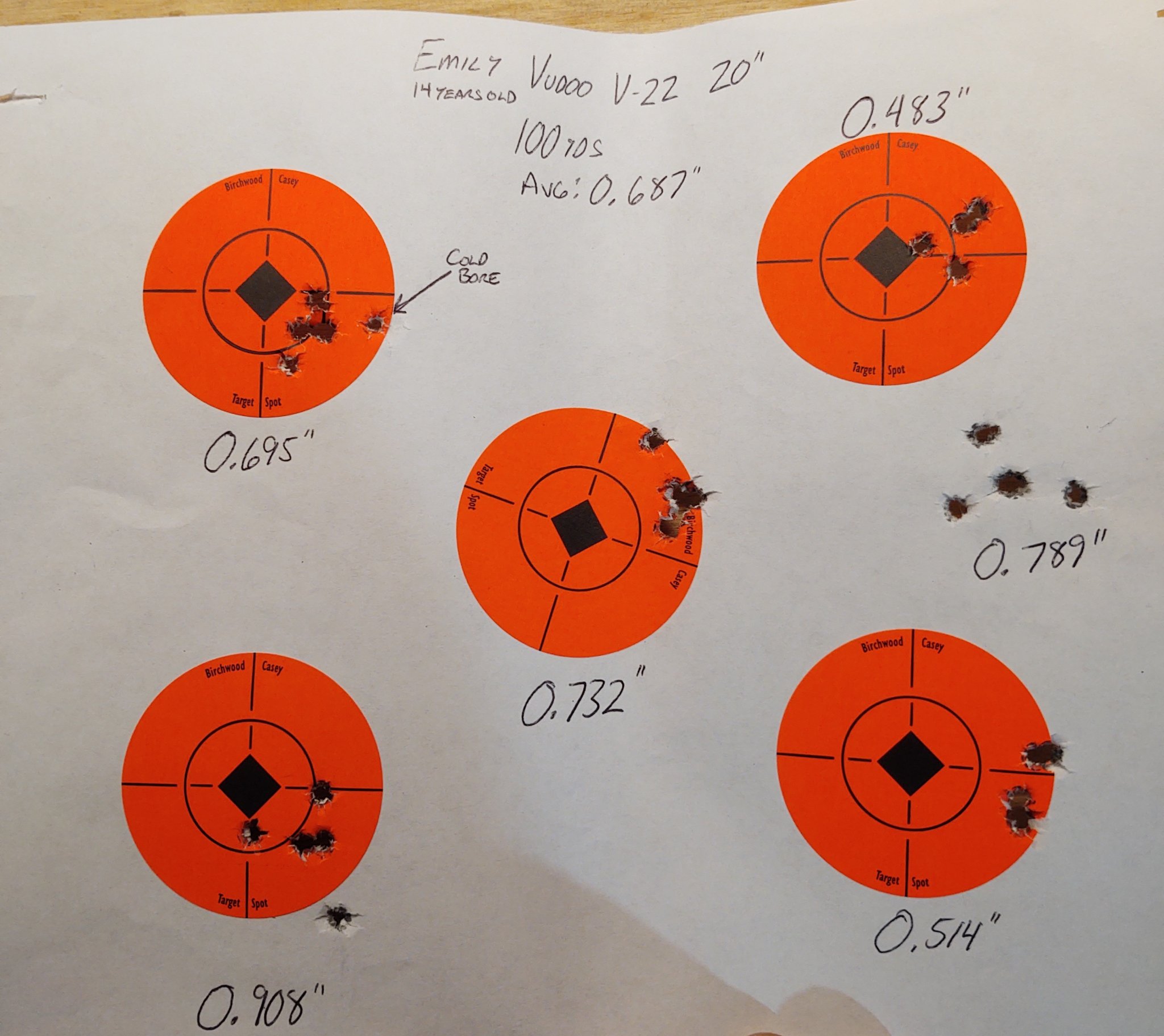

I guess since this thread resurfaced I might as well give a follow up on my own RimX vs V-22 “experiment”. As I said earlier in this thread I decided to order a Rim X to see how it stacked up to the several V-22 (1st gen) rifles that myself and my family have owned (3-4 to that point) of which all have been excellent in every way. I have previously outlined my troubles with the Rim X in the earlier pages of this thread, which with the excellent help of Zermatt Arms Customer Service I was able to resolve. But honestly I still was not “overly impressed“ with the Rim X action vs the many V-22 rifles I have owned So I sold the Rim X and ordered 2 V-22 barreled actions. Both were brand new 2nd generation both with the Kukri profile and I believe both are Ace barrels one is a 20” and one is a 22” just because I wanted to test the differences (I will have a 24”-26” at some point to test as well). They were set up identical with KRG Bravo chassis, Timney 2 stage triggers, KRG spigot with an Atlas Cal bipod, and Vortex Razor GenII scopes (one of which had to be sent back to Vortex for a canted reticle, BTW Vortex CS killed it with a 4 day door to door turnaround and repair, hence the DMR II PRO in the picture).
These rifles are for my daughters as they have expressed an interest in shooting some again, the last time they were serious was like 6-7 years ago so they have had some down time. But to the point they are not exactly experienced shooters. They now have a few hundred rounds through each rifle with zero malfunctions of any kind and both rifles are showing excellent accuracy. Here are a few targets the girls have shot, all are 5 round groups at either 50 yards or 100 yards as noted and shot prone.
50 yards
100 yards

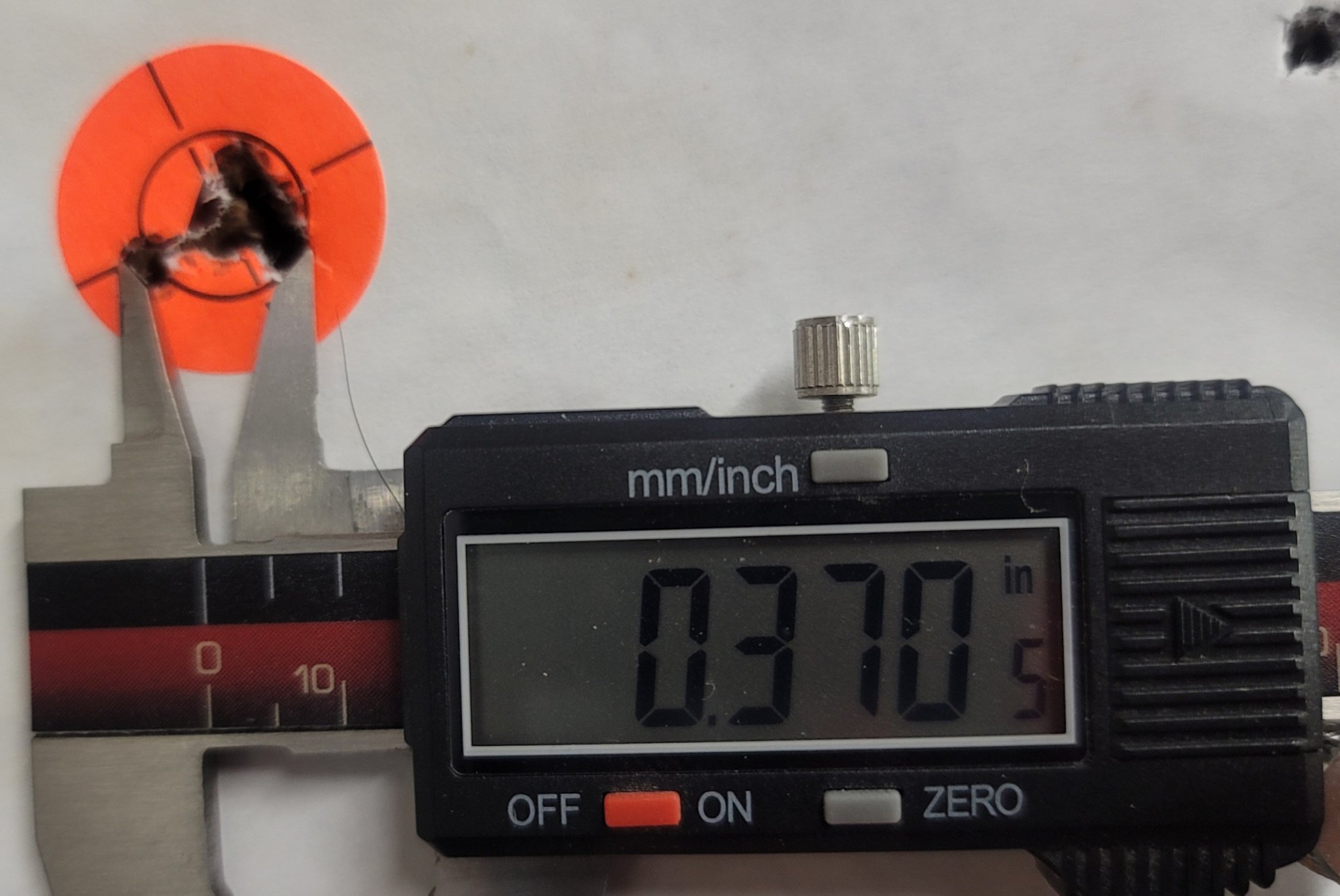

I thought I'd resurrect this to share my experience. I had problems with my Rimx. Though it had nothing to do with the action, Ray had me ship the barreled action to him for examination and recommendations. Following his advice and his shop coordinating with my local gunsmith (who had never even heard of Rimx), I ended up with a perfectly functioning system. Ray is great to work with and will ensure you get your issues sorted out.

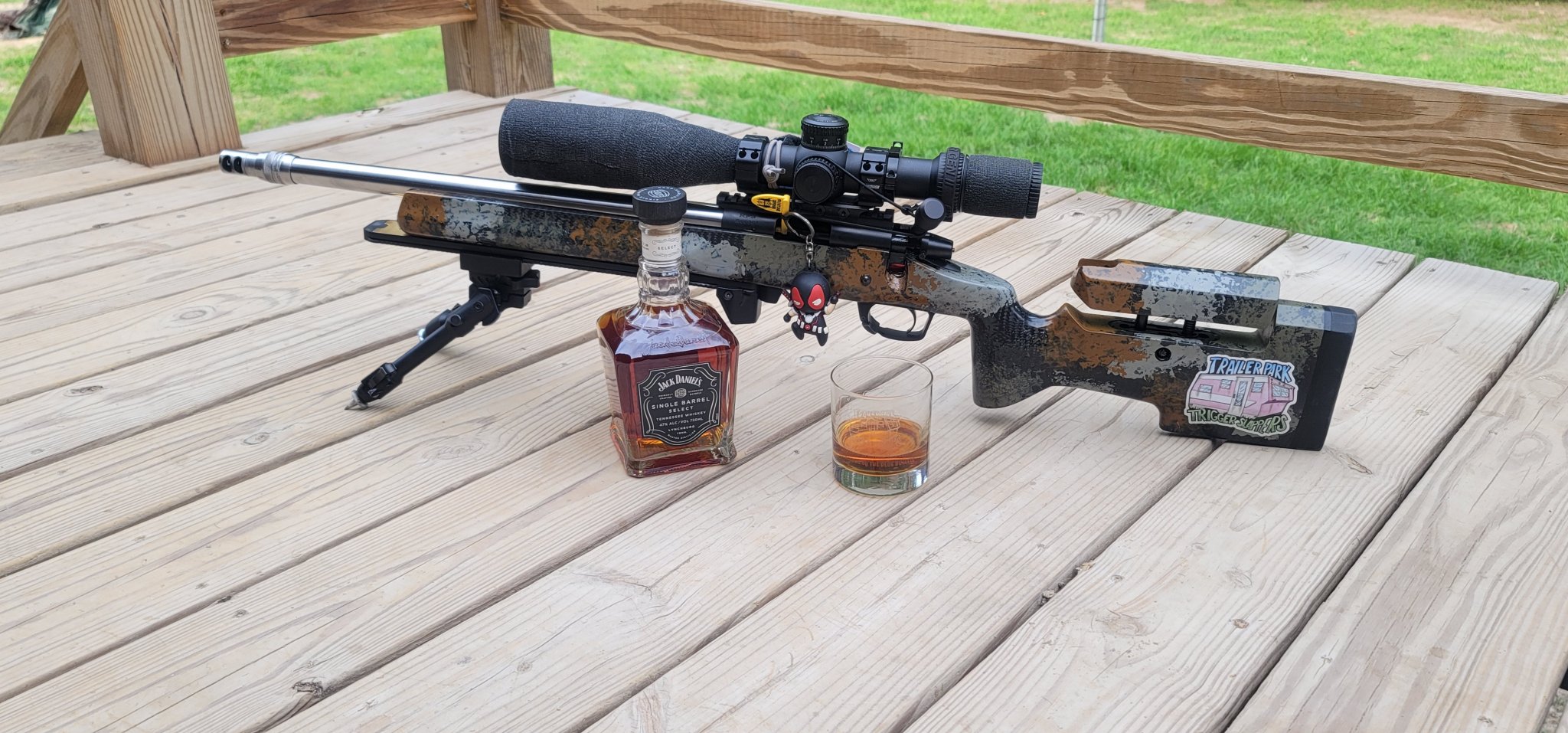

I have 2 Rim-X's that I slapped together myself with prefit barrels. They seem to work fairly well. I like the adjustable mags and the ability to change calibers with different bolt heads.
#1 is a 22lr with a Straight Jacket Armory 18" 1:14 twist

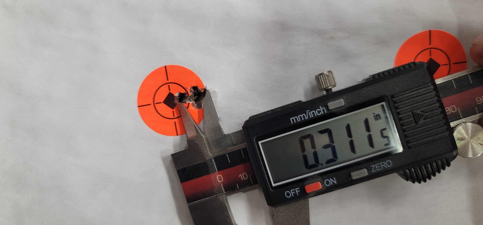

100 yard 5shot group (calipers zeroed at0.22)
#2 is a 17hmr with a Primal Rights 20"
100 yard 5 shot group (calipers zeroed at 0.17)
