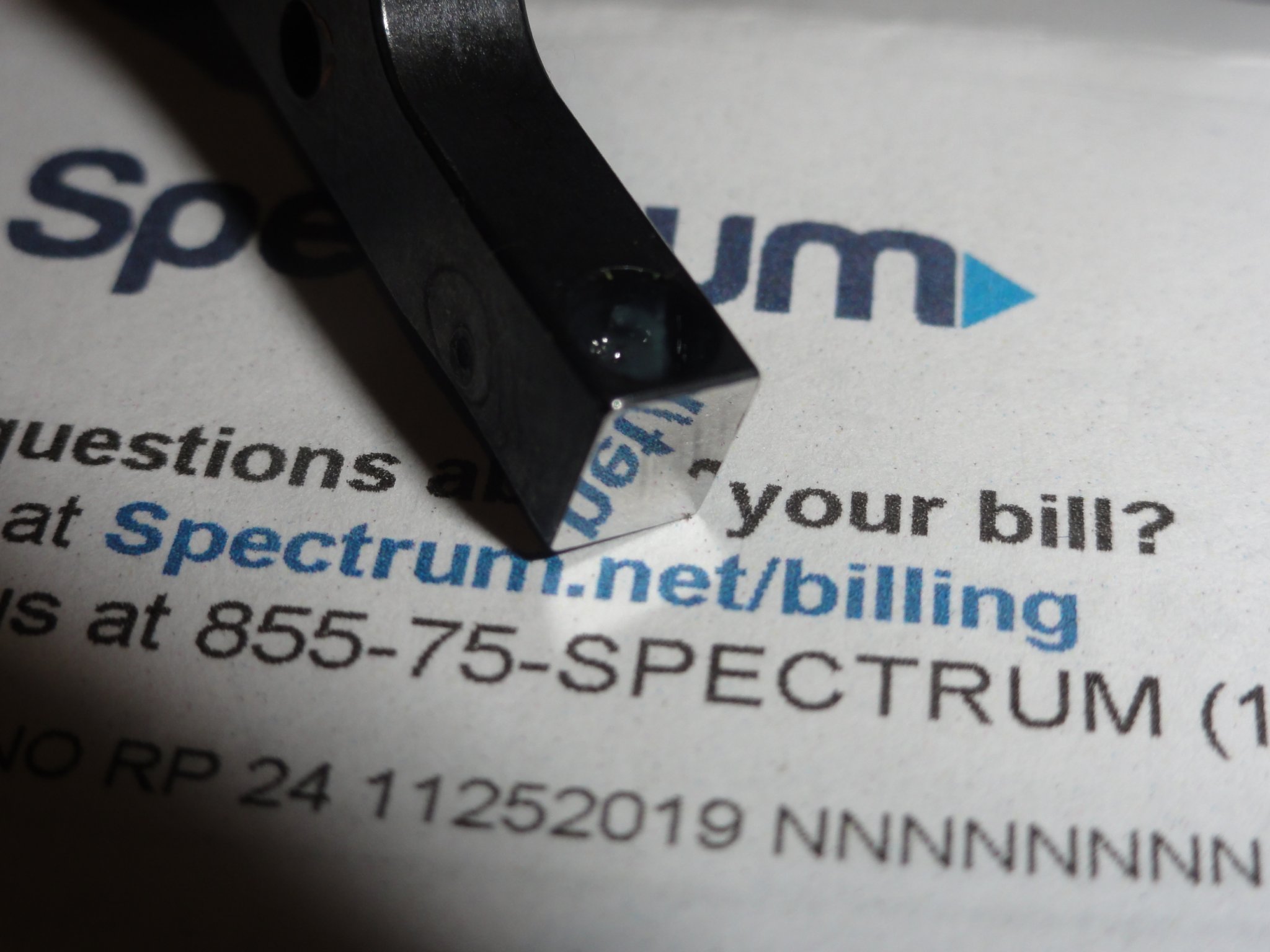

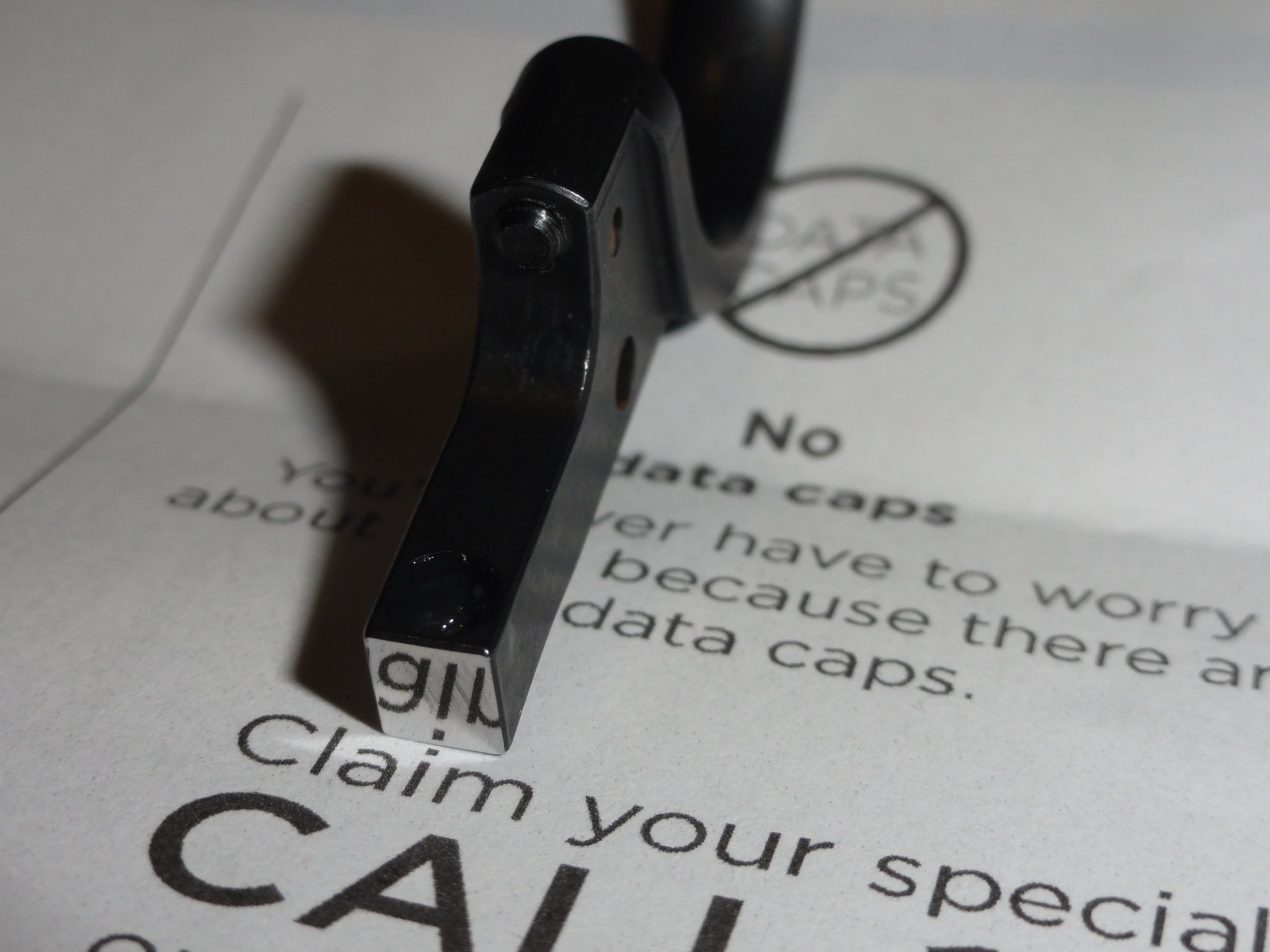

The CZs are a great value. I have the 457 MTR, At-One and the Royal. The triggers are sweet and really simple to get
them down to 10 oz. with a fifty cent spring and a quick trigger lap job that anybody can do. I used 9 and then 3 micron
aluminum oxide lapping film to get this finish. KOD has his trigger down to 6 oz.
Shawn

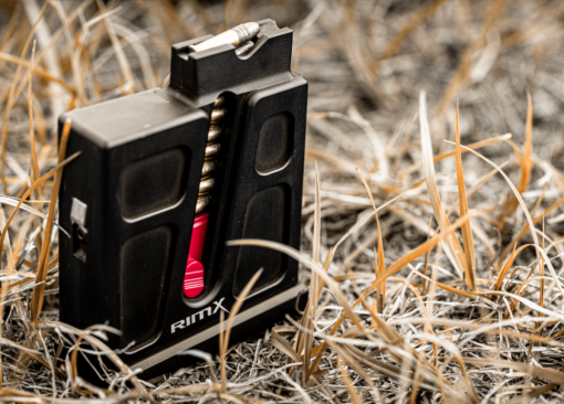

I prefer to have real steel and wood in my guns but that said. My feeling is that Zeramatt could have made the same magazine from some plastic and used ultrasonic welding to assemble it like Vudoo did and produce a magazine that is less expensive without sacrificing any of it's functionality. It is a fact that the cost of aluminum and it's cnc machining and then some sort of de-burring step like tumbling takes more time and cost than using poly. Then they also have the secondary step of anodizing. Hell, I nearly forgot, those mags may even be welded halves. No matter the process that they use, it wont be as fast as the 10 seconds or less that it takes to ultrasonically weld poly mags.
Look, it's a really nice looking magazine and it likely funtions really well but, every second that that magazine has to spend in the manufacturing process costs more money. If you mold them, you put cost into the mold one time.
I can buy steel CZ mags but I buy poly. If I could buy poly for my Annie's I would and I'm a steel snob when it comes to guns.
Just my thoughts.

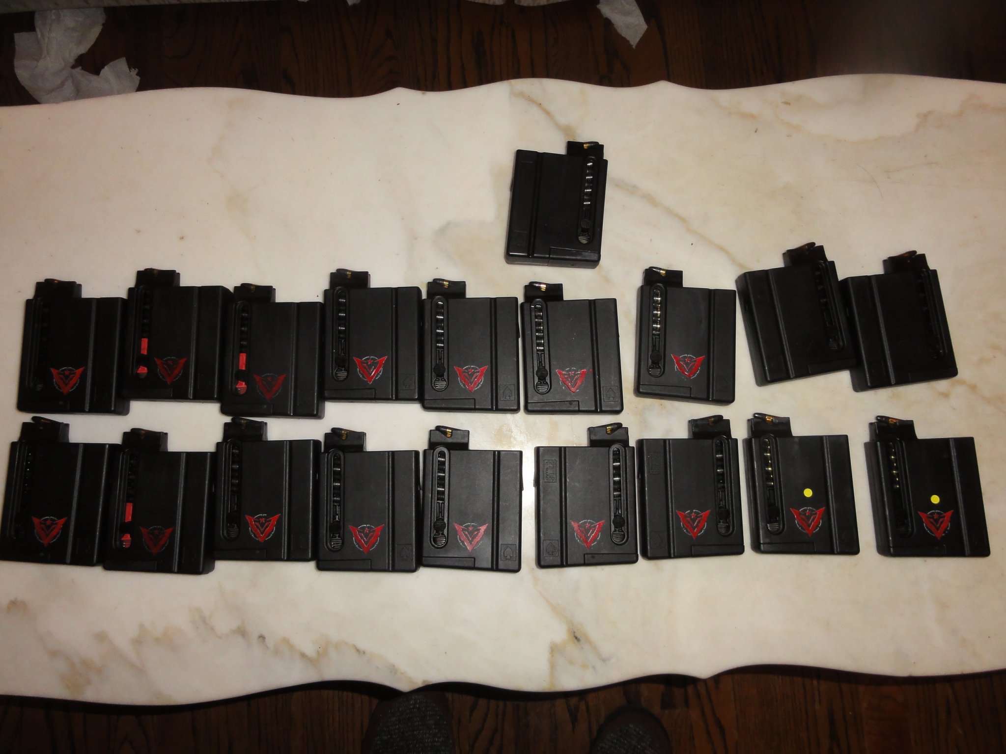

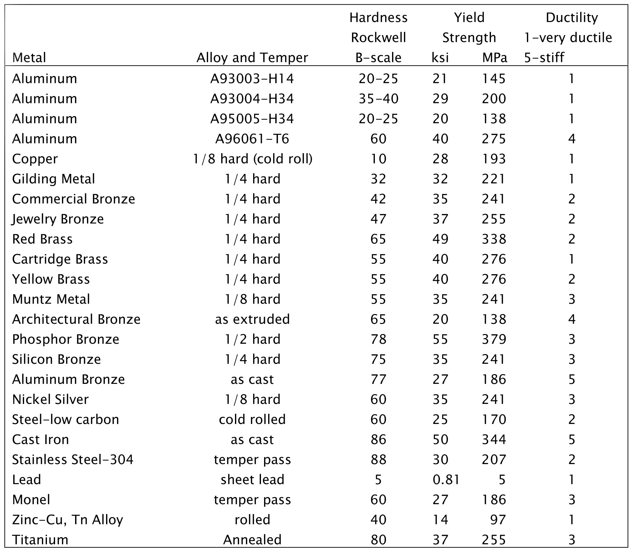

If you know how to interoperate it, please take the time to look at the chart below or pull out any chart on the Rockwell hardness of cartridge brass and aluminum and decide for yourself. Cartridge brass is 1/4 hard with a Rockwell hardness of 55 on the B-scale.
Out of the four aluminums shown, three of them are softer than the 1/4 hard brass by nearly half.
Which one sounds softer and more likely to wear out to you? What do you base your statement on?
Is it because you despise plastics or do you have some facts?
