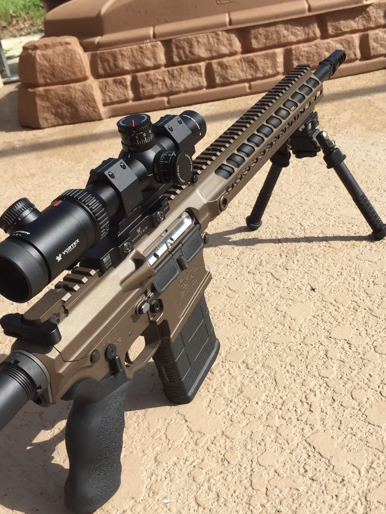

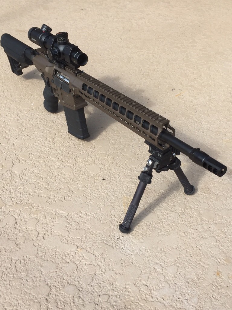

Mega makes awesome stuff here are some pics of my build. I recommend a non prs stock due to the weight. The STR stock feels perfect on mine. ImageUploadedByTapatalk1412039455.682977.jpgImageUploadedByTapatalk1412039473.422335.jpgImageUploadedByTapatalk1412039490.615312.jpg

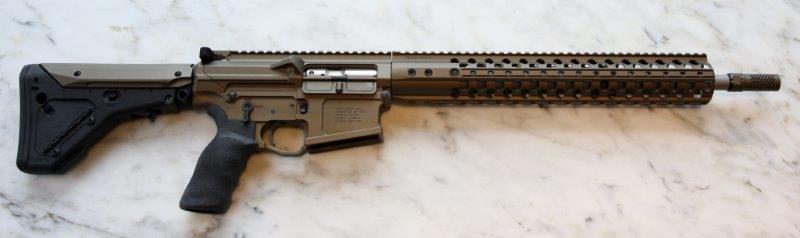

I built a 308 on a Mega Maten last year, whose purpose was heavy metal (iron or non-magnified) 3 gun. And then my schedule changed and I haven't used it.
16" JP Barrel with BattleComp, Wilson Combat TRIM rail, Magpul UBR stock and Wilson Combat Tactical Two Stage trigger. I also put a Slashes heavy buffer weight in. Cerakote with Burnt Bronze...
It shoots really nicely, but I haven't mounted a scope and tested its accuracy.
Got the upper and lower in today, wow it is a very nice set. Fit and finish great and they fit together with no play! Just finished cerakoting the upper, lower and hand guard in FDE. Now gotta wait a few weeks for the barrel to come in. I have the POF 4 pound trigger really want something around three pounds single stage but can't seem to find one.
