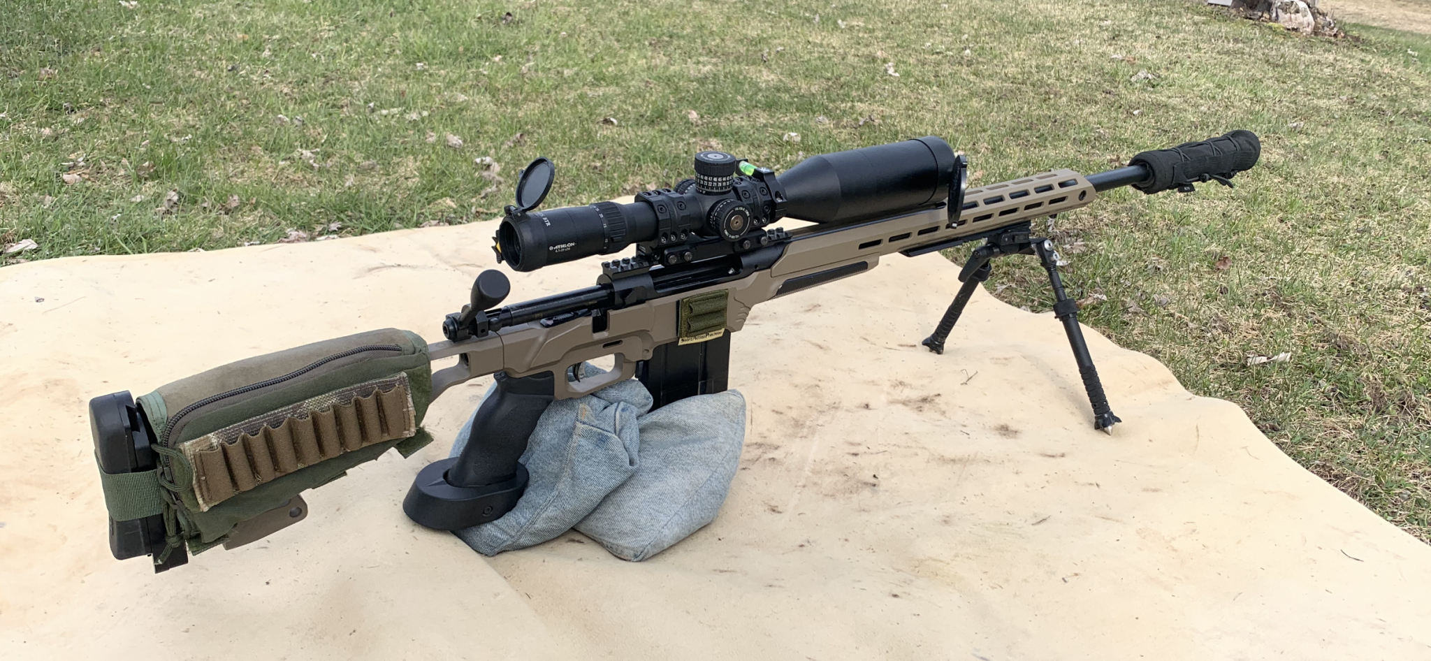

    This is my Savage 110 300 WM in MDT ESS. To date still one of my favorite chassis.

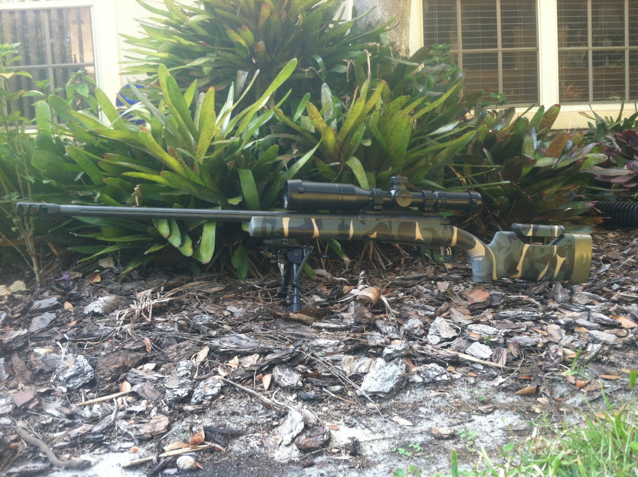

    For those that are interested, here’s what I did with mine: I kept the HP Precision stock, but modified it myself. First, I did a careful bedding job, which turned it from a 2+ moa to a ragged one-hole rifle. Then I purchased adjustable KMW cheekpiece hardware, cut out a cheekpiece and epoxied it in. While I had the buttstock open, I added 2-3lbs of lead in epoxy to the butt to balance the rifle. I replaced the sling studs up front with a nice Atlas rail to mount the bipod and did a cheap flip flop 1” length of pull mod for fit. To finish it off, I did a paint job.
    Mine shoots great and I’ve been fortunate to have the opportunity to shoot past 1 mile here in Florida. I also use a S&B PMII in 5-25 on mine.
