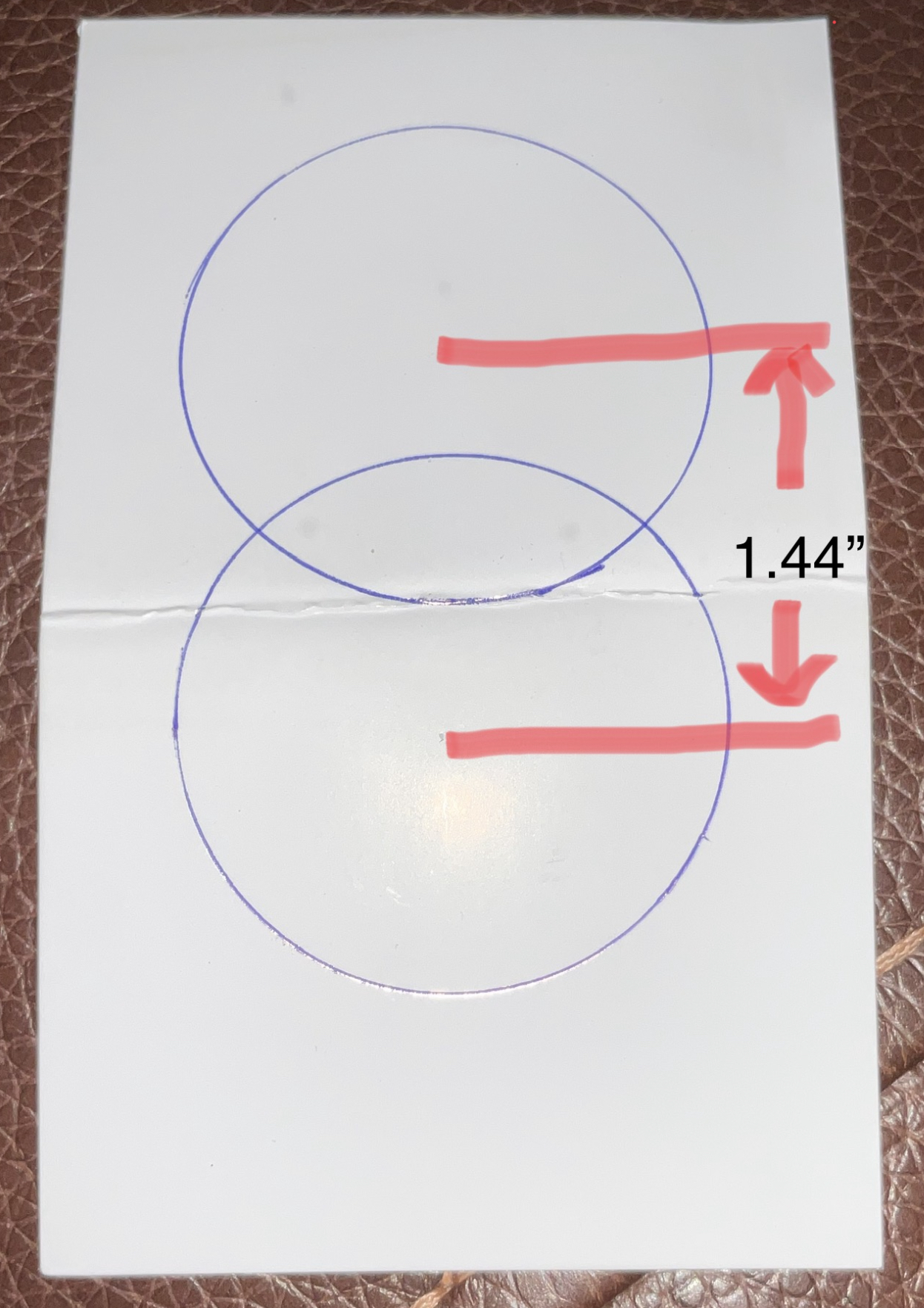

Adding to Rudys point #1…
I would do exactly what Rudy said and keep track over a few more range trips.
To visualize, that is a 2” group centered 1.44” higher than another 2” group at 200y.
In this case all shots would impact a 3”x5” card at 200. Not sure what size target you were shooting at.
