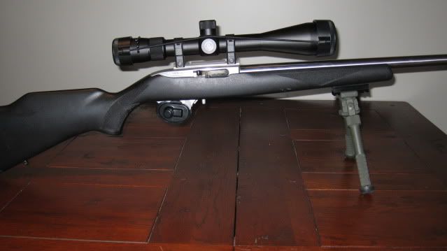

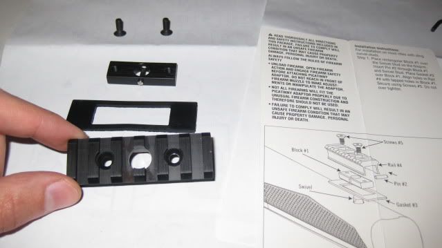

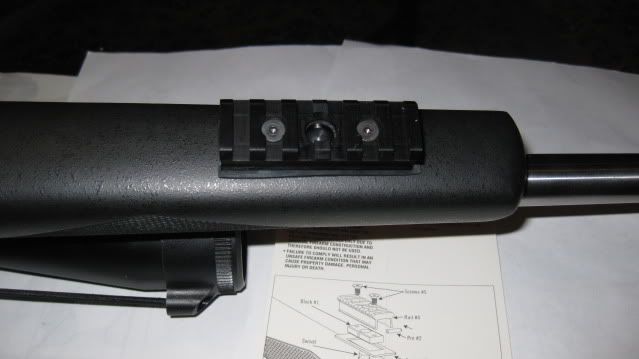

Not sure if anyone's had experience with these Weaver stud to picatinny rail adaptors before, I searched and saw people reference them but could find any reports how they worked or if they were liked. I picked one up so I could use an Atlas bipod on the .22 as well without having to take the rifle apart and disturb the bedding / zero. Above the pic rail in the first picture is a rubber footer, it both protects the rifle from the metal of the rail as well as gives a good surface that resists sliding or moving around once tightened down.

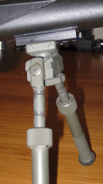

I was skeptical at first but for $15 figured I’d give it a try. It's very sturdy once installed and was very easy to attach. I tired to move the mount / bipod once attached and it's on there firmly. The adaptor would remove in seconds if I wanted to go back to the stud mount.
So far it seems like a good alternative to replacing the existing stud.

Nice concept for target rifles. For carry/sporting/competition rifles I see a few issues. 1. You no longer have a front sling swivel. I guess you could add one to the pic rail aftermarket though. 2. It sticks out pretty far compared to other direct mounts. Other than those few things it looks like a good alternative to a direct stock mount. Nice find and thanks for the review. May have to try one out on my 10/22 also.
