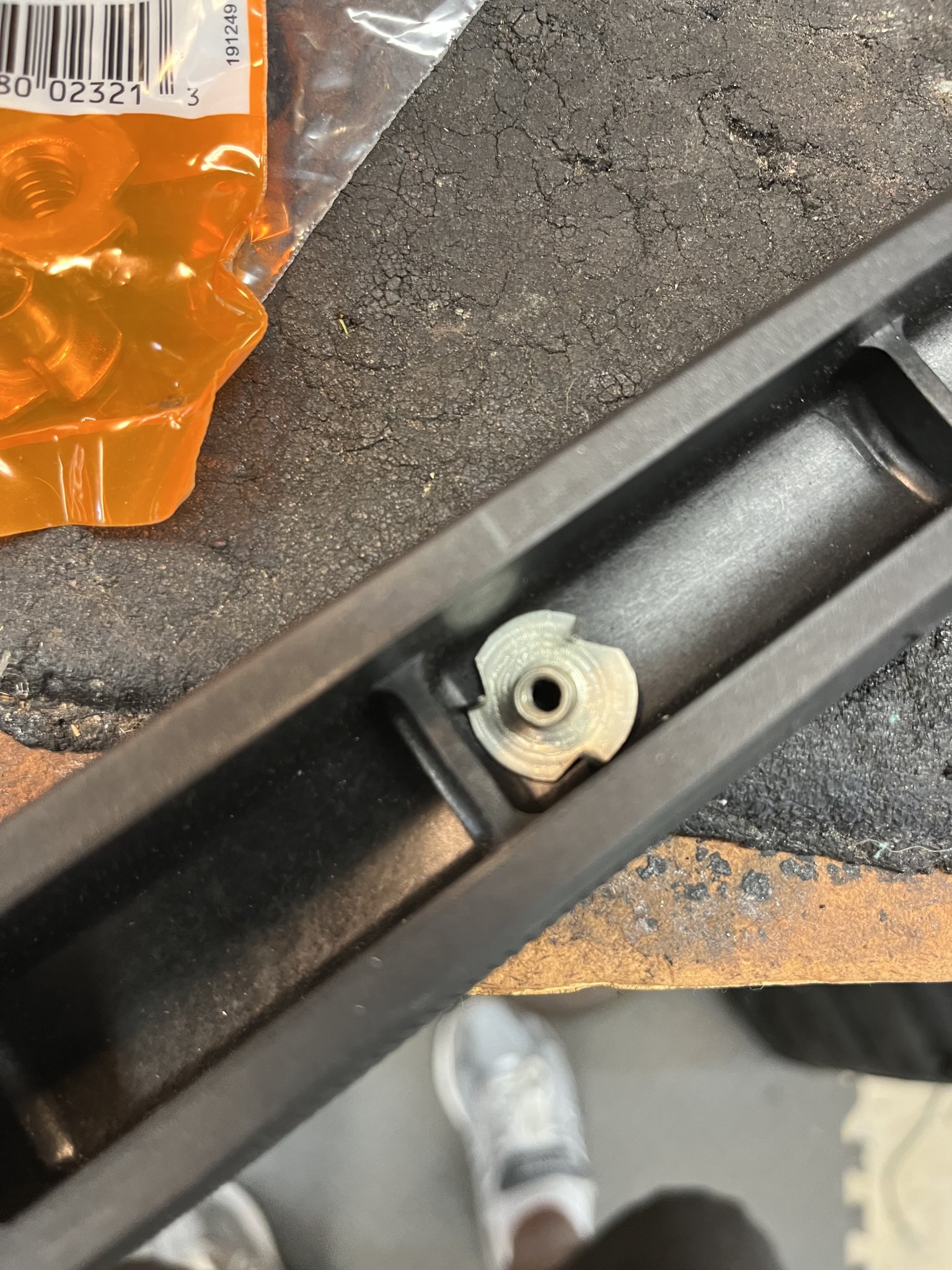

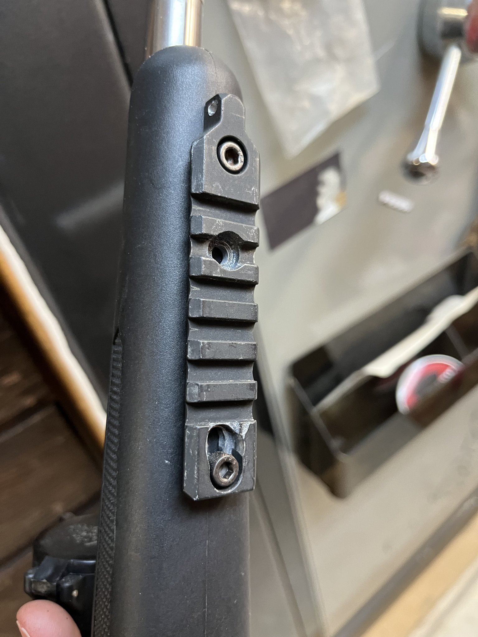

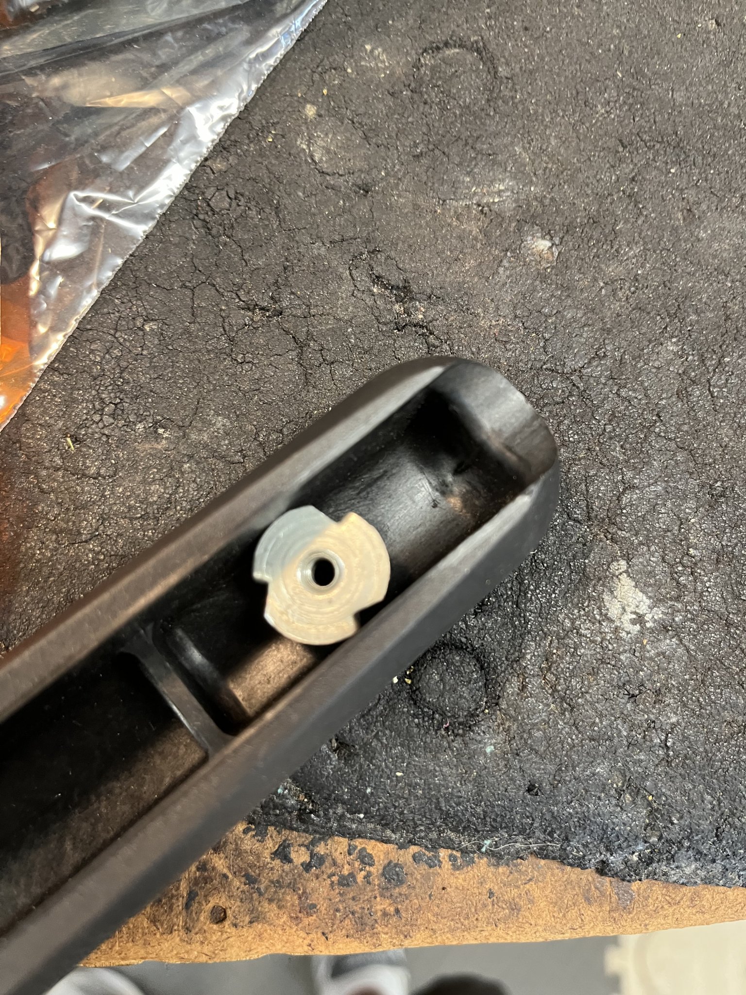

This isn't Arca but shows how you can install one. I drill through the center of the cross rib and counter bore the front sling hole to fit the tee-nut. This is a Ruger 77/357 with rail installed, spare 77/44 stock with nuts. Same stock.

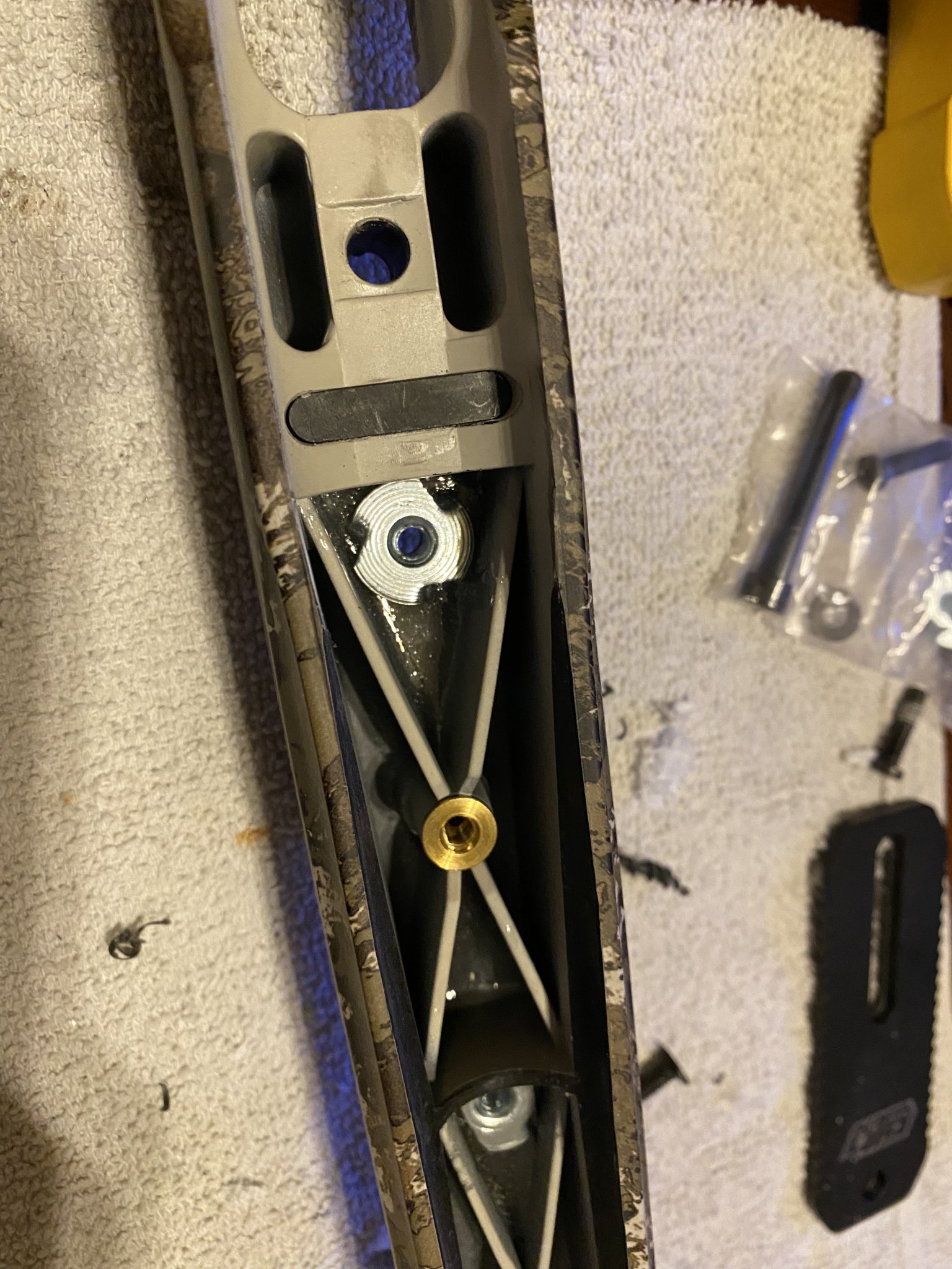

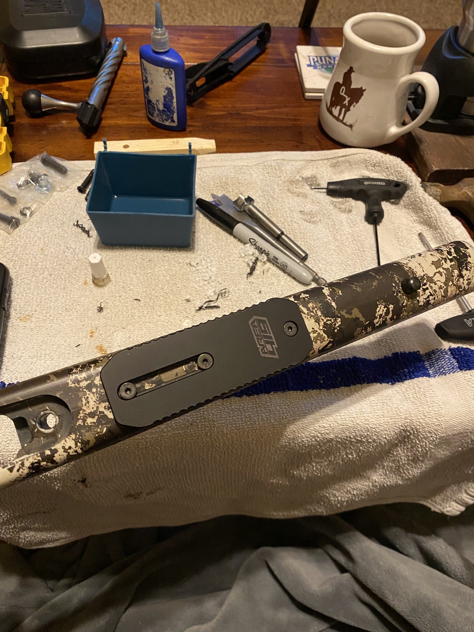

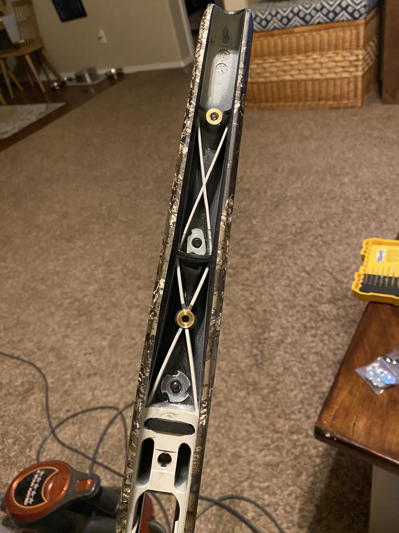

I just did this one last night. Thought it might help you. Tikka veil plastic stock. I used 5min epoxy and added 1/2-3/4” of epoxy to the ‘pockets’ in the stock to basically act like a big buffer, and strengthen the stock where the T-nuts are.
I had to play with the spacing a little, so to not affect the bracing in the stock. I think it turned out pretty solid

The same night i did the tikka stock, i added t-nuts to a manners stock just like the video below, for a full length arca rail. It was easier than i imagined.

For my tikka stock, using the epoxy, the t-nuts locked in the same.
