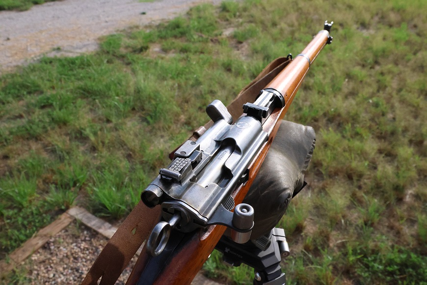

In the early 1940's the Swiss tried several German optics/mounts and were dissatisfied with the zero retention and general ruggedness of the optics and mounts so they solved the problem by filling the gap between the optic and receiver with weld... So at least we know there's a nuclear option if all of this still fails us :D
