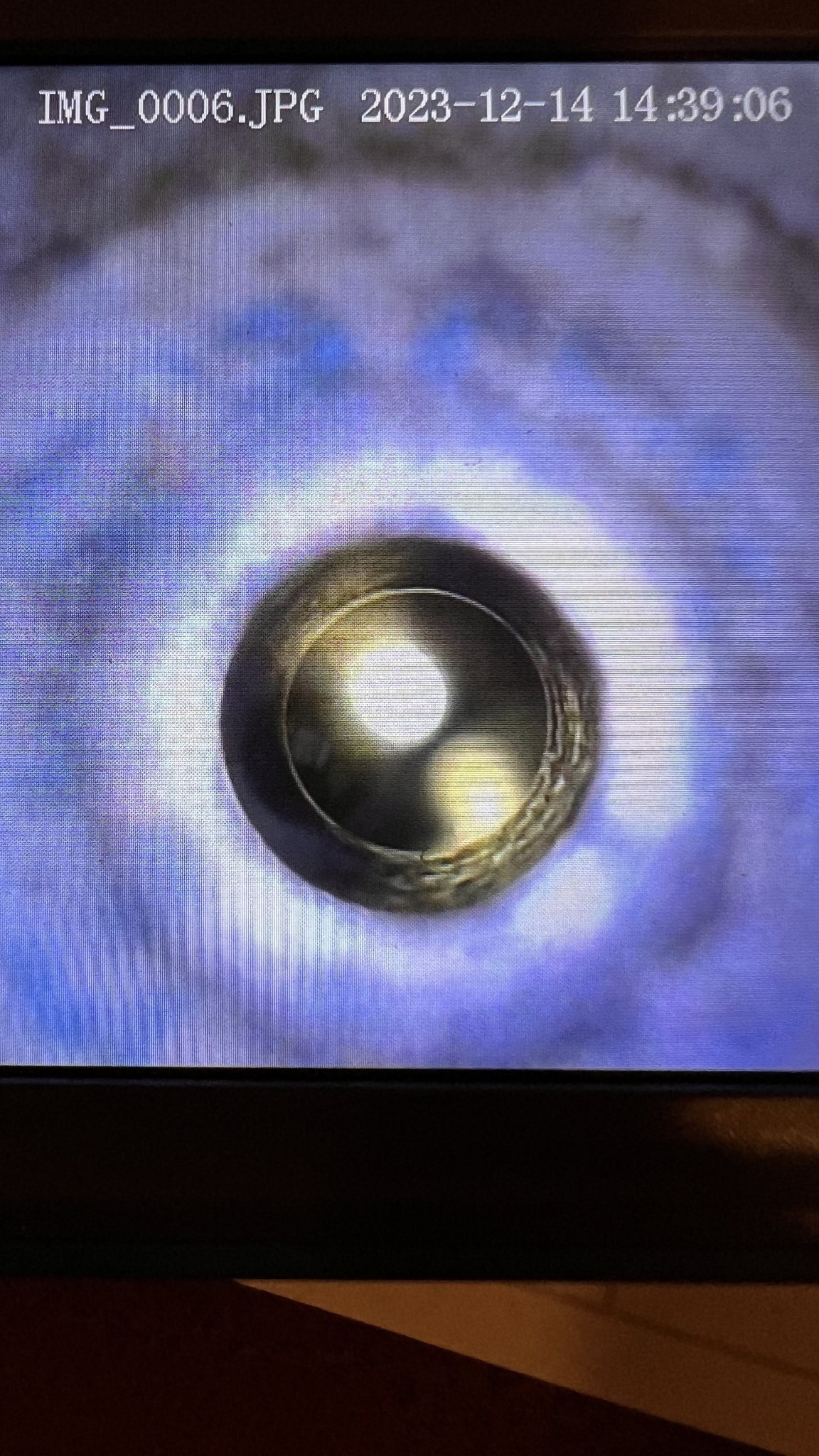

I should note that I got unlucky with my bought-new Super Varmint, so it ain’t all 🌈 & 🦄 . The inside of the firing pin hole looked like a Martian landscape and that increased friction was causing some light strikes, especially in colder weather. Sent it off to Tikka mid-Dec. 😞
