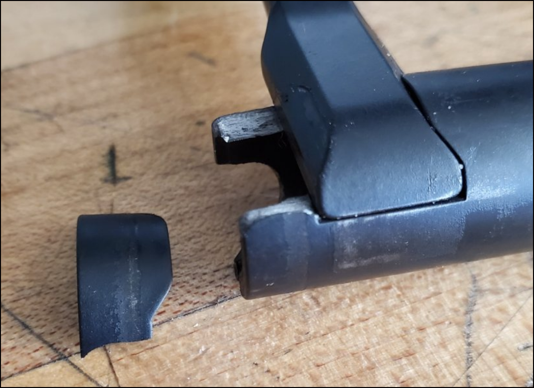

Why is this? Have you seen or have a reliable tale of a Tikka bolt failing?
Tikka is great, but I would not put it into serious heavy use like competition shooting (many do). I don’t have total trust on the strength of their bolt. I consider Tikka as great hunting rifle, casual target shooting etc.
Reactions: MarshallDodge
Yes I've seen couple bolts failed personally. And they all failed the same way, let me see if I can get a photo for it. I think it's a design limitation, can't avoid it - so having a spare bolt will be good idea, but Tikka's spare bolt is going to cost a bit...
There you go, same exact issue as the OP so borrowing his photo and thread.

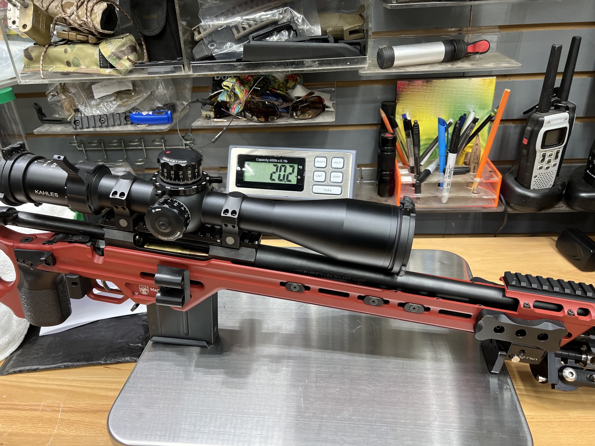

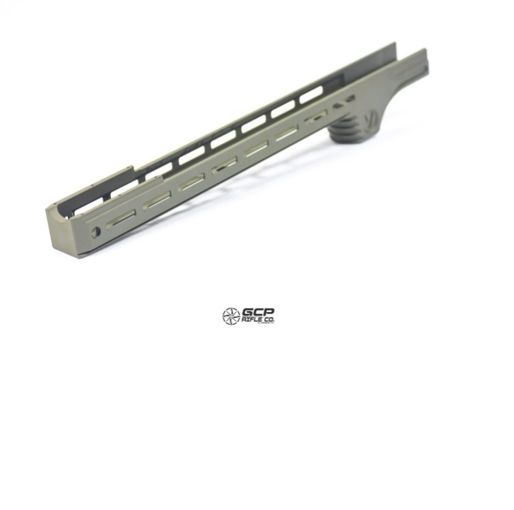

Besides being a nice product, what's the best use of this fore-end? Is it to increase weight? The website looks like it's 28oz. Does it add significant weight to the Bravo? Probably not an NRL Hunter type of fore-end?
It would be a perfect NRL hunter fore end. U can add weights to it, full length arca rail, better for positional, and longer than factory to get spacing between your magwell and bipod. You can run a game changer on a barricade while the bipod is still on. It's better in literally every way.

LRI does make a replacement bolt for tikka now, should be of good quality, so I'd say it's going to be OK so long you have a backup bolt!
Also their analysis suggested the same issue on factory tikka bolt:
Stress analysis proved that the dovetail handle geometry creates a stress concentration. To mitigate the risk of failure we chose to temper this feature and wire EDM corner fillets to create a virtual corner (dog bone) to distribute the loads more effectively.

But how does it do on weight? I have a slim KRG Arca on my Bravo fore-end, a spigot, and I don't need any extra weight. Trying to trim weight, you know what I mean?
Is it heavier than a Bravo forend that has a KRG Arca rail and spigot?
Wish i could verify. i didnt have anything on my factory bravo fore end except a polymer pic rail. That shit sucked. with the medium palma barrel finished out at 24" and a supressor, it still feels super light. then i added LOP spacer weights and the exterior weights to the fore end.
but IMO, the juice is worth the squeeze. i dont think i could ever go back to a bravo without this fore end. And honestly, if i was looking at getting a W3 chassis, due to the cost of the new one, i'd go with the last gen and do this fore end swap and feel good about it. I like the new W3 but the price is pretty steep.

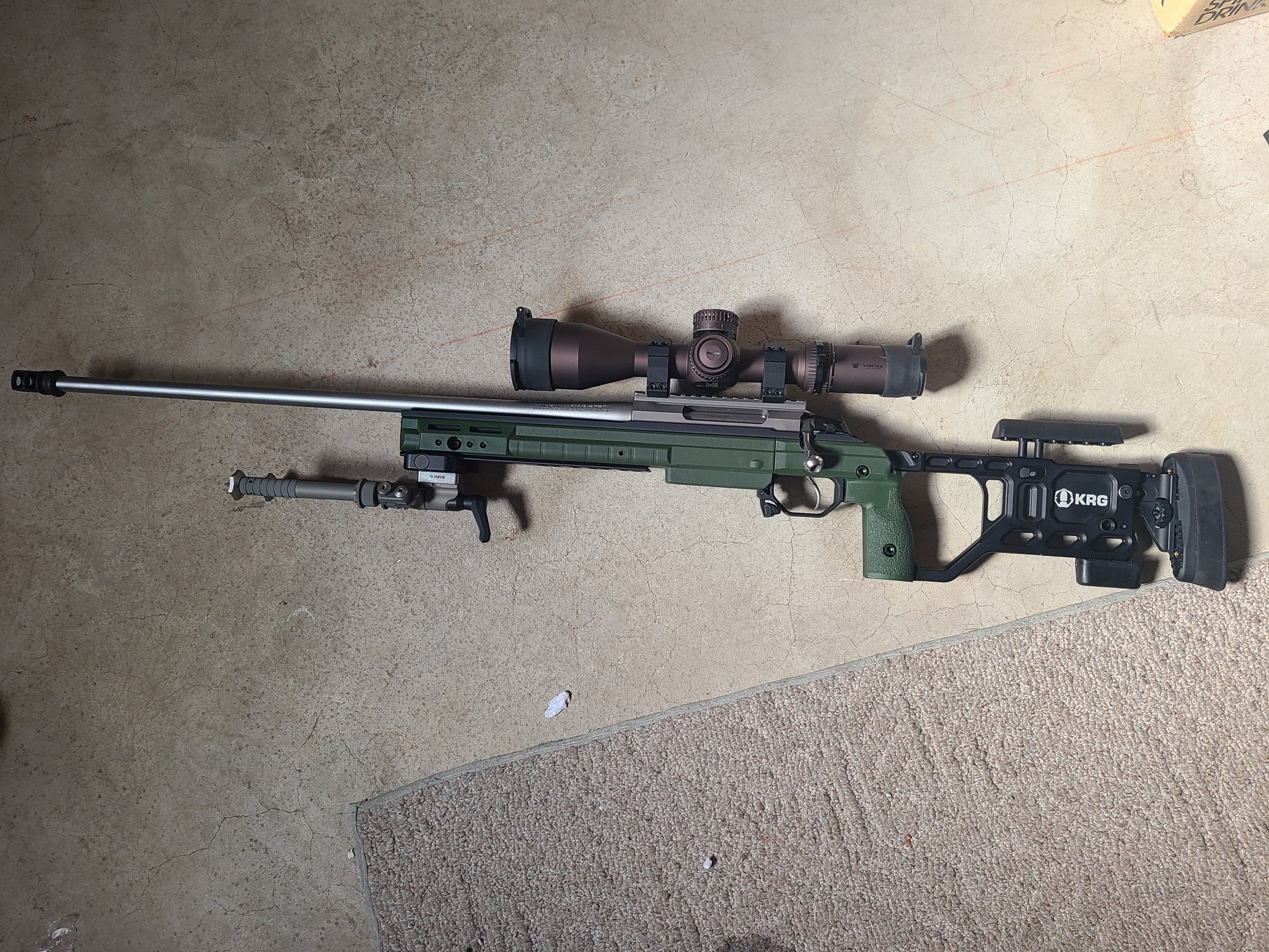

I just went through this decision building a rifle for my son. I have a Tikka that’s DLC (or similar) coated that is smooth as shit. I love the action and paired with a proof barrel it shoots lights out. I wanted to get him a Tikka action but the more I looked into it the more I found myself looking at an Origin. I’m very limited on what stock I can run with my Tikka. I don’t like being limited to just Tikka specific parts and accessories. I decided on the Origin and I’m having Southern Precision assemble the rifle.
Pretty similar in weight to a bravo forend with all the add ons.
Does this vision forend still need a backbone? Or can you just bolt on the stock/ grip from KRG?
I have seen 2 on the hide and I think both were dropped but i'm not saying it cant happen. With thousands and thousands out there I wouldn't call it a common fail point but to each there own it never hurts to have spare parts.
I can't say I've measured hundreds of the Tikkas. But of the ones I have, I've seen an extreme spread of .021" from receiver face to bolt nose. Distance from bolt nose to bolt face seemed pretty consistent.

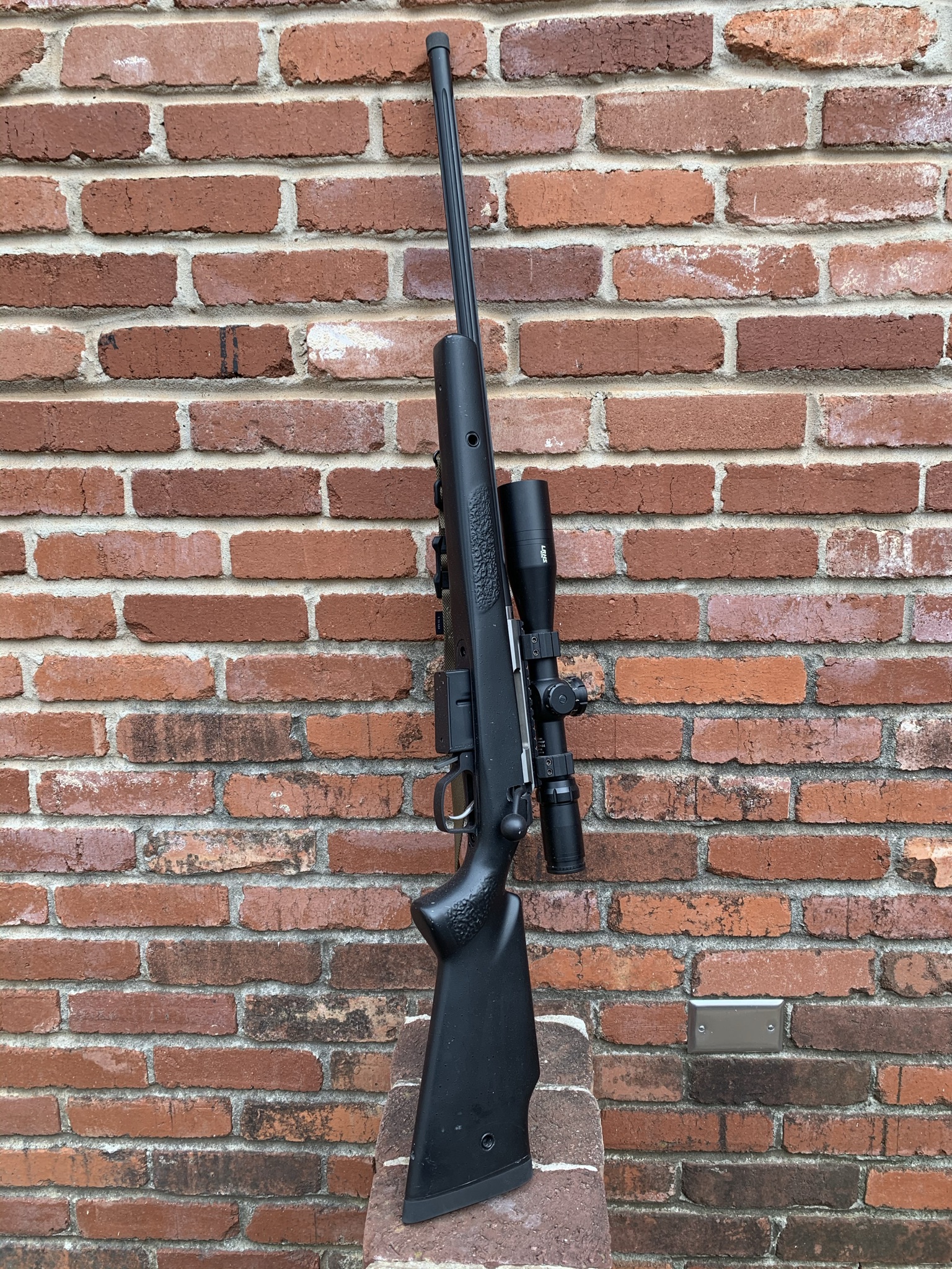

My t3x. Will eventually change out the barrel down the road. My ultra 7 is in jail.
Need updated pic. No Sterk handle or shroud.

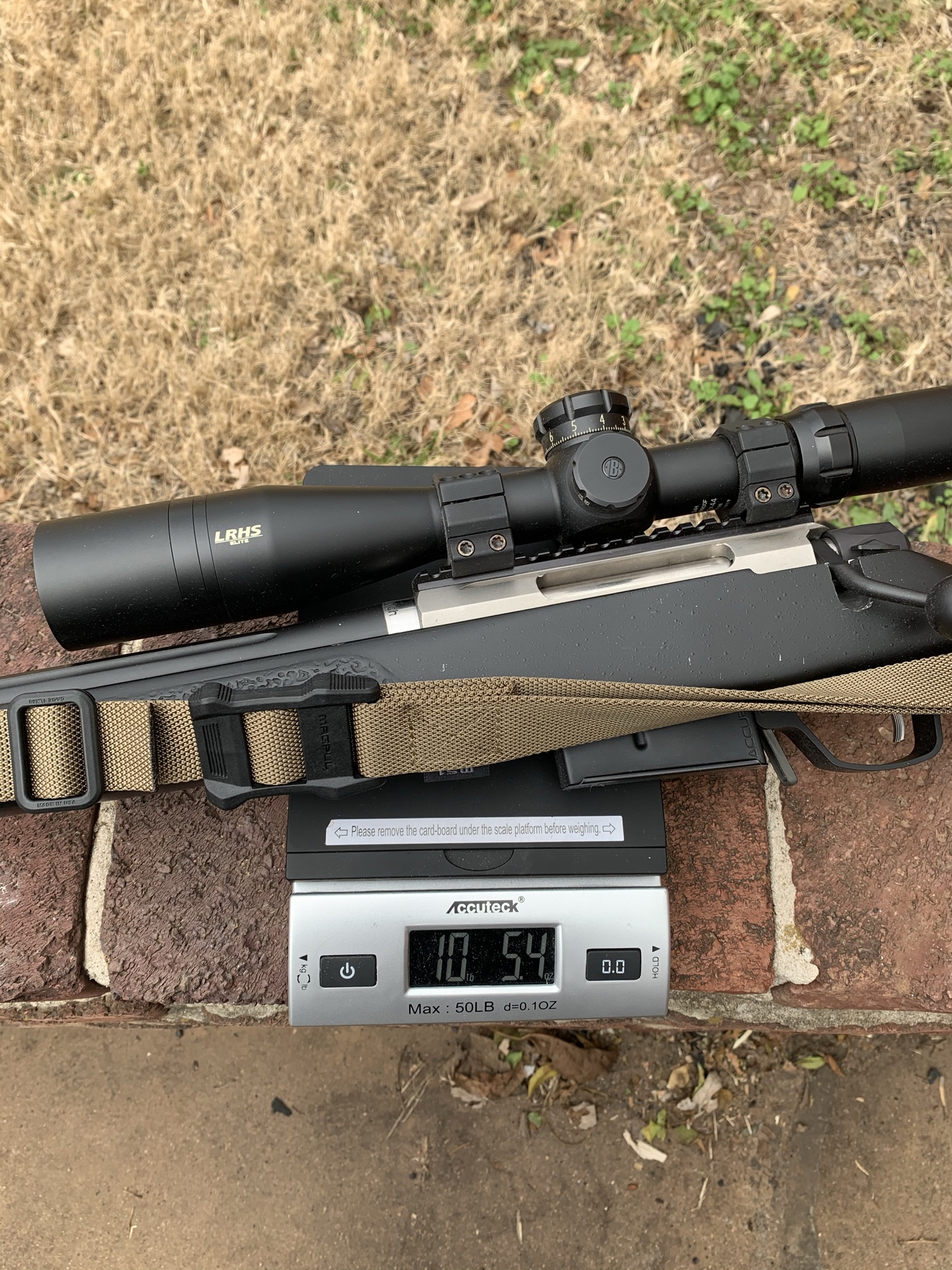

I paid right at $730 for the T3 lite donor rifle. Sold factory bottom plastic and mag for net $60, barrel sits in my reloading room, tried to sell it a for net $50 a couple times. Paid $15 for a yo-Dave upgrade, $70 for a shroud, $30 for a lug, $90 for a Sterk handle, and $80? for a rail.
$730 + $285 + ~$50 in shipping for the bolt ons - $60 - $70 (even if I sold the barrel) = $935 + whatever my time is worth.

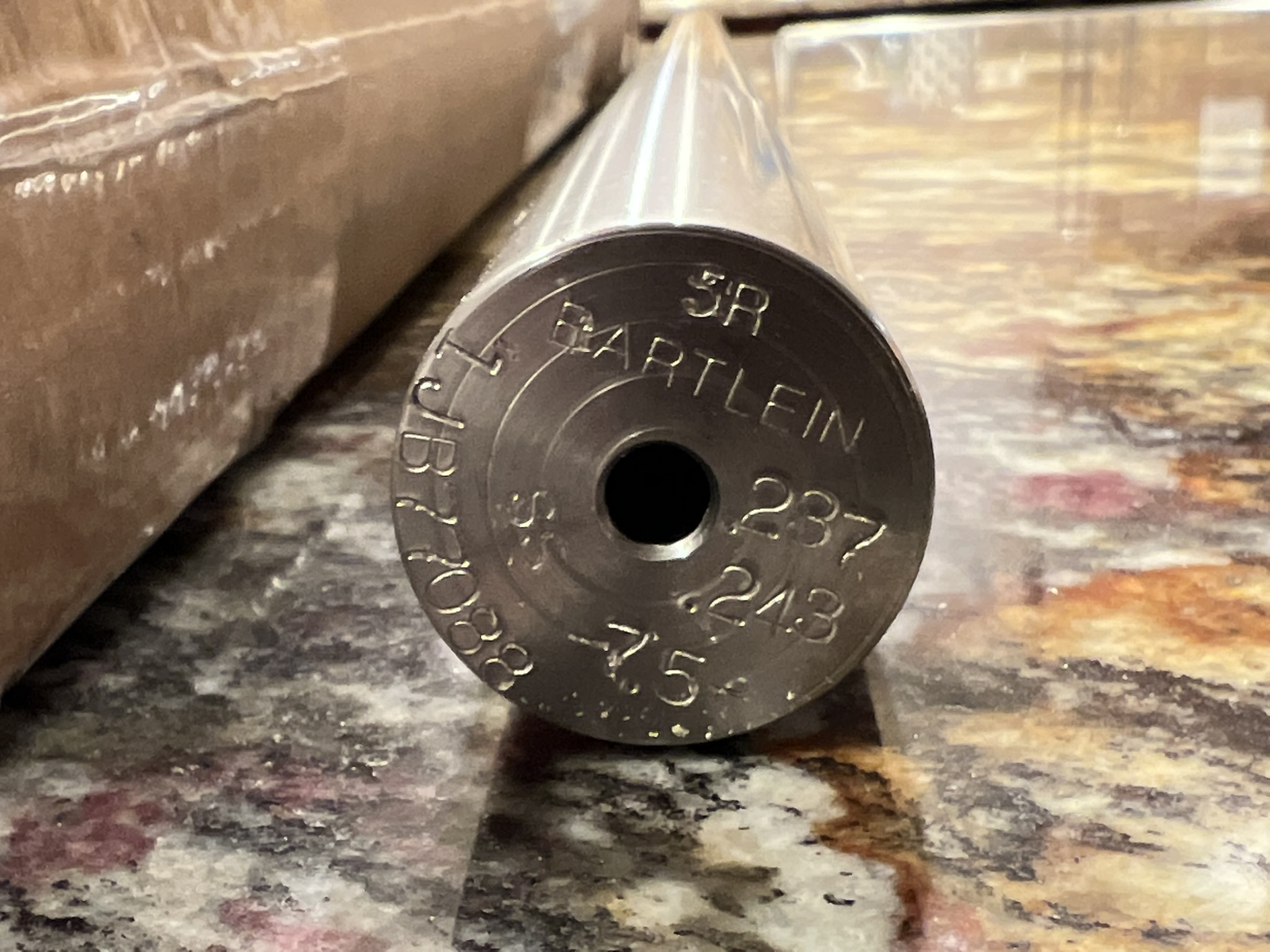

Shit, it's hard enough to find top shelf blanks for $350. Much less one chambered, shipped, and isnsured.
Fella said he'd bet, I wonder how much. Maybe I can get my next couple blanks paid for.
I’ll go fly a WTB ad, we’ll give it one week, I’ll happily wager $100. Do we have a bet?
