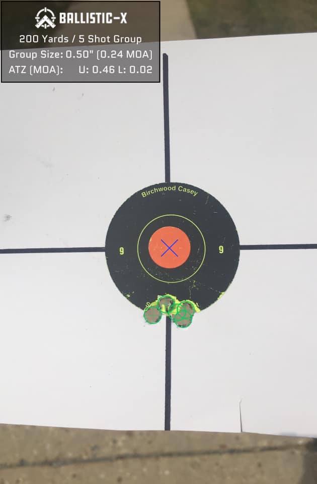

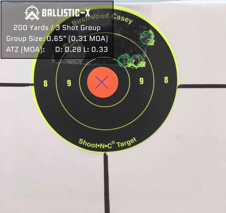

    Lots of great information here! It's been helping me validate what's been going on with my rifle. I have a factory Tikka with about 1,600 rounds down the pipe. Accuracy is still phenomenal, however my velocity took a dump. I was at 2,742 fps and now after I had to redo my load development to chase the lands I'm at 2,613 fps.
    Sounds like based on everyone's experience - velocity takes a dump prior to accuracy going away. Groups below were shot today @ 200 yards, even with my velocity having dropped. Luckily I have a backup barrel ready to go.
    Just add a little more powder until your velocity comes back. No need to chase the lands.
    I tried that and I actually hit pressure. My load before was at 42.5gr and I worked up to 43 grains. Accuracy was acceptable, however I started noticing ejector marks on the brass. That's why I decided to do a complete load workup again. 41.5gr had stellar accuracy, however the velocity is now slower than my 308 Win gas gun by 100 fps?
