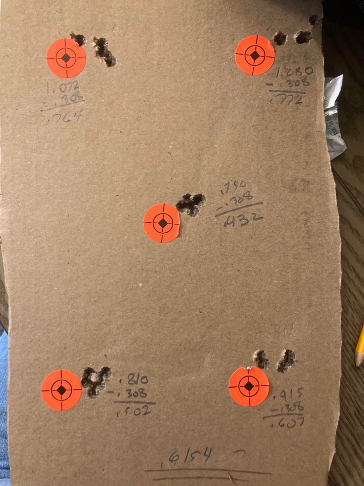

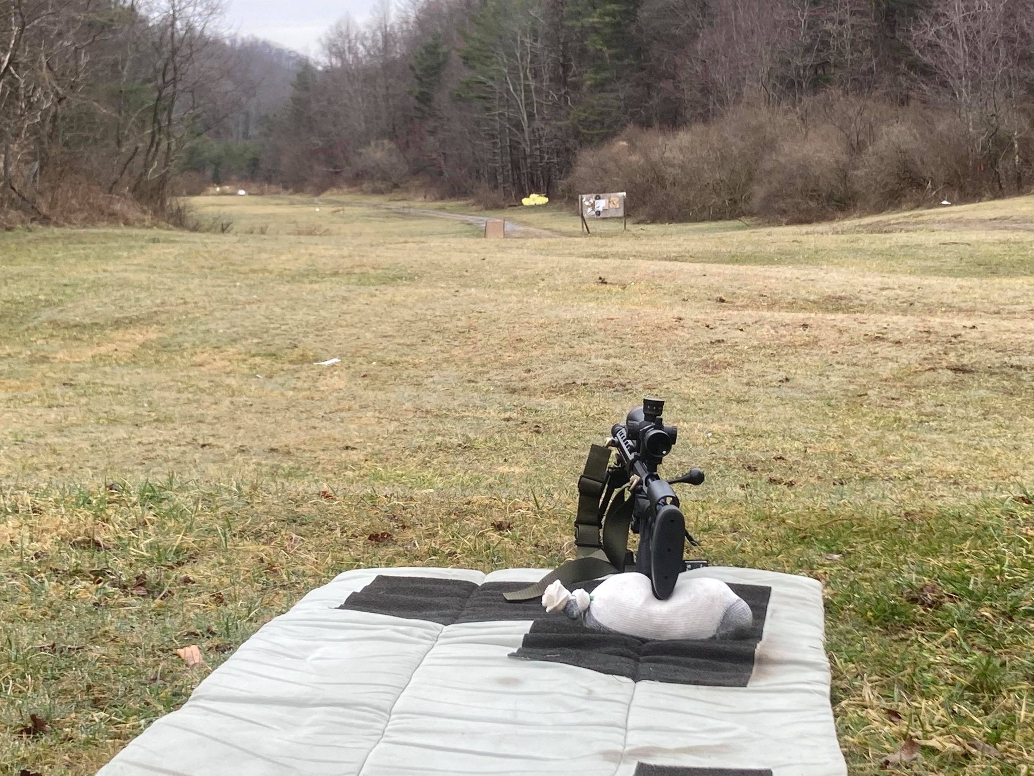

Folds up into a nice package so it's nice to get into position. Loaded I am at 13 plus change pounds. Go try one is all I can tell you. Not that I am a good shot but took it out playing around with it shooting 175 grain match kinds loaded for an old 700 and got this. I'm a shit shot and was tiring during the last few strings.
