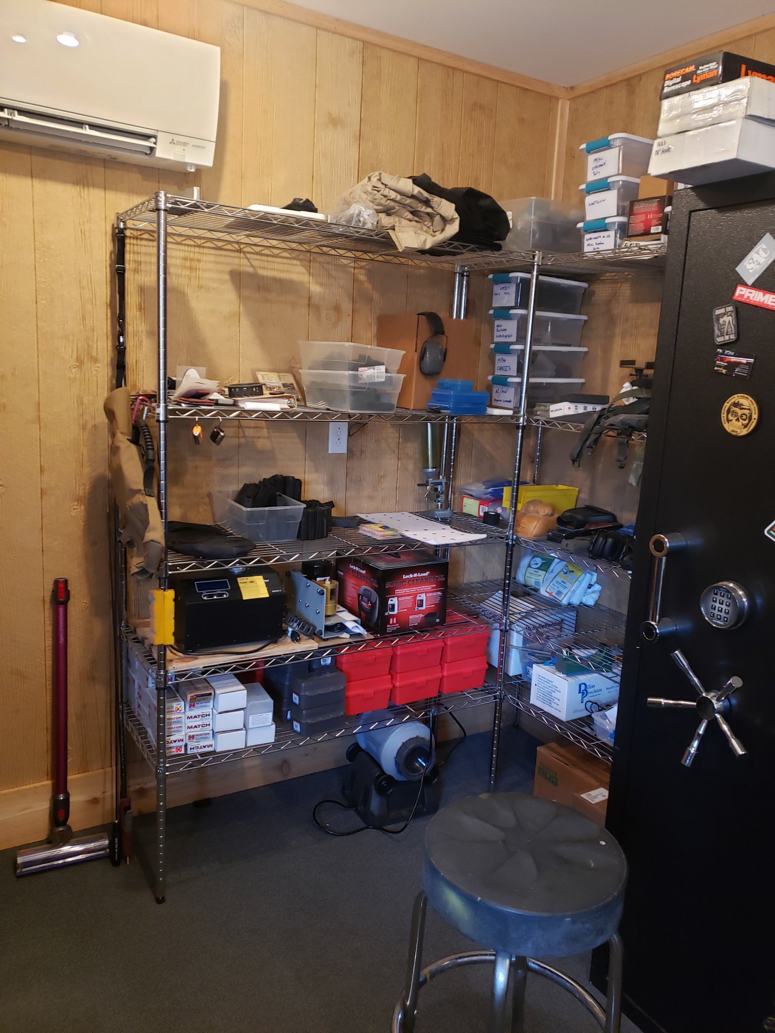

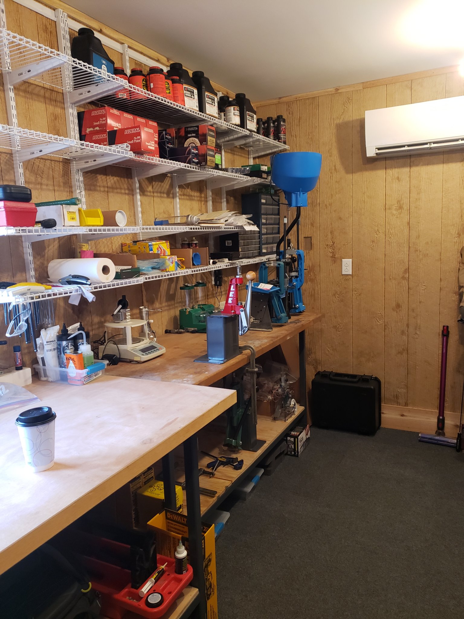

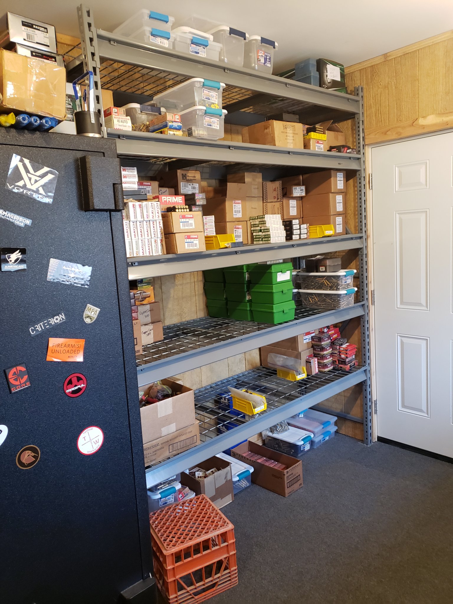

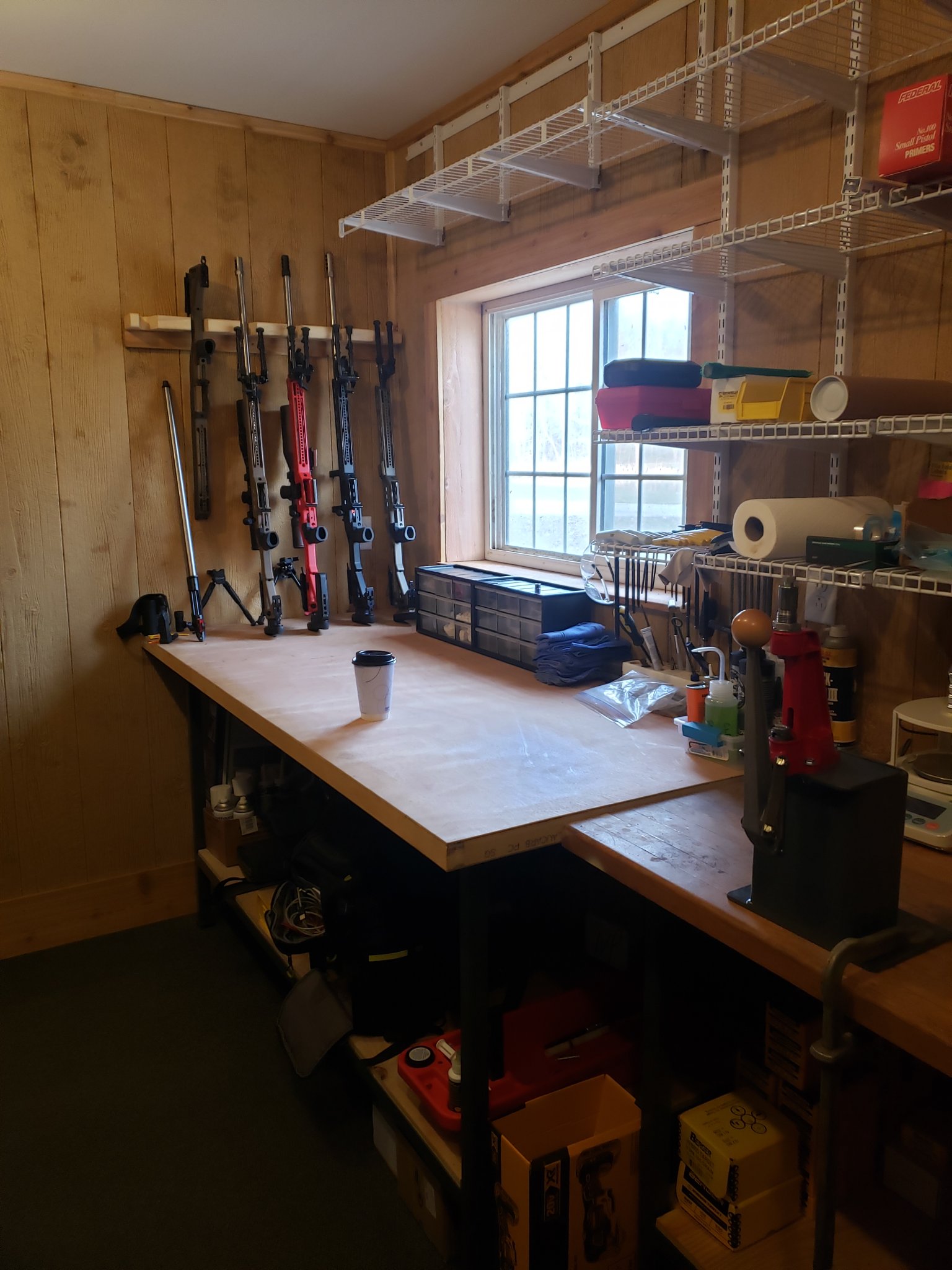

My hidy hole

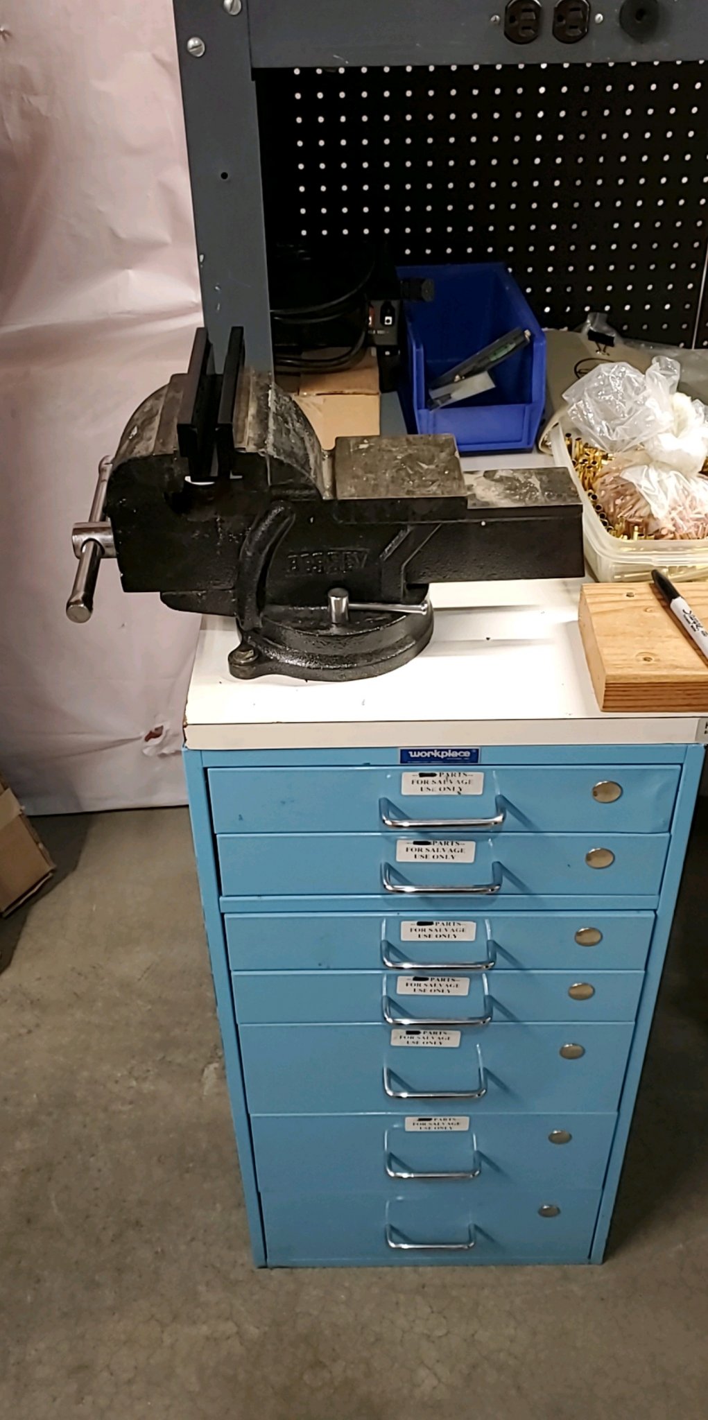

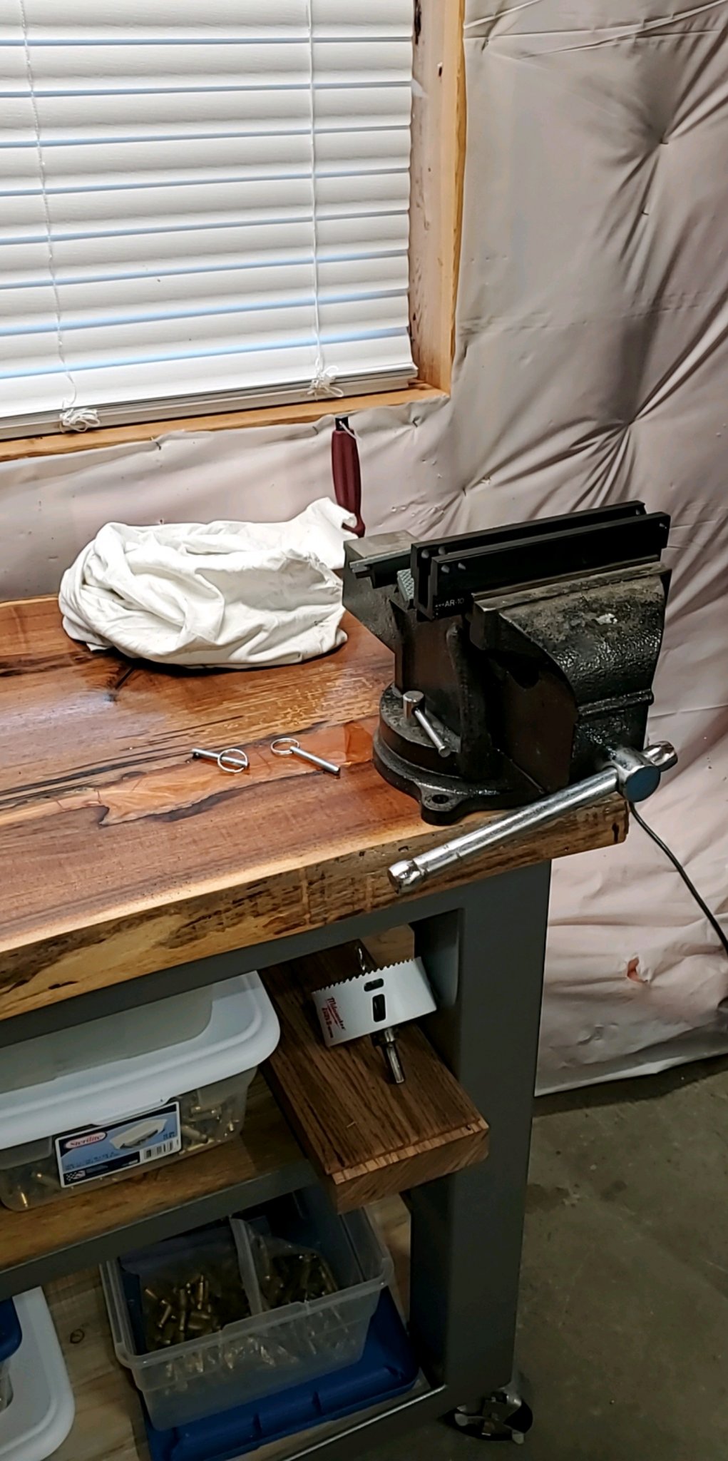

What a deal had 6 ft of reloading bench, added 14 ft wow, wait for it, subtract 14 ft of gun working bench.
By my expert calculations and having been awarded my GED long ago I belive that I'm close to 6 ft again.

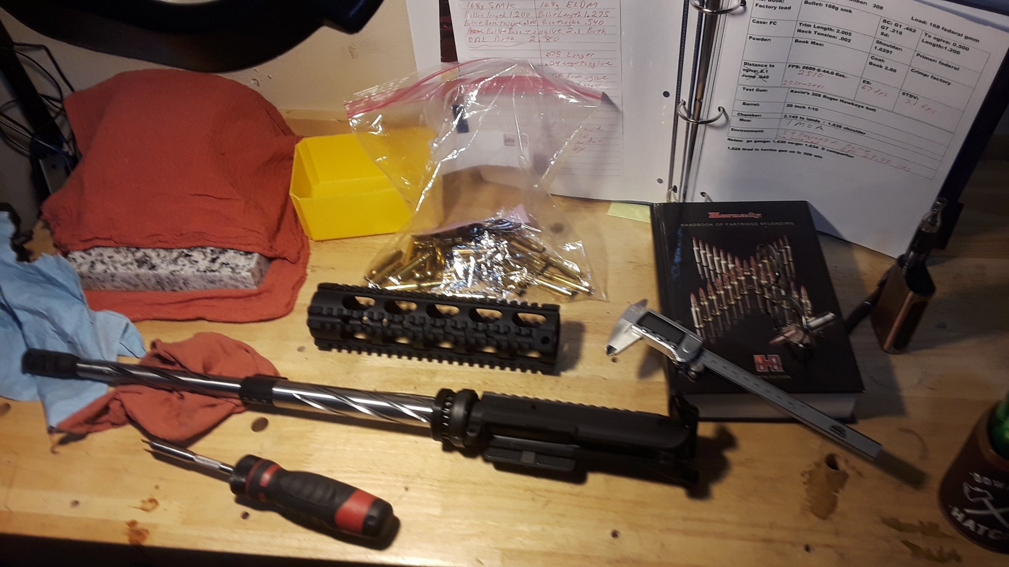

Loaded some and processed more 308
New barrel needed new reciver old one had too much play, too damp and cold to paint so will run it for now.
That damn c-clip on the dust cover gets harder to put on each year.

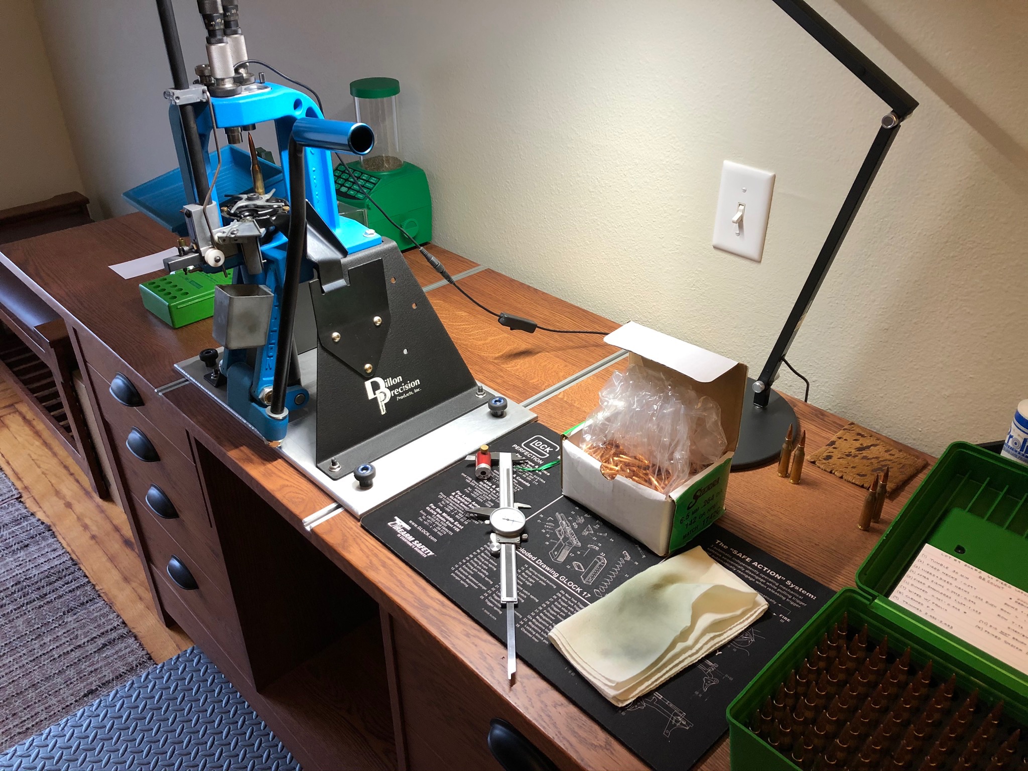

Yessir. I have multiple presses mounted to aluminum plate that mate with T track. The rest are stowed in another space when not being used.
I like that. Makes more sense than having multiple presses mounted and eating up bench space. Looks like I need to go back to the drawing board!

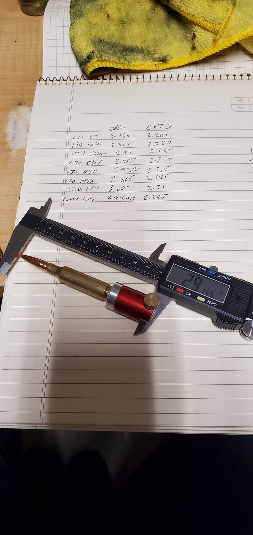

I’m not sure if this was meant to be tongue in cheek humor, but if not, you’re doing it wrong.
I have to agree. Is that comparator not supposed to go down on a bullet that is loaded to the lands? I mean, I get the way you are doing it, but it doesn't give you "ogive to the lands" measurement. When tips are mechanically uniformed, what you're doing will work to give you a seating depth, but still won't tell you exactly where the ogive touches the lands.
I have to agree. Is that comparator not supposed to go down on a bullet that is loaded to the lands? I mean, I get the way you are doing it, but it doesn't give you "ogive to the lands" measurement. When tips are mechanically uniformed what you're doing will work to give you a seating depth, but still won't tell you exactly where the ogive touches the lands.
I was measuring OAL like that. Obviously I did things the correct way by putting the ogive into the comparator to get the BTO measurement.

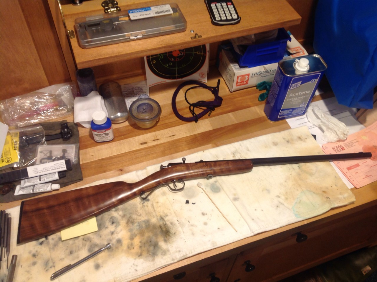

Friend has been wanting to find a decent stock for his passed dad's first rifle....a Winchester Model 1902.
Found a stock on Ebay a week or so ago. Ordered it up and have been Tung/Linseed oiling the crap out of it.
Worked on putting it together today......
Sucks the little escutcheon that lines the take down screw hole broke while disassembling the old stock.
Fortunately found a guy that sells them online. replacement ordered.

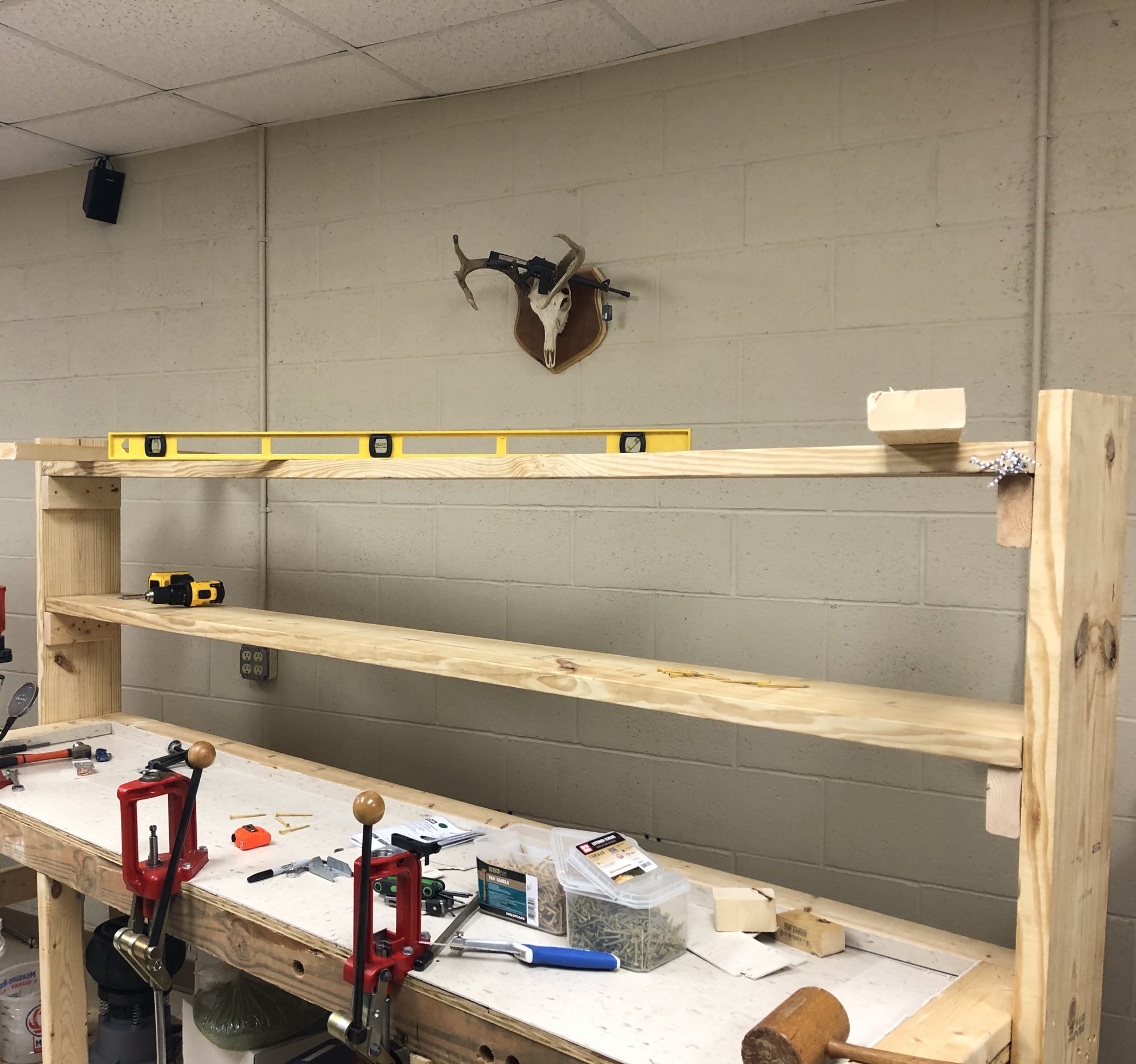

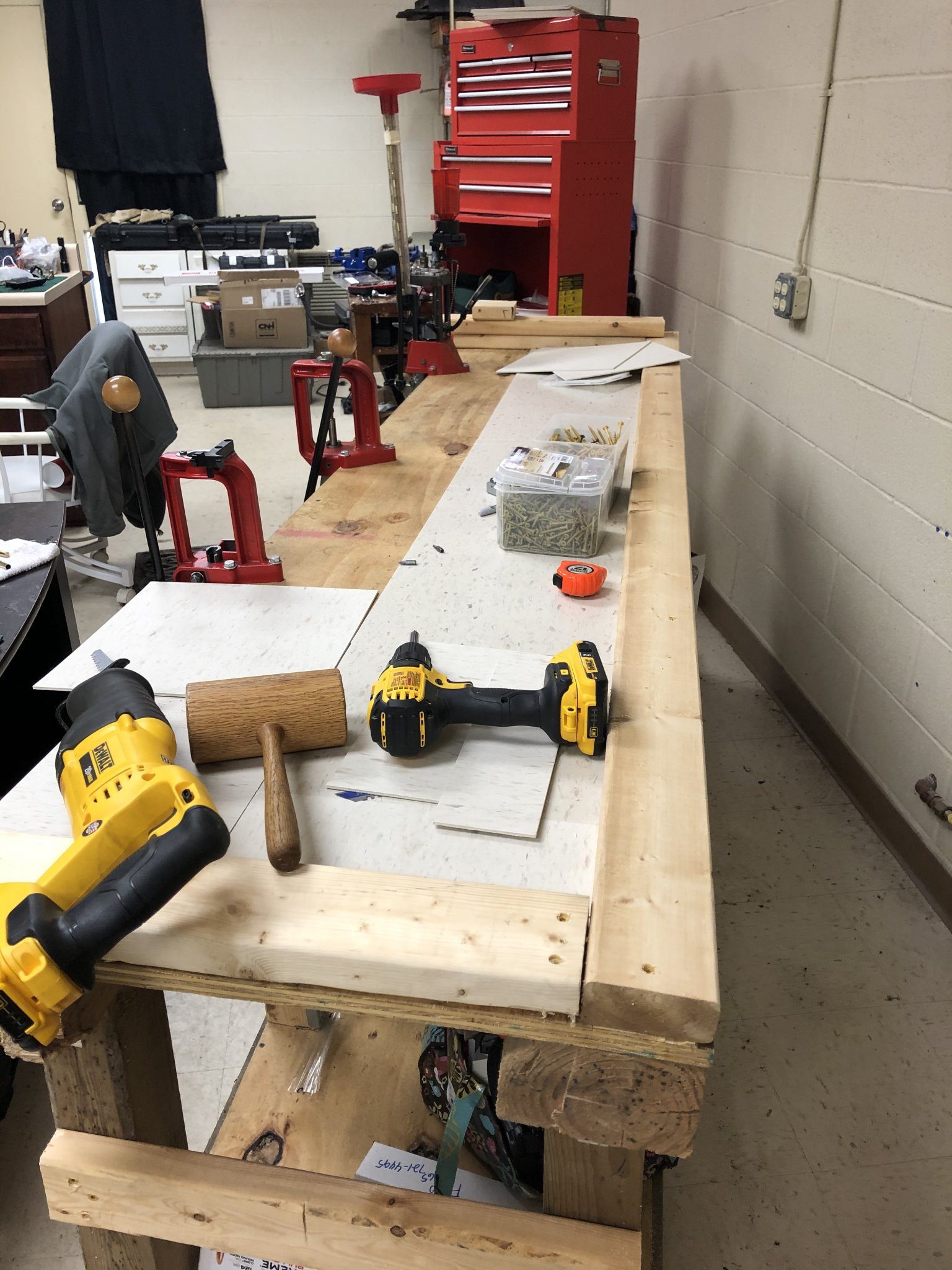

Started to work(update)on the reloading bench a little finally. Not sure the exact direction yet but that’s half the fun I guess. Today I will build the frame for the back wall and may finish laying the tile. I have 5 new LED fixtures to hang throughout the house so may not get to this today.

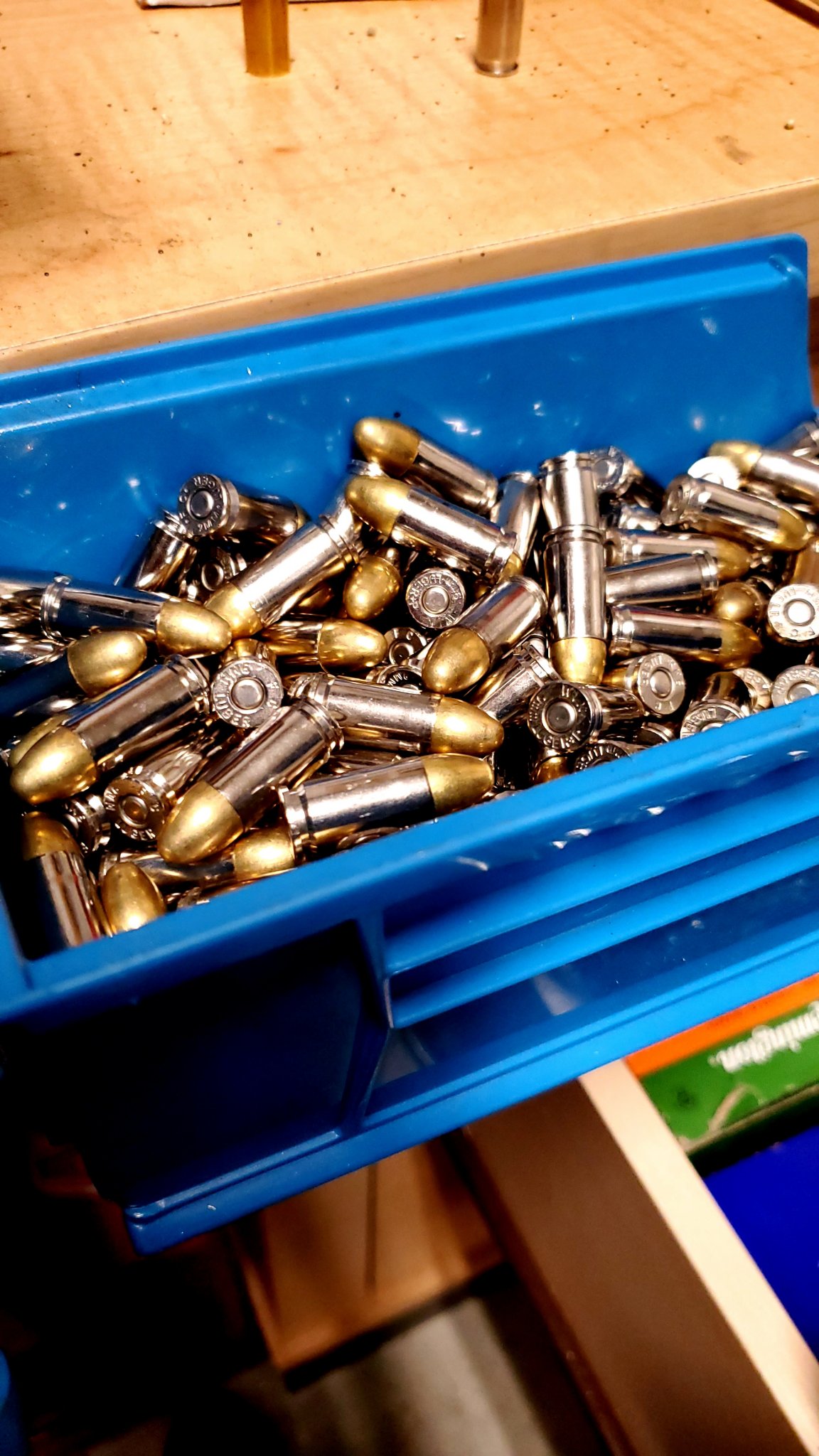

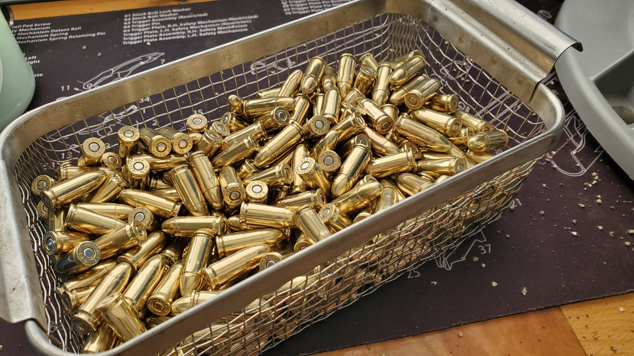

9mm 115 grain today. 700 in total between these two lots.
