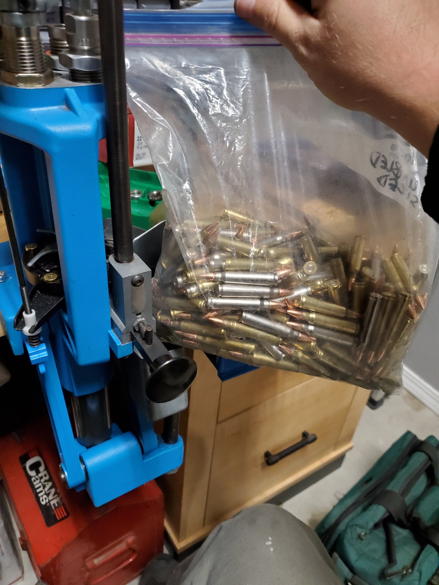

I have a frankford arsenal and it will do 600 at a time maybe more.

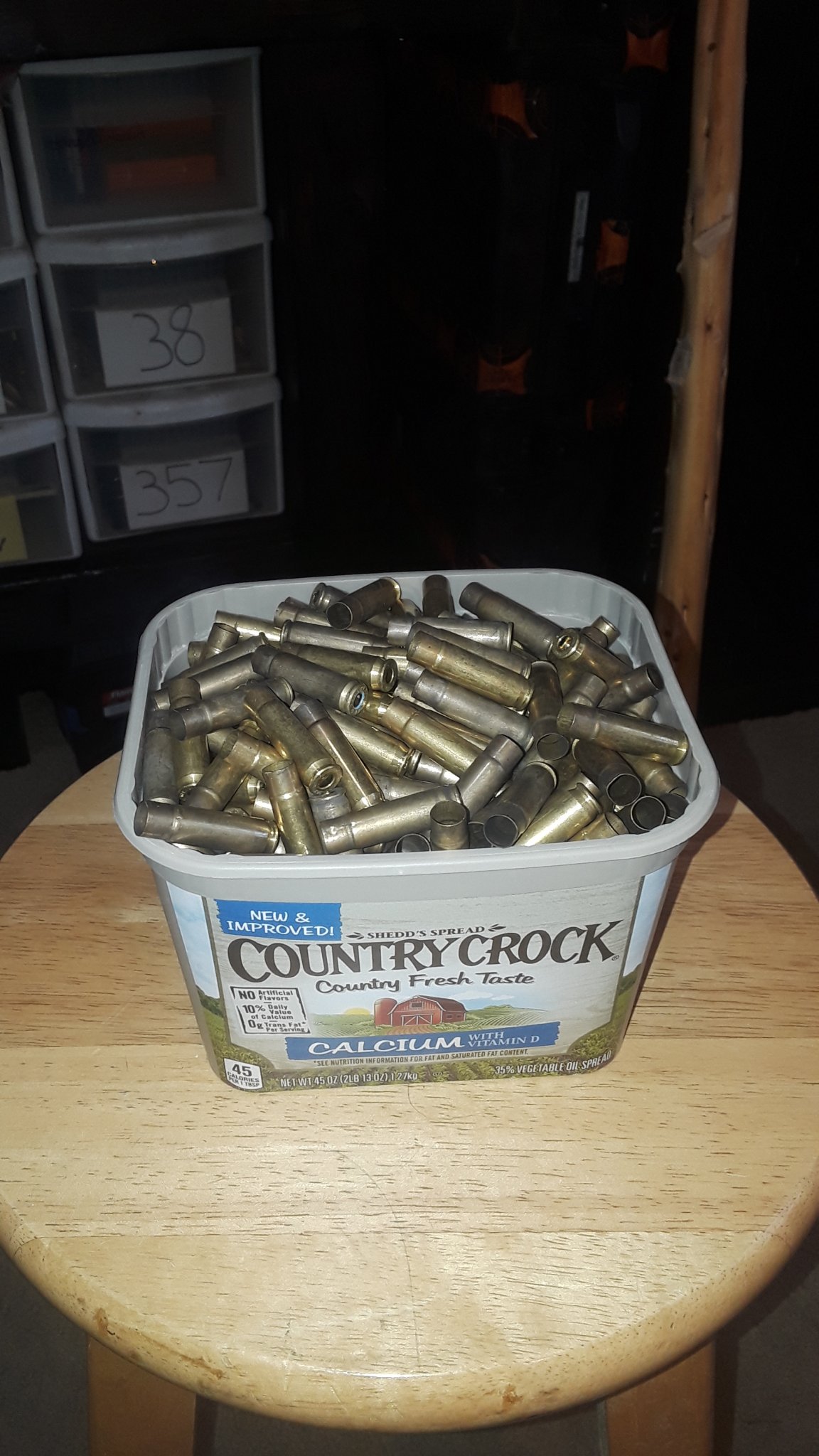

I prefer wet over dry. It REALLY cleans them, especially primer pockets prior to swaging.
What stainless tumbler can you do 600 at a time!? Jesus.

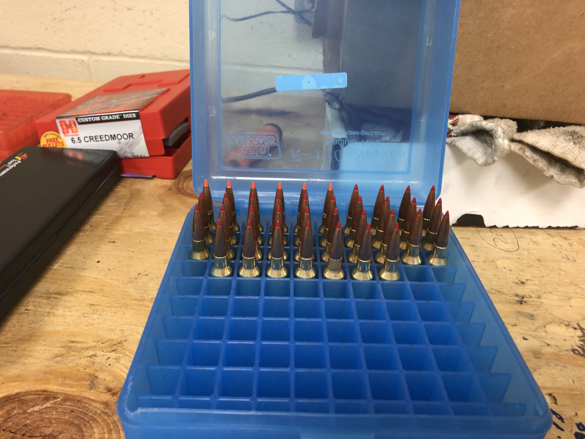

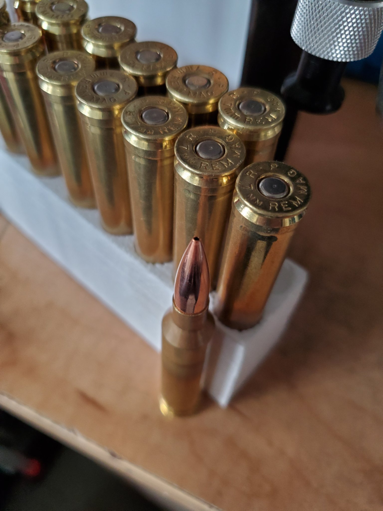

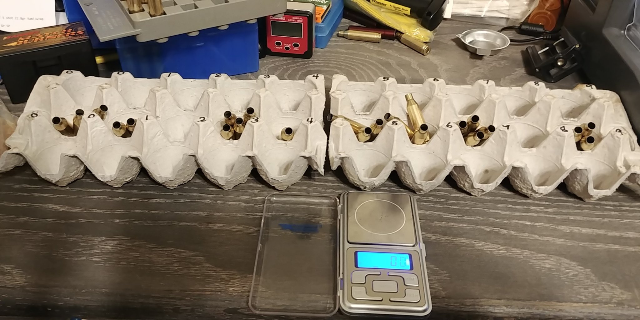

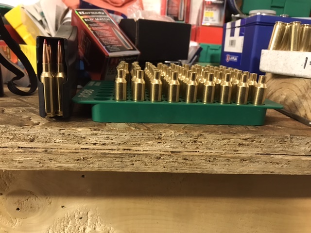

Had some Winchester fired brass sitting looking at me for a while. Deprimed, tumbled, cleaned flashole, uniformed primer pockets, sorted by weight in my super sorting station. Necksized and then loaded 11 different sets to check jump distance on a bullet I had sitting on bench.

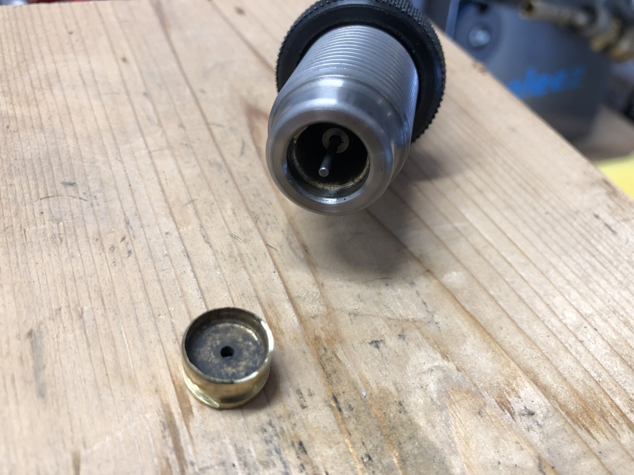

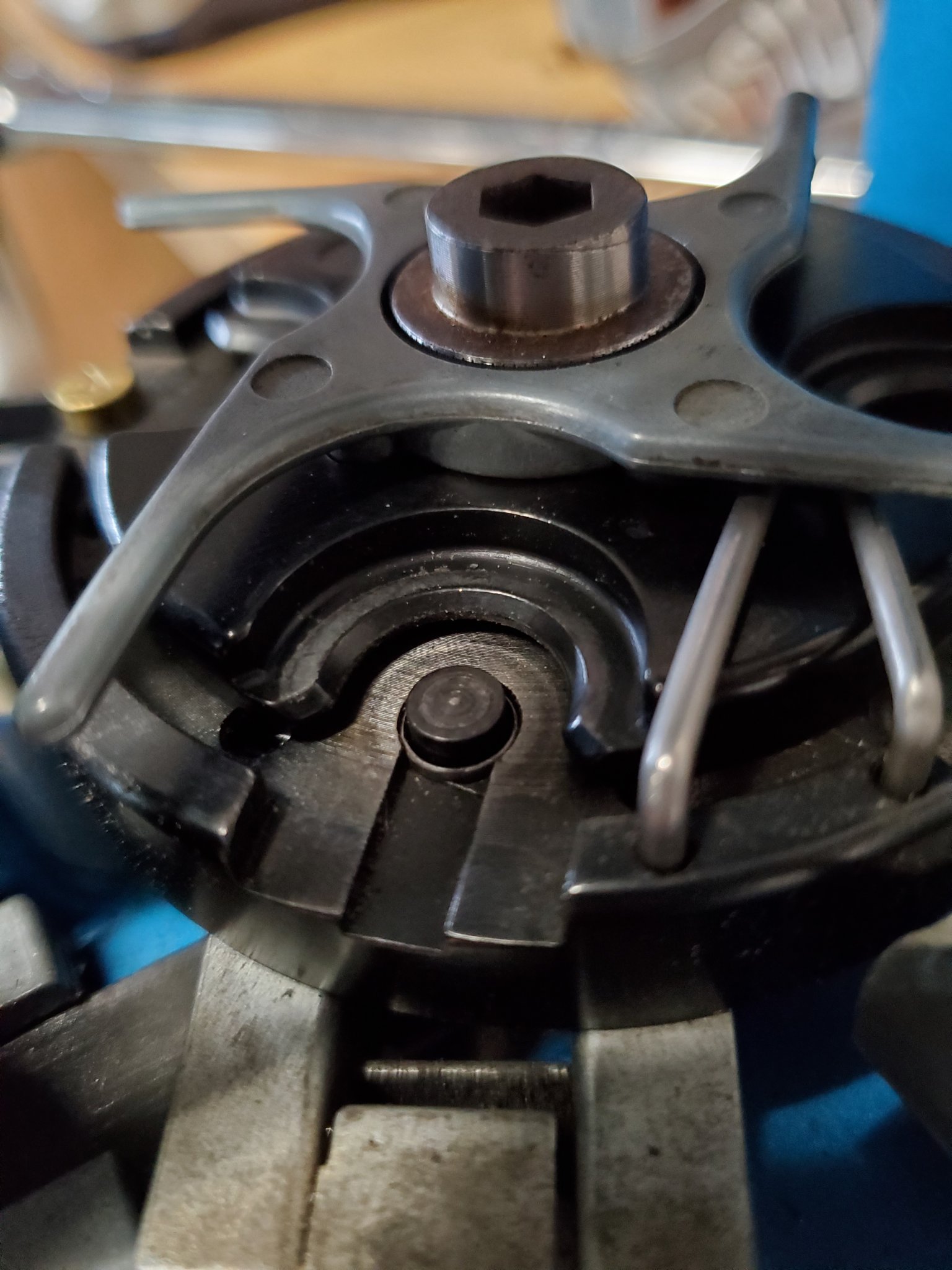

Cleaned the lock-n-load and OCD got the best of me and Drilled out the shell plate bearing dimples because it bothers me when gunk and spilled powder gets trapped in it, now it can pass through.
Aaaahhh...the 'ol incipient case head separation trick ;)
Added: I didn't see you posted later. That isn't just a case of not enough lube. It is INCIPIENT CASE HEAD SEPARATION!
I'm glad you found this in the die, and not while firing the next load. If you look at the case wall thickness you can see it starting. During inspections you should run a thin metallic point, i.e. an extended paperclip or O-ring, down to the bottom of the case and feel for a groove there.

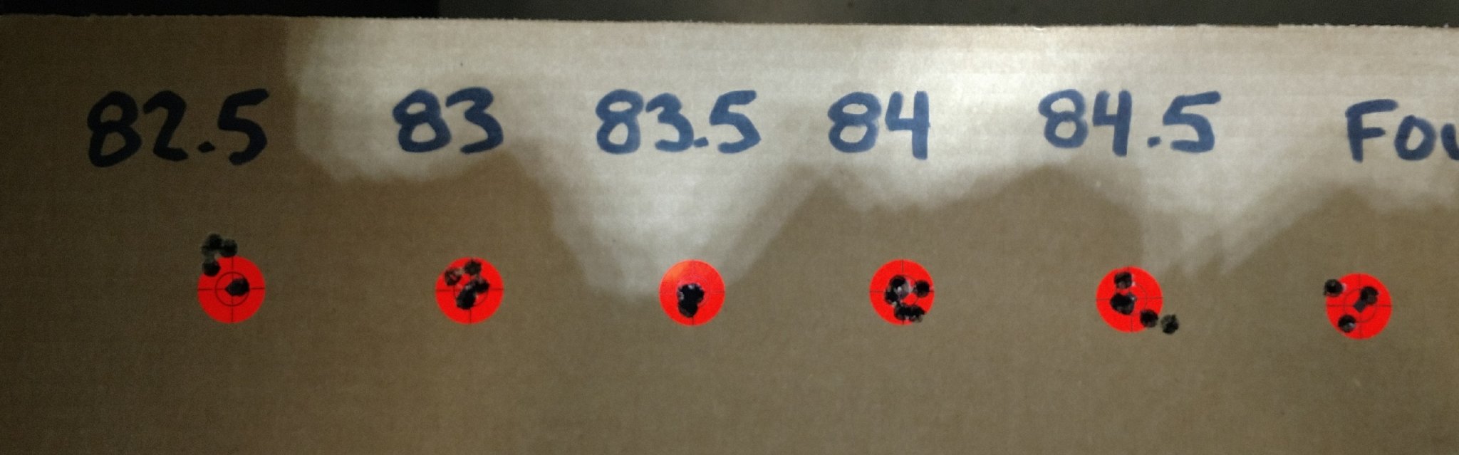

Ran an OCW test today on a new lot of H1000. Ended up in a totally different mode. Old lot was 77.8 gr @ 2950 fps shooting sub .5 moa. New lot is 76.3 gr @ 2840 fps shooting sub .5 moa. Both lots are shooting single digit es & sd #s.
Got some more loaded to 76.3gr to verify load later this week.
300wm with 190's or so?

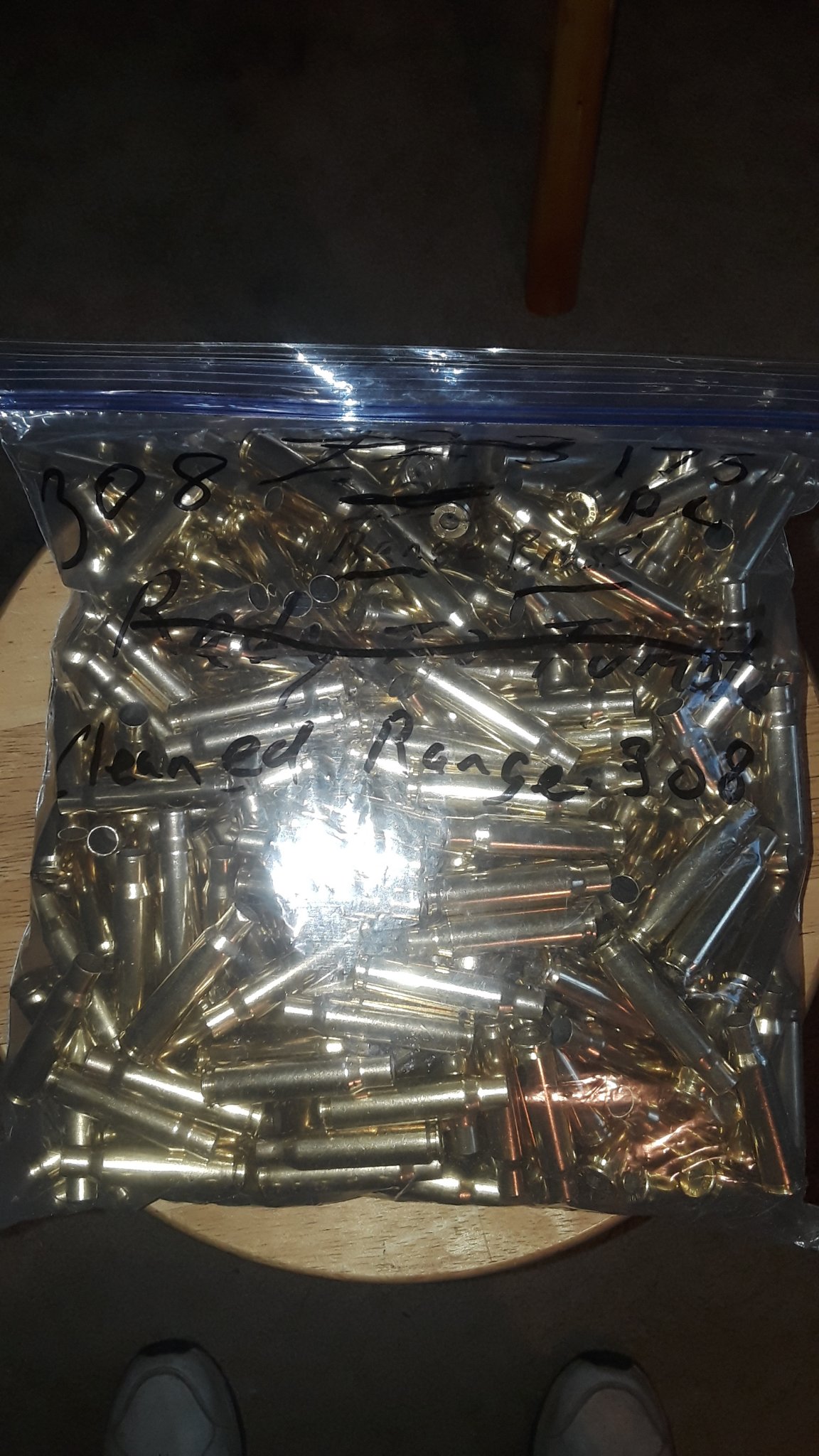

350 pc of 308 deprimed quick inspection (4 culls) half in the tumbler.

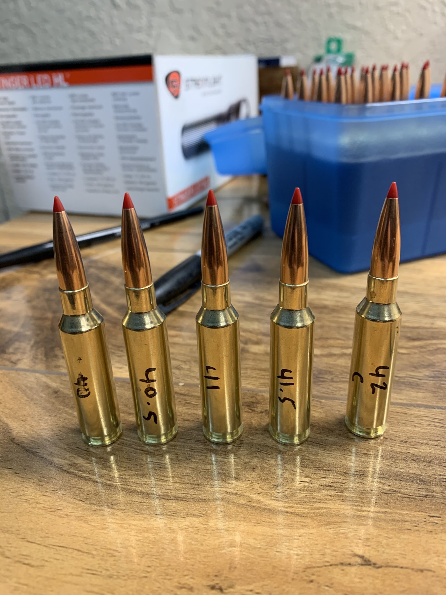

Hornady 168 eldm over varget cci 200 0.045 off lands, .0015 - 002 neck tension
42.0 got 0.74 group and 43.0 got a 0.65 group, 41.0 and 44.0 both opened up.
Factory fc gmm shoots 0.98
So loaded six sets in 0.2 increments covering that less the 42.0 and 43.0.
Plan on my son shooting those asap.
Not sure how is best for jump tests for next load.
Plan is 2 groups to confirm best load at .045 off
And then? These loads could get beat up in field conditions so I
want to stay off the lands by 0.005 to 0.010 thousands
could use recommendations on that.
To be honest would be very happy to lock down the .65 groups but
this is a test of all the help I have gotten from snipers hide so I feel like
I should put in max effort with the tools I have.
Chronograph on final product will be done and go from there.
Our family greatly appreciates all the help from the hide.

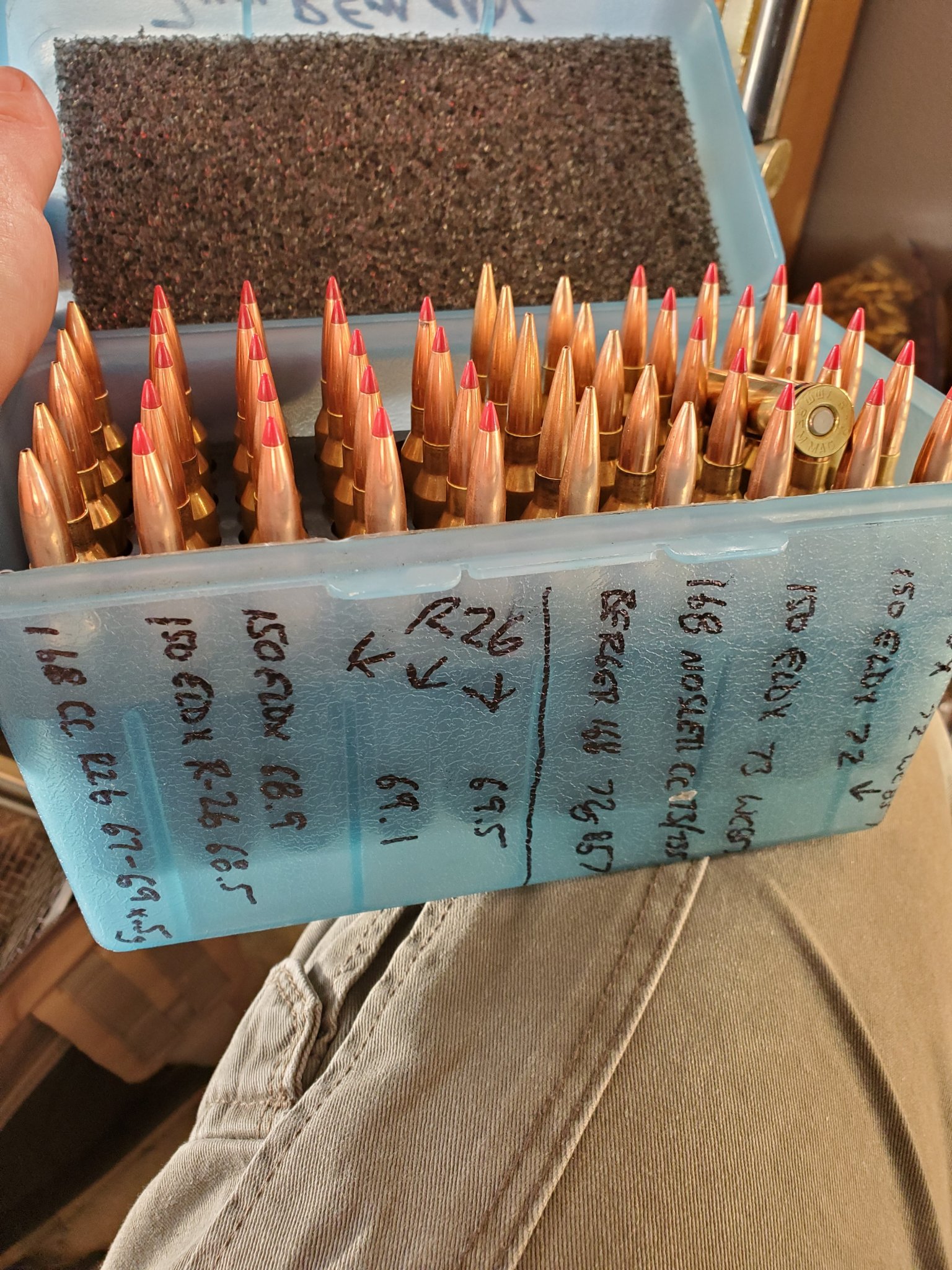

I am in your same boat. Today is the day..... I delve into my stash of Reloder 26..... 9 pounds.
Gonna blast a few 150 ELDx out of my 7mm RemMag with 68, 68.5, and 69 grains just to see where it is compared to Reloder 25 on the Hornady book..... since they dont have data for R26 ?

Did a quick ladder Thursday. One was excellent with great SD/ES.
Loaded 50 as I needed loads for a shooting trip Friday and today.
It was a laser at distance today and not having to crunch powder is awesome!!!!
I suppose it could have been... But I most certainly didn't use enough lube and it got stuck. This is once fired Lapua 6BR brass I fireformed into Dasher just jamming and shooting. So maybe that round didn't have enough of a jam and it stretched where it shouldn't have. But no issues with the other 599 cases I fireformed and resized. Couldn't notice anything on the inside of 20+ case walls when inspecting with a pick.

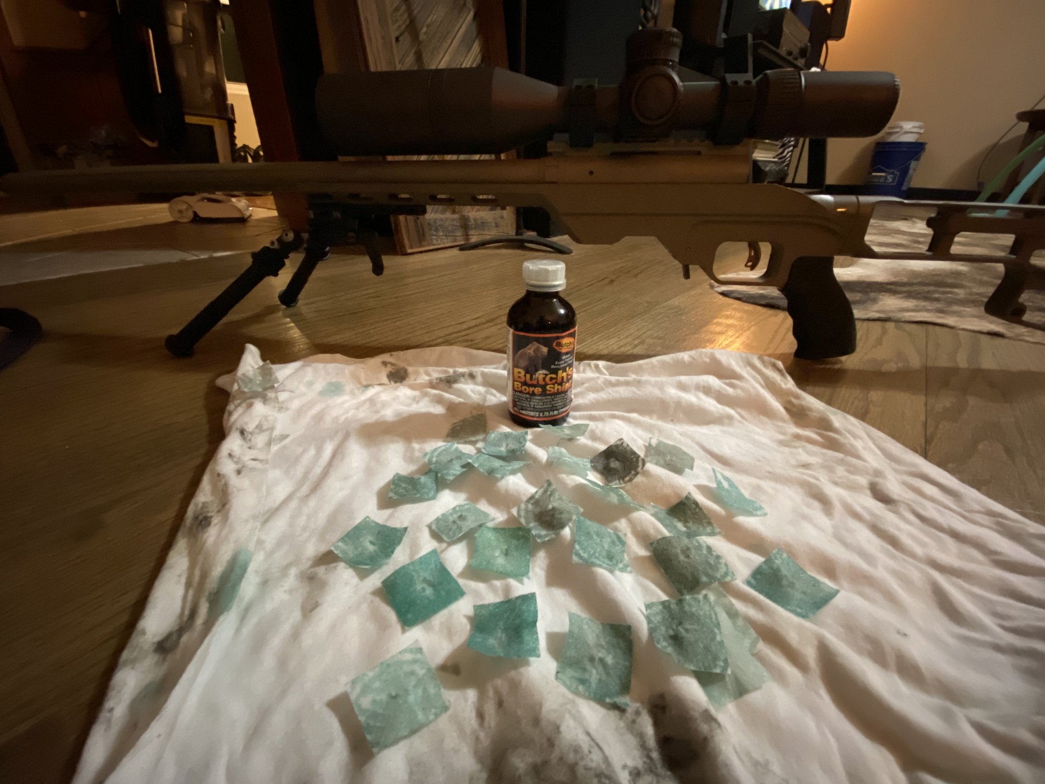

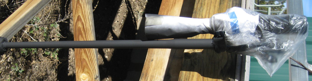

I shot a match last weekend and had a heck of a time seeing black-painted targets placed in the shade and shooting South with a bare stainless barrel made for a LOT of glare through my rinky dink scope with cut-rate glass. I took advantage of today's warm temperatures and calm conditions to rattlecan my barrel matte black. All that was on hand was some "grill paint." Oughta work if not I bet some solvent will take it off.
A little paper, tape and some plastic bags made short work of it.
How was it shooting? What caliber?
It was shooting great actually. Savage 12 LRP in 260 rem. 136gn Lapua Scenar over h4350. I could see all the oxidized copper in the barrel though.

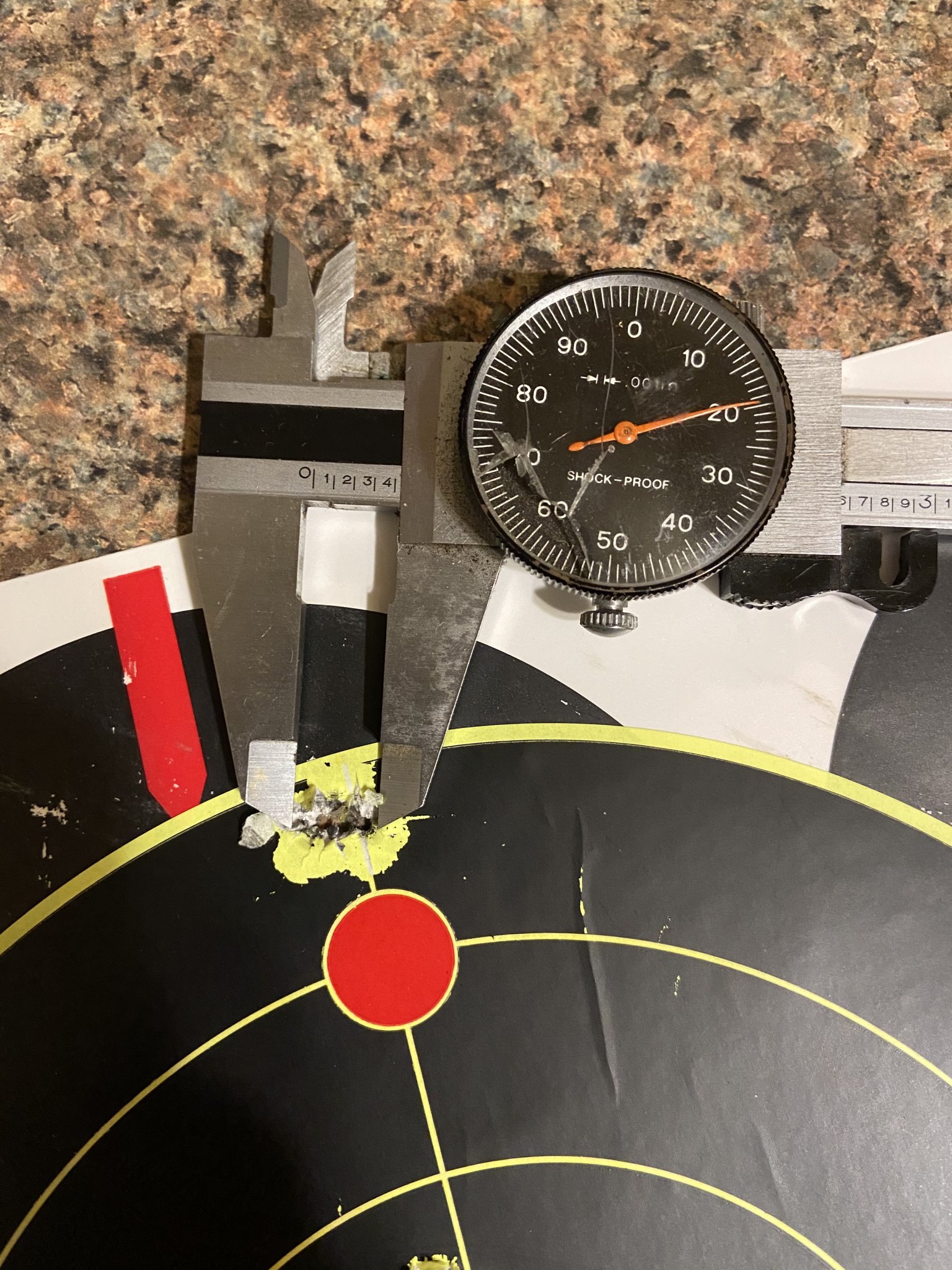

Shot this 5 shot group at 100 the trip before. .156” center to center
shot another group that was around .200
