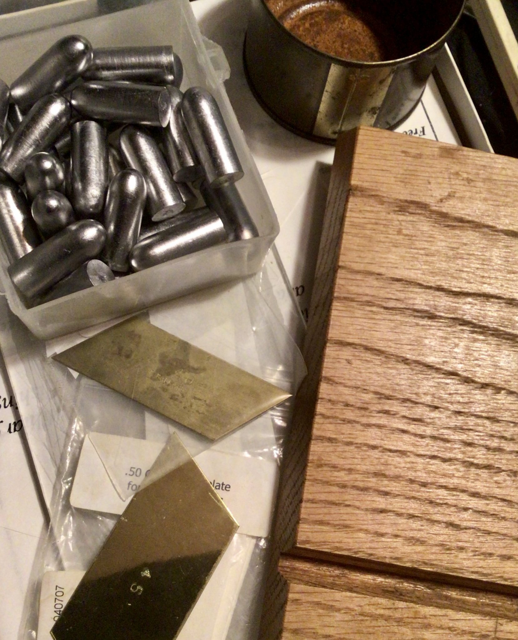

Went digging around to reassemble my paper patching gear which seems to have been scattered all over the house. It’s funny I mostly stopped shooting certain rifles because I grew weary of doing it, and now I’m looking to do it for other rifles stupid stupid.

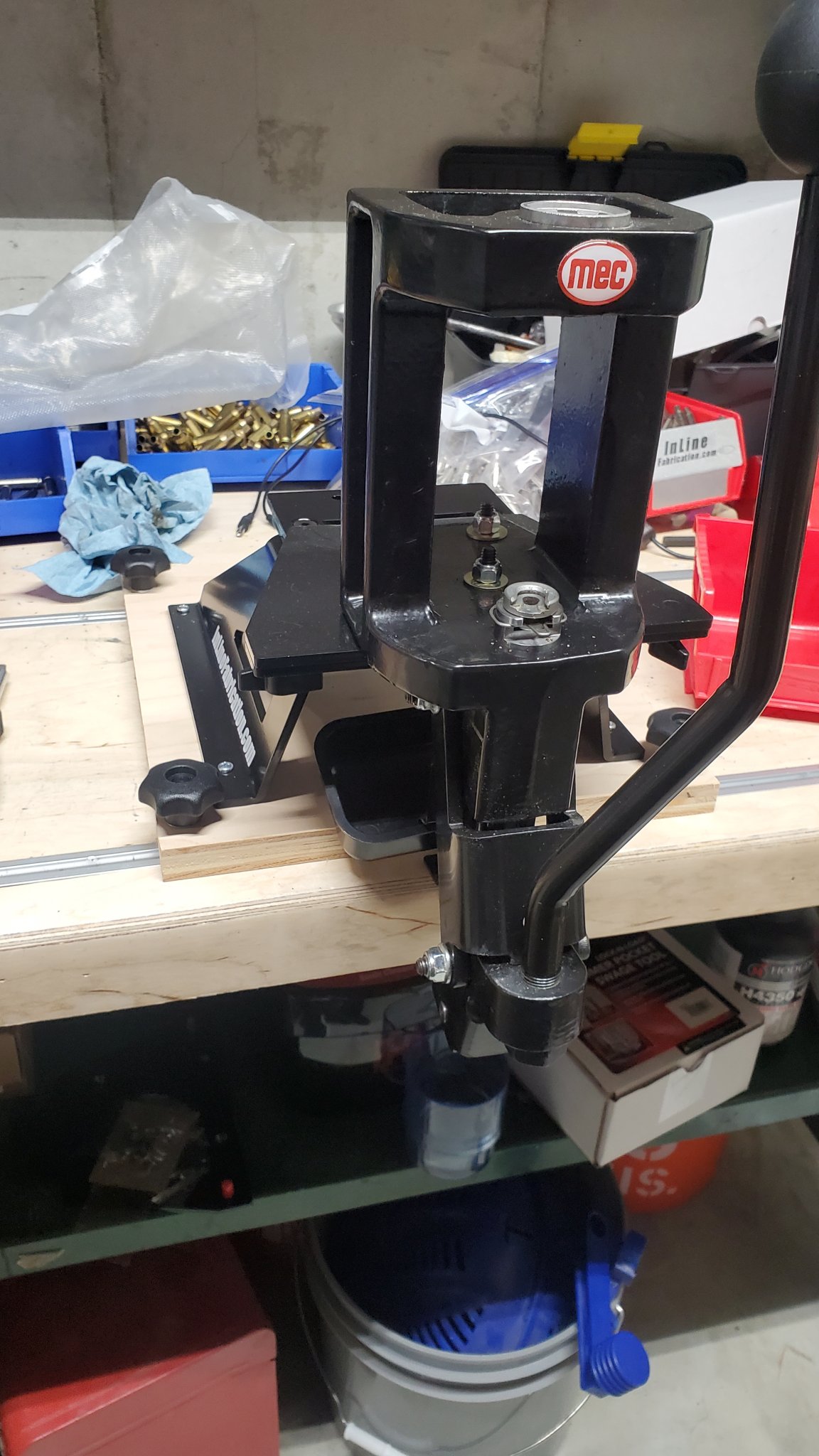

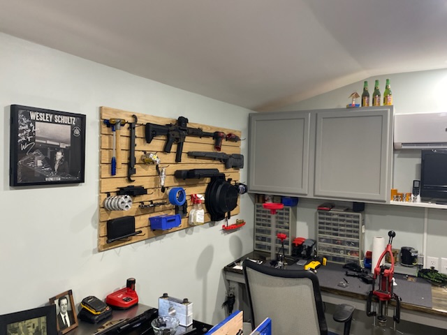

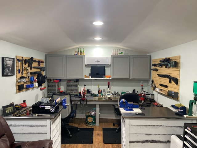

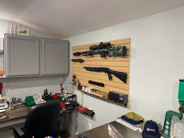

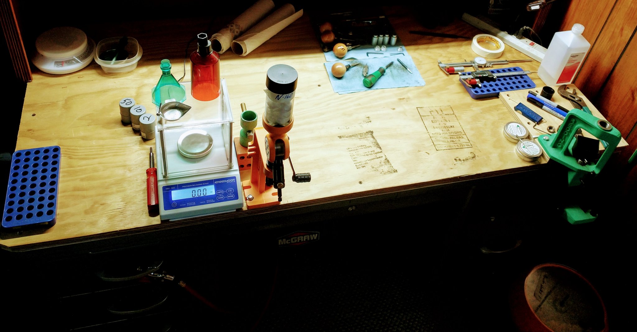

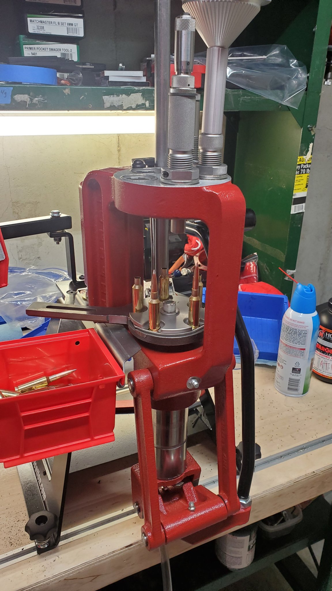

Last year I resurfaced my bench with some really nice 1/4" ply I had laying around. Routered some grooves and installed T-tracks for an Inline Fabrication mount. I've been using the tall and when I want to stand to reload its great. But sometimes I want to sit and it was a bit too tall. I recently got a short Inline Fabrication mount. To use my t-tracks I had to mount to a piece of plywood. I really love the Inline Fab set up and being able to use different presses and other tools- I have one for my barrel vise and now a bench vise.

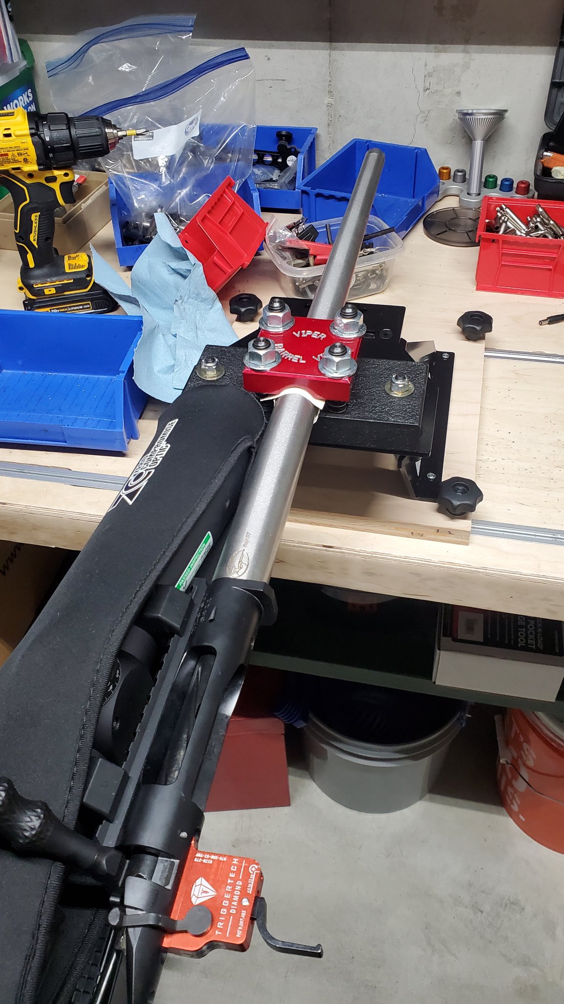

So today I pulled my AP press off, swapped 6GT barrels, and resized a few pieces of brass on my single stage MEC, all in about 20 minutes.
Here are some pics of the set up.

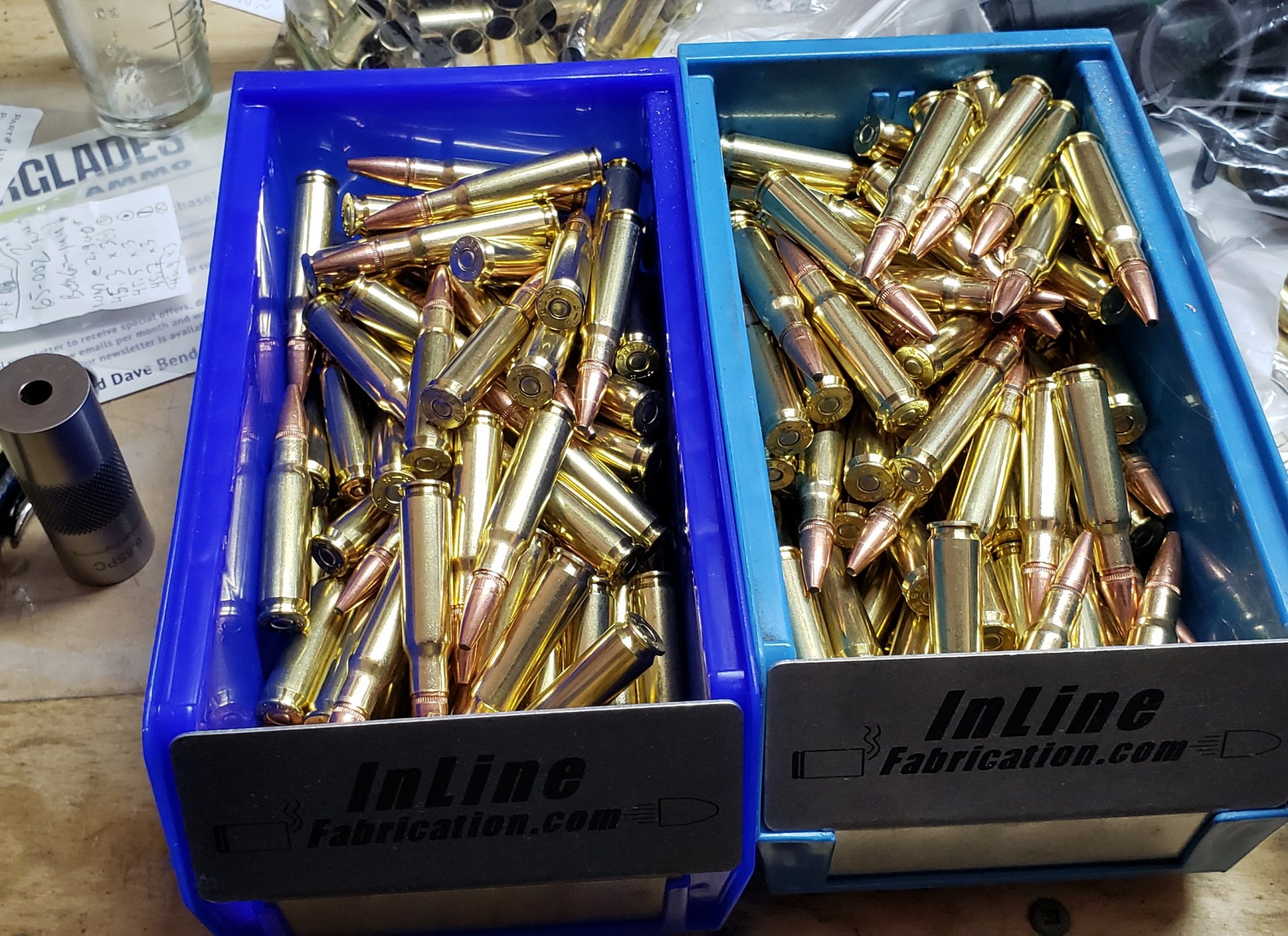

Just finishing up some prep on some Federal .308 brass... Going to load until I use up the last of this pound of powder.
Weather is supposed to be downright decent tomorrow... Mid 60's, tolerable wind... Plan to try out to 600.
Wish me luck.

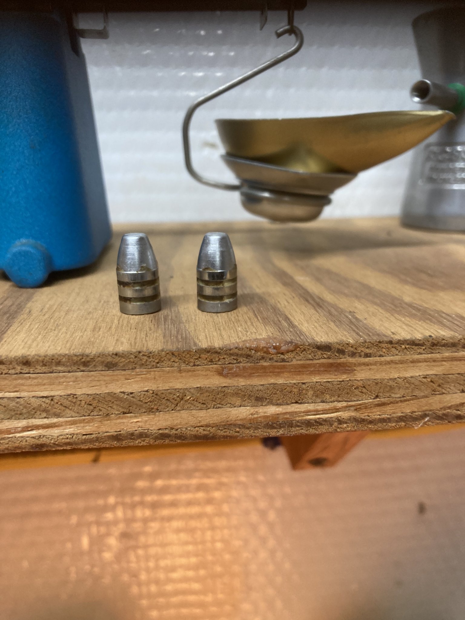

Friday I spent the afternoon casting light .45 Colt bullets and 147 grain .355 bullets. My .355 mold (for 9MM) drops bullets in the .357 range. So, I can and do load them for .38 special loads. I have a heavy Kieth mold for .357 and really like those bullets, they are a bit overkill for plinking. So, the 147’s work great, save lead. Tomorrow if the rain moves in I will head back to the shop and lube and size them.

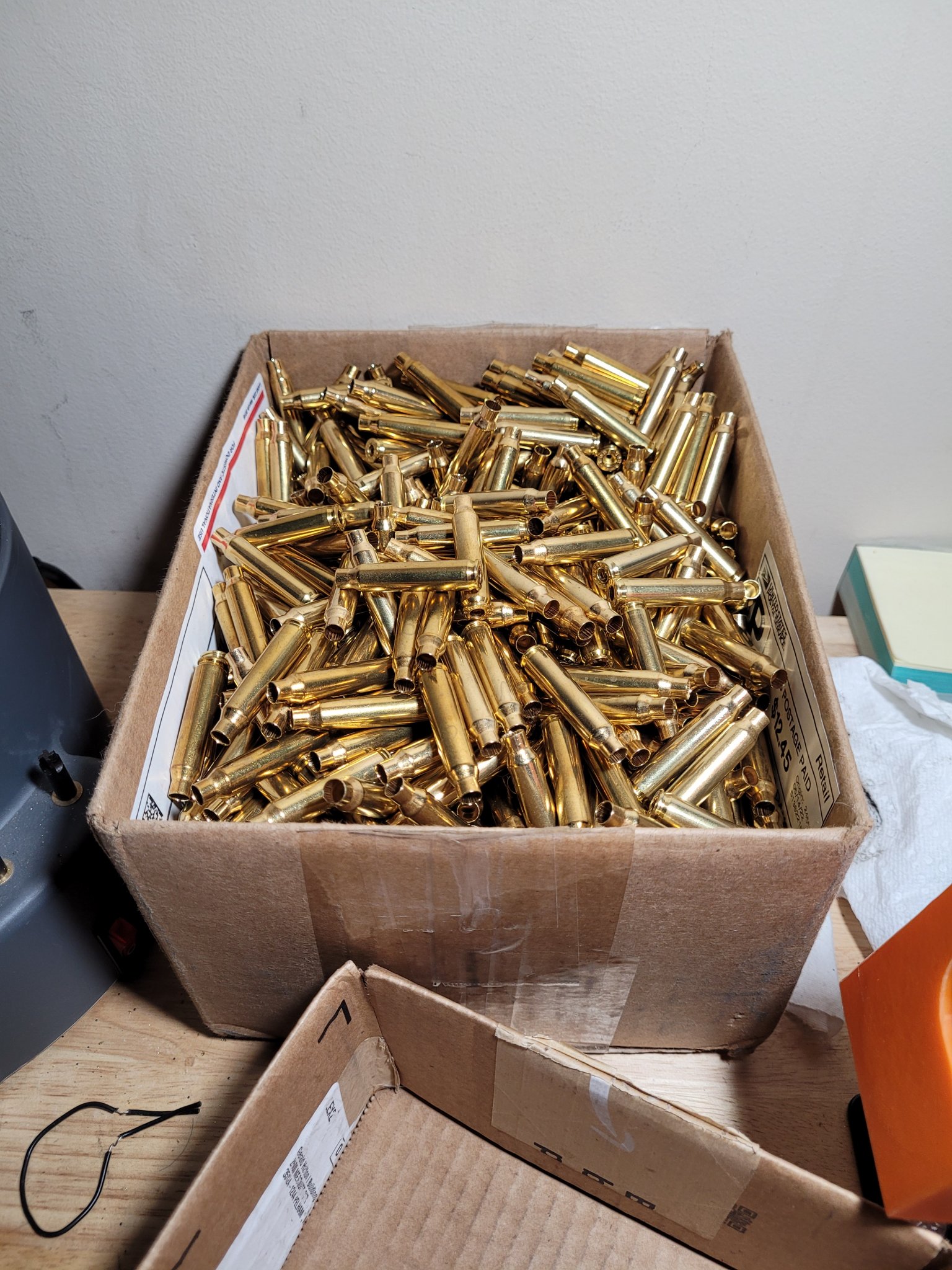

Yesterday I stared at the bags of brass we picked up from the last few range trips. I’m avoiding sorting it all, but will likely do that today so I can run a few batches in the tumbler. Three of my kids shoot with me, so range trips are extremely labor intensive.
