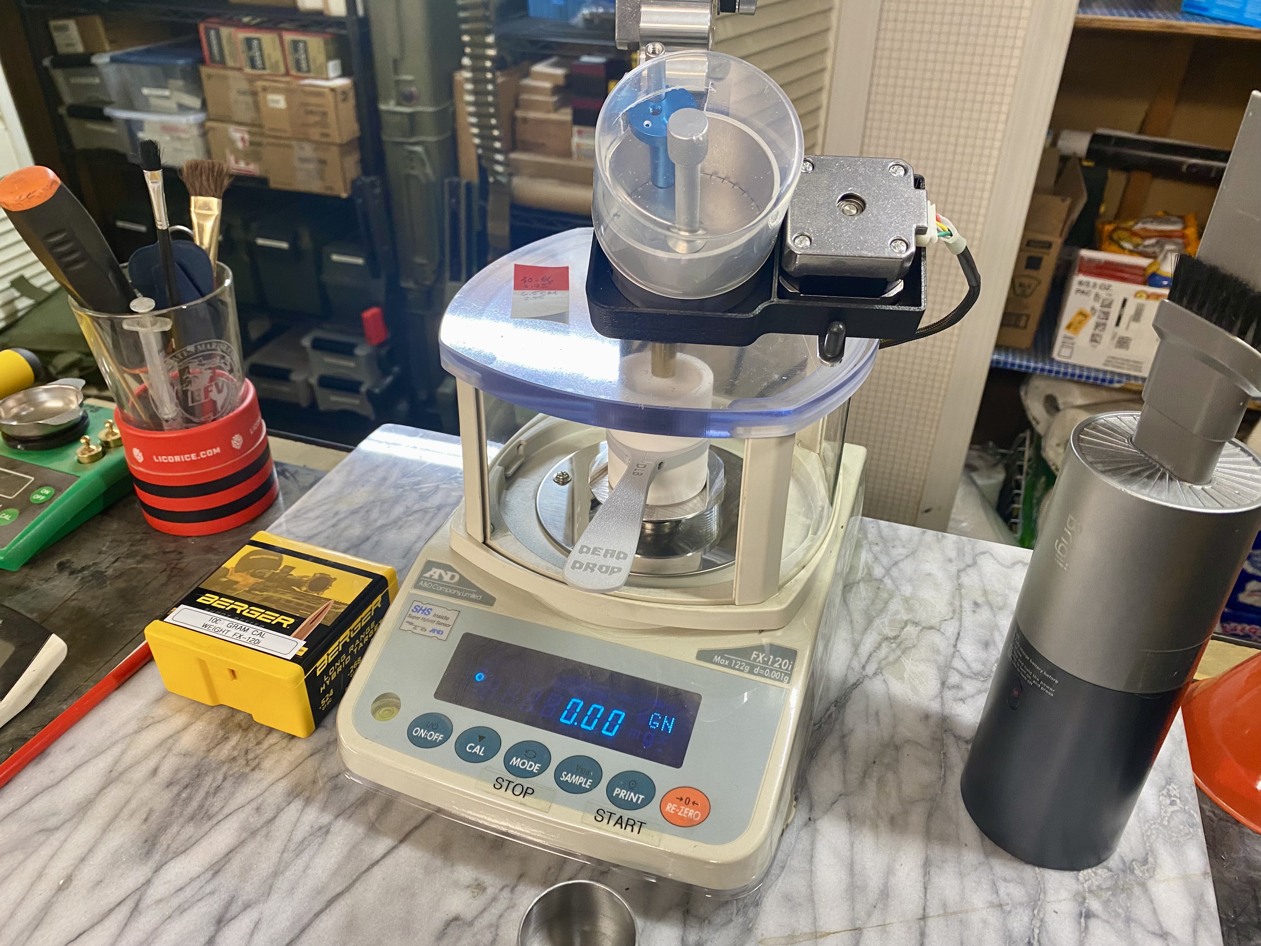

Ask him what he'd charge to do another. I'm struggling with my 120 being very fussy where I put my 419 cup. After about 60 throws it starts to have issues.
I was having similar problems last winter.

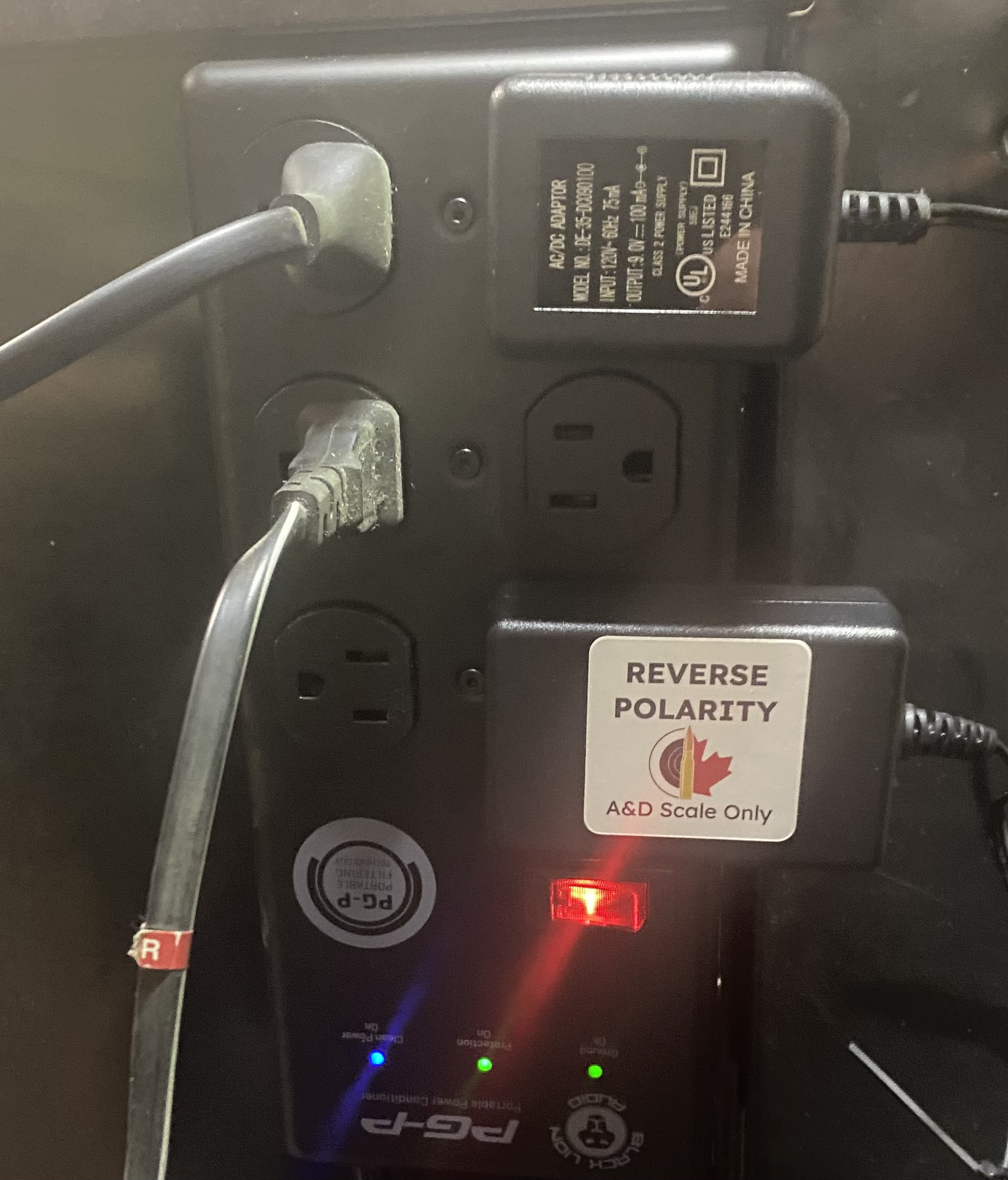

This set up started out as a V2 AutoTrickler, as evidenced by the Stop/Start labels that I put on the scale cover back in 2019. This was before the V3 Bluetooth upgrade that came later.
Anyhow, to make a long story even longer, last fall my scale started acting weird once in awhile, usually in the middle of a long session that involved more than fifty charges being thrown.
It would begin to refuse to go back to zero between throws occasionally. Not plus or minus .02, but sometimes as much as .04 or .06 off of zero.
I’d stop the target weight, make sure there wasn’t powder where it shouldn’t be, fiddle around with the cup, re zero the scale and calibrate it.
Things would return to normal until the next hiccup. Eventually it began to happen more frequently.
I emailed Adam and went back and forth with him and Laura and we decided my power transformer was going bad, as evidenced by the craziness mid session and subsequent return to normal after screwing around with it for 10 minutes or so, allowing the transformer to cool off.
While I waited for the new transformer to get here from Canada, Laura suggested I try the transformer that originally came with the scale and it worked.
They also said they’d recently changed vendors for the transformers.
The original AFX transformer worked well enough until I got my official new vendor transformer from Canada.
You might want to try a transformer.
You’ll get it faster from C&E.

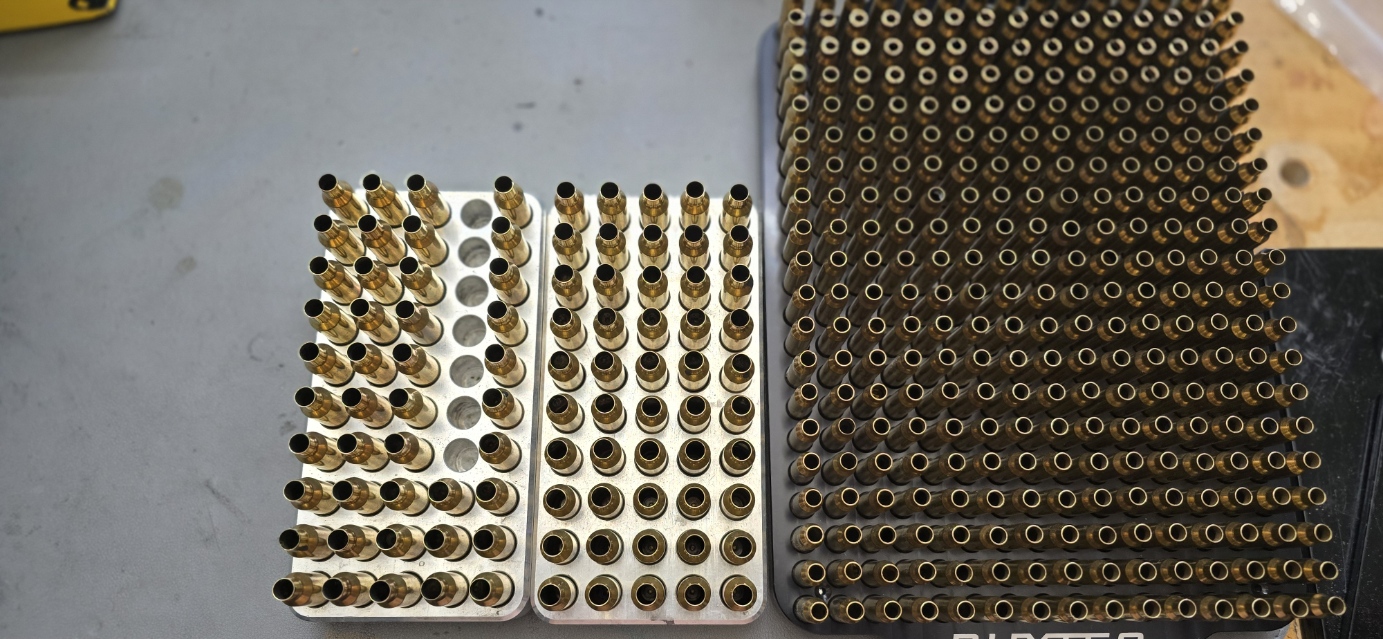

Decapped and sized a 100 223 lapua cases on my RCBS single stage press. Hopefully get them primed, powder, and bullet today. Debating on going with my 75g ELDMs or work up a new load with the 80.5g Bergers and N540 from the 28" Bartlein.

After work and supper, went in and turned on the A&D to let it warm up for 30 min. before charging some cases for tomorrow. Went back and collapsed in the recliner in front of the TV while I waited. Promptly fell asleep. Two hours later I woke up, went back in and turned the scale off and went to bed. Good night, folks...zzzz.

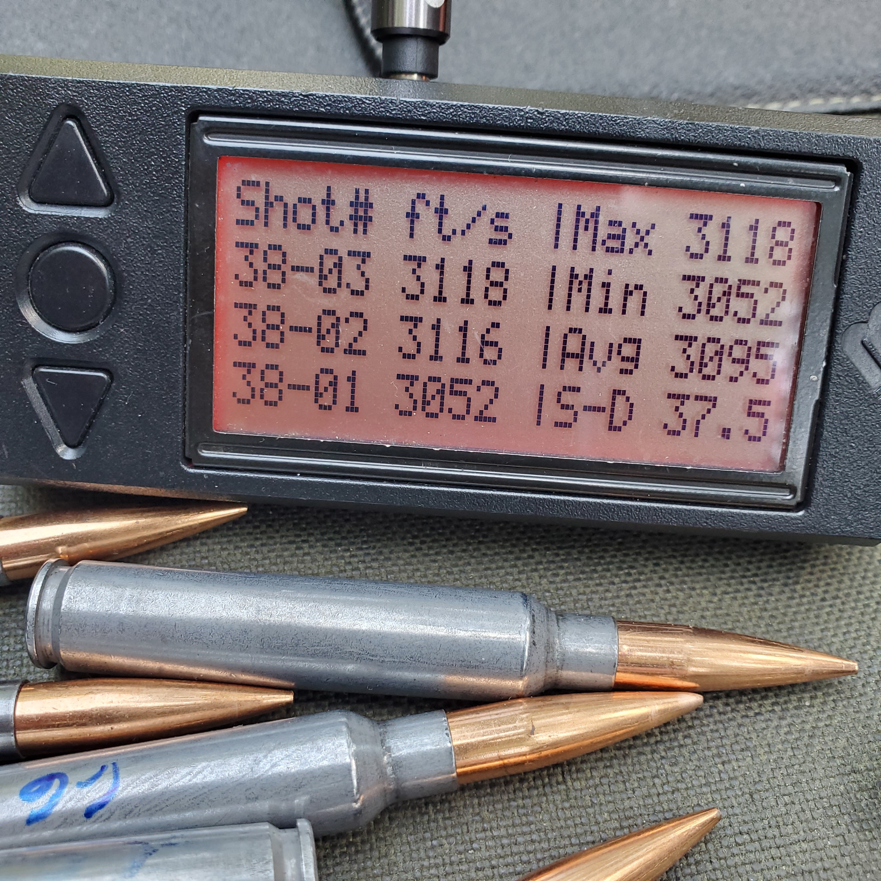

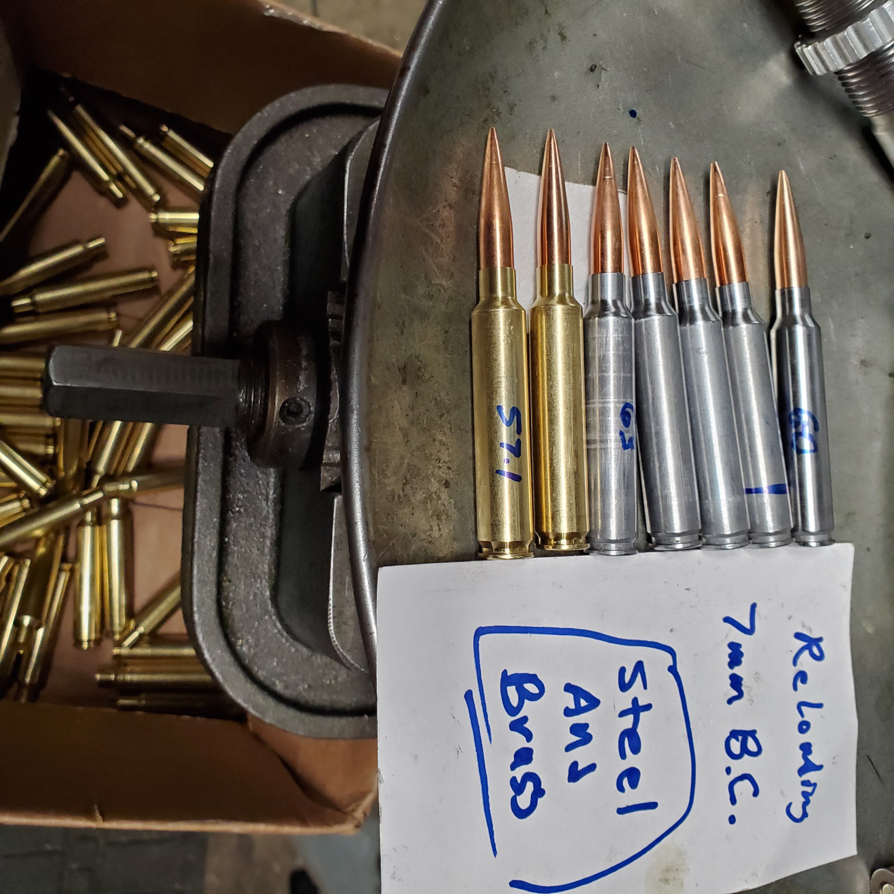

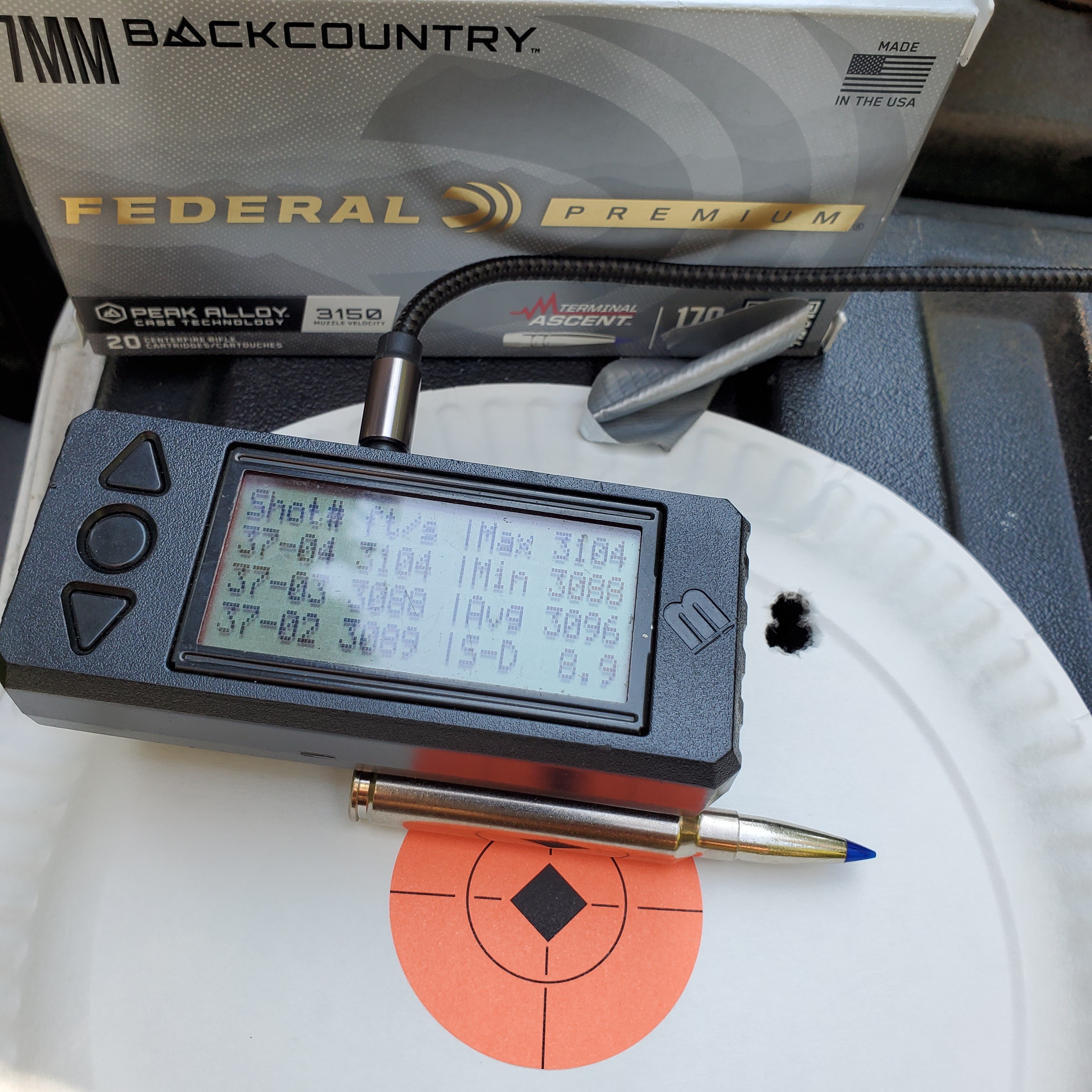

Reloading the 7mm Backcountry with steel cases and 80,000 psi.
And yesterday made 7mm Backcountry brass cases to load to 60-65k.
This is the 197 SMK ...see if it stabilizes in an 8 twist.
2nd loading on steel cases, first loading on the newly formed brass cases.
The 180 gr 7mm Berger reached 3118 fps in the 6 lb 20" rifle,...at 93° and 2000 ft elevation...that would be a flat trajectory.
The 7mm BC is the real deal ...high velocity in short light rifles, especially designed suppressor hunting.
Should be great for hunting for those who like that type of platform .
It Will shoot faster than most any factory cartridge in the 20" barrels ...if you are interested in that sort of thing.

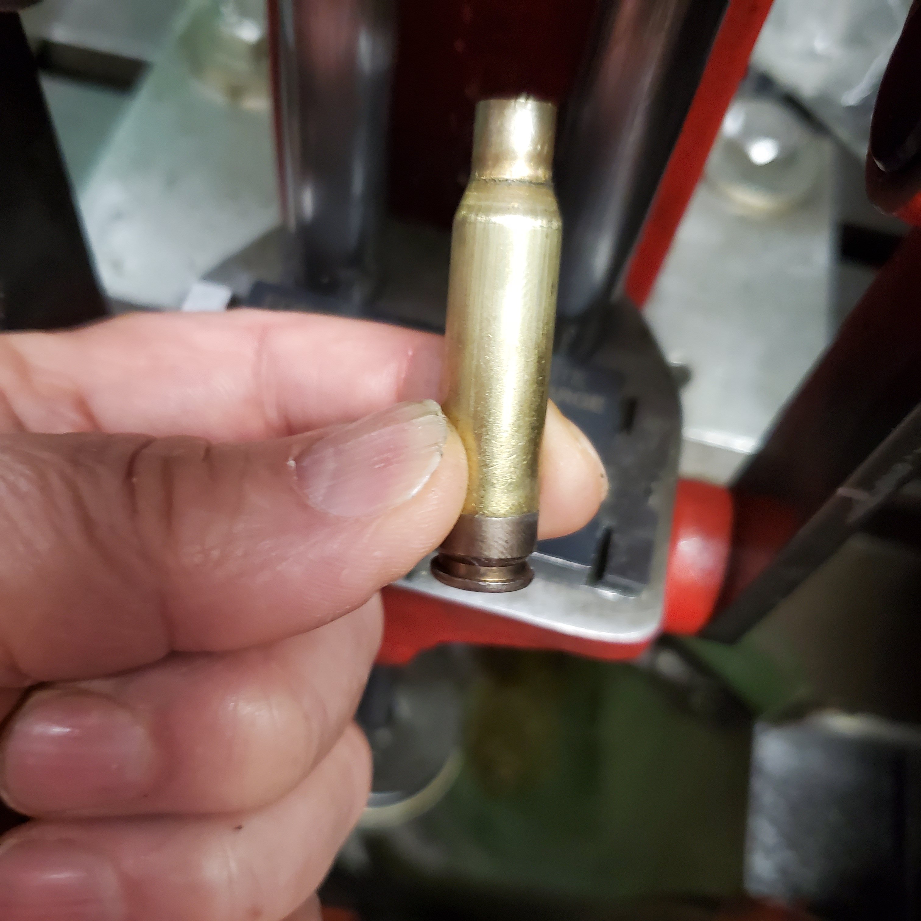

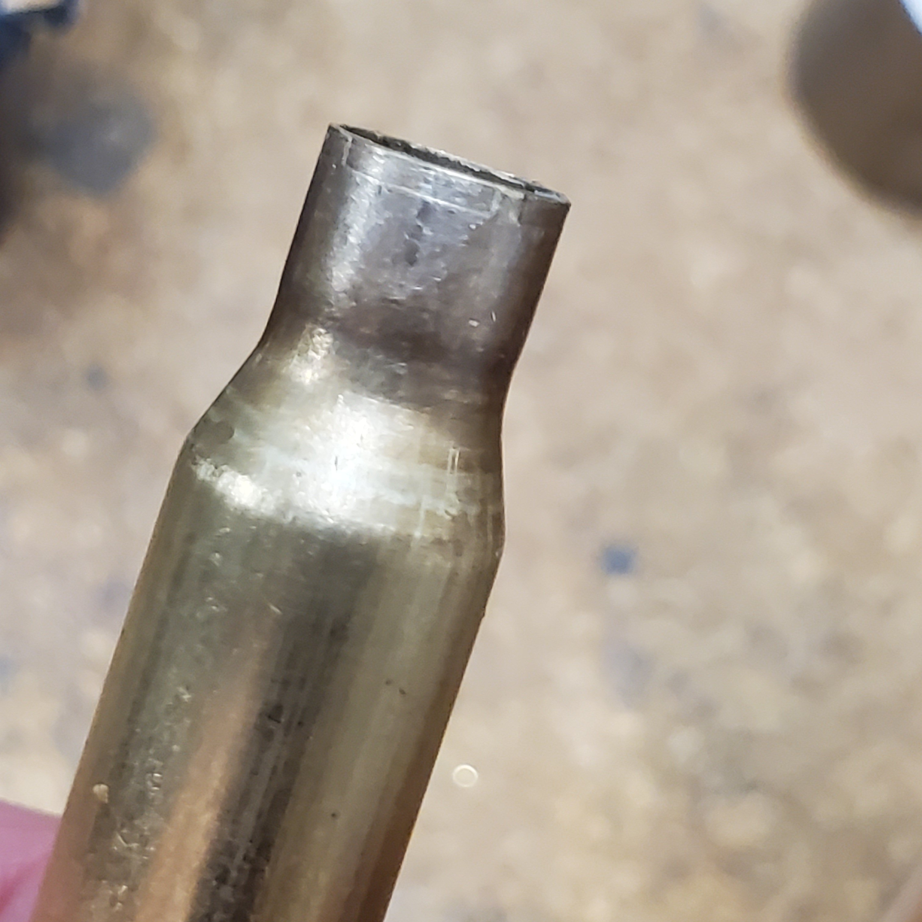

After my first firing this little batch of SIG 277 Hybrids, I wasn't sure what to expect on this second sizing. . .especially as most were fired pretty close to 80K psi. I noticed that it took more than normal effort to seat the case into the sizing die, even though there was plenty of lube. It felt like it was doing a lot of sizing, therefore I measured at the web area and it was at .470 before sizing and .468 afterwards. At the shoulder-body junction the die was reducing it there by .004". Normally for my fired Lapua and Alpha cases, the web area is at .470 and when sized reduces to .469 (maybe the high pressure is reducing the amount of springback on the hybrid cases???).
The unusual effort to size the cases apparently resulted in actually lengthening the cases headspace by ~.005" and it being inconsistent on the first pass. Running the case through the die a second time was naturally easier and it then reduced the headspace to where it should be. I've never experienced that before and don't know why that occurred as I wouldn't think the headspace could just go further than what the die has been set to . . .🤷‍♂️ :confused:
The necks were originally at .014" in thickness with some variances that went a little below .013" thick. Like I do for all my brass, I therefore turned the necks to a uniform them to .013" thickness.
On my Webster Hardness Tester, I got a reading after firing of 17. Virgin Lapua brass reads at 15. In order to get to that reading of 15 I have to anneal the brass to a hardness reading of 13. After sizing and expanding the neck with expander mandrel proper sizes, the final reading I got was at my target number, which is that reading I get with virgin Lapua brass of 15.
Now I'll see how they do in my second firing.
Reactions: brianf
The 7mm BC cases are different because they are not hybrid cases.
You have to make your own dies for 7mm BC.
The first part or sizing is easy just neck size,slight shoulder touch and load. Shoot.
The next time the body die was employed. Its a bit tighter than needed, but I am concerned about spring back after several firings...if they stay put in the body I can polish out .001" on the shoulder...to make it easier. But I've already had to reduce the neck dia because of spring back.

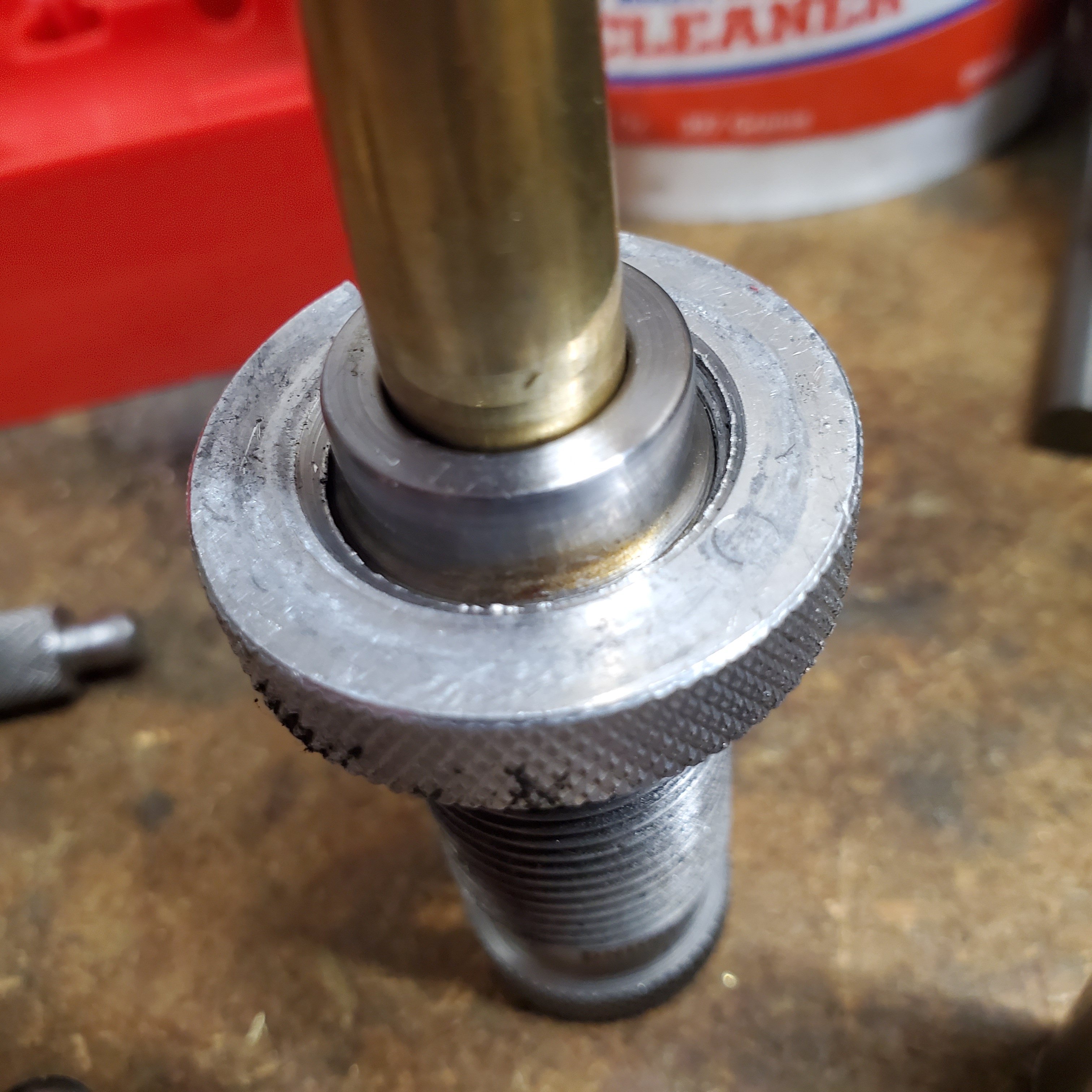

You shouldn't have to size the steel portion of the case...except where its real thin and is joined to the btass.
No solid head is ever sized, it's supposed to be undersized here and just falls into the die..as shown with the hybrid case head falling almost completely into the die.
Same with the 7mm BC fired steel case goes even farther into the die, no sizing is done here on any case.
If so your case head has expanded under extreme pressure and primers will fall out.
These cases will take 100k and brass maybe 70 k+ before that happens depending on the brass hardness.
You should anneal the neck shoulder area to get the hybrid case to not spring back when FL sizing...same as brass because that portion is.
Hybrid cases lengthen on the first firing maybe .015" and need to be trimmed back.
The joint flattens out under pressure lengthening the case.
I always skim neck turn into the shoulder.

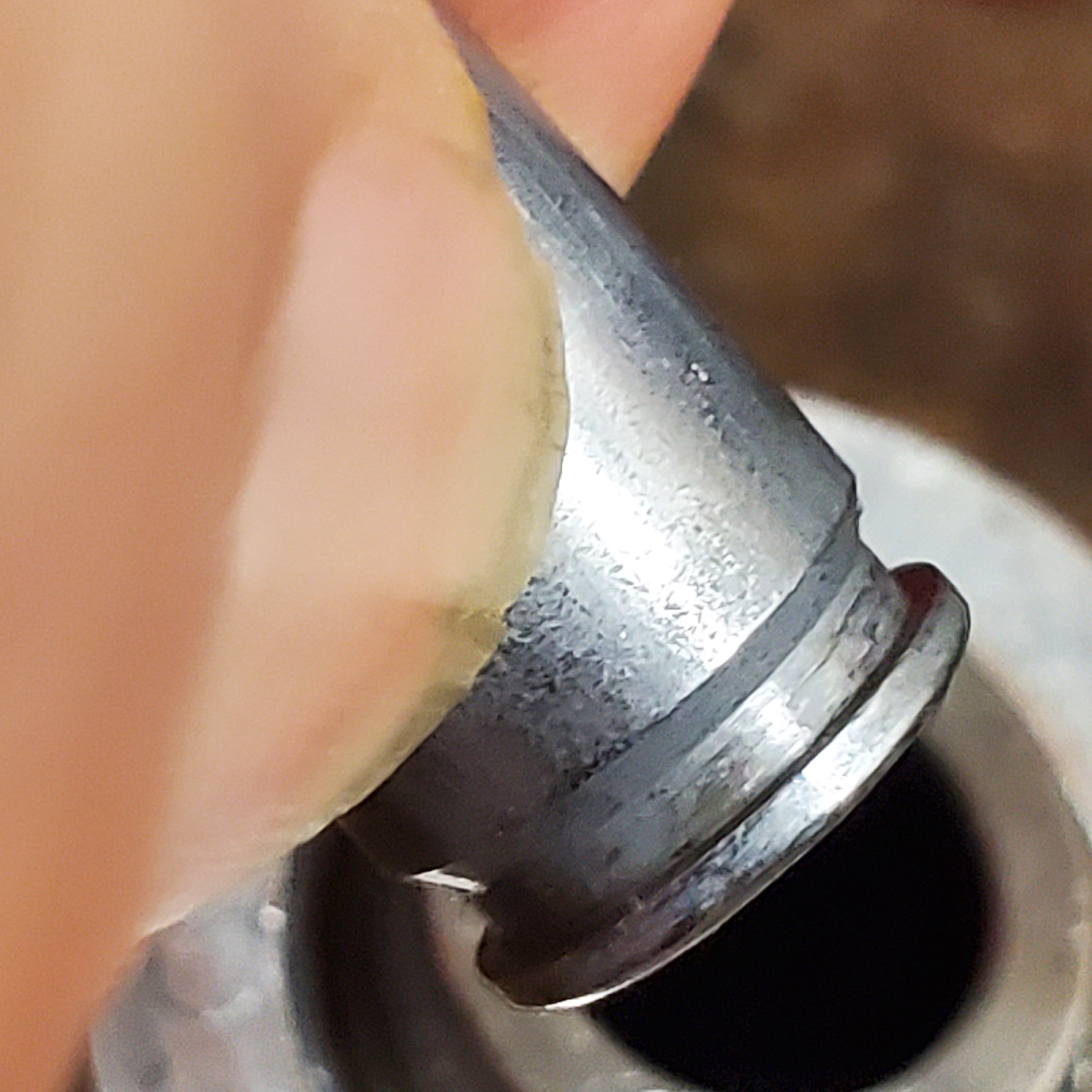

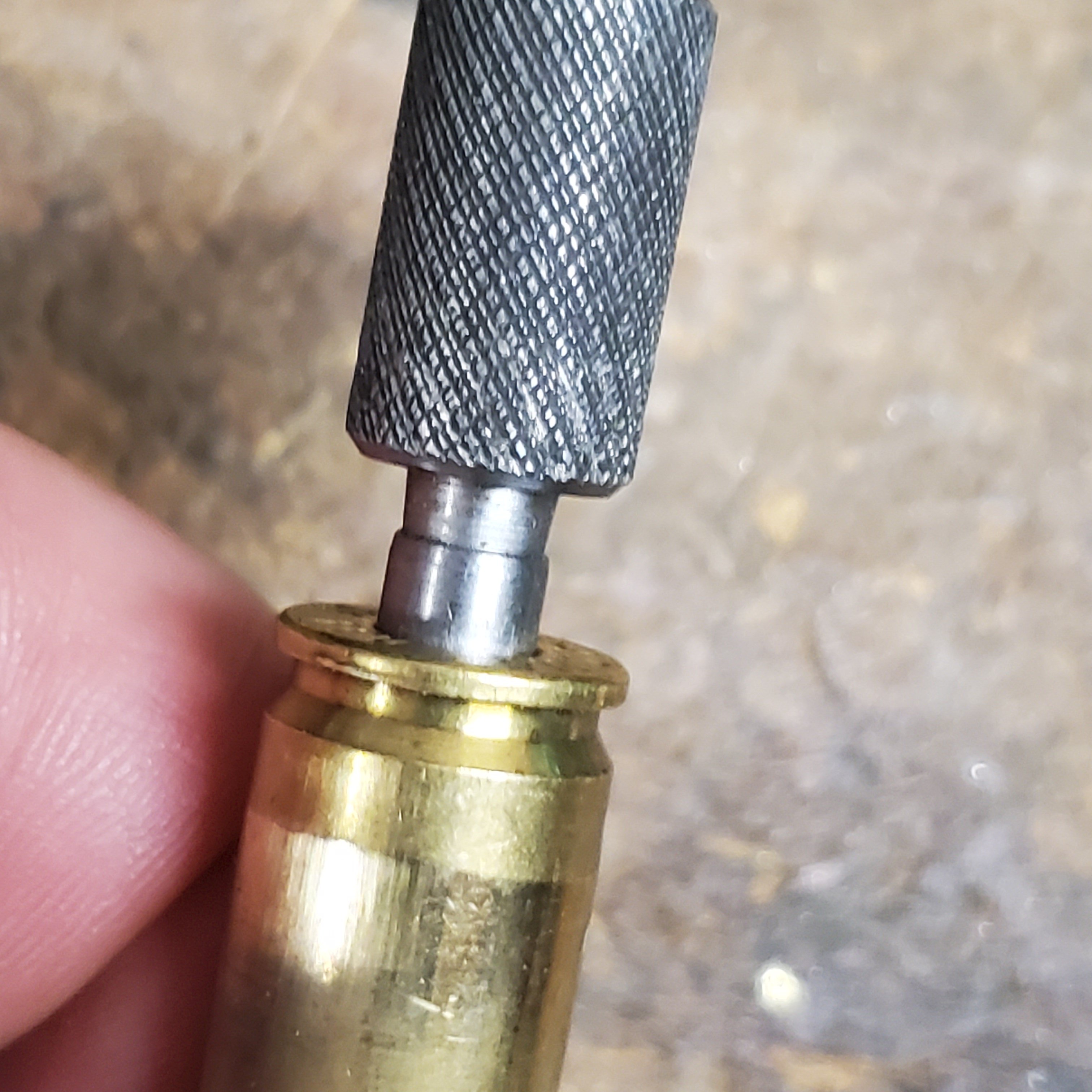

Found a brass case thats had too much pressure you can see the bluge in the brass after sizing...and the no go starts into the primer pocket.
But some of the solid head still enters the die, when the case is inverted, as you can see. But the primer pocket is pretty much trashed.

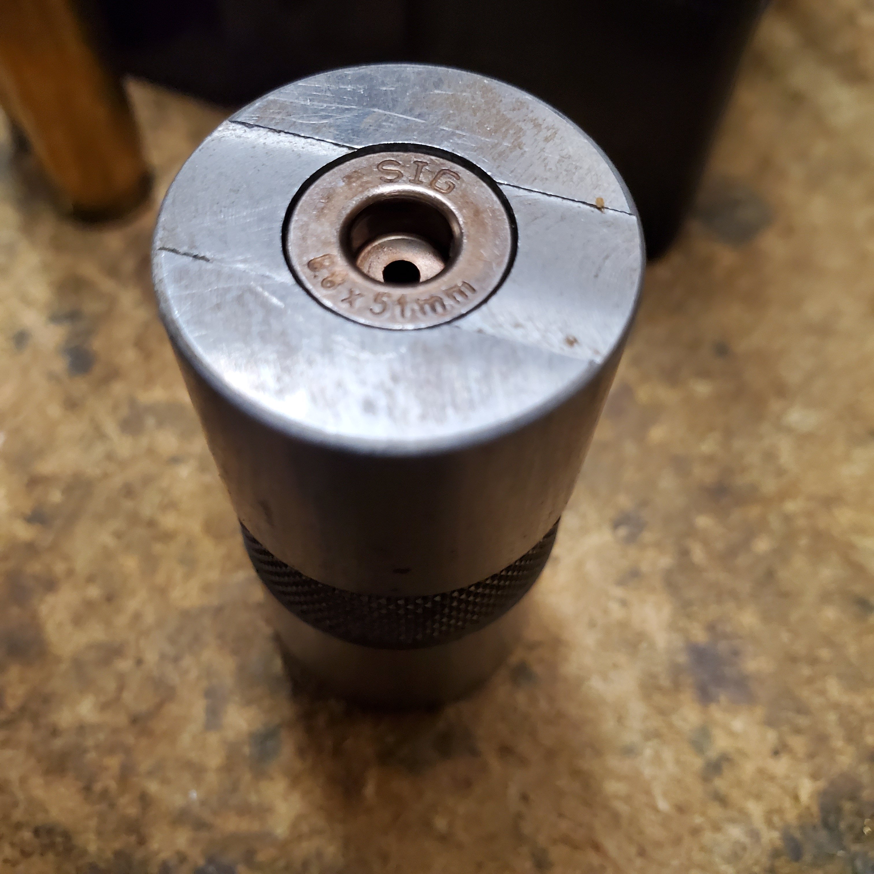

Spent a few hours re-sizing 277 fury to 308 win.
Should not be that difficult for 308 conversation.
I just went out and did one.
Grab a 6.8x51 hybrid case.
Mandrel up to 30 cal.
Lube and run through 308 die.
Check results in gauge
Clean and polish...
But I would neck turn, anneal, and resize the clean brass.

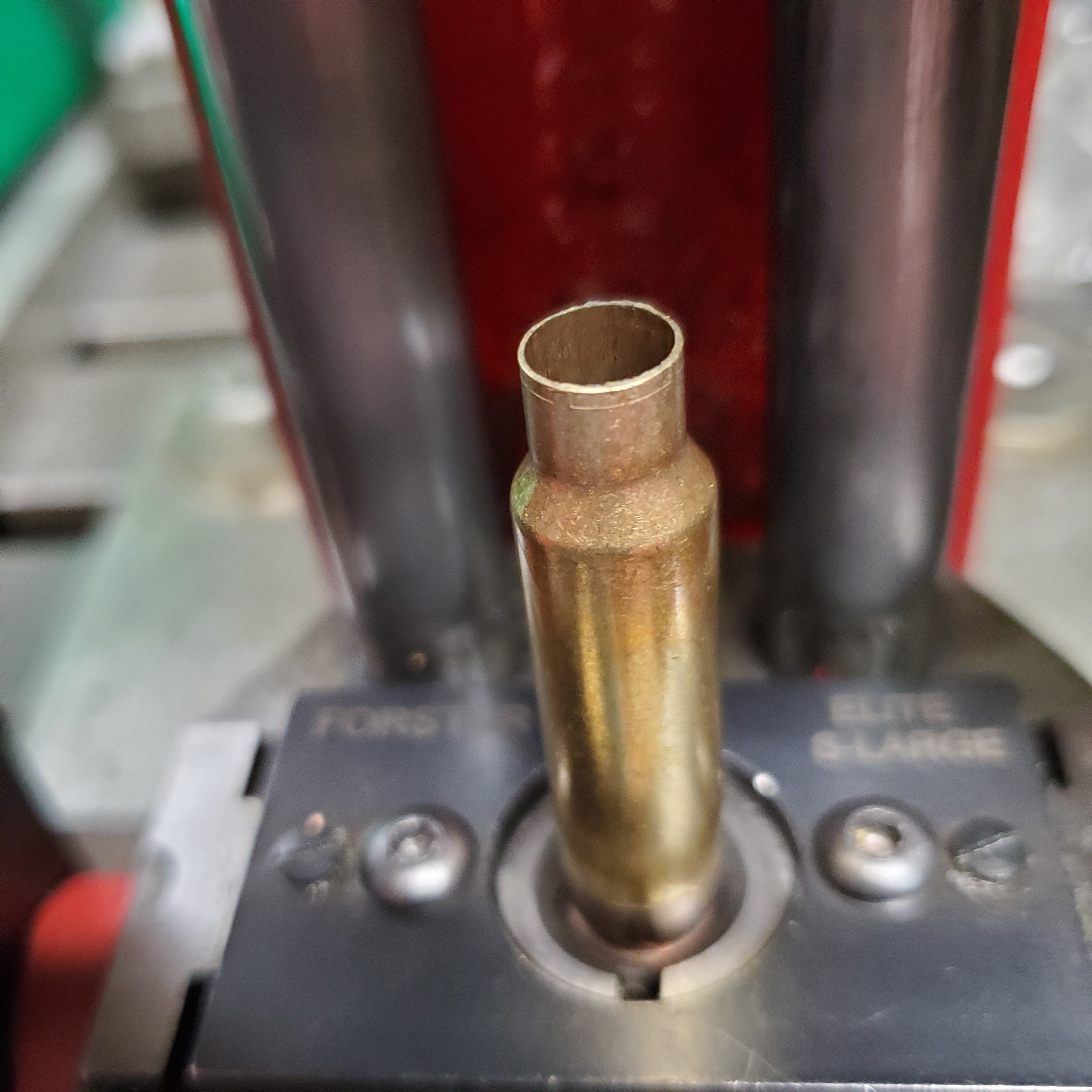

Clean and polish...
Yeah, it required more turns on the resizing die than I expected. I got it sorted and loaded a few to try today.
Holds 54.8 grains of h2o
Thank ya

They are 277 Fury brass converted to 308 Win. So its a Sig headstsmp
Which SIG 277 headstamp is on it? There are different ones that have different case volumes. That's why I was asking.
Like I have some stamped with "277 SIG FURY" that have a case capacity of 57.7 grs H2O. Another batch I have is just stamped with "SIG 23" having 56.8 grs of capacity and some just stamped "SIG 24" having 56.3 grs of capacity. The 54.8 you state sounds really low from all the other's I've heard about, making me curious as to what the head stamp is.
Reactions: 45-90
Like I have some stamped with "277 SIG FURY" that have a case capacity of 57.7 grs H2O. Another batch I have is just stamped with "SIG 23" having 56.8 grs of capacity and some just stamped "SIG 24" having 56.3 grs of capacity. The 54.8 to state sounds really low from all the other's I've heard about, making me curious as to what the head stamp is.
I will have to check. I am not sure.
My early sig 6.8x51 fired hybrid cases will have about 58 grs of H2O. So the 57.7 to 58 gr capacity for some of these head stamps seems about right ....but it appears others like LC are making hybrid cases now.
Bottom line when sharing load information on handloading, this is a big deal with this much variation in case capacity...and it must be considered when loading these cases...check case capacity, and load down with lesser capacity cases.
Formed 350 pcs of the first ever in the world "Brass cases" for the 7mm BC cartridge. And used the first home built dies to do it.
So I can resize steel cases for 80,000 psi or Brass cases at 65,000 psi max.
Giving the option of more moderate loadings.
This is turning out to be a fun and accurate cartridge, in a 6 lb rifle with 20" barrel.
There is no industry reloading support for it at this time. Slow bringing it to market.
I’m not criticizing you for the work you’re putting in but isn’t a brass-cased 7 BC essentially a 280ai?
Reactions: 45-90

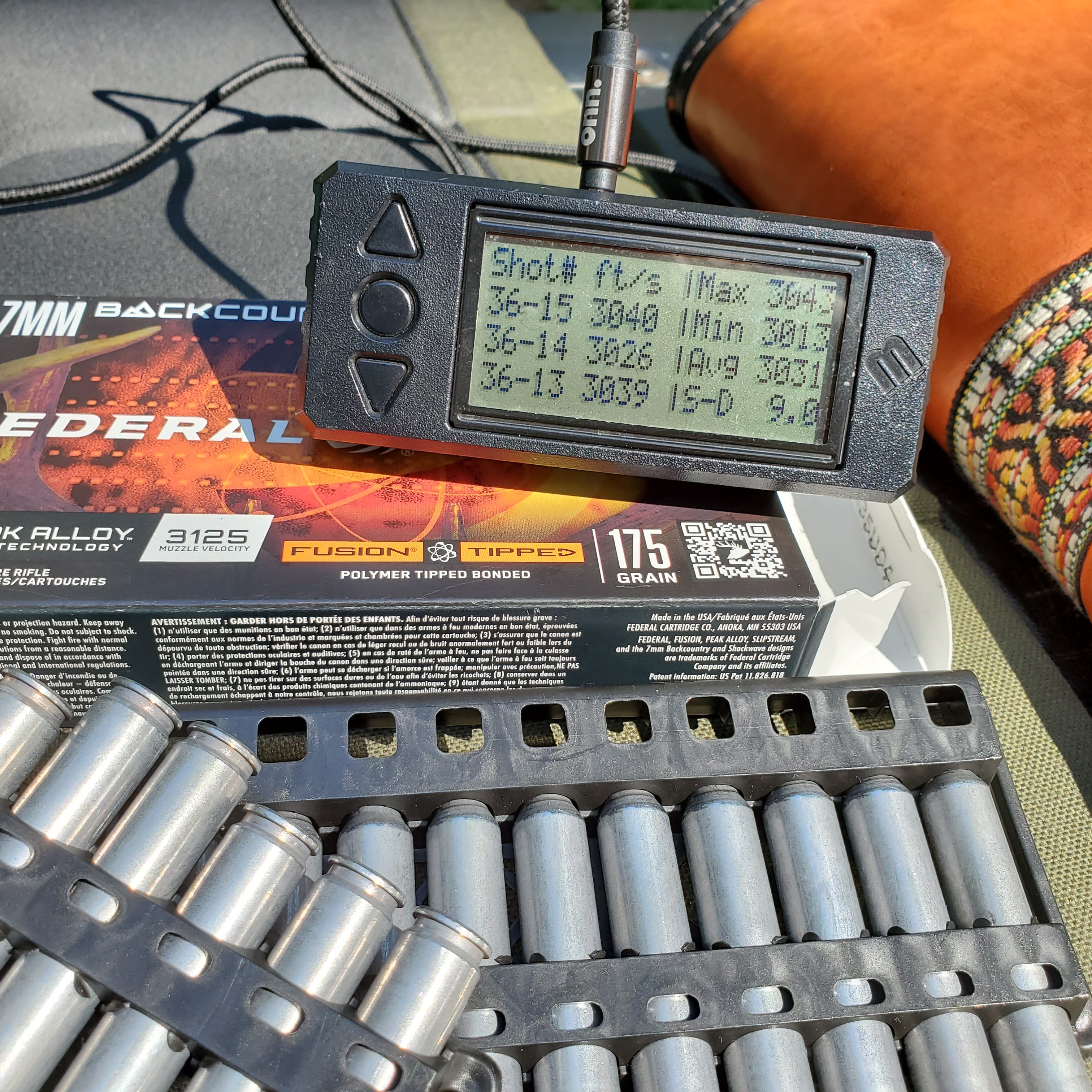

For me the 7 BC is a much Better than a 7 PRC.
I can buy factory rounds for the same price that are much faster than a 7 PRC in the same barrel length or even their longer barrels...utilizing a short barrel with much better ballistics then the 7 PRC.
I can reload those steel cases too.
...reloaded 3 cycles on the steel 180s at 3000 to 3100 fps in a 20" barrel.
And I can run it in brass ....accurately with subs! Or low velocity supers for light loads.
Or 180 gr ELDM at 2833 fps in brass, with Mag Pro fireforming case's...about the same as a 20" barreled 7PRC...
I saw them shooting factory 7 PRC rds chronographed at about the same speed as my brass cases fire forming loads in 7 BC in a 20" barrel.
The longer barreled 7 PRC generated 2875 fps ave with a large velocity spreads down to 2850 fps over their 3 shots.
42 fps difference between the brass cased 7mms with my fire forming hand loads and a shorter barrel with the same bullet...
Enter the steel cases the 7 mm BC is like a real magnum compared to the slow 7 mm PRC factory loads.
The 7BC is much more versitle...
True magnum performance in s 20" barrel,
180 gr match bullets at 3100 fps in a 20" barrel that can not be done by a 7 PRC...
I doubt a 28 Nosler will do that in a 20" barrel.
Factory ammo is excellent in my rifle, low S/Ds and tiny groups... first 3 into .166" at 3100 fps.
No 20" 7 PRC can keep up with factory ammo. Just the facts.
And the 7 BC is great with handloads.
3118 fps with 180 gr Berger match bullets 20" barrel...or a fire forming 180 gr brass load that turned in an .054" 3 shot group.
This barrel loves 180 gr match bullets, in brass or steel cases.
Not the 7mm PRC isn't any good, but it's performance doesn't live up to expectations, especially in factory loads.
Where there is a huge performance gap.
Cut your 7 PRC to 20 inch barrels and chronograph the 175 to 180 gr loads and compare to the 7mm BC factory loads to your 7mm PRC factory loads...it's huge.
The 7 BC was designed as a hunting cartridge with hunting bullets in short light platforms...and IMO it is very successful.
Most hunters don't reload but it would be nice if they had the dies ready for those who want to reload.
From 120 gr Barnes tipped at over 3600 fps to 197 gr SMK at 2940 fps from a 6 lb carbon fiber rifle with a 20" barrel.
I built my own dies and have printed load data on this site for those interested.
