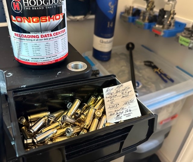

10mm I forgot to post a couple days ago. Set up the 550 for these two months back and finally got around to test fire the load. Worked well so I jammed out 250 of these. Gonna run some Missouri bullet 200gr next with Longshot (fav best mm powder).

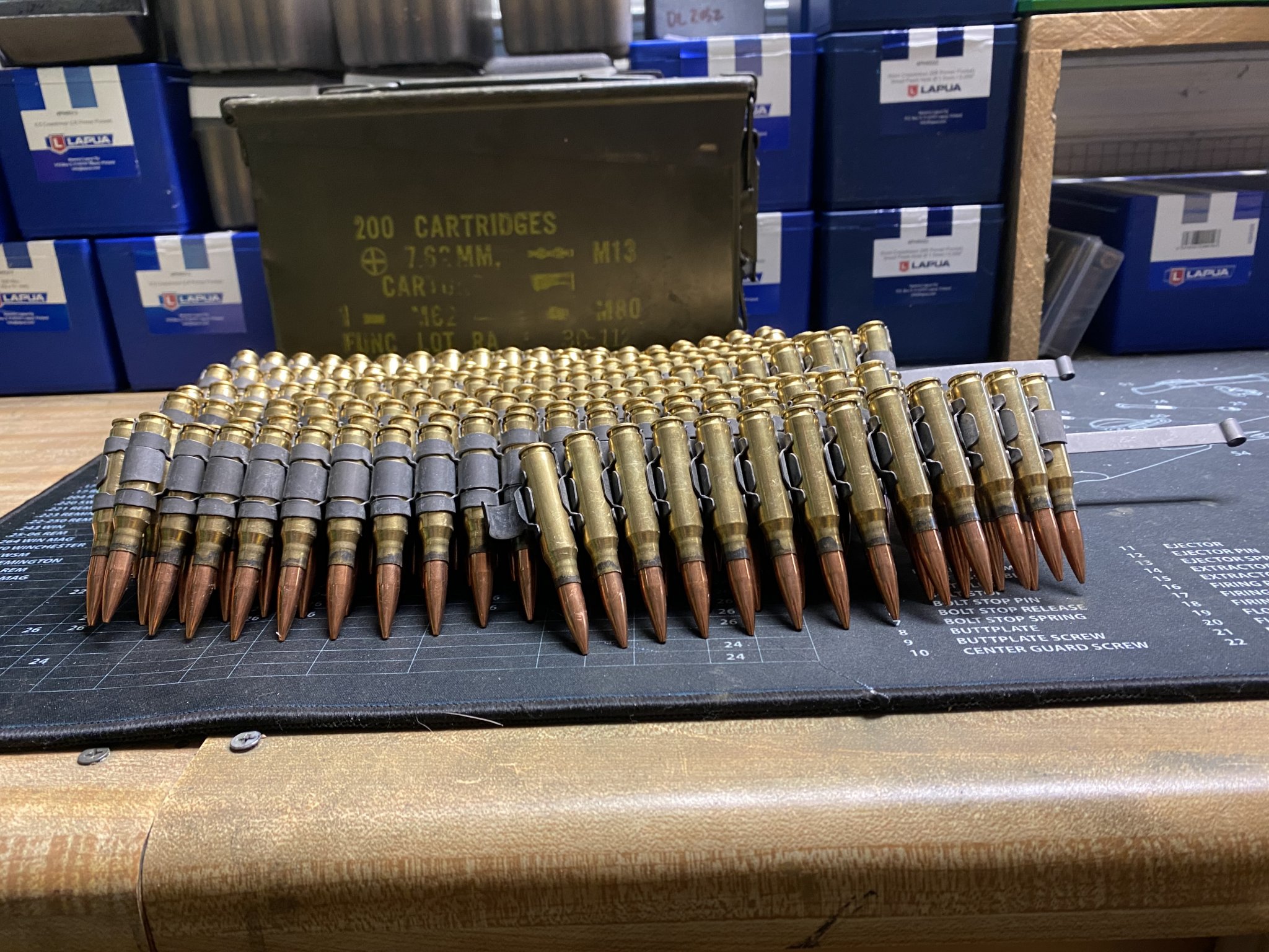

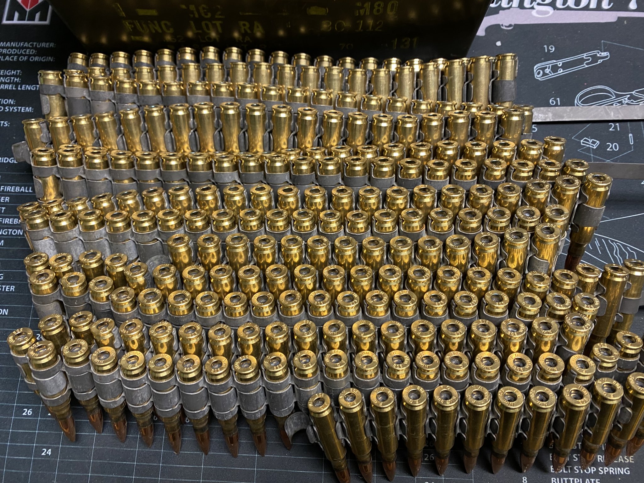

My 24yo niece:
“Uncle Al, my mom said you might know where I can find some machine gun bullet belts for a Halloween costume I wanna make? “
Me:
“No honey, I don’t have any machine gun belts, but I can prolly make some for you.”
I don’t think she realizes how heavy these are gonna be…..
Once fired Federal brass and unknown orphan 150gr bullets….

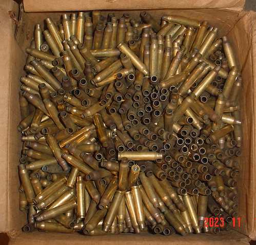

Spent the last few days processing 5.56/223 LC and FC brass for
reloading on the RCBS Pro 2000.

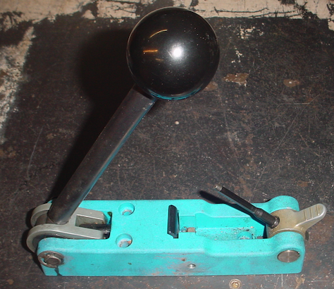

Used the Dillon Swage tool to remove the primer crimp,
Giraud trimmer to set the case length.
Have one more box of 2k LC & FC brass from gibrass.com to do next.

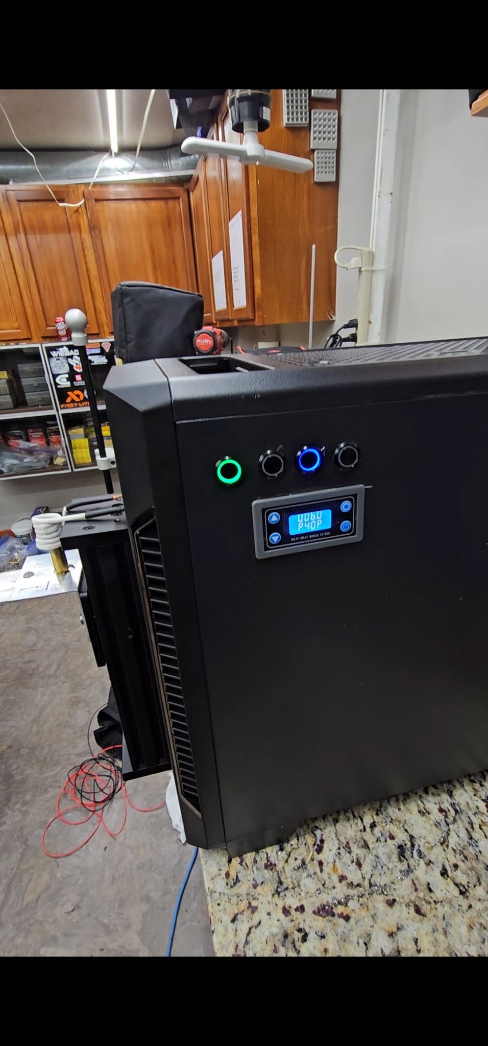

what is AUTODOD
It started out as the "IDOD". A manually run neck turning lathe that turns the inside and outside of neck. It's progressed to also able to trim/chamfer/deburr, as well has being run with a CNC controller/motor and an auto eject system. He is working on bullet trimming/pointing add ons as well as an auto feed.
So, it's essentially turning into a full on ammo prep lathe/station. Though it does come with a substantial price.
Likely won't make a difference for most shooters. But we have a niche portion of our customers that want the best brass prep they can get or the best ammo we can make. And we just like nerding out on this stuff as well.

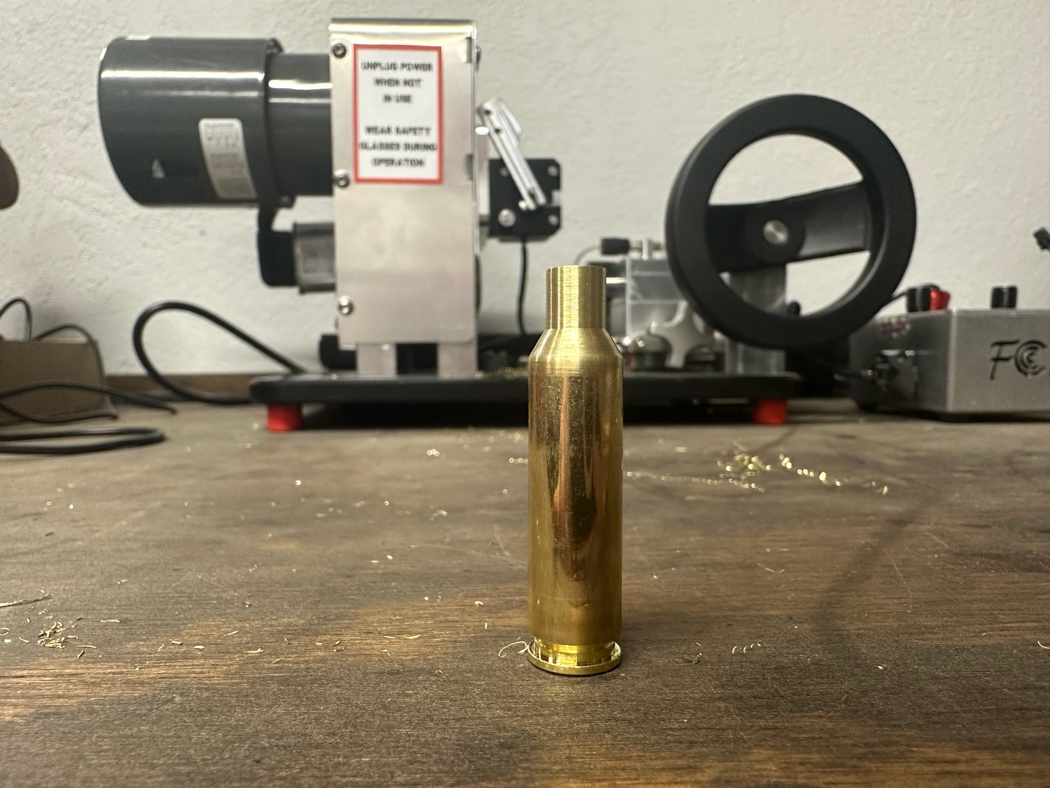

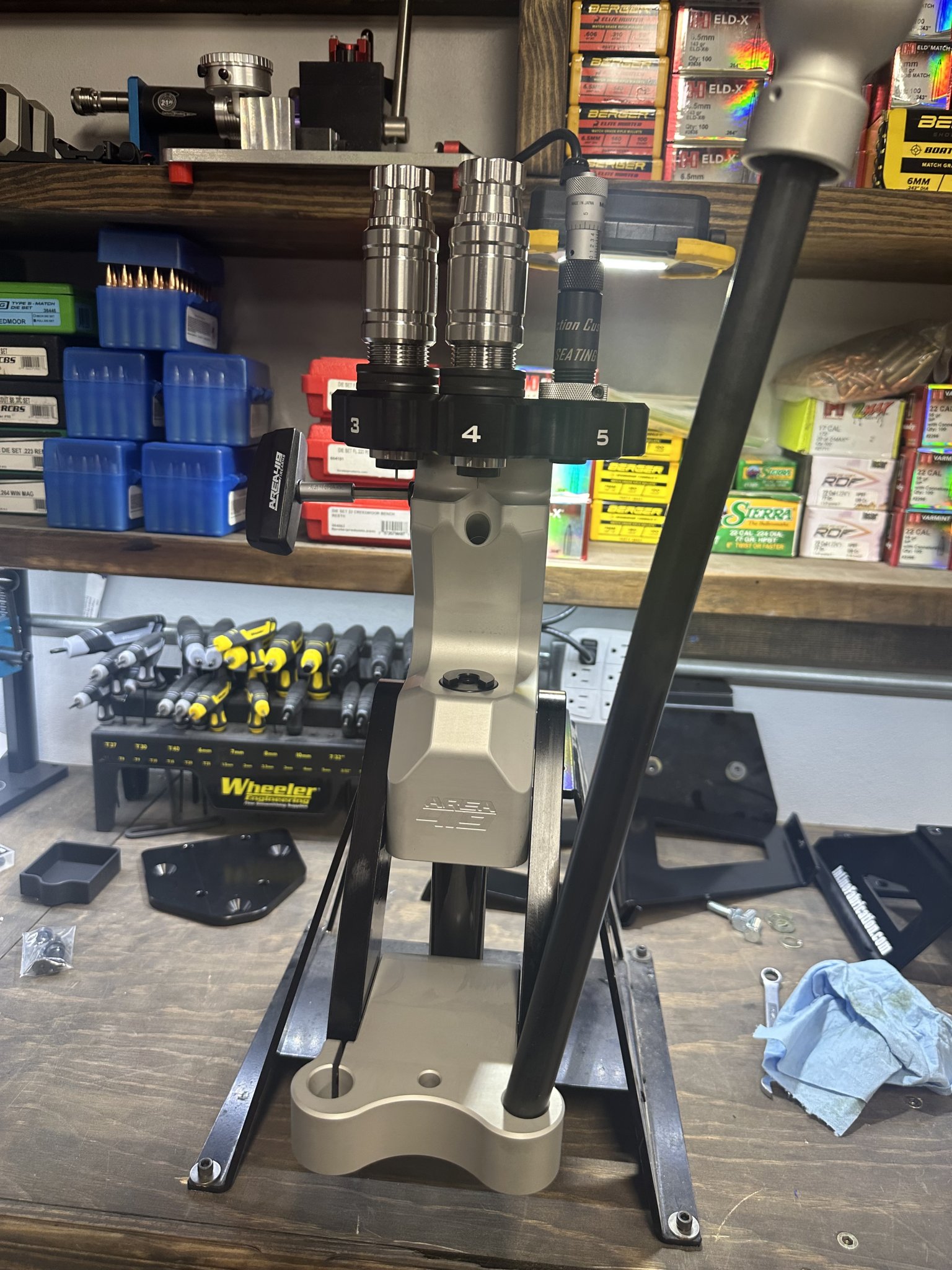

Was setting up AUTODOD for .300prc Lapua. Tossed a 212 ELD-X in with the SAC Infinity Die. Pretty impressed with the Infinity Die so far.
Might have to go full screen to see the movement. It's there.
Lapua .300prc comes quite thick in the necks. Over 0.015". Turning down to .012 - .013 drops seating force down to more "normal" levels.

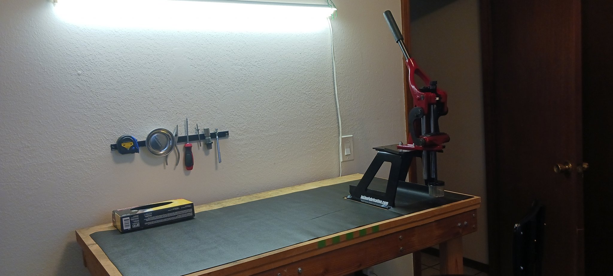

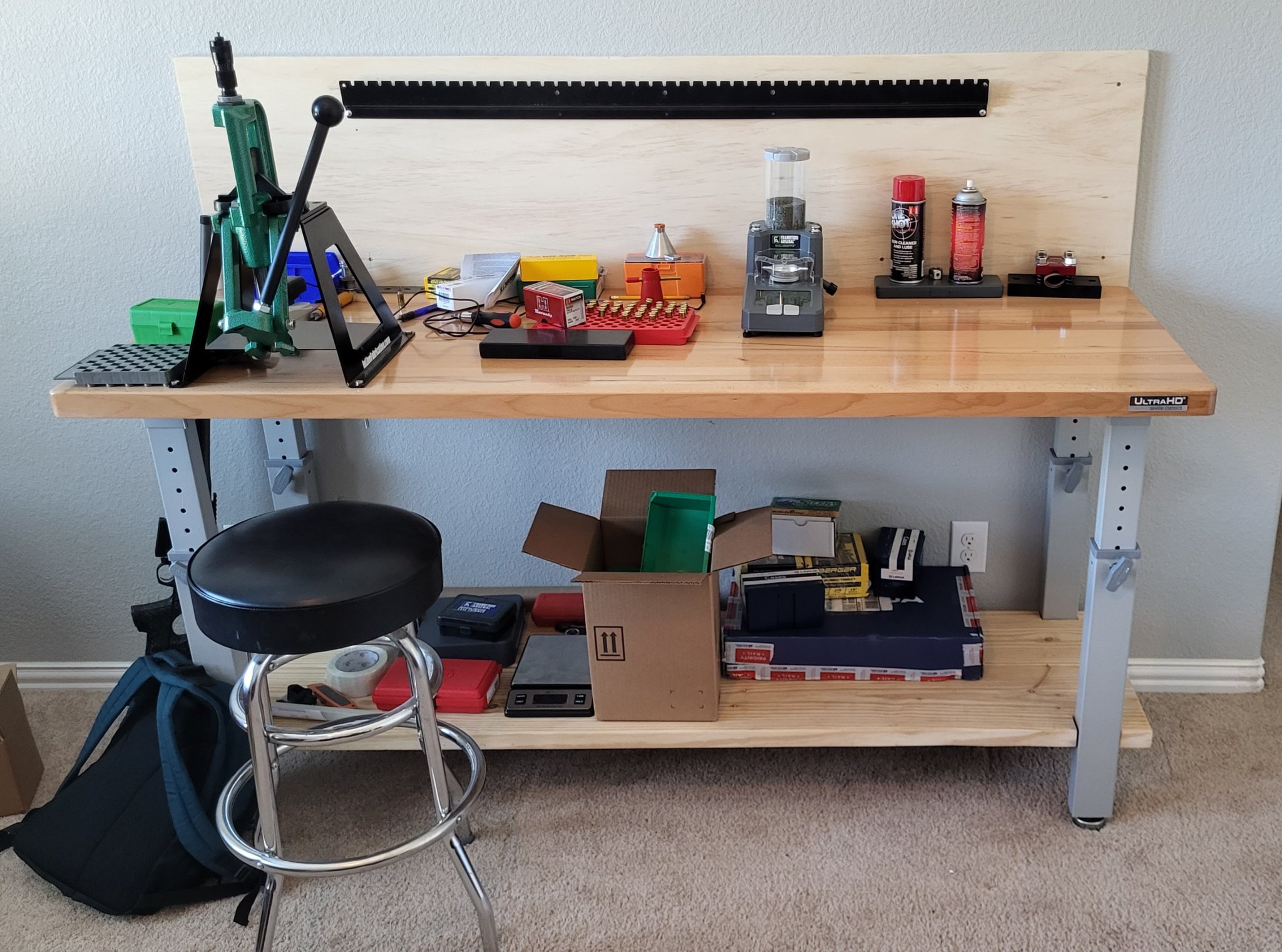

Picked up a workbench from Sam's. My regular bench was just too crowded with pistol and rifle gear. Still getting organized...
Aren't we all bud, aren't we all. I will be so glad to get my new room painted and lights and floors in. Then starts the job of putting all my boxed up crap in there.... it will great when it's done but man I'm tired of working on it.

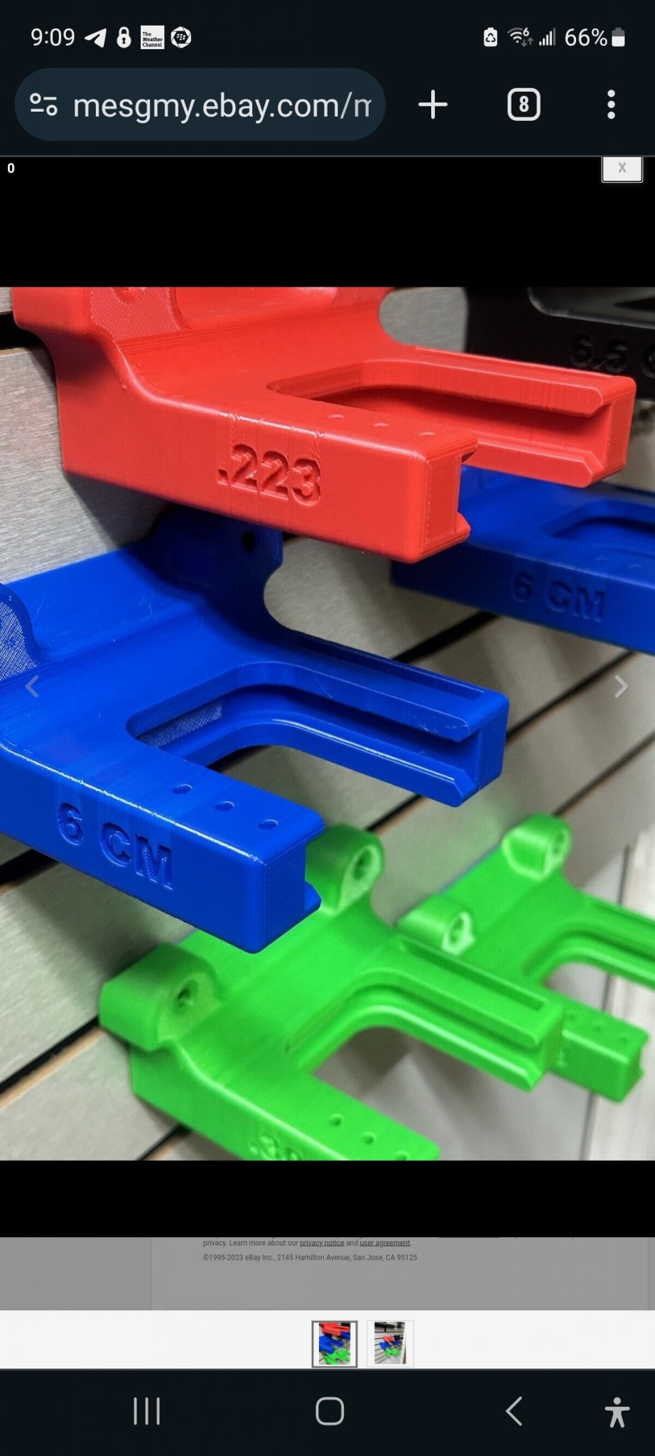

I also got these dillon tool head racks that will go directly in my slatwall. He color coded to match the color code I have on my dies already. He embossed em too. I'm thrilled. He makes a few different ways to keep them with peg board or just sitting on a bench. Really good dude I found through fleabay.

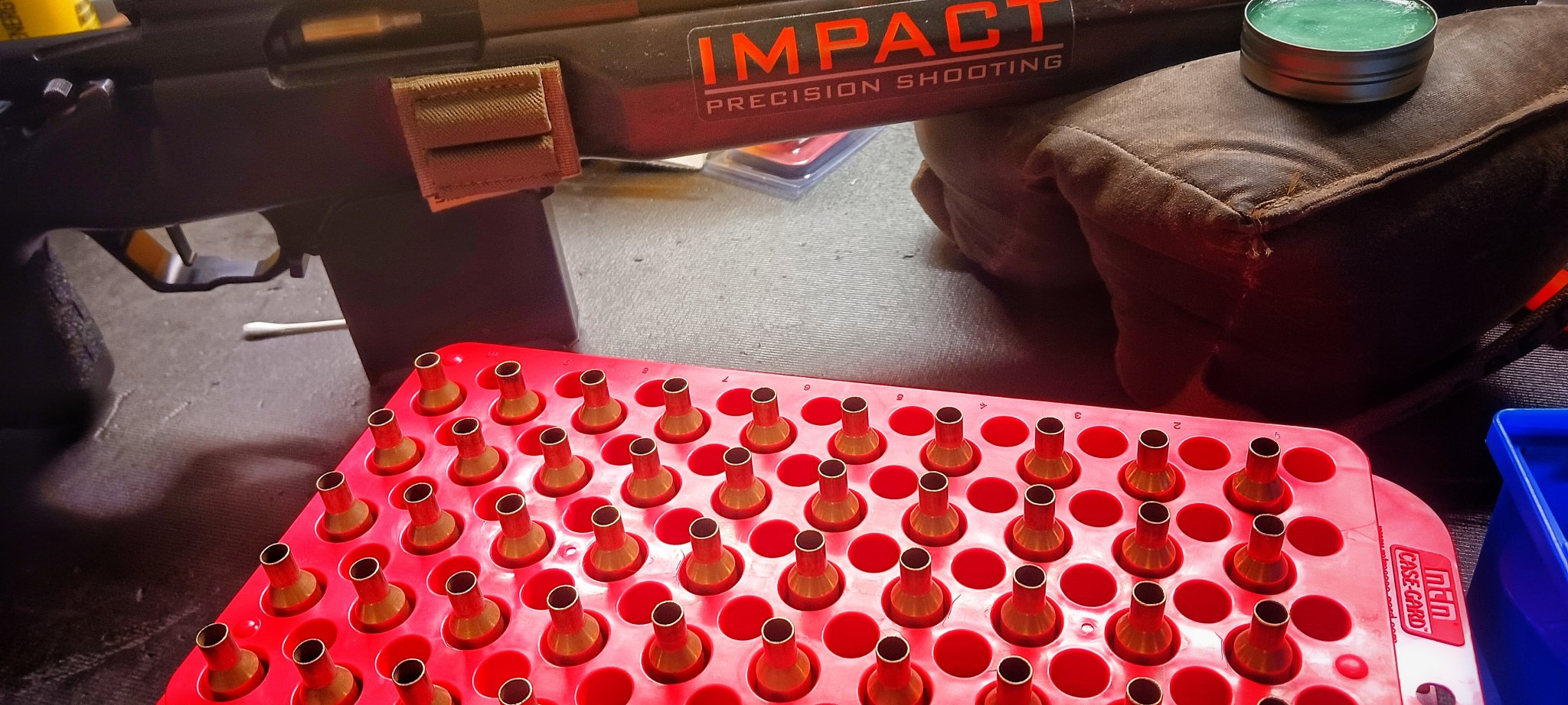

Resized all my 6br fired brass. Whatever chamber they were shot from was a bit looser than my chamber. Some would still not close and took some extra effort in sizing. Using a sac die in a coax. Checked each one..all 600+ bolt close now. Will start chamfer and load testing soon
