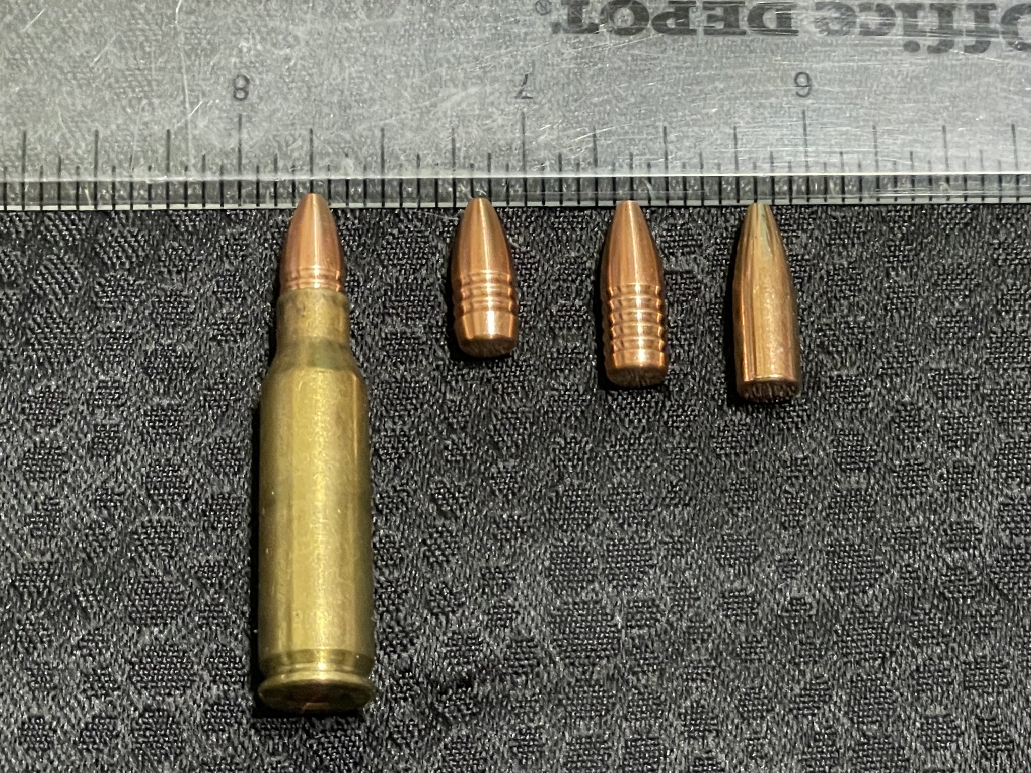

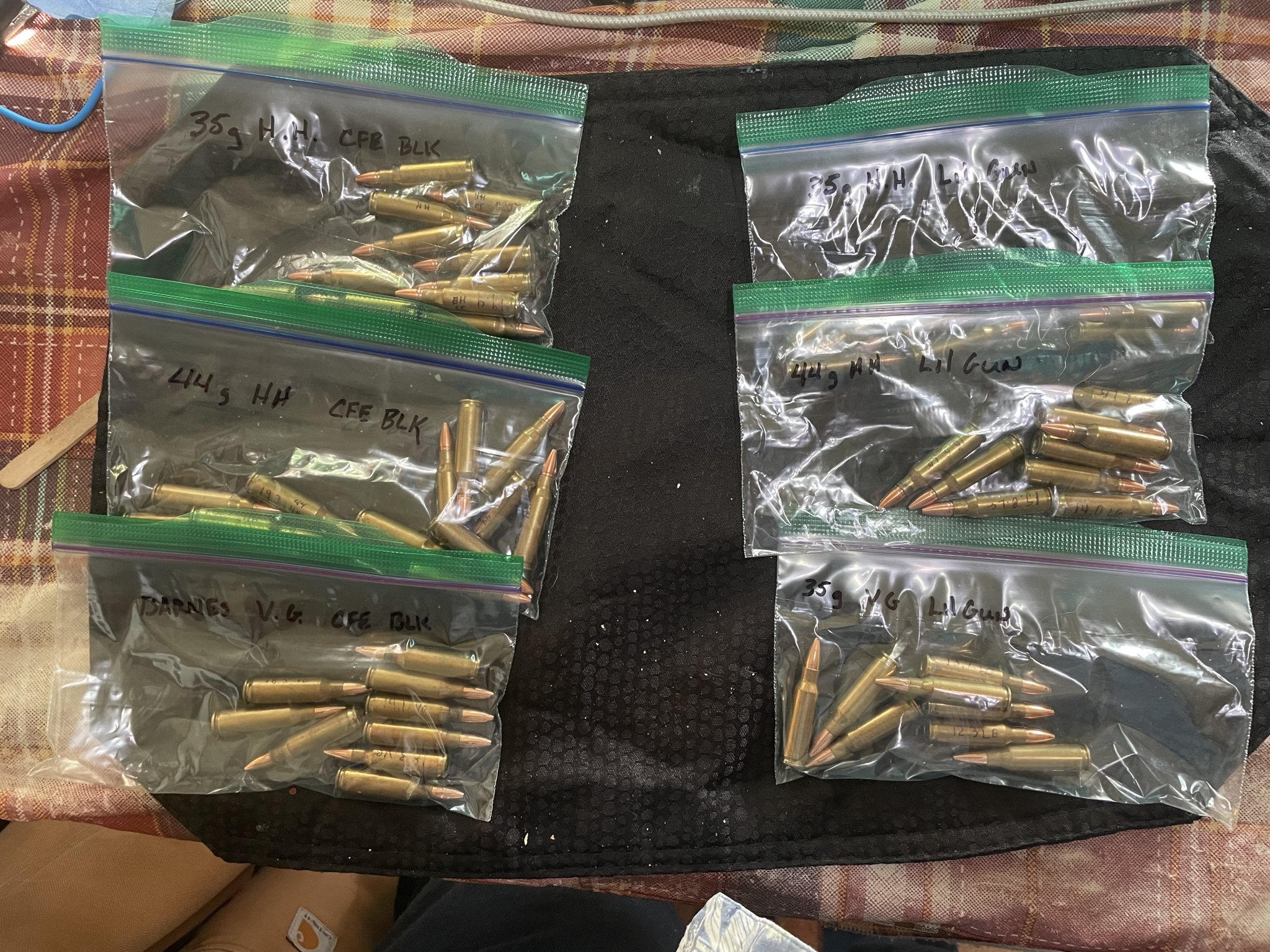

Just finished getting the 221 Fireball set for the first round of load development. 3 bullets and two powders all new to me. I forgot how small those cases are! 🤩
The nice thing is that the max loads from Hodgdon top out just over 20 grains, so I’ll get some good mileage out of a keg.
The hard part is the fact that I’m having to treat the first two bullets like a unique wildcat because of the lack of load data.

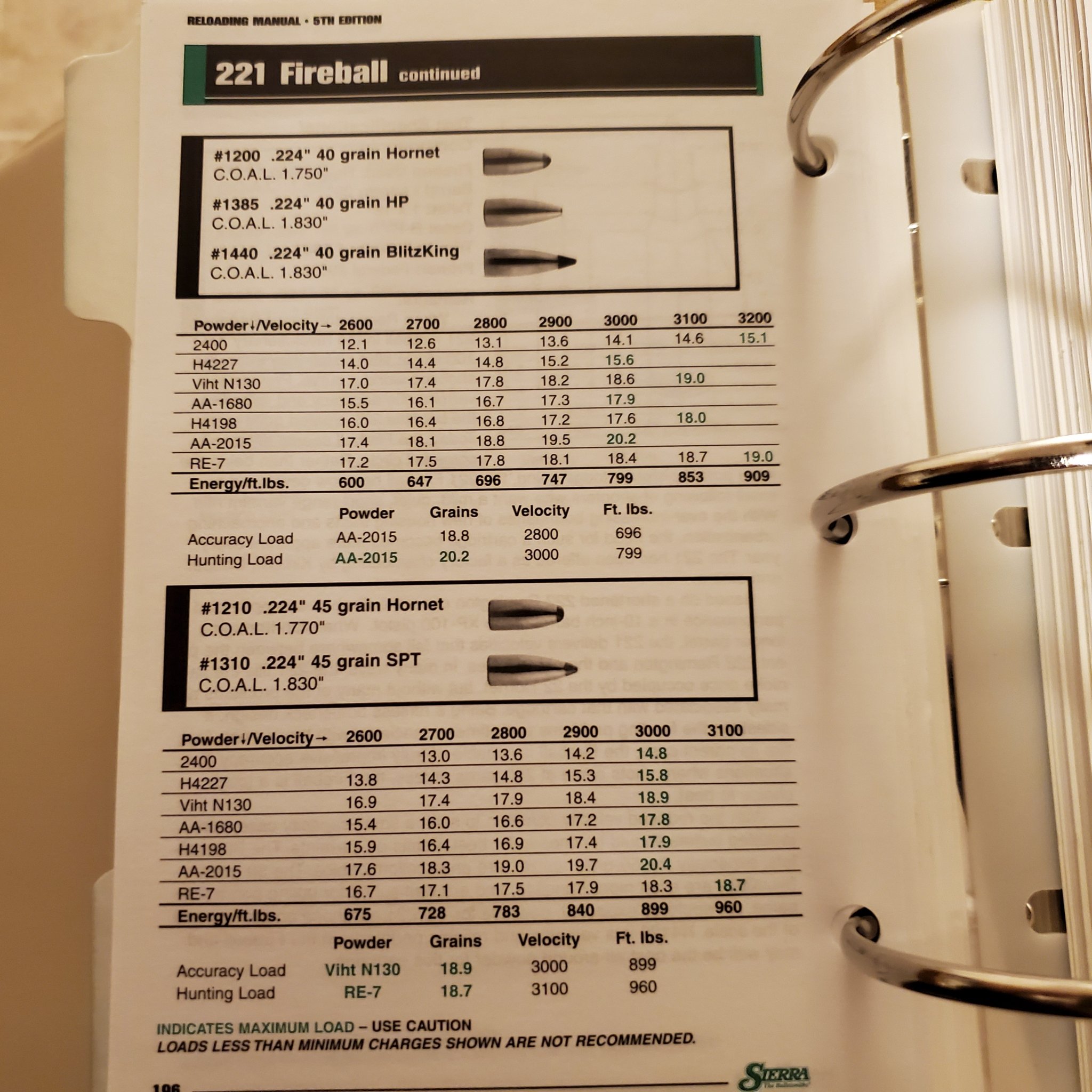

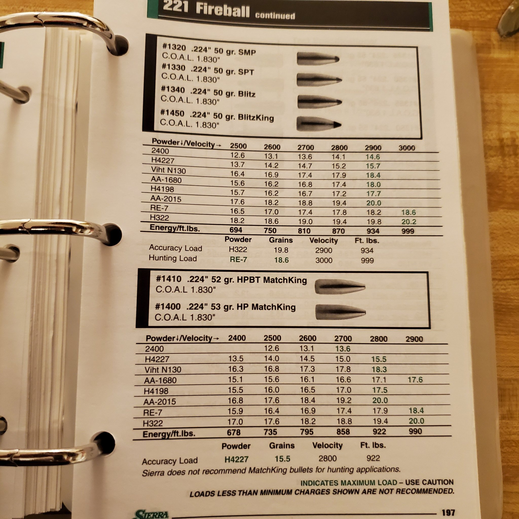

Here ya go... 221 fireball 20" barrel Sierra load data.

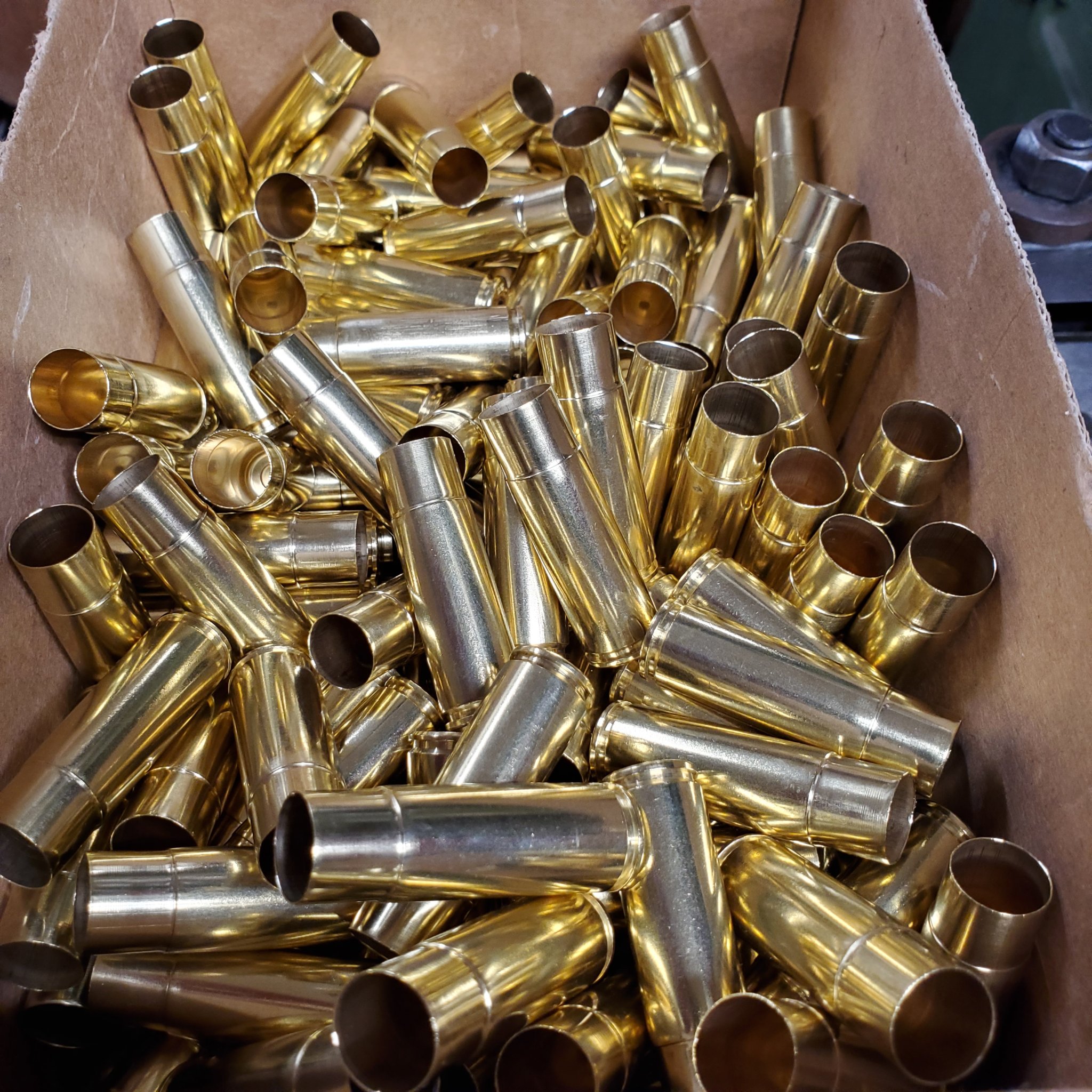

Yup. It’s a pain - haven’t made any more in about ten years. I have about 50 still at this point. I take .338LM brass that already has five or six firings, use a pipe cutter to cut it to length, run it through a die to take the taper out, cut the shoulder with a neck turner…not a fun process.
I use a Bridgeport mill and collet fixtures to cut to length, in one second...and neck turn in a Hardinge lathe with collets...lots easier than by hand. Made the cartridge gauge with the finish .510 whisper reamer.
Bought a barrel blank 510 1-10 twist, and a .510 whisper reamer

I appreciate the photos, but none of my powders are listed. 🤷🏼. The wildcatting is for working with a newer lead free bullet that no one has admitted to using in the Fireball. I’m following the bullet manufacturer’s recommended procedures and see where the trail leads.

So you have secret bullets and secret powders for the 221 Fireball?
What is the bullet and what powders do you have? Are they appropriate for this cartridge?
Doesn't the manufacturers have load data for it?
You can use lead bullet data as a guideline, but start low and work up, copper bullets have a higher start pressure, and are longer for the same weight, reducing case capacity in such a tiny case causing pressures to spike, just .2 tenths of a grain can put you over pressure.
Have fun, be careful.

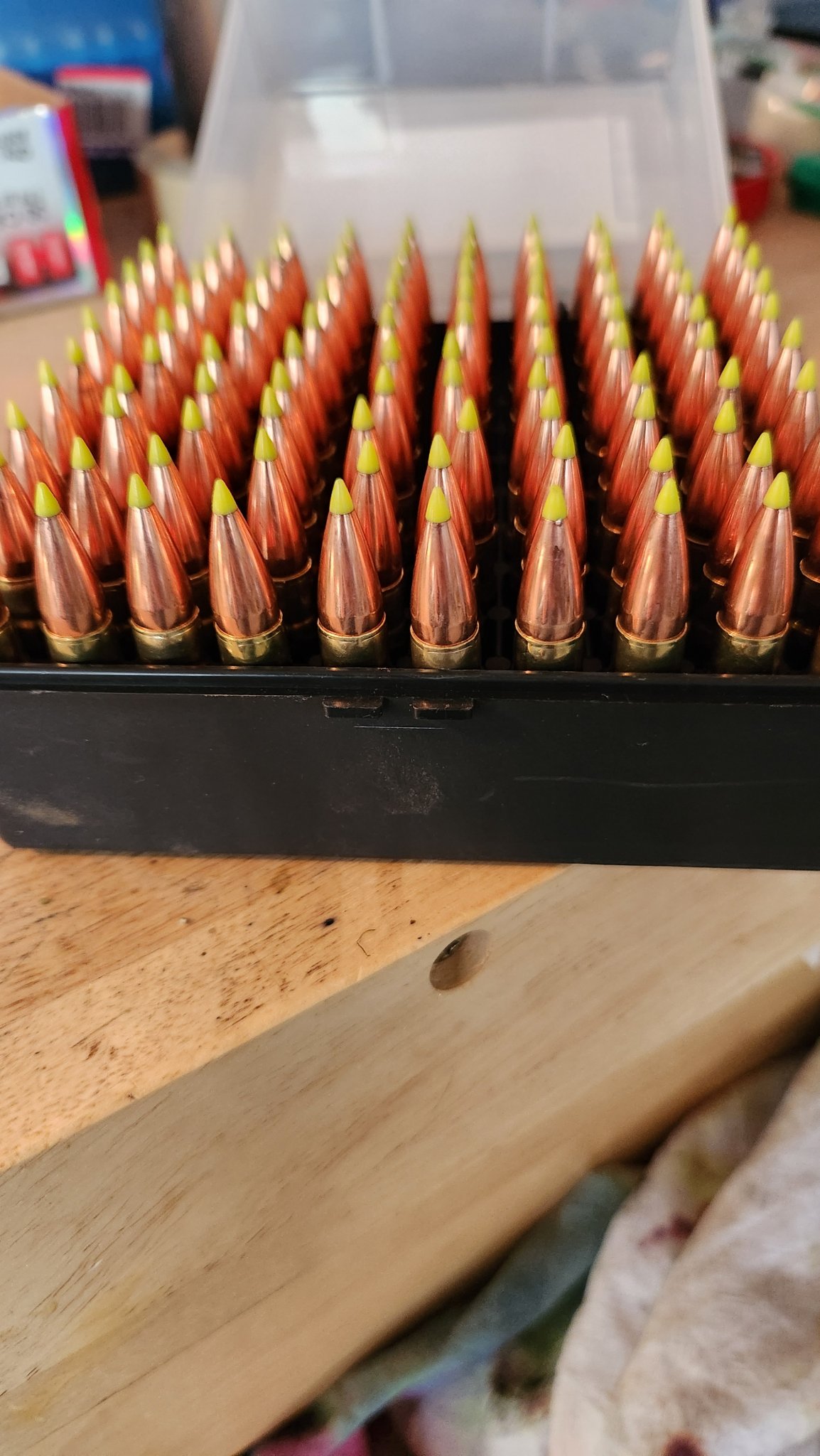

Chamfered and debured 1000 cases of new Starline 223. Now I just need to run them all through the mandrel. I have been trying to get a load with 77smk for all 3 of my main AR's, but I think it's time to just call it on that one. I'm going to try the 73gr and 75gr Hornady hpbt and see how that shoots in my CLE precision AR and my new Craddock done Bart barrel with CLE chamber and see if I can get a load that both of them like a lot. My smk load was poping primers in my new barrel and I left my cleaning stuff at home so I didn't want to shoot too much without cleaning it to start out with anyway so, gonna take it down a half grain and try some other bullets while I'm at it.

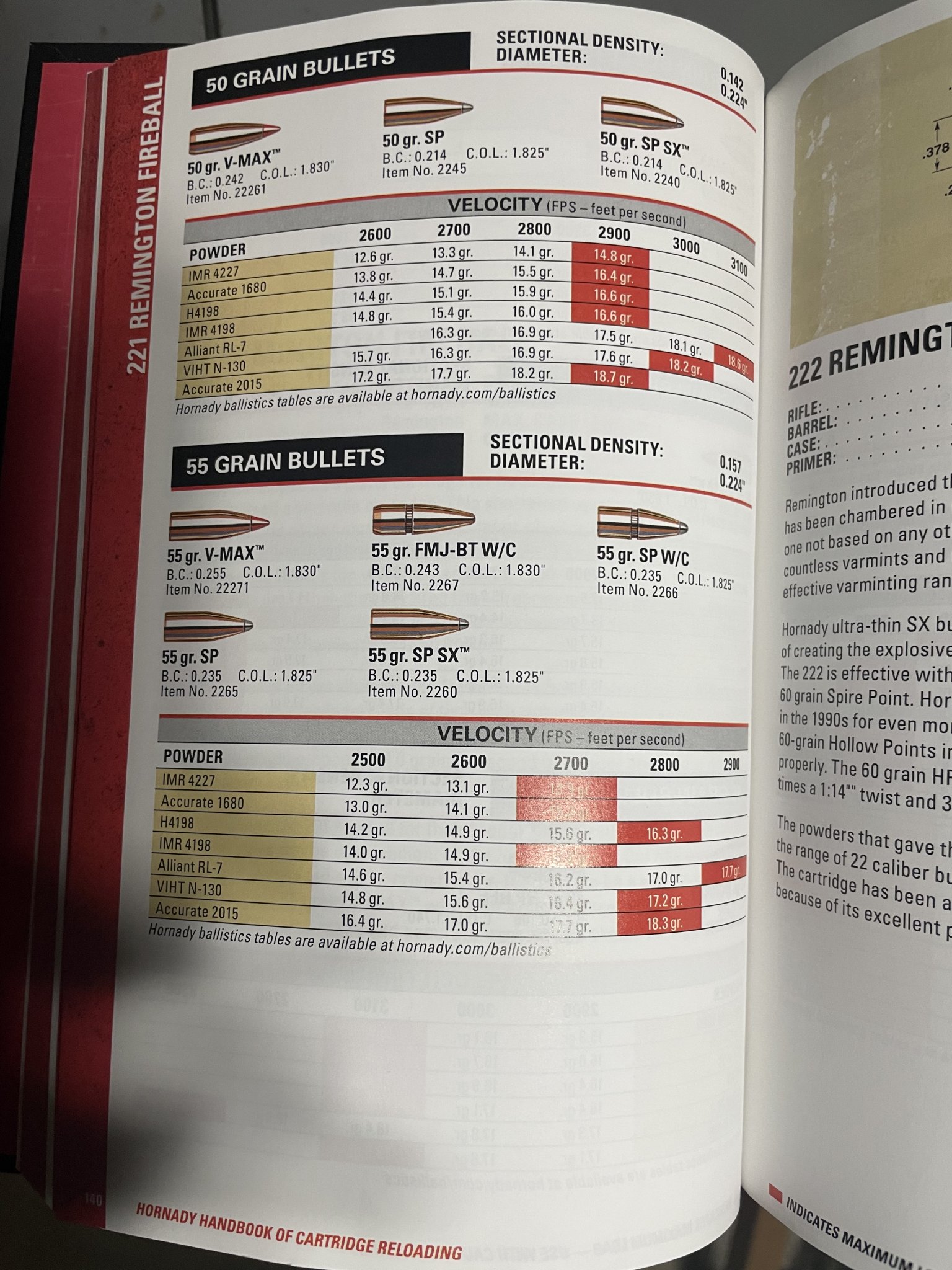

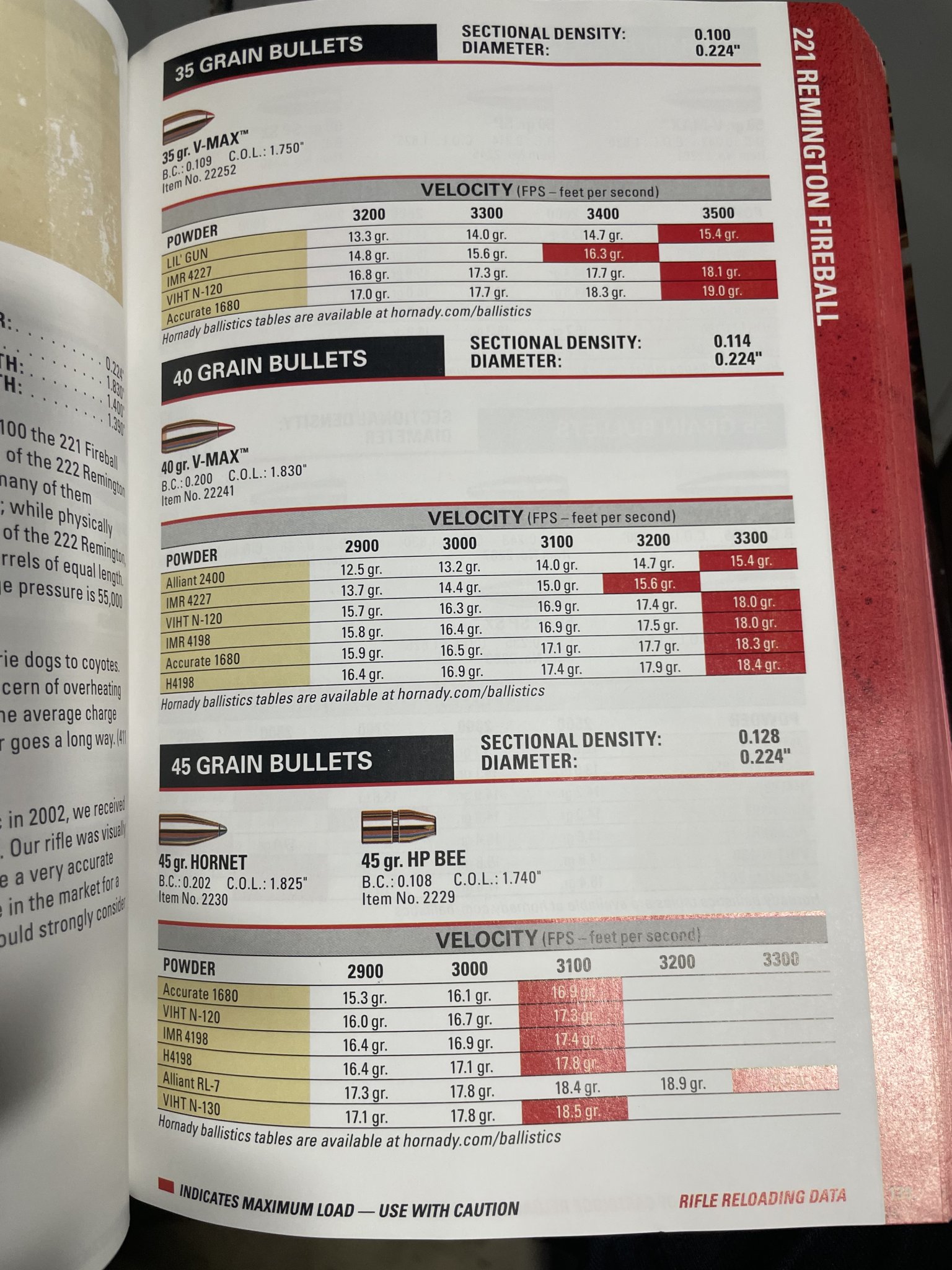

Hornady Data for further extrapolation;

Are you using Starline 223 or 5.56 brass? The 223 line of brass has a lot less volume than the 5.56 (which is the same as Lapua).
Reactions: BuildingConceptsllc
Yeah it's 223. It is a decent amount reduced from lapua for that reason(my load that is). I will probably get the 556 next time but I bought 1000 of these a while back and had a bunch of FC I was going to use for AR for a while before getting into the starline 223, (similar to starline 223 capacity), but the FC brass sucks so bad I'm just going to use it as hunting brass and only ever fire it once more and not police it. I hate that stuff.
I didn't know the 556 had the same capacity as lapua. That's good to know

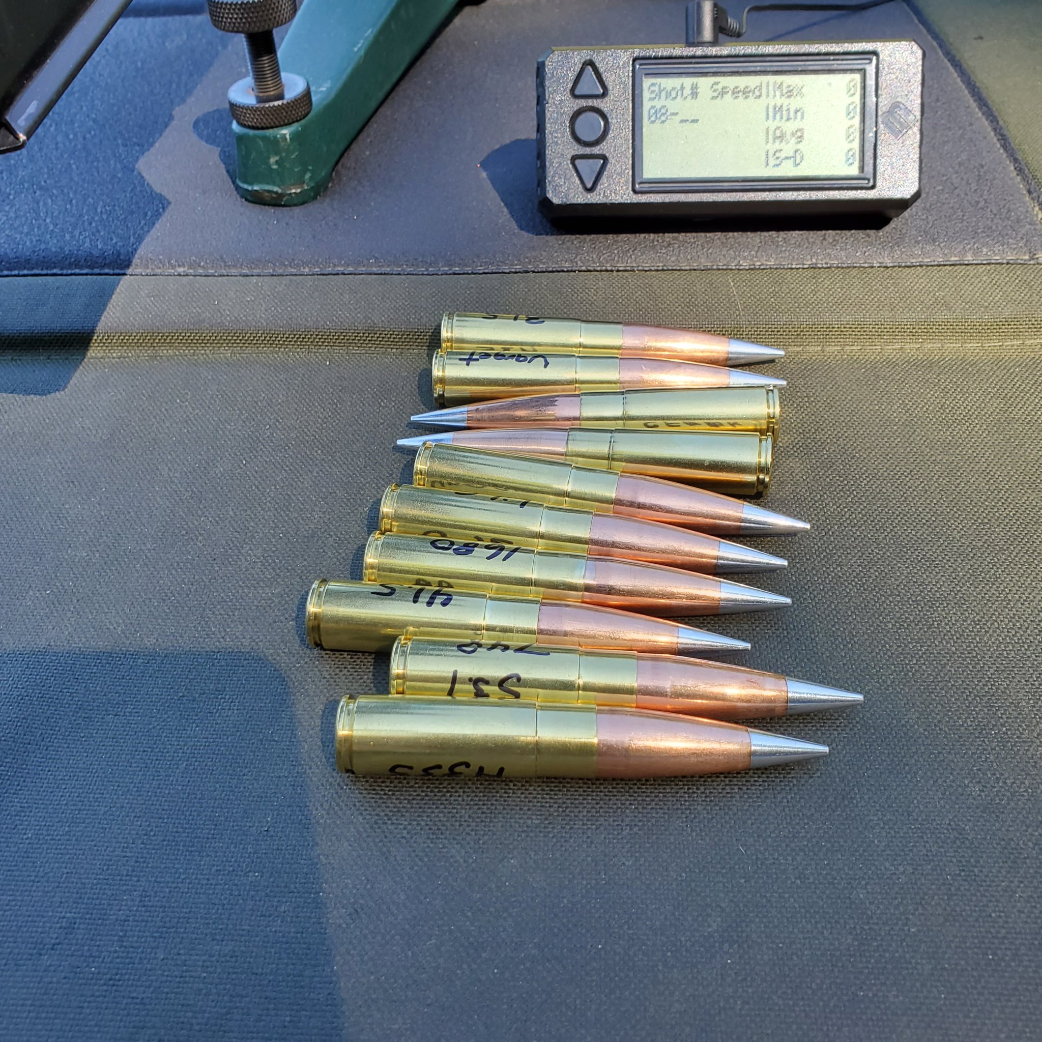

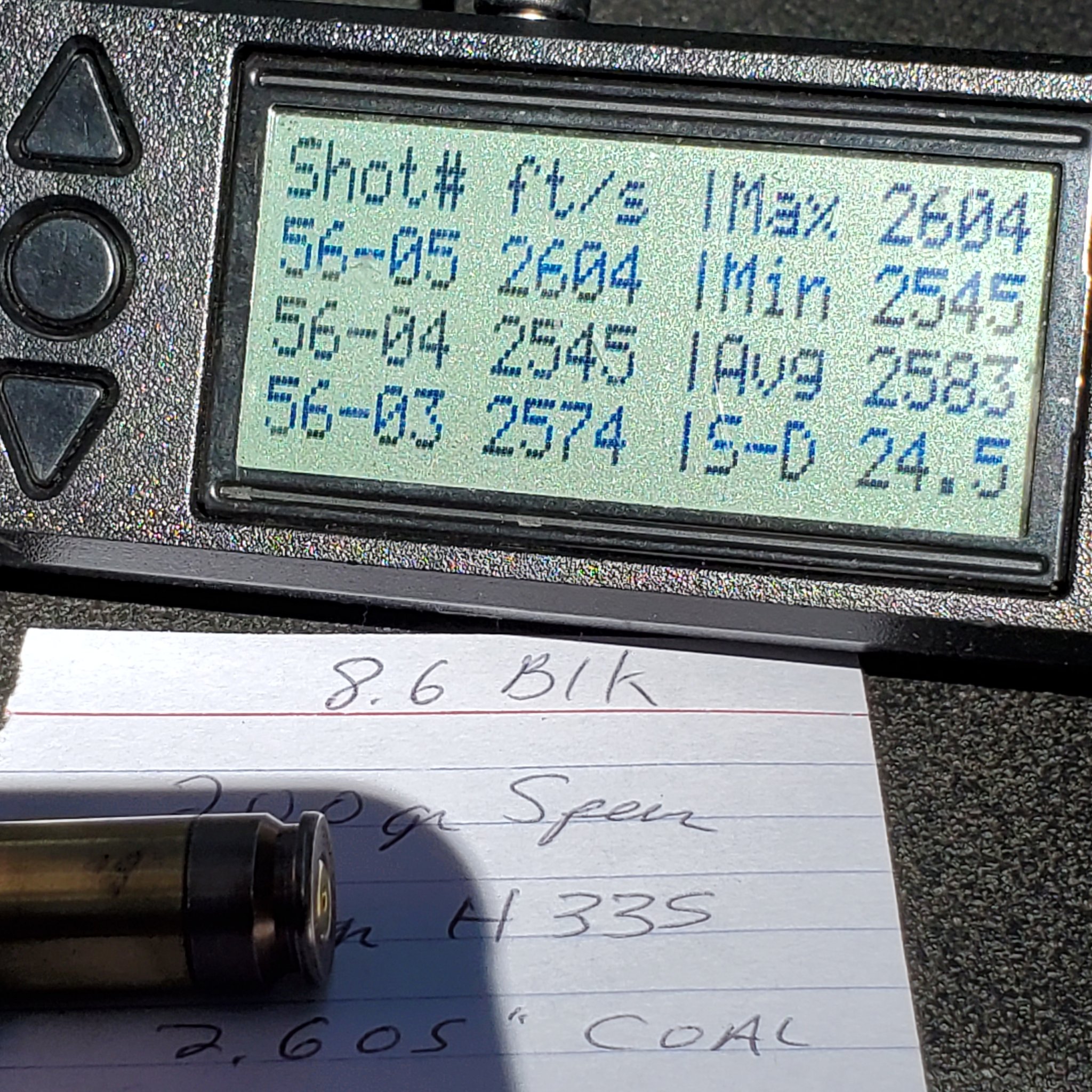

Loaded yesterday fired today.
High velocity 8.6 Blackout loads from a 6.5 twist barrel rather than three limiting 3 twist Faxon.
Results 200 gr Speer with H335 reached 2604 fps.
Also tried with the 200 gr Speer 338 hot core.
AA 2495= 2451 fps
CFE223= 2572 fps
IMR 4198 = 2433 fps
2000MR = 2494 fps

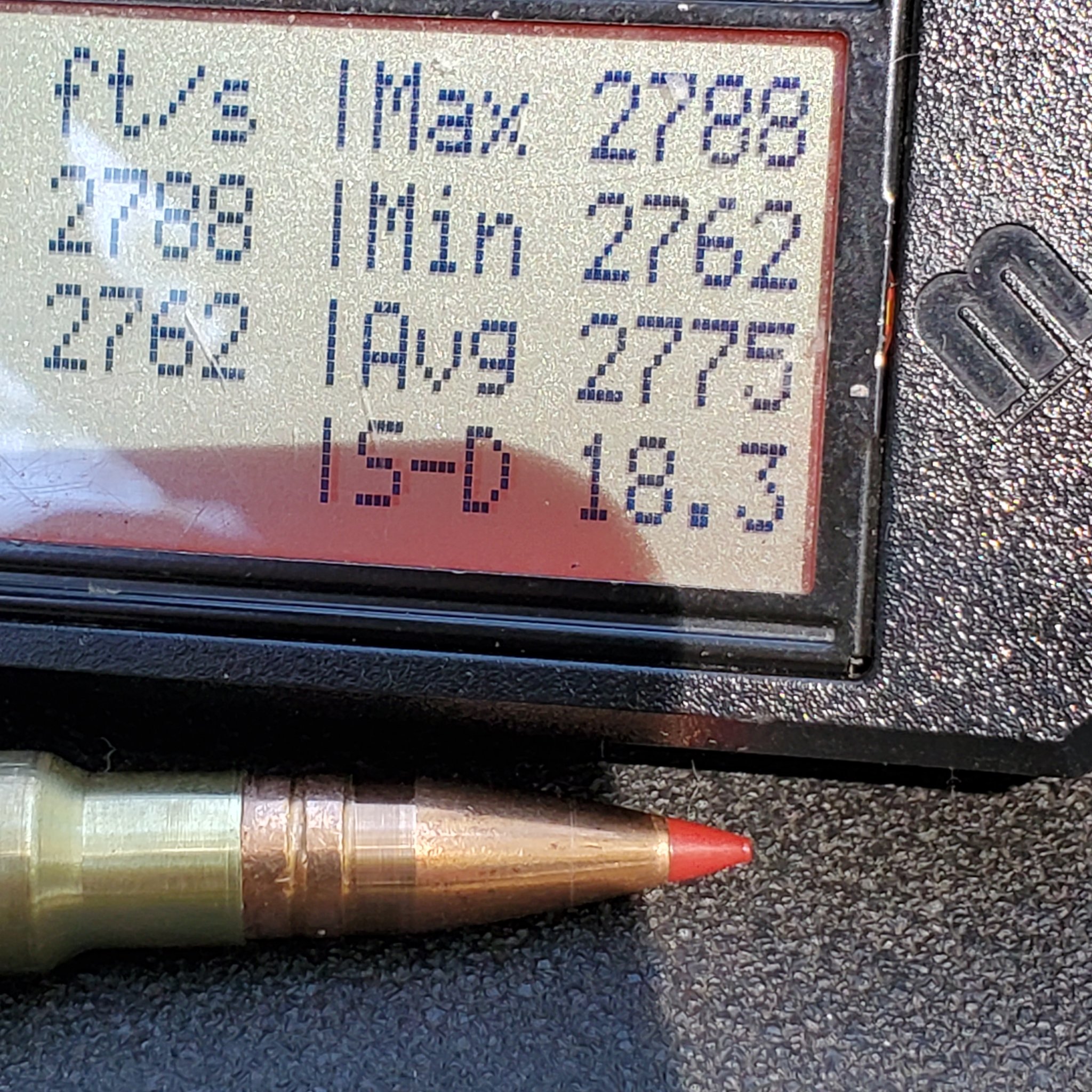

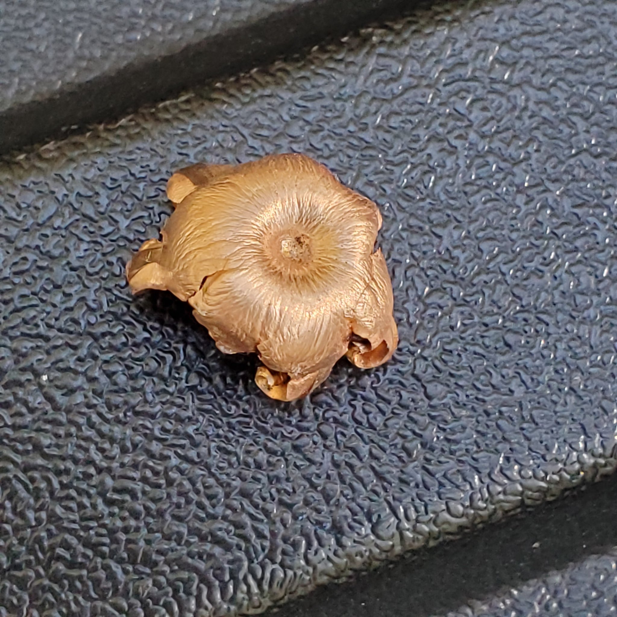

Copper hornady GMX 225 gr cut down to 154 gr in lathe with collets.
H335 = 2788 fps.
One copper slug caught in plastic water jugs...it mushroomed nicely at that velocity.

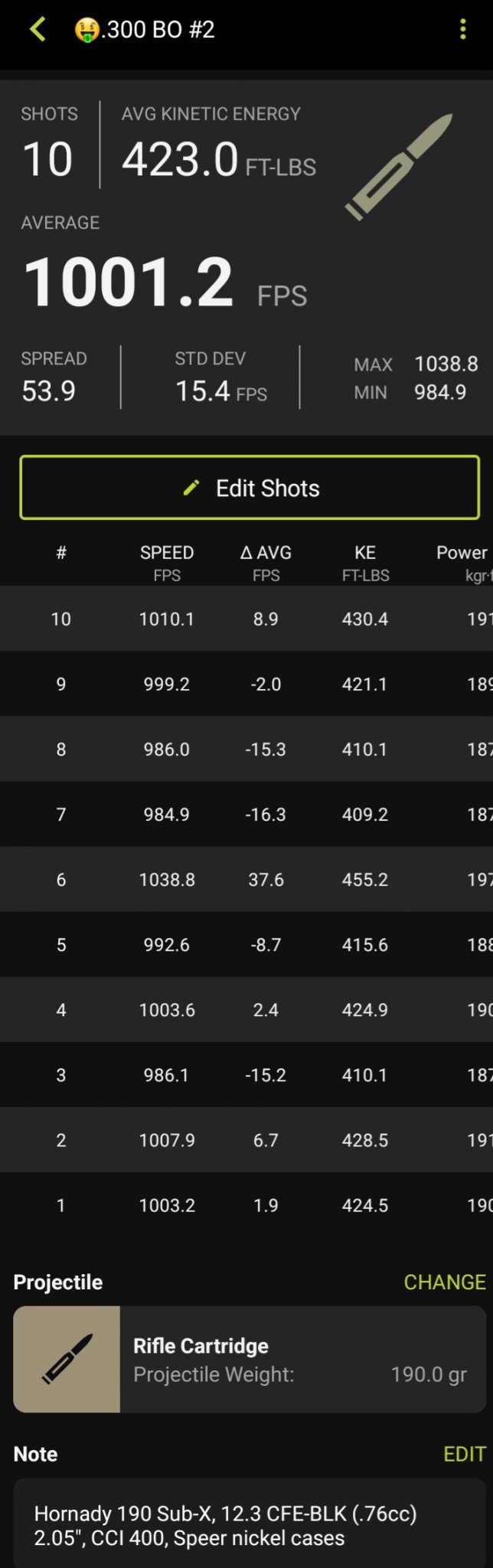

Also fired some subs 300 berger 989 fps, with imr 4198 about 1.1" for 5 shots round group. 300 gr SMK with AA 1680 a vertical string, large velocity veriation at 100 yds.

AA-2200 is really good in the Fireball.
I'm still using Lil' Gun in mine with the 40 V-Max.

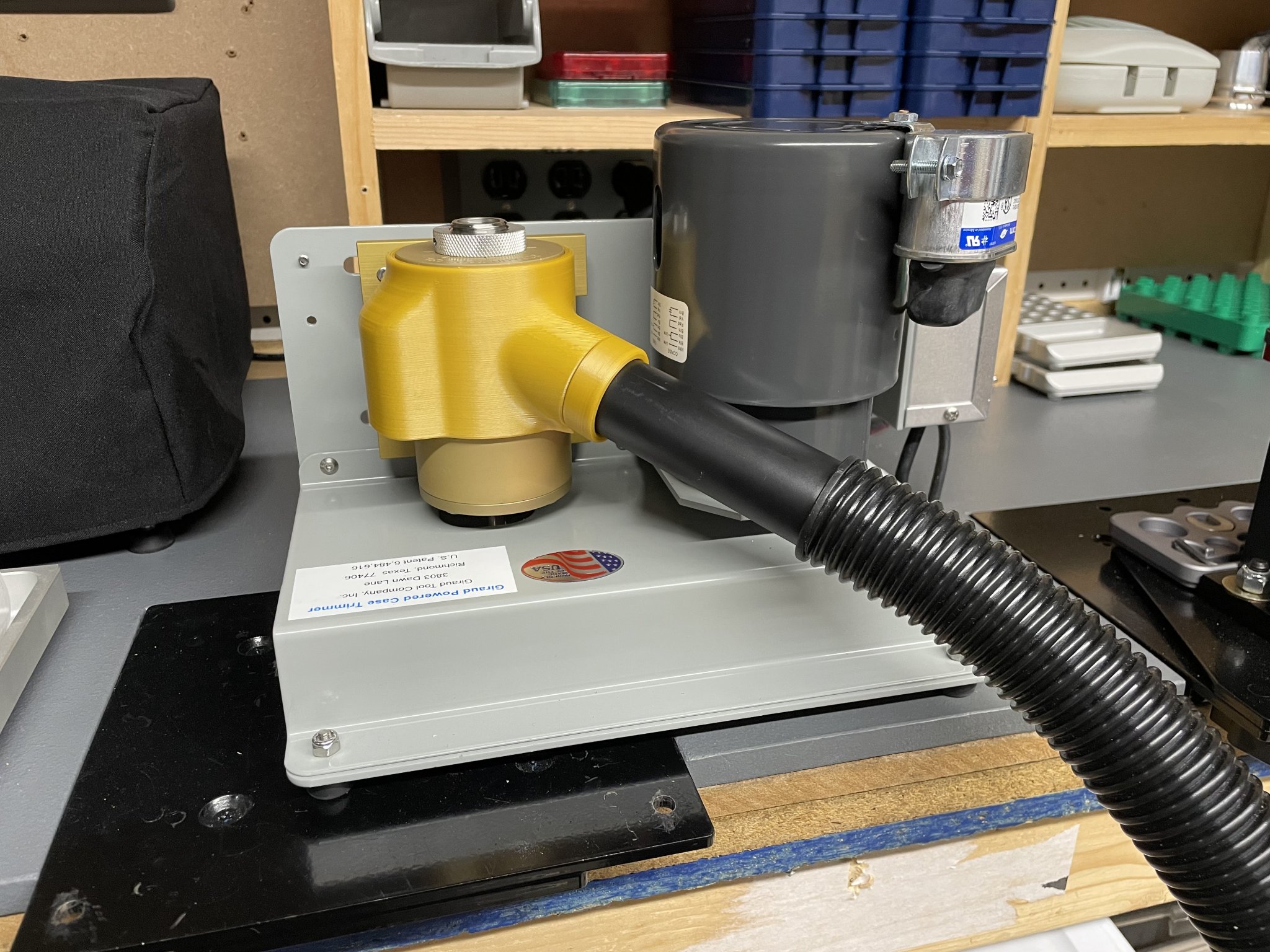

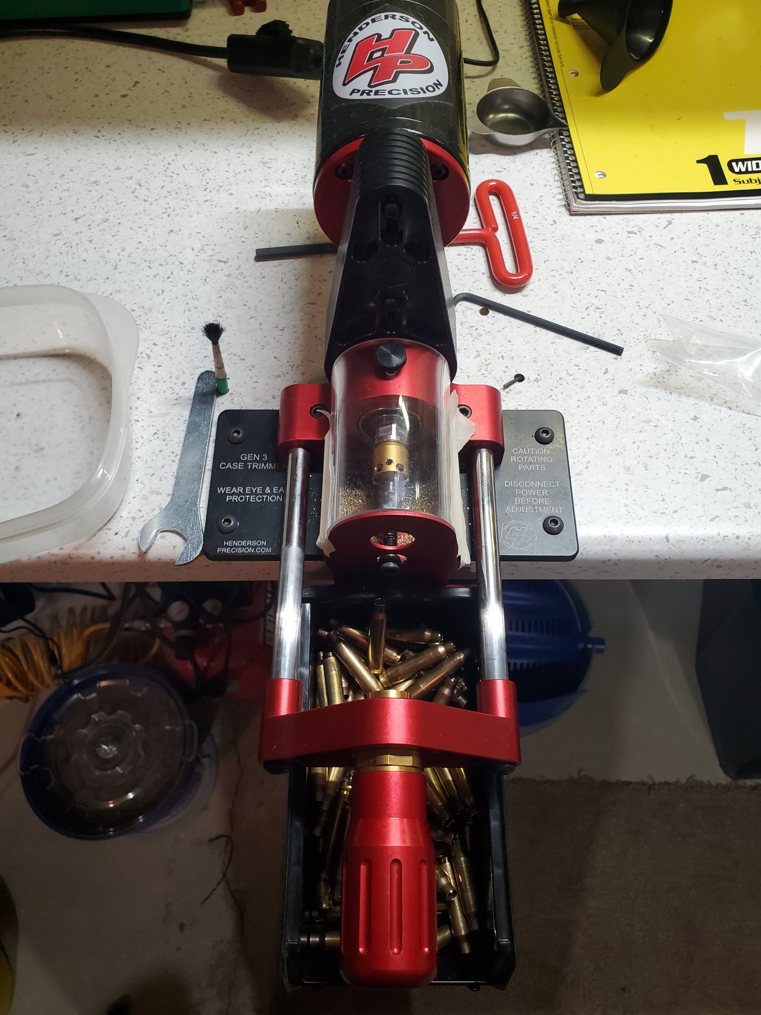

Ran a quick batch of 6.5 Creedmoor brass. Only 50 rounds, but it’s all I have time for right now. The upside, it works. Not a spec of brass shavings in the unit. There were some in there before I started. All gone. I have it hooked to the cheapest, smallest Bauer shop vacuum that Harbor Freight has to offer and it worked fine. Now for the downside. It is really loud. You have the noise from the trimmer, the vacuum, and the high pitched sound of the air rushing into the trimmer. It will absolutely require hearing protection.
Picture is after trimming the 50 rounds:

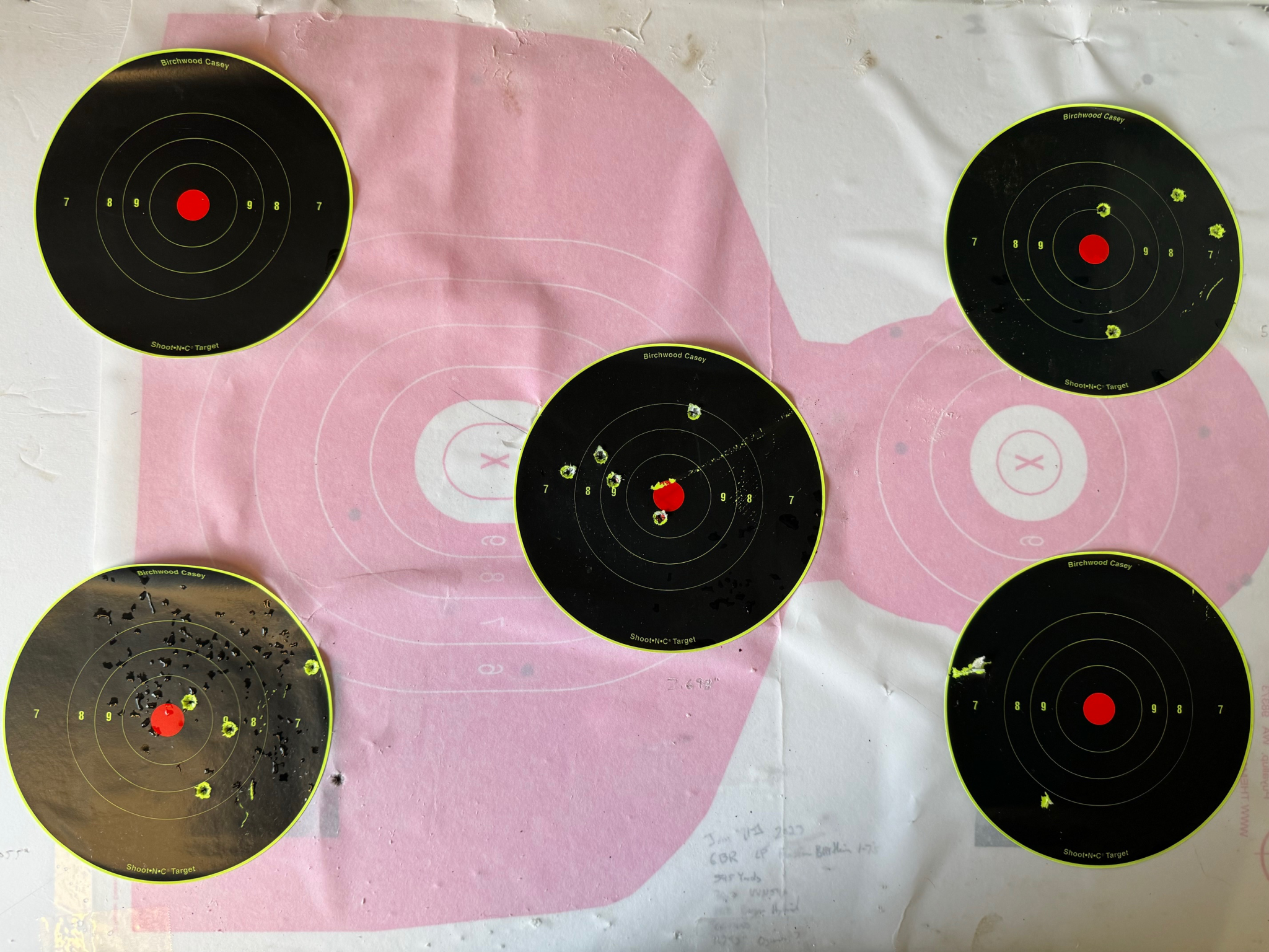

This target got blitzed from bullets hitting and exploding against the steel rail right behind the target--lesson learned--place target higher.

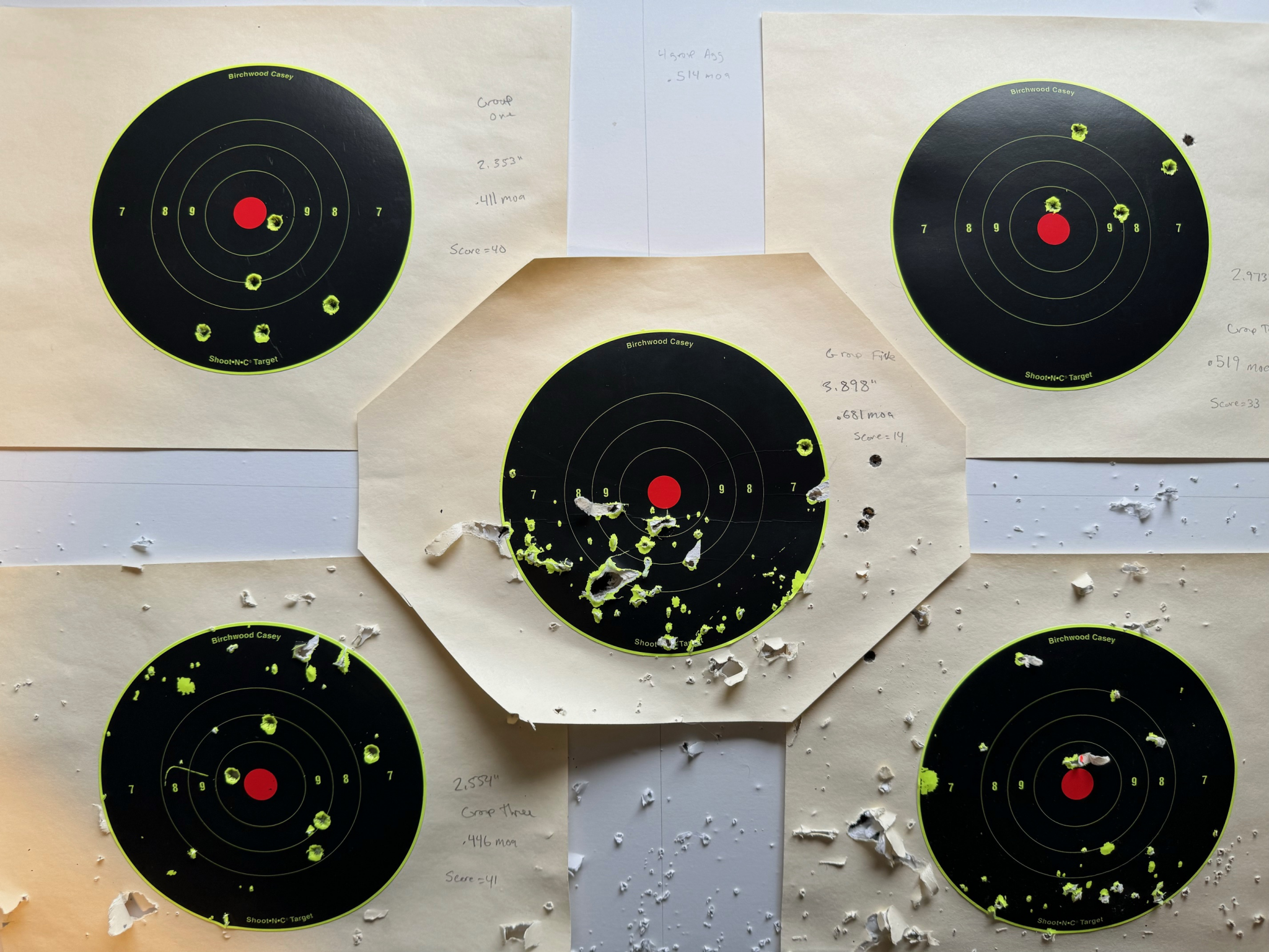

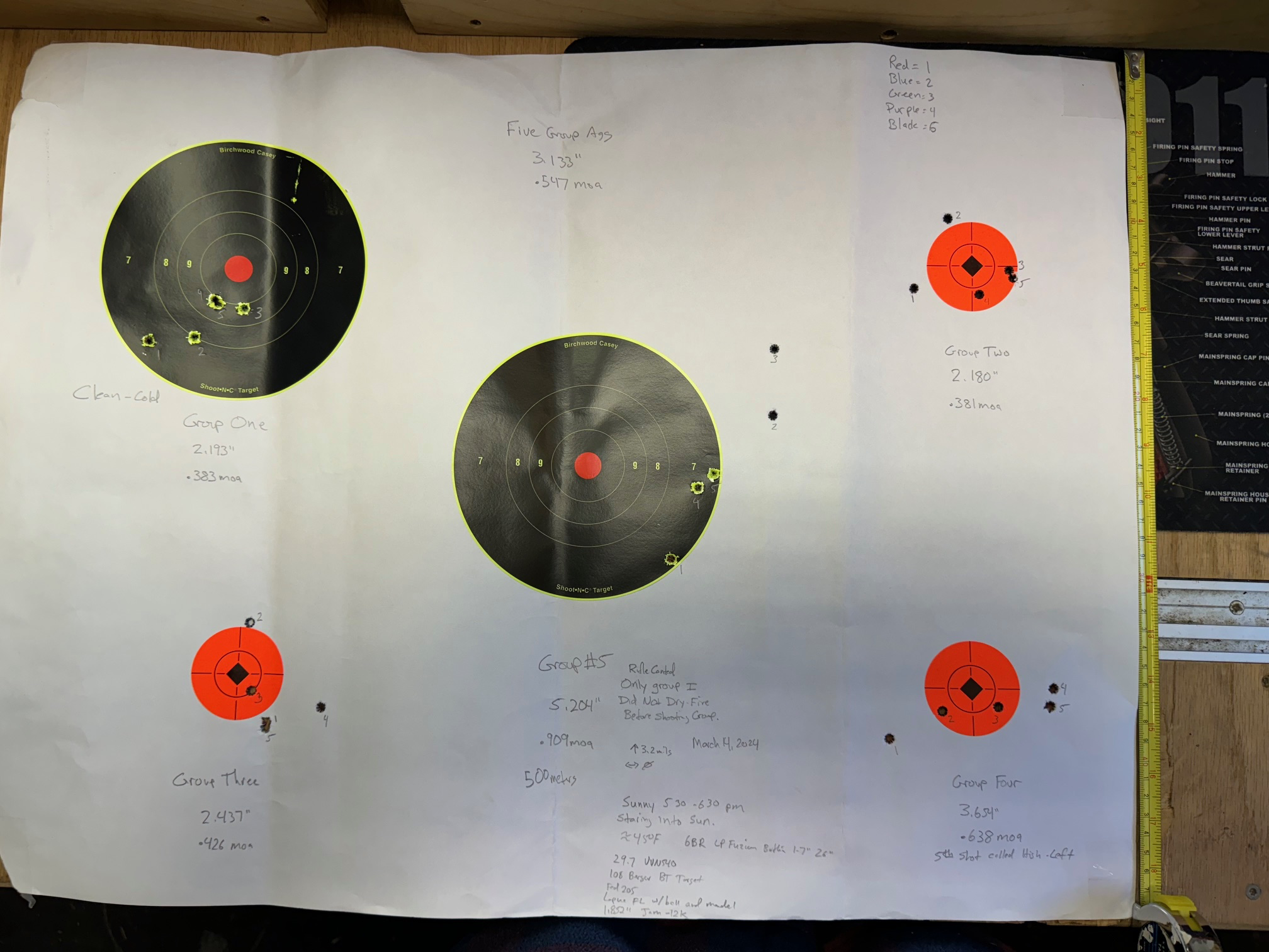

Shot this a couple days ago. Colored the tips of each round to see where each one hit. For the first four groups, I took some advice from Ryan Cleckner (spelling?) from Erik Cortina's podcast. Dry fire five perfect shots before shooting a group. I did that before each group and I think it helps.

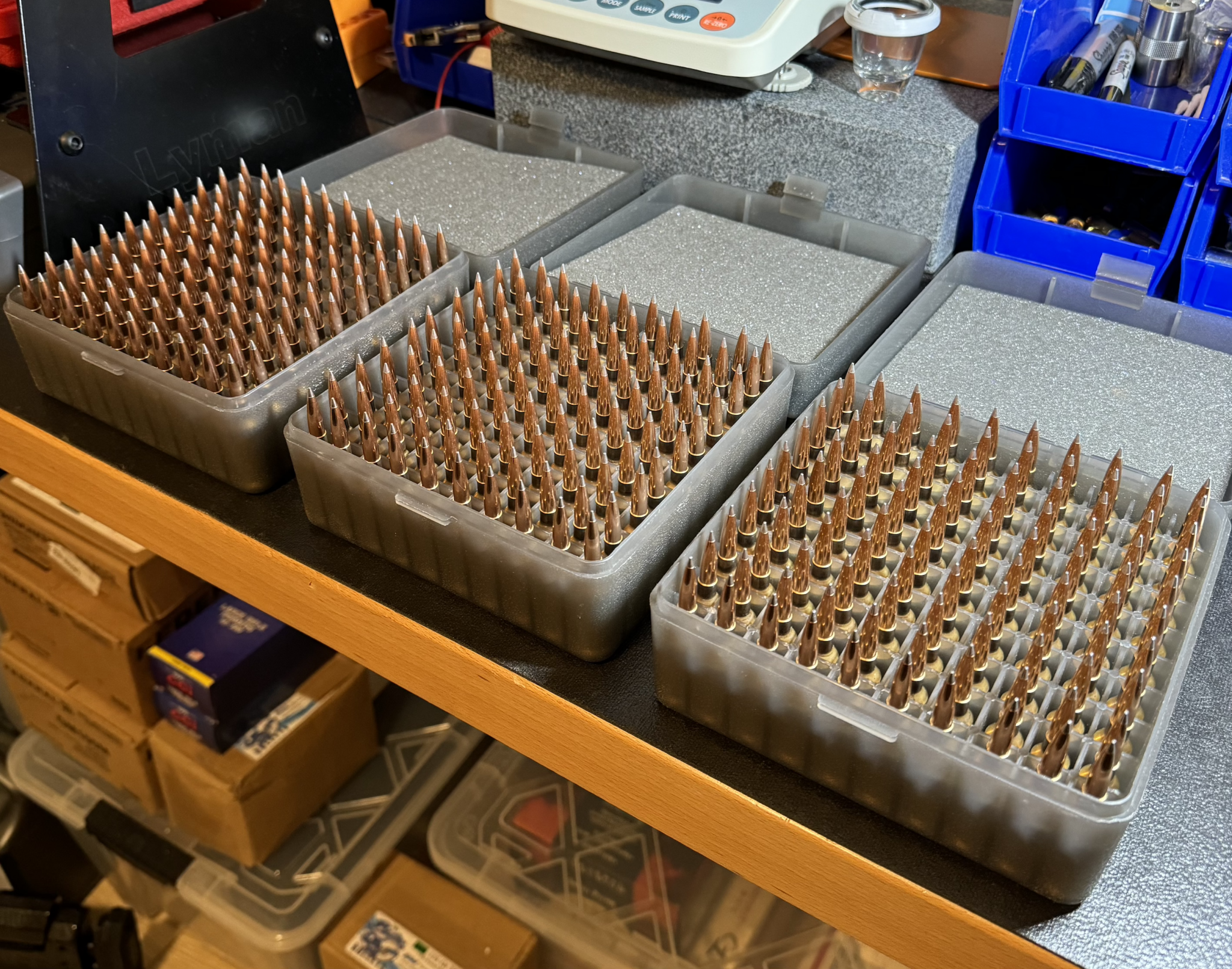

1200rnds 708 for the M5. All 308 brass reduced to 708 single stage press hand primer…
Wow. That's a lot of hand priming! Might want to check out the ugly reloading primer. It's great and will give your hands a break. Though I do live my hand primers too.

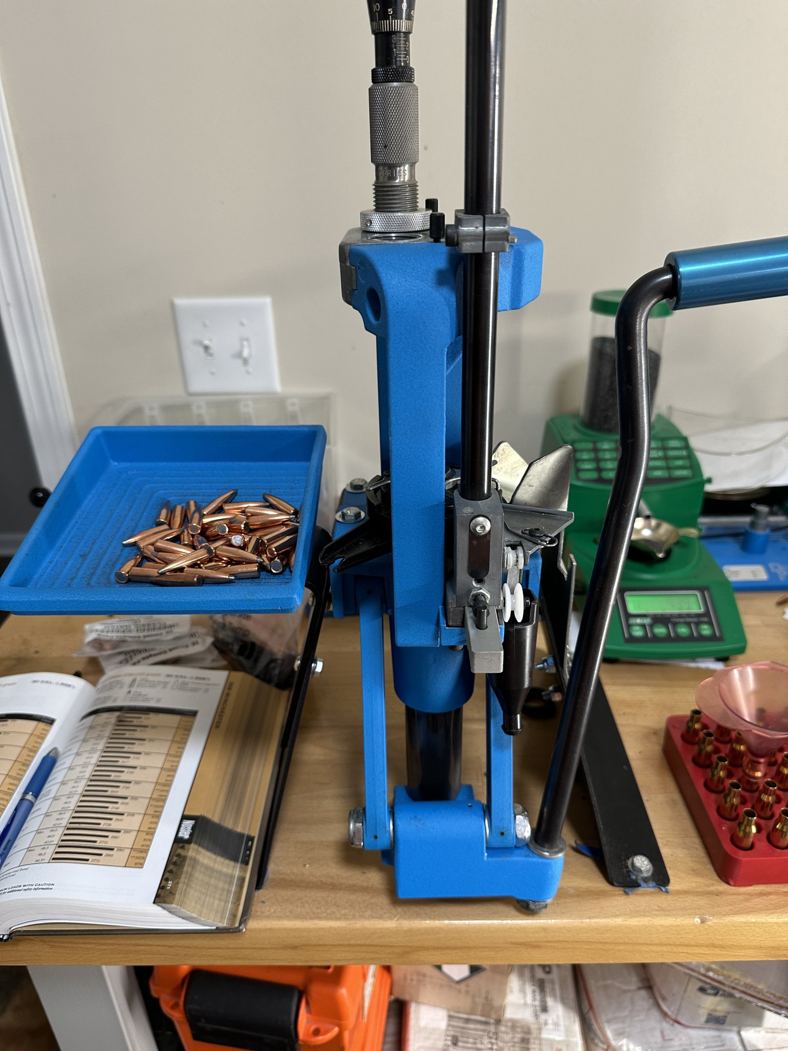

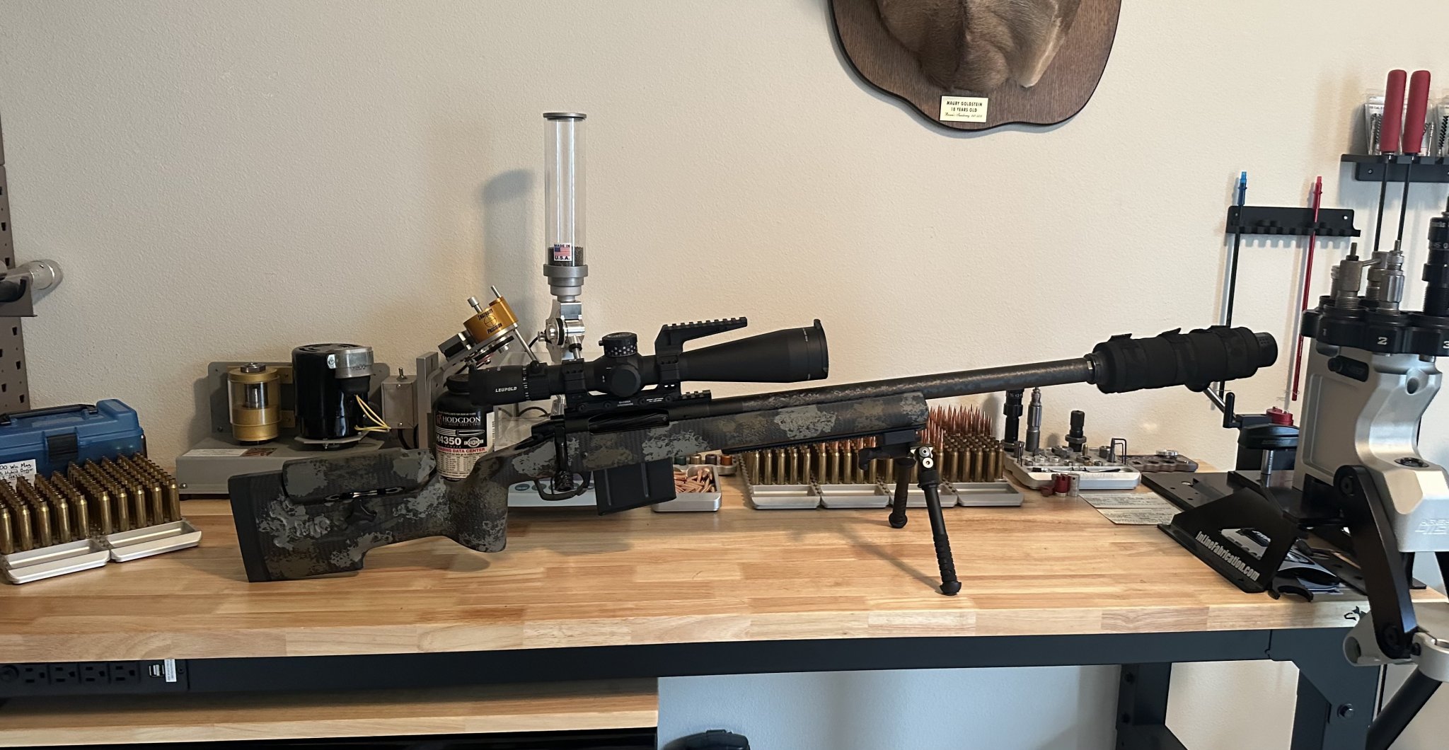

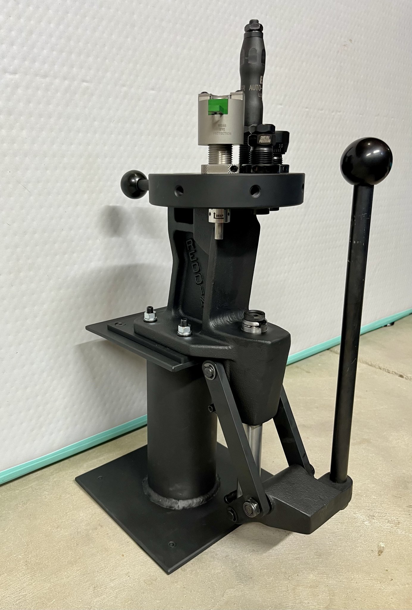

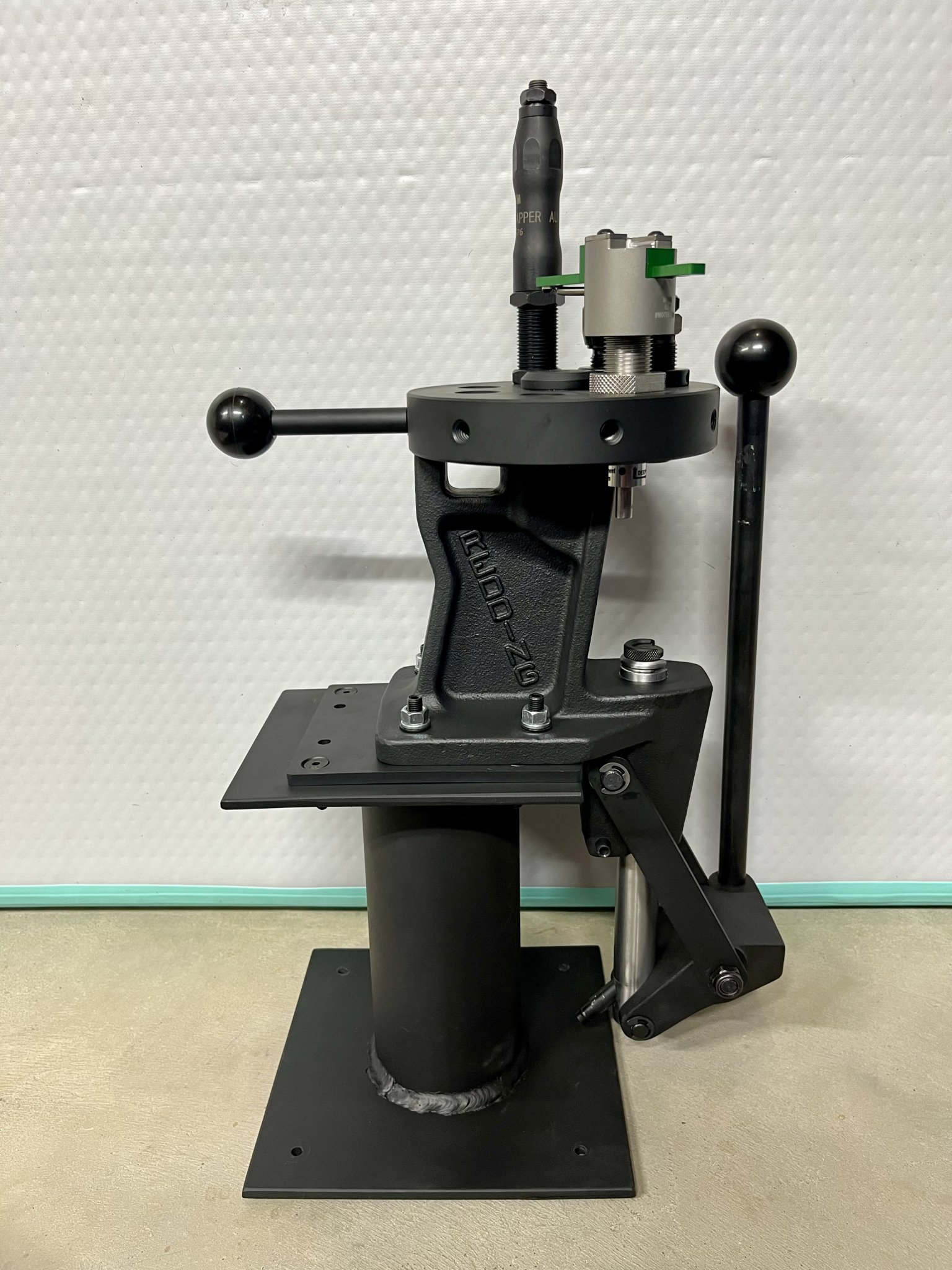

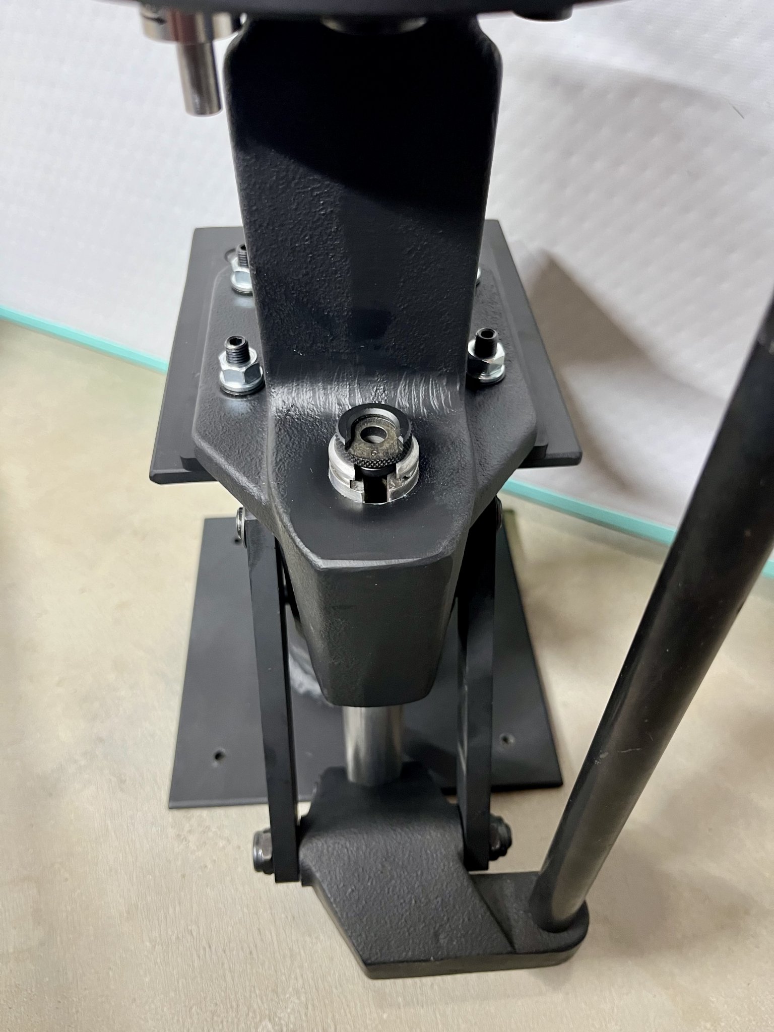

Went kinda nuts on my Redding t7 project. Fabbed up a mount for it, added the Creedmoor sports turret head, and bushing kit, lobbed off the factory priming arm and re profiled/blended the front. Stripped all the powder coat and cerakoted everything graphite black

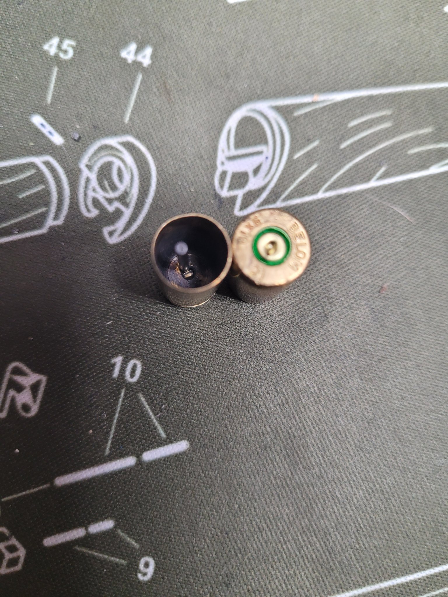

Belom evidently crimps and seals thier 9mm primers.
This is why I deprime (or attempt too) on the Lee Processing press before putting them on the 550. I've never seen a primer stretch so far and not come out. I had to remove the shell holder and use a punch to flaten it back out to get the cases out of the shell holder. Then sort them all out.
The factory Belom shot well, but I'll be using the rest where it's a lost brass event. Not worth the headache.

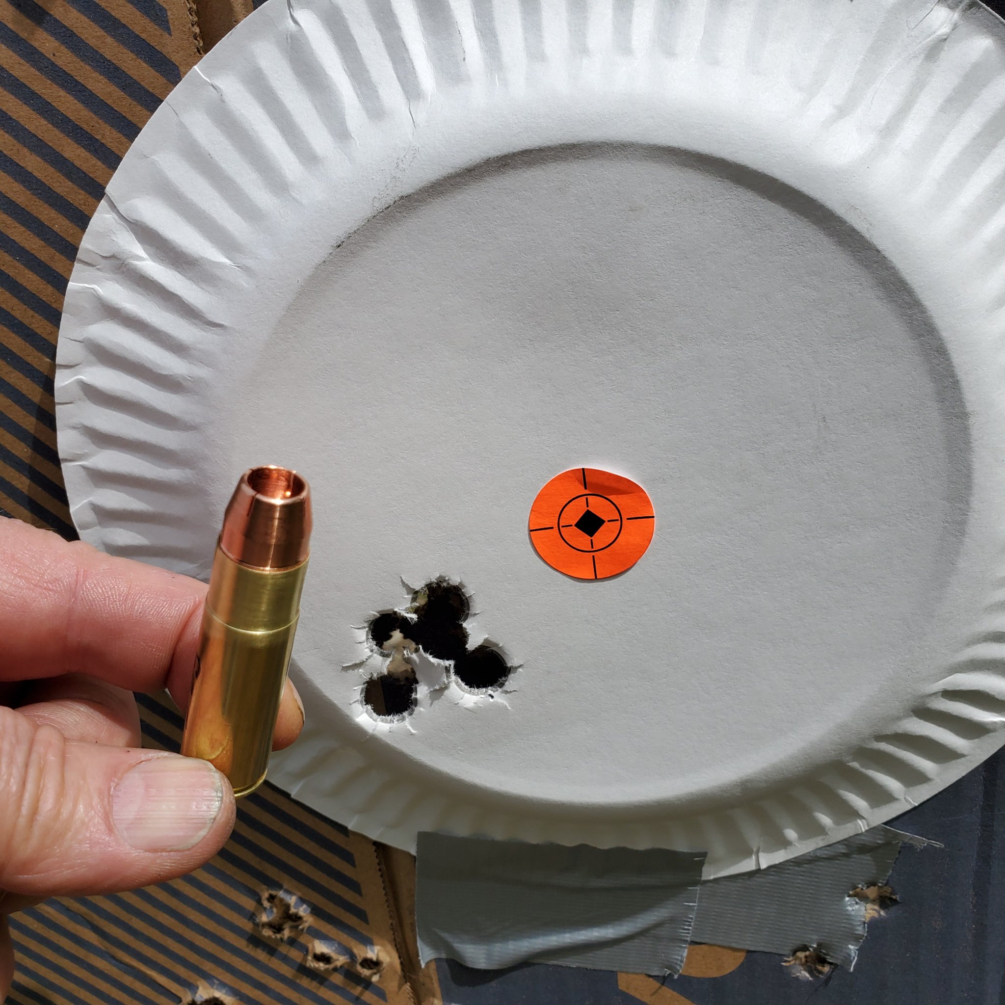

I finished up some 510 Whisper load development.
Then went out and tried them out.
Here are some 750 Amax ready to be tested.
Most were a bit high for subs in the 1200 fps, ran a few up to 1525 fps for the 750 gr.
A fun day.
Any idea of expansion you get? Not that it probably matters with 750 gr projectile lol
No haven't tested it in anything.
It was strictly, seeing what powders are viable for this caliber, and where they are on the velocity scale, I order to develope some good loads, for subs and supers.
But this .510, 350 gr segmented copper hollow point only needs 900 fps to expand ...I ran them at 2450 fps and 4700 ft/lbs of energy with good accuracy.
For a good hog or bear load, that will definitely expand, as its designed for that.
Also available for full expansion at sub velocities is a Maker 750 gr segmented copper hollow point, I believe it expands down to 750 fps. With huge expansion, probably a 2.5" or 3" dia circle.
Lots of options today in .510 dia. As sub hunting becomes popular.
I also have the 8.6 Blackout, with a 338 diameter 350 gr Maker, pales compared to the .510 Whisper with a 750 gr Amax.
But a Maker 750 gr segmented hp is available for the .510 Whisper too.
