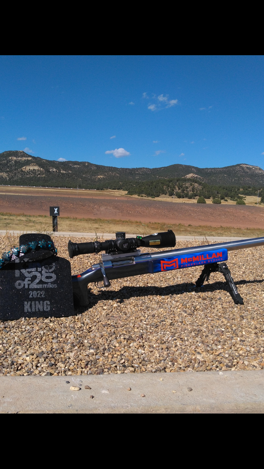

No giraffe neck needed and that's 94.4 moa in the base and mount. At Raton I needed 32.5mil to hit at 2 Miles and still had 2.5mil left in the turret + the full reticle to hold if needed.

I'm not running a Charlie or a prism anymore, it's extra shit to look through that's not 100% reliable and amplifies the mirage even more at extreme ranges, and it adds to time during transitions if you need it for a further target during a string of fire. Starting in June this season I went to a 94moa offset which is 35" high on my rifle at 100yards. It's pretty much a perfect zero at 1550 yards. It worked good enough for 2 firsts at Spearpoint, 3rd at the Castle, Spearpoint season championship, and the crown at King of 2 Miles.
