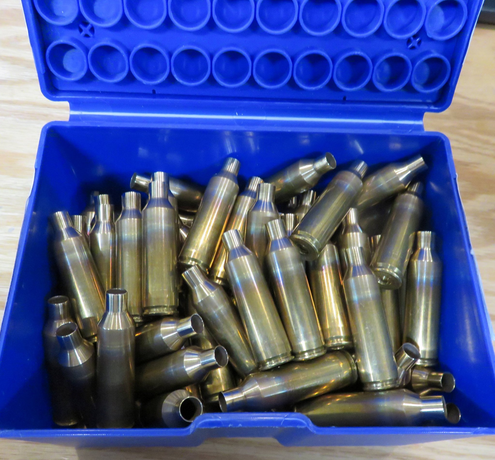

This is what my annealed brass typically looks like:
You're right about annealing involving both the neck AND the shoulder. As far as temperature goes, annealing is a function of temperature AND time. The hotter the temperature the shorter the time needed. When annealing our brass, we don't want to take too long so as not to do any annealing in the lower part of the case . . . especially the web area. The body needs to be hard enough for enough spring back so that it releases for ejection. As you say, 750°F is what you want "at least" and it's ok if neck temperature goes somewhere between 750 - 1,000°; much hotter than that can result in the neck being too soft and won't hold the bullet well.
Hence why I mentioned using 900F Tempilaq as well.
