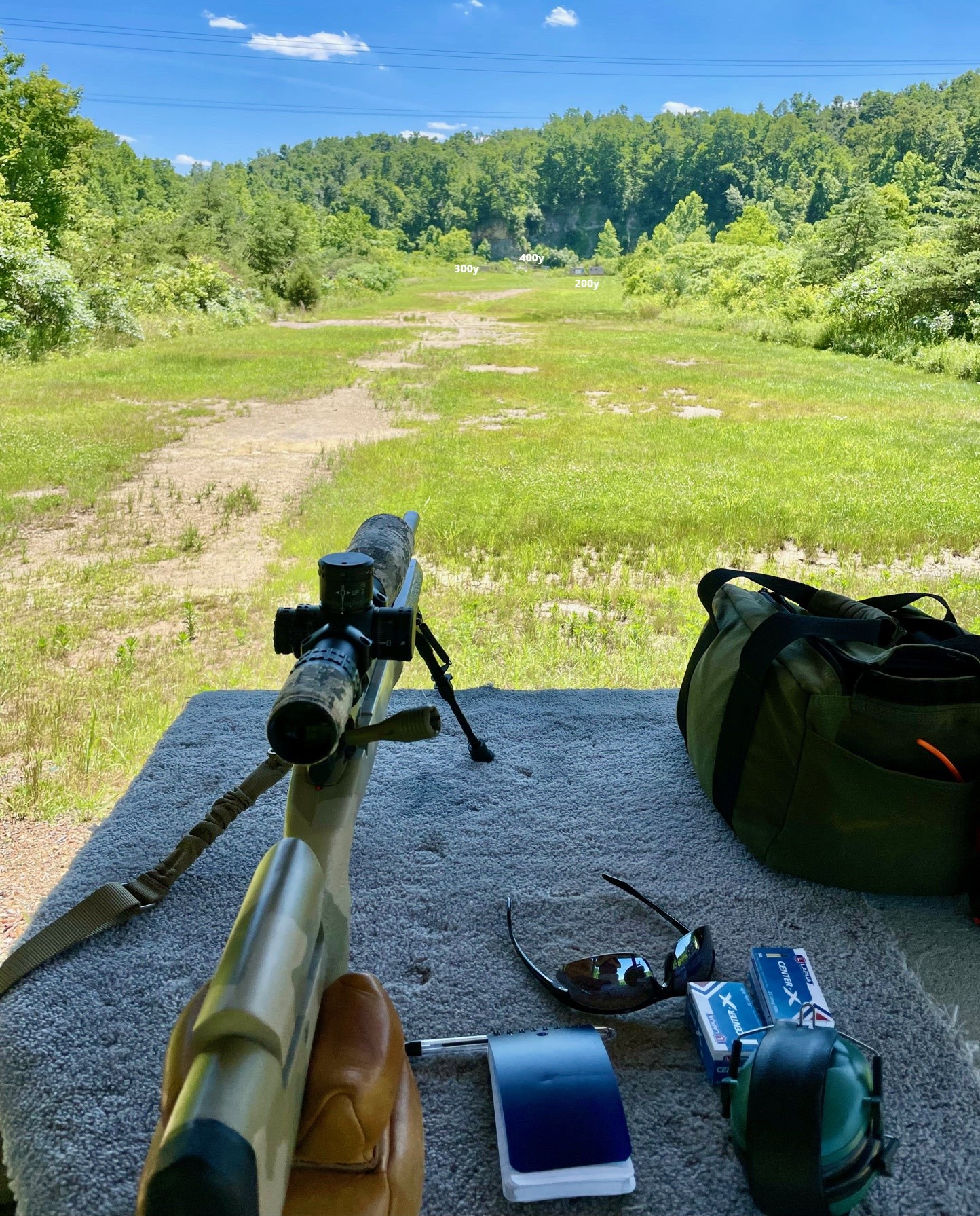

A friend and I have shot 22 ELR out to 400y which is the limit of our local range. At 200y & 300y is is fairly easy to hit a modest 8" plate with most if not all rounds once you have your dope sorted out. Going to 400y is a big step. We were able to hit a IPSC tgt with regularity once we had the windage and elevation figured. The temp changes affect the elevation by a tenth of a MIL or two. Wind is a huge factor. Spin drift another. I have seen wind pushing us 2.6 MIL at 400y which is about what 37"? and that is not a strong wind.
My club has a longer range out to 600y but do not allow it to be used for any purpose except organized matches. I have not had the chance to use it to reach out further. I was using a custom Sako Quad with a Arken SH4 6-24x optic. Lapua CX ammo.
