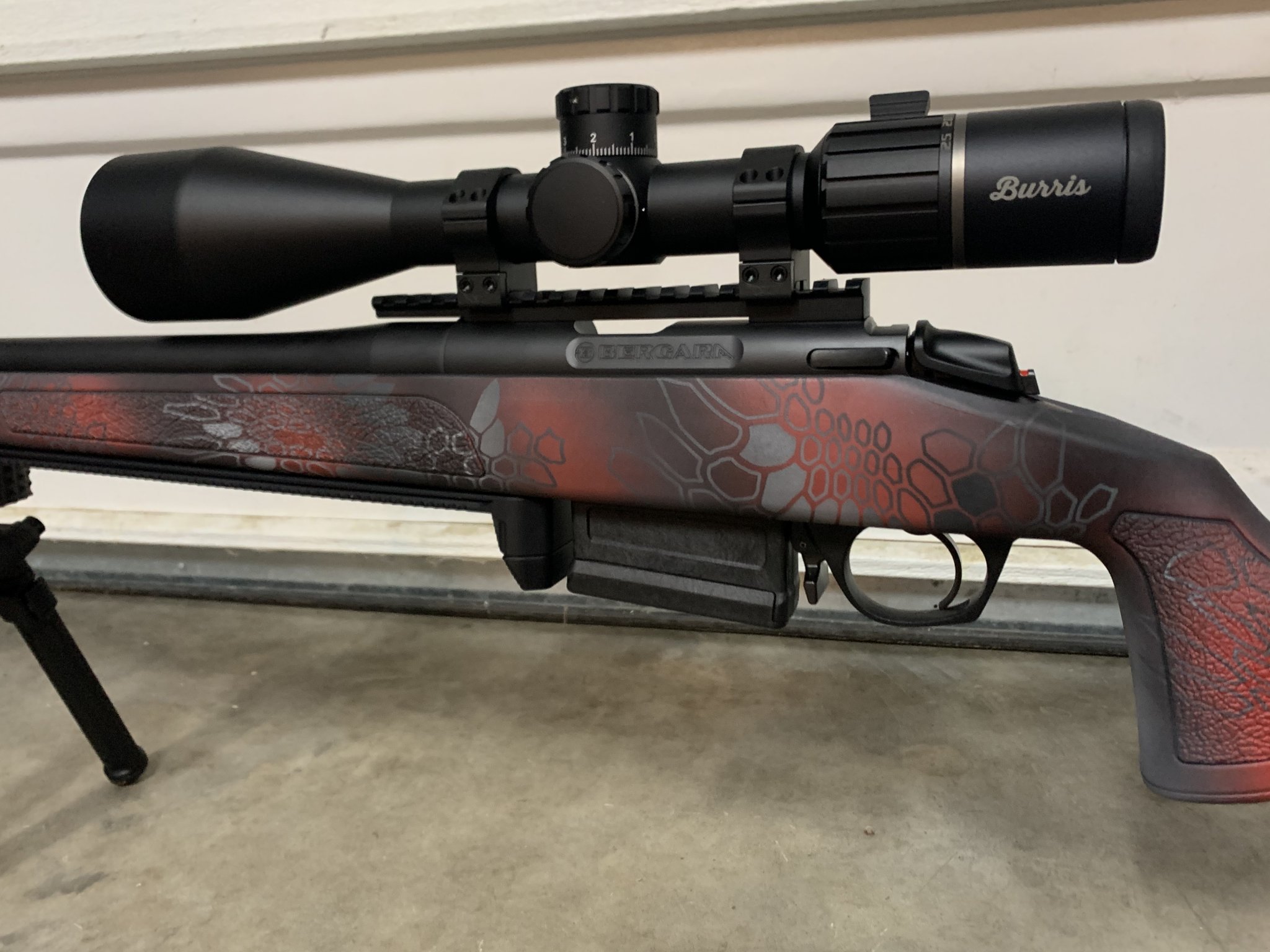

    LGS had Burris Xtreme for like $60 so I just went with them so I could shoot the gun that day. Might upgrade scope in the future if I do i’ll go with Badger rings

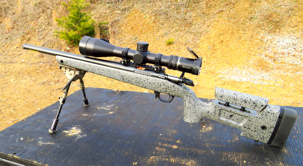

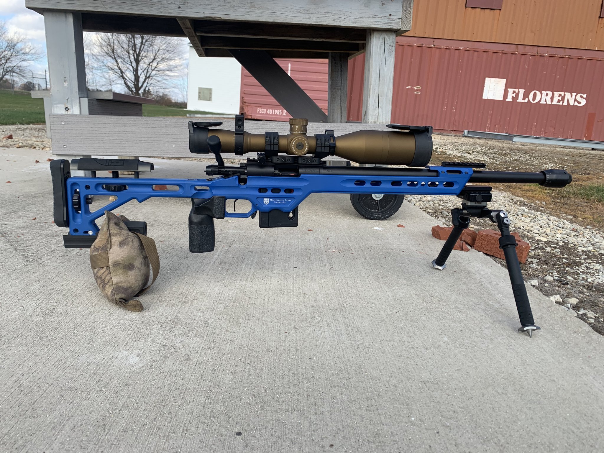

    I am running a LaRue Tactical 20 moa rail. Burris RT25 5-25/56 30mm with Warne med rings.

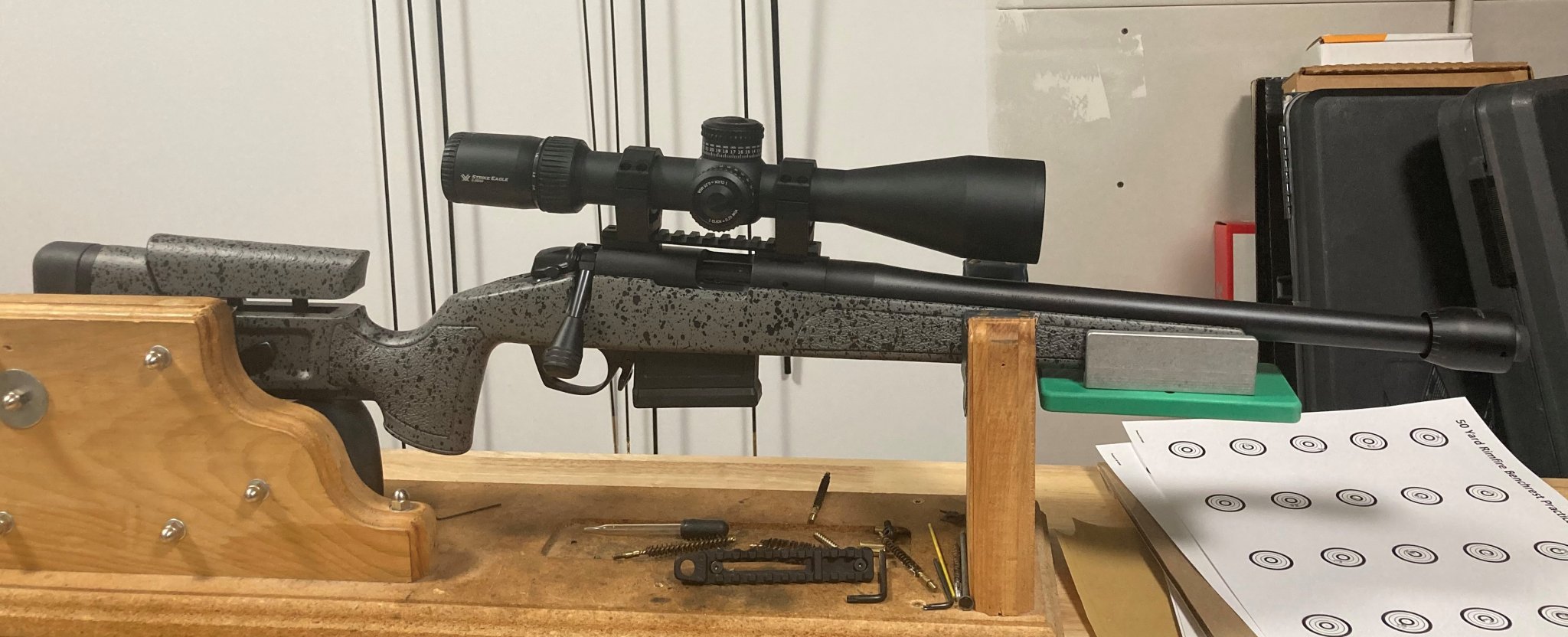

    I run 34mm tubes and 56mm objectives with caps on most of my rifles. I've used Vortex PMRs in 1.0" and 1.1" height as well as Athlon medium rings in 1.09" height, all on 20MOA rails. They've all worked fine. I slightly prefer the taller 1.09 and 1.1 inch rings for head position, but the 1.0 inch rings provide plenty of objective clearance on my B14R also.

    I’ve got a B14r with a Strike Eagle 5-25x56. I threw some Vortex PMR 1.1” rings on and have plenty of clearance. I often think maybe too high, but when I get behind the scope it feels great. 🤷🏻‍♂️

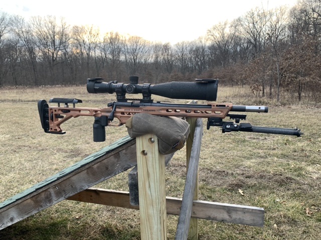

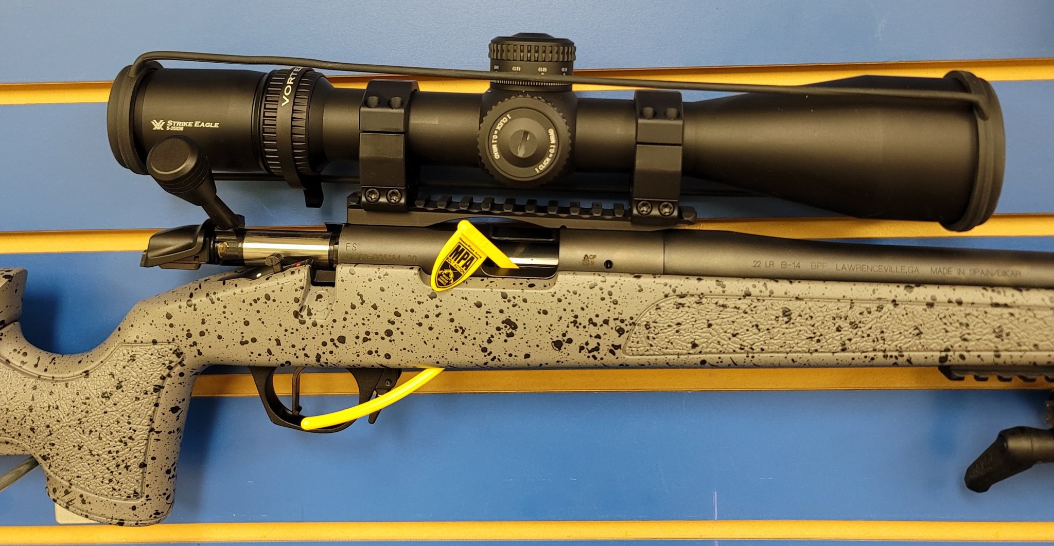

    I'm running a Vortex Strike Eagle 5-25x56mm with Vortex Precision Matched 34mm Rings. Rings are the 1.10" height. I'm running a 0 MOA picatinny scope rail. You'll see I just installed the Kinetic Security Solutions ATS tuner, but haven't gotten to try it yet.
