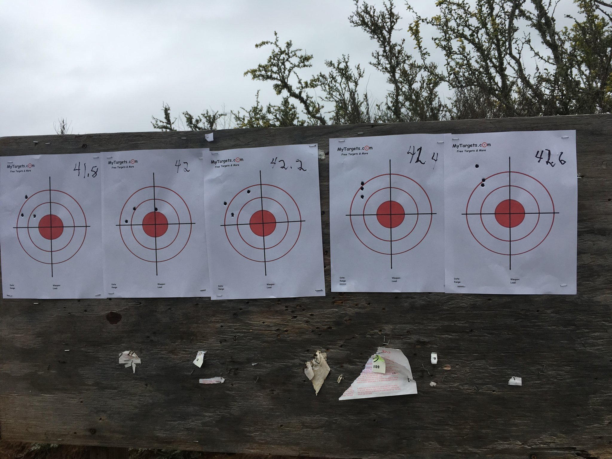

    Shot round robin style at 300 yards
    Put up some 1-2" dots only on blank paper (smaller aiming point)
    Reshoot it but shoot them as individual 5 shot groups and take plenty of time. (assuming RR style means 42 then 42.2 then 42.4 etc and back to 42 and back down the line)
    42 and 42.4 have the best vertical spread. Hard to say where the horiztonal is coming from, wind, getting off the gun, trigger pull, etc.
    That is precisely how I shot those targets and that is a 2 inch dot. I went up the scale one shot with each charge weight. Then a cooling., Then down the scale the same way cooling. And then up the scale. There was a bit of a breeze from the right.

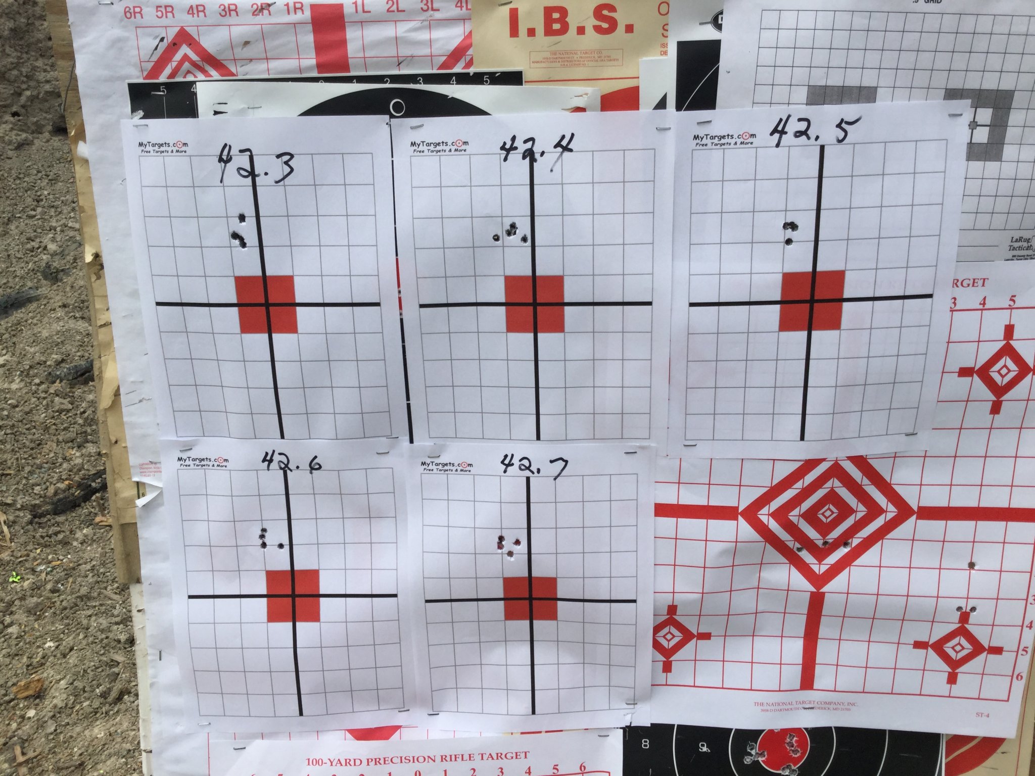

    I would test this, 42.3, 42.4, 42.5, 42.6, 42.7 just to make sure you arent seeing a fluke.
    I will try that, it will probably be next weekend before I have access to a 300 yard range. The Hogden manual showed a maximum size charge weight of 42.6, but I was showing no high-pressure signs, I had an experienced reloaded observing. In another publication I saw loads with the same powder up to 44 g, that is H4350

    Yeah I would say shoot them as groups.
    If you're moving, breaking your position, etc between shots in each group there could be some variation caused by that as well.
    I am assuming that you are not familiar with the OCW method of load development. This is exactly not what he is trying to accomplish.
    You can and probably should do OCW at 100 yards in order to remove the possible influence of wind on your results.

    None of that matters when we can see the results on his targets.
    One area looks much more promising than the others. (not denying more complete info wouldn't be helpful)
    But its also mostly in his previous posts.
    I think that Mr. Spife is right. You stopped at 42.6 and said that there is no pressure signs. You still have vertical and that suggests that you need more powder. Good groups are small and round. I would keep increasing powder in 0.1 grain increments until
    (a) you go through the node and see your groups grow or
    (b) you see pressure signs.

    Yep. 42.5gr and play with seating depth to see if you can find a slightly less vertical group. That will . But honestly, a .3-.5moa group at 300 might not need much tuning depending on your skill and equipment.
    If this is a custom barrel, I'd say you could likely tune a bit more. If it's a factory Ruger or someth4 similar, I'd take .5moa or better and walk away smiling.
    16.5" Criterion barrel. I'm thinking node may be narrow. Which way on seating depth? Or better question what increments?
