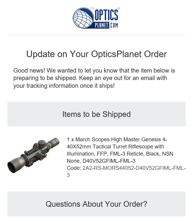

you receive your March yet? I'm curious on your first impression.
Well...
Since this worked out so well after you asked about it, can you ask about my action next? :)

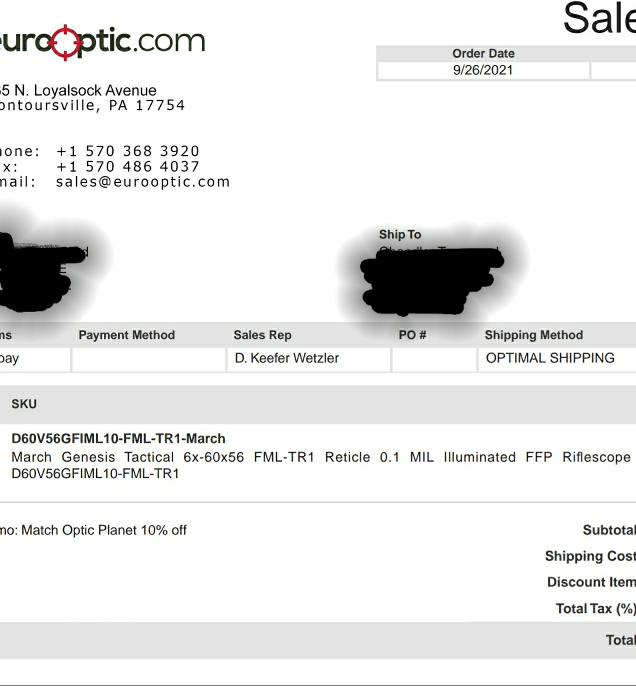

Tell me more. How was the unboxing? Did you mount it on the rifle?
Mounted on my 37xc build. Unboxing of course is amazing if you have ever seen a March. Comes in a linen lined wooden box :)
Super easy to set up. Scope is amazingly clear and surprisingly lots of light at full mag. I was worried it would be dark. Looks clearer than our spotting scope
For me, superior to my ATACR with external mil adjuster (charlie tarac). Mark and Sam Afterwork gave it great reviews which made me make the jump. Glad I did now that the pain of the price is over
