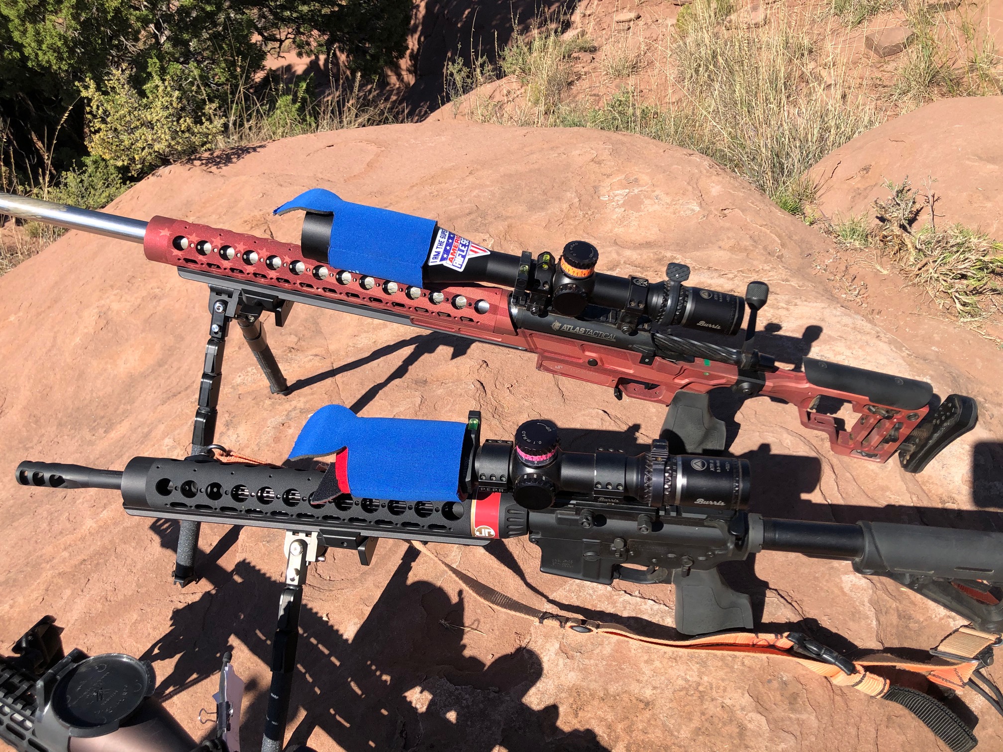

Already been mentioned a bunch but I think the 3-18 is about perfect. AR's these days are so stinking accurate no reason not to have some higher zoom zoom for longer range shots.
Photo taken at Competition Dynamics Team Safari. My partner and I added some top notch sun shades to help out with the morning sun. Shots taken from 200-600 yards with relative ease.
GL!

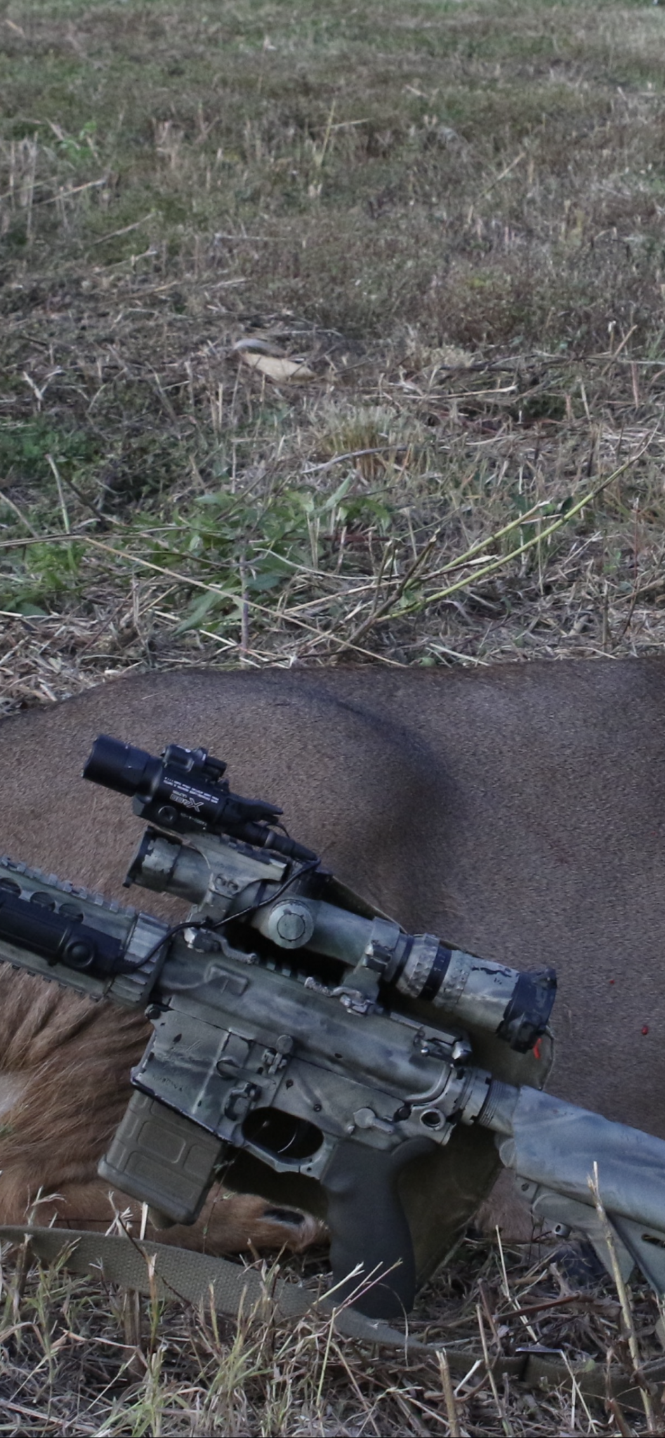

I just mounted a new scope on my old 5.56 last night. Seems nice. I will sight it this afternoon. NIGHTFORCE 1-8 ATACR. DMX reticule.
Lower is with 2.5-10x24
