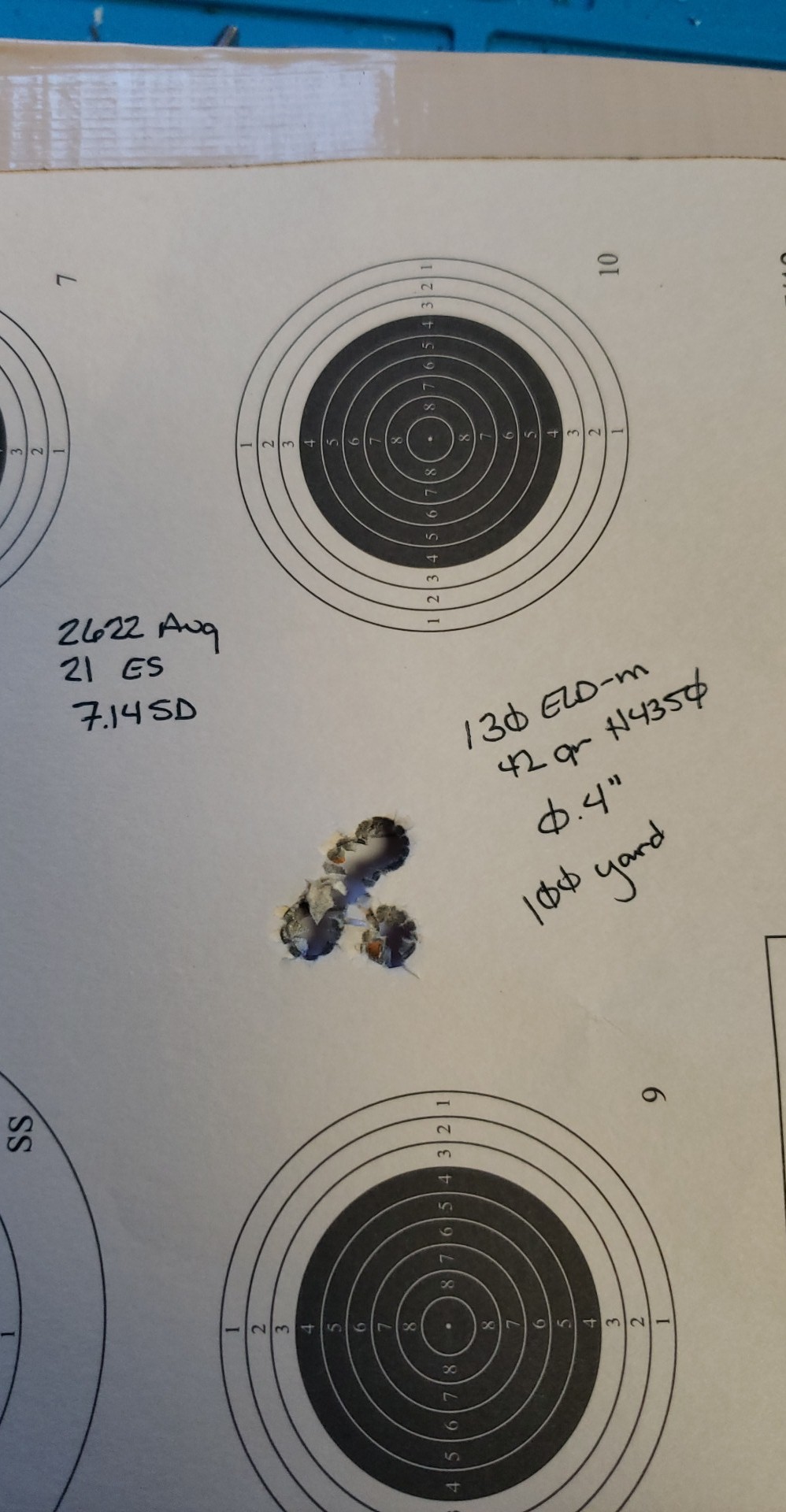

Was able to get an SD of a little over 7 with starline brass. Was honestly shocked to be honest. Have yet to shoot at any type of distance yet, but that is planned for either this week or next.
Mine was just 5 to get a base line from multiple loads. Loading up more to get a few larger groups to see what happens
Agree though, that shooting fewer rounds really doesn't show the full story.

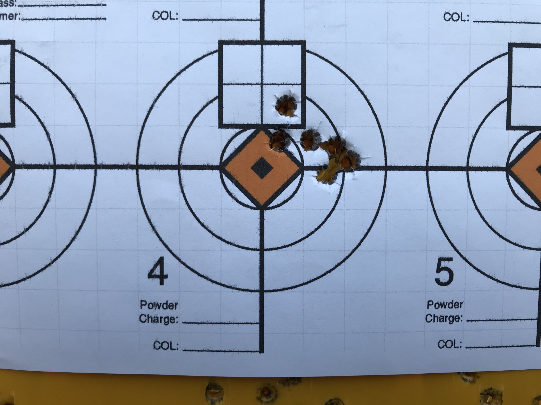

Shot this load at 200 yards yesterday. Only 7 shots. The 4 that are stacked are .16moa!! The other 3 opened it up to .47moa. Still a contender and I’ll massage it a little bit on either side and see if it’s repeatable.
42.0gr H4350
2843FPS with and ES of 9.
.120” off lands. CBTO 2.097”
140gr Berger Hybrid Target
Alpha LRP brass
CCI BR-2
