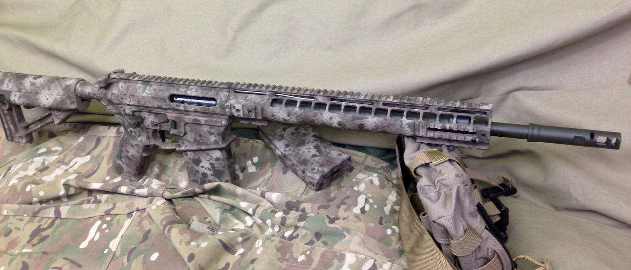

Here is one of my recent builds using the SWS (Superior Weapons Systems) E1 15" handuard.

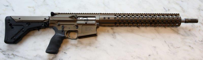

well here it is
spikes dynacomp, BCM large latch, 16" dpms I snagged. 14" centurion CMR. ok get this, I got every part of this cheap. really, it was expensive, but I saved on every part. and it still cost freaking 1100-1200 I think. ill have to do the math. but dang. I think I was in 1300, maybe 1500 for the initial first whole rifle, lol. I hope I don't get a hard-on for the MKM

well here it is

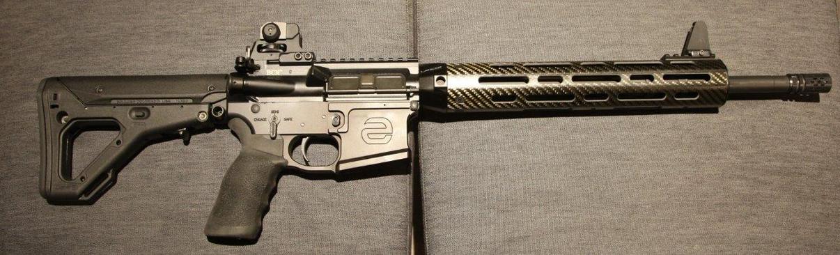

FWIW, this is what I end-up with (work in progress)! The rails line-up perfectly, the barrel nut is not on.
Barrel: Fullton 16” Ultralight
BCG (not shown): Shadow Ops
Handguard: Samson via 556 Tactical
Lower-receiver: Iron Ridge
Upper-receiver: Sun Devil 308 slickside
Edit, missed the photo above showing final rifle--so you settled on a rail... Axeman, can you put your 308 on a scale, as is in photo? Mine is 9.4lbs, as shown with only non standard part being a slightly heavier buffer weight.
mine is 8.5 pounds as you see it. standard DPMS 308 buffer. cant recall the weight, but its not a heavy. the upper you see in my sig comes in at 10.25 pounds complete without the scope. almost 2 full pounds lighter with 2" less barrel and the Centurion
my barrel in the sig photo is 18" and the upper with the Centurion CMR is 16"

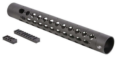

JP is working on a version of their Rapid Config hand guard that will work on the LRP-07. if they are lighter than the regular JP hand guard, i will be looking to get one of those once they release them.
Things add-up quick!
so is this a discontinued handguard? , I can only find the star10 on their website? what model is this? thanks in advance
