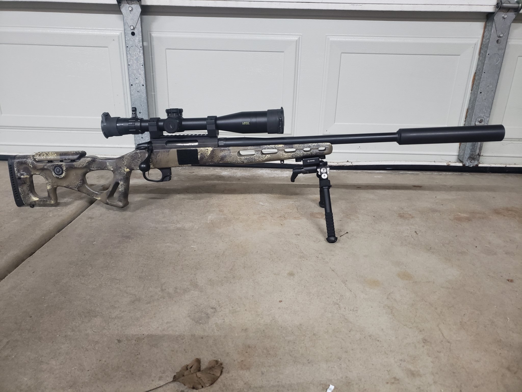

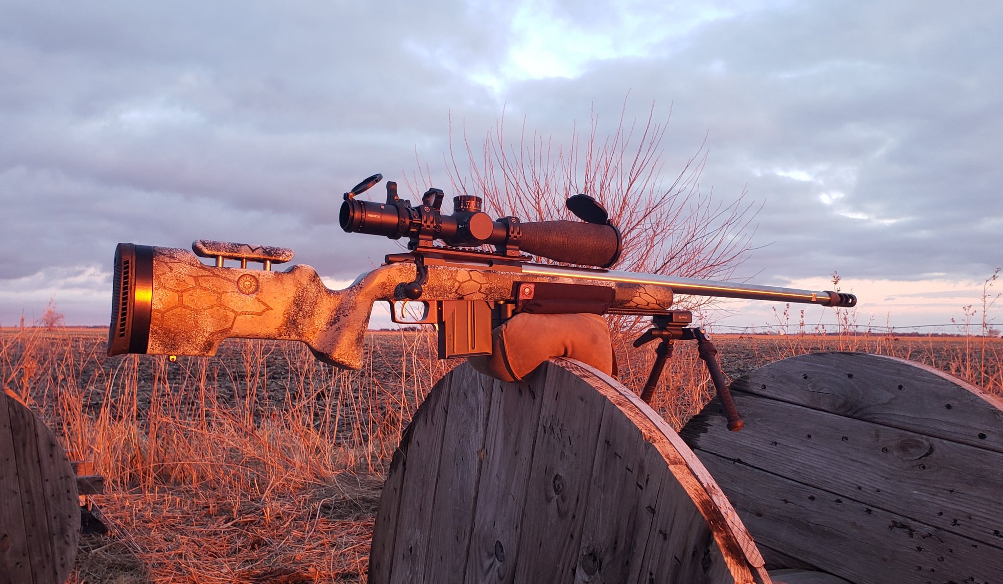

The biggest benefit of the tikka LA and SA sharing a foot print is if you found a good deal on a 30-06 but you wanted to shoot 6.5cm, all you have to do is rebarrel to new cal and change bolt stop and you have a .475 bolt head, short throw action.

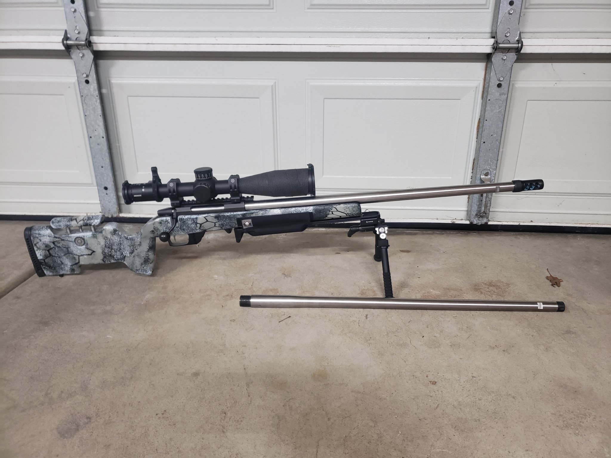

This. I built a 22BR off a 270 that I bought for the action and trigger. Put in a High Velocity Hunting adjustable bolt stop and was gtg. Made the rifle a switch barrel this year and added a 6.5 Creedmoor barrel to it. Adjusted the bolt stop from short to medium and it works for 22BR and the 6.5 Creed.
I can swap barrels in five minutes or less, change magazines, and go shoot. I have 3 Tikka rifles, a CTR that started as a 260 and is a 18" 6.5 Creed, my match rifle with 22BR and 6.5 Creed barrels, and a 223 Varmint

. I have taken factory barrels from one action to another and they headspace perfect.
I can swap barrels in five minutes or lees, change magazines, and go shoot. I have 3 Tikka rifles, a CTR that started as a 260 and is a 18" 6.5 Creed, my match rifle with 22BR and 6.5 Creed barrels, and a 223 VarmintView attachment 7272242View attachment 7272243View attachment 7272246View attachment 7272252View attachment 7272253View attachment 7272254. I have taken factory barrels from one action to another and they headspace perfect.View attachment 7272262
Do you just snap your barrels tight with a wrench when you switch back and forth?
I am going 40 ft/lbs with a torque wrench and a crows foot. Had some mis-communication with my smith and he headspaced both barrels at 100 ft/lbs. I started at 25 and works my way up to 50 with the barrels in a vise and the ejector out of the bolt. Couldn't tell any difference at 35. I can still hold it between my legs at 40, so I stayed there. Still breaking in both barrels, so I will see how repeatable they are when I swap them. They are both shooting lights out so far.

I use 75 ft lbs on mine but aren't switching barrels without a vice. I'm not to big on the switch barrel idea. I would rather have another rifle ready to go than rely on switching back and forth. Hell I don't even switch bipods around. I may try it out on one soon enough and I may change my mind.
