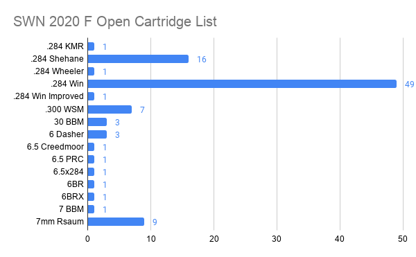

If you go strictly by what's winning most big state or national level LR tournaments currently, you see predominantly .308 Win for FTR, typically a 200 gn projectile of some sort, and for F-Open you mostly see straight .284 Winchesters (or something close to it) running 180-184gn pills.

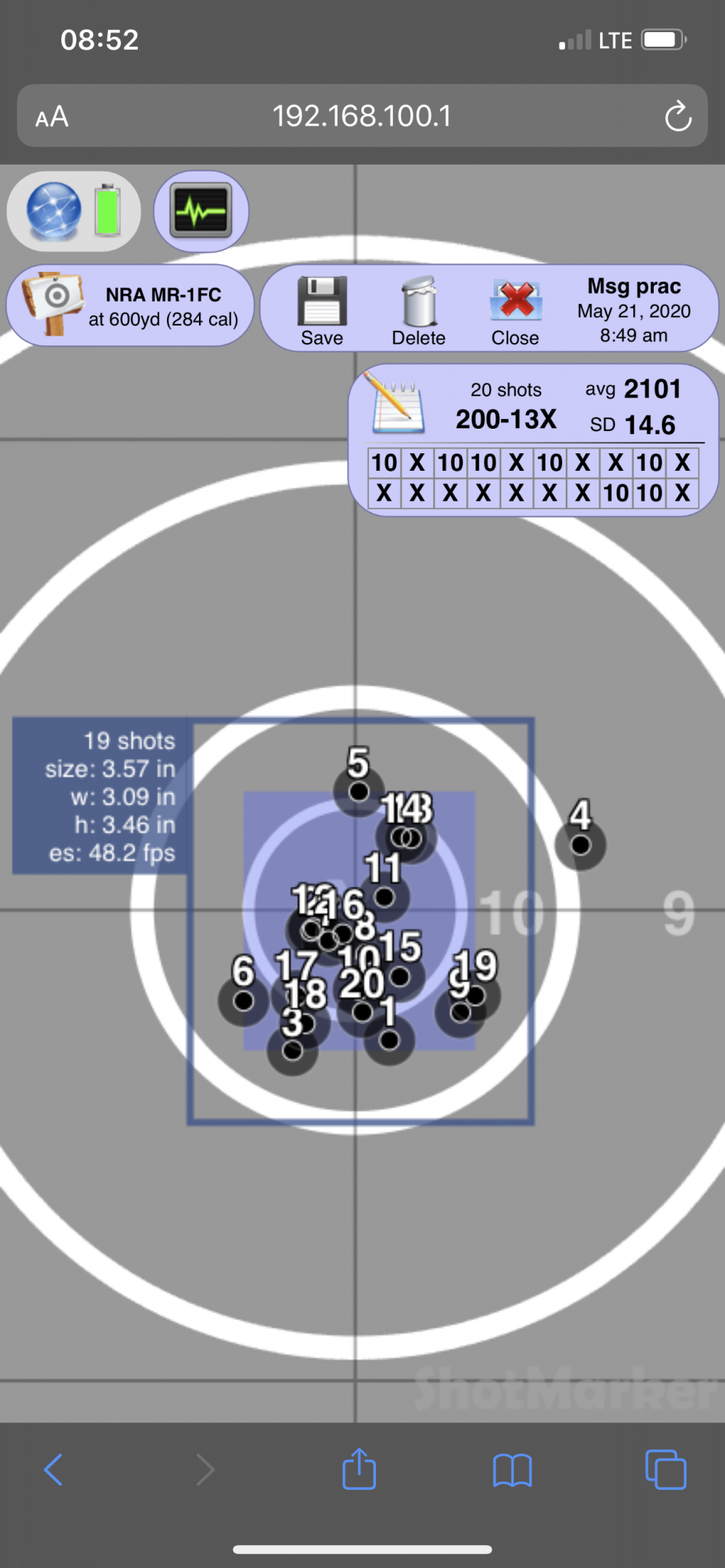

I shoot in f open and At 600 yards I see nearly all 6mm bullets: dasher & br unless it’s a very windy day and then I see some 284. At 1000 you see more 284 wins start to come out but 6mm is still very competitive. I shoot 6 dasher primarily at 600.
If you would like to shoot f class without spending a lot the ftr category is definitely a place to start and without needing a 1200$ rest makes entry a lot more competitive
