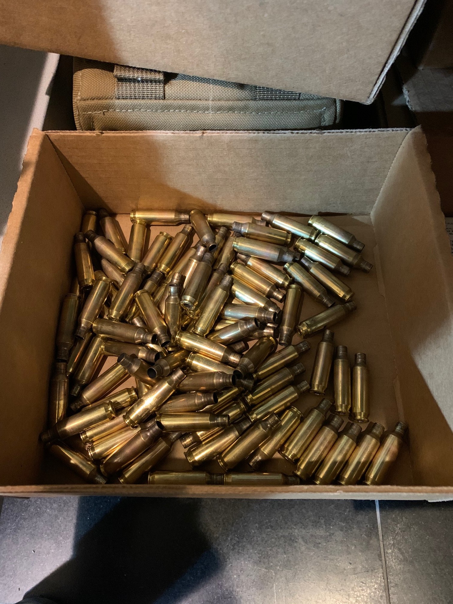

I was at the Brawl and I saw Jorge get out of his chair and crawl under the excavator trailer which never moved for 15 years looking for “A” piece of Dasher brass before the new stuff.
I was like, damn Jorge something under there is gonna bite ya and kill ya for a single piece of brass, South Texas is the last place I’m crawling under an old anything
I do pick up my 22 brass most of the time. Obviously not at a range or a competition, but if shooting on my own land or other private property I try not to leave 200 pieces of brass behind every time I shoot.
lol I’ll try and remember a picture tom of where we shoot rimfire. Probably 10k pieces there right now slowly sinking in the ground.

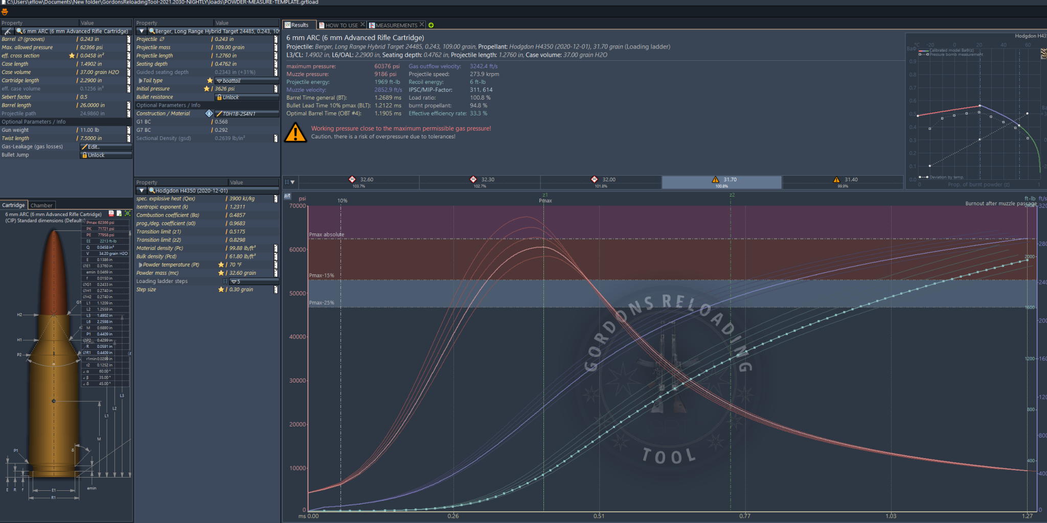

Below is a GRT load for a 6ARC with the added capacity ss case. 109 Berger & H4350 and when P1 & Zmax line up like this, it'll shoot very well.

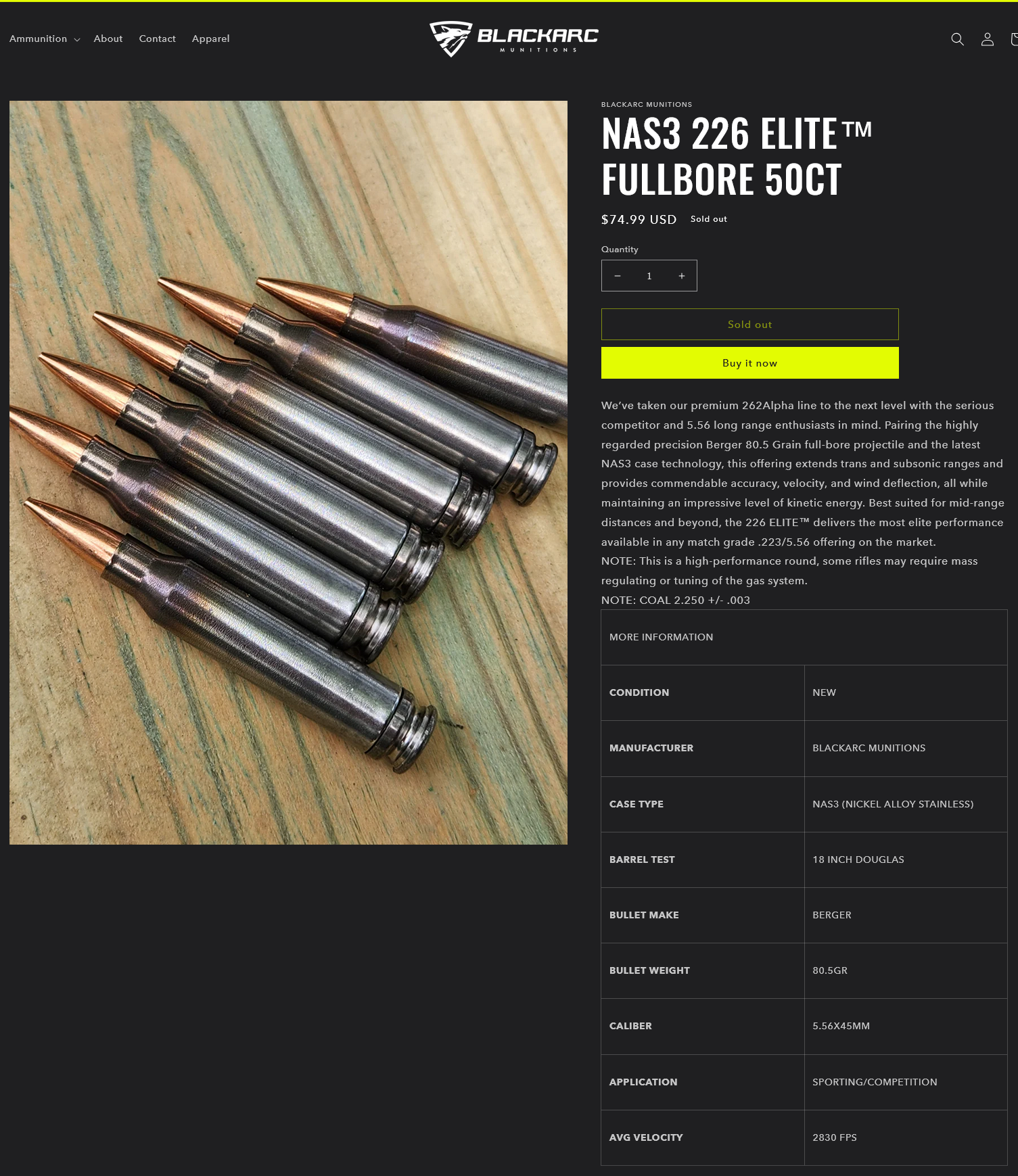

Example of factory loaded 5.56 below. 80.5 Berger's @ 2830 from an 18"

And, at $1.50 per round (for 223), it’s still not a more economical alternative to brass.
That’s factory loaded with Berger’s, but that’s not the point. That was just to show performance advantage.
For a lost brass match .25 per for brass is affordable.
Cost for a new guy to get in the game and reload this stuff is half. No cleaning, annealing, or FL sizing. This is assuming the QC on these is good?
