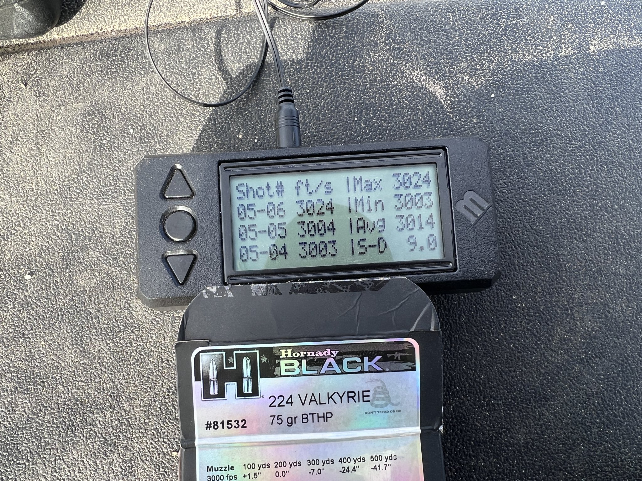

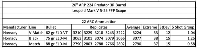

I posted this in another thread, but here are some real numbers from factory Hornady 22 Arc, from a 20” AR15. Good enough to “move the needle” in that direction for PRS? IDK, but these are factory offerings loaded at AR-safe pressures. A handloaders with a bolt gun should be able to do better in all respects.
And, my apologies to the statisticians, I’m not trying to publish a paper in a peer reviewed journal…
