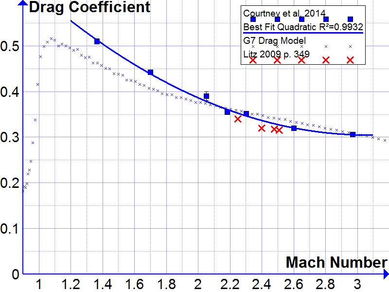

I'd be happy to answer the above questions for any of the drag curves our group has published. You can rest assured that if we publish a BC or Cd at a given velocity or Mach number, that we've actually measured the BC or Cd at the specified velocity or Mach number and we're not extrapolating from a much narrower range. For example, in the attached figure, we actually measured the Cds over a range from M1.36 to M2.98. The uncertainty in Cd at each Mach number is about 1%, but at one point is closer to 2% and shown with error bars.
This is a good example, let's consider it for a moment.
So you measured the drag of a bullet at Mach 1.36 (~1517 fps), probably over 100 or 200 yards.
My question is; what barrel twist did you use to test the bullet at this speed?
As a bullet slows down on a long range trajectory, its spin rate doesn't decay as fast as it's forward velocity, which means that if it was turning 1:9" @3100 fps from the muzzle, by the time it's lost 1/2 it's velocity, it will be spinning at a rate much faster than 1:9", probably closer to 1:6".
So my question to you is, did you fire your low velocity data points from a faster twist barrel than your high velocity data points? If not, then the data point is not representative of the bullets actual stability condition at that speed on a real long range shot.
Another question; didn't you publish on the effects of tip off rate affecting BC? If you fire the bullet at 1517 fps MV and you gather that data point where there's a 'tip-off' rate which reduces BC, then, again, it won't be flying as it really does on a long range shot.
And now to answer your question.
The reason my data points appear to be clustered tightly together is because they represent the center of the speed range tested. Since I test over long range, a shot with a MV of 3200 fps which slows to 1600 fps, will have a midpoint of ~M2.15. So that's where the data point would sit. My data points appear clustered on the graph, but my measurements are a more accurate representation of the bullets actual drag at long range.
This is another example of you dwelling on the minutia in order to twist the facts. Yes it's a fact that you tested a data point at M1.36. It's also a fact that that data point doesn't represent the bullets actual drag at that speed on a real long range shot.
I'm going to go out on a limb here and say that actual shooters actually care about drag models which actually put them on target at long range more so than they care about where your points are on a graph and why you say your way is better.
Thank you for clarifying the issues from your book that I had asked about earlier.
The stability was over 1.5 for all the data points in the attached figure. Sierra has done some very convincing work showing the consistency of BCs (and drag coefficients) for different twist rates, as long as the bullet is well stabilized. One should consider section 2.5 of the 5th edition of the Sierra Reloading Manual before suggesting that BC depends on twist rate for well stabilized bullets. For example, Figure 2.5-2 (Sierra 5th edition) shows BCs are consistent for the 69 grain SMK in barrels with 1 in 7", 1 in 8", 1 in 9", and 1 in 10" twist rates. There is only a reduction in BC for the 1 in 12" twist rate for that bullet under their test conditions.
Further, Figure 2.5-3 (Sierra 5th Edition) shows BCs are consistent for the 190 grain (.308) SMK in barrels with 1 in 8", 1 in 9", 1 in 10", and 1 in 11", with only a loss of BC (drag rise) for 1 in 12" and 1 in 14" twist rates under their test conditions.
Consequently, there is no experimental support for the suggestion that bullets that leave the barrel at Sg > 1.5 are experiencing more drag than they would if fired with faster twist rates (higher stability).
The bullets were all fired from the same barrel, which was fine, because the stability was above 1.5 for all the test shots.
Our earlier published paper concerned the effects of pitch and yaw in drag coefficients rather than BC. The effect is small (< 2%) in the bullets we used, requires very careful measurements to see, and has mostly disappeared after the first 50 yards.
Our shots with the smallest powder charges (low Mach numbers) have no discernable effects of pitch and yaw. The pressures at the base of the bullet as it exits the barrel from 6 grains of Blue Dot are much smaller than with a full power load, so tip off effects are too small to see. In the attached figure, the Cds were determined over 100 yards, so the effects of pitch and yaw might be as large as 1% at the higher Mach numbers, but are much smaller at M1.36.
One needs longer bullets with larger tip off rates to see more significant effects on drag.
You make this claim several times, but the truth is, you don't know what the stability level was of these bullets. The Miller formula (and its variants) are based around 2800 fps, with a correction factor that's good for small variations in Mach. The velocity correction is way off condition at a MV of M1.36. Even if you used a more sophisticated model like PRODAS, aero-prediction codes are notoriously bad at estimating overturning moment coefficients near transonic speeds.
So although the math suggests stability, the truth is, you just don't know that.

We've validated the stability formulas by turning down the stability at low Mach numbers. The bullets tumble when the appropriate formula predicts SG < 1.0 and do not tumble for formula predictions that SG > 1.0.
It's not just the formulas suggesting stability, the experiments confirm it.
I hope you can forgive the poor video quality, but I have attached a frame of a high speed video showing a 55 TTSX beginning to tumble near M1.2, just where the stability formula predicted it would for the given twist rate and environmental conditions.
In our testing of armor and terminal ballistics at low Mach numbers, we've found the predictions of our stability formulas very reliable (within 5%) down to M0.8 and we've shot a lot of bullets at M0.8 to M1.5.

We KNOW bullets tumble for SG lower than 1, and not for SG greater than 1. That's actually a definition.
What I'm questioning is the validity of your data points which are created in stability conditions which are different from what the bullet actually flies with on a long range shot.

You seem to be challenging the validity of the Miller stability formulas (which we have experimentally verified) as well as the long established results from Sierra that BC is independent of stability for well-stabilized bullets.
This is a more interesting technical discussion than the other rabbit trails. I want to see if you have any real data to support your claims.
I accept that the Sg of a bullet that was fired at 2800 fps and slowed to 1500 fps is higher than one that is fired at 1500 fps at the muzzle.
But if the Sg > 1.5 at the muzzle, there is no reason to believe the downrange bullet (Sg is higher) has a different BC because of the higher Sg. Damping of pitch and yaw may have raised its BC 1-2%, depending on the tip off and bullet length.
