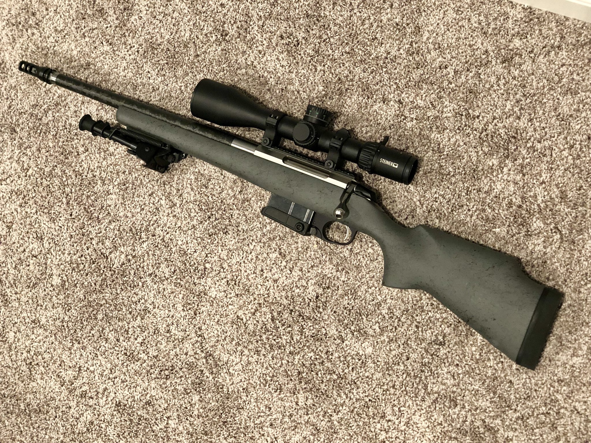

I went with the PR prefit for my T3. just got everything together Monday of this week. haven't shot it yet but I'm very satisfied with the overall fitment of everything.
