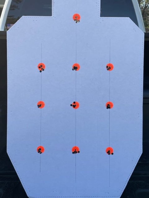

Who of you bullshitters claims 1/4 MOA all day? Show us all you proof?
My last target..............10......1" target dots..........
I have good days, and some not good days...........10 dots, 5 rounds per dot............over all a pretty good day, but take a look at the top dot on the target that was my cold bore shot of the day........the center one.........

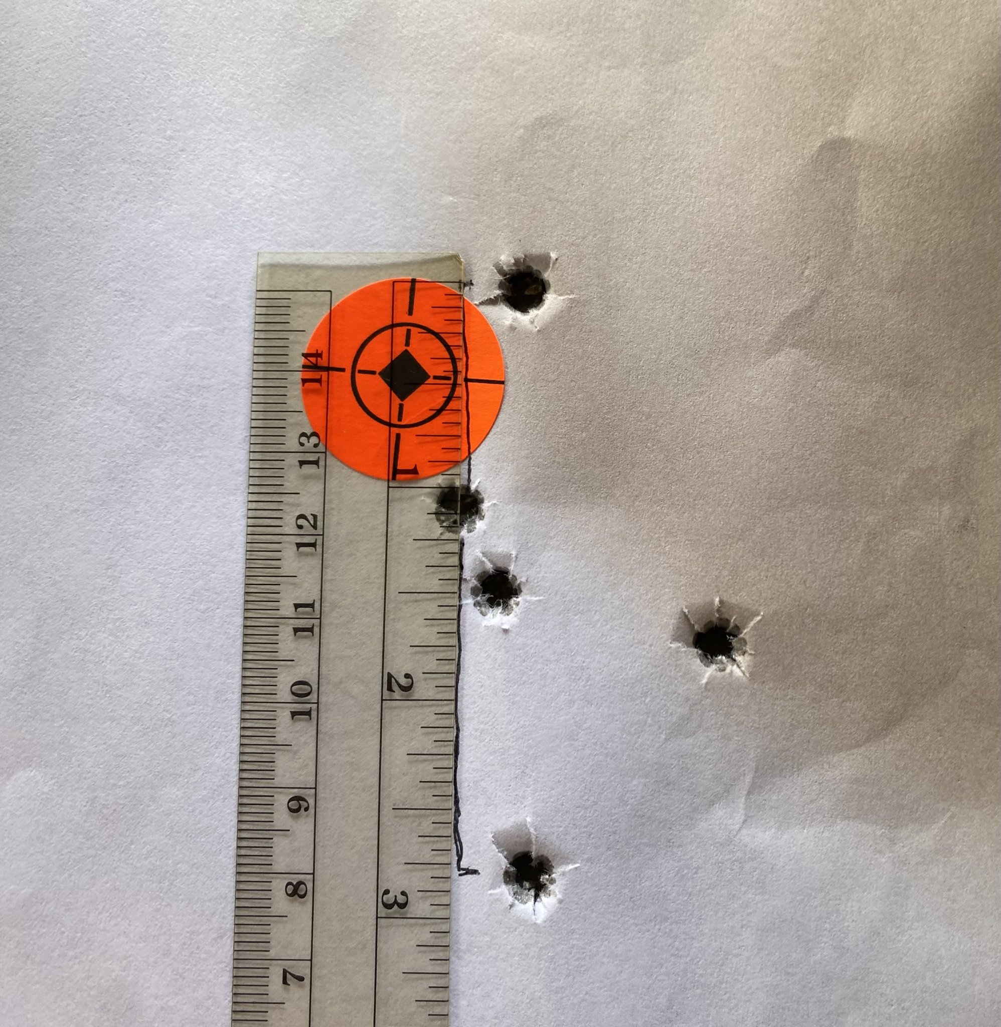

Ended up shooting two consecutive groups of 10 shots at 300 yards. Both were right at 2"...so I was a 2/3 MOA guy that day with that load. My rifle is much heavier than 11lbs too.
Not excellent, but I don't claim to be a 1/4 minute shooter either...

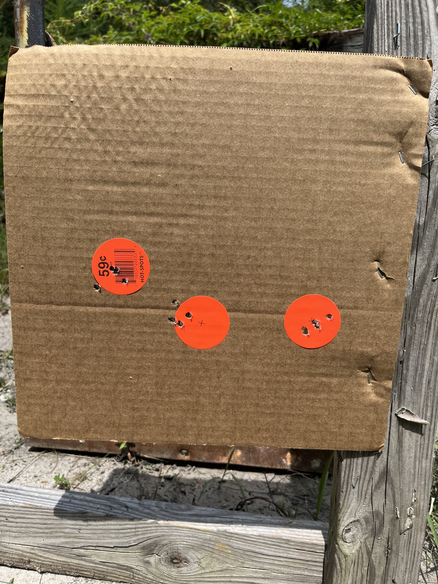

How about a 15 round string? Not .25, but sub moa on all three from a home built AR off the hood of my gator. Did I mention it was factory IMI 77g?View attachment 8544570View attachment 8544571
I like what you did there. 3 different targets to show all the actual impacts. Then, it can be averaged from greatest dispersion. Which may have less weight than average dispersion.

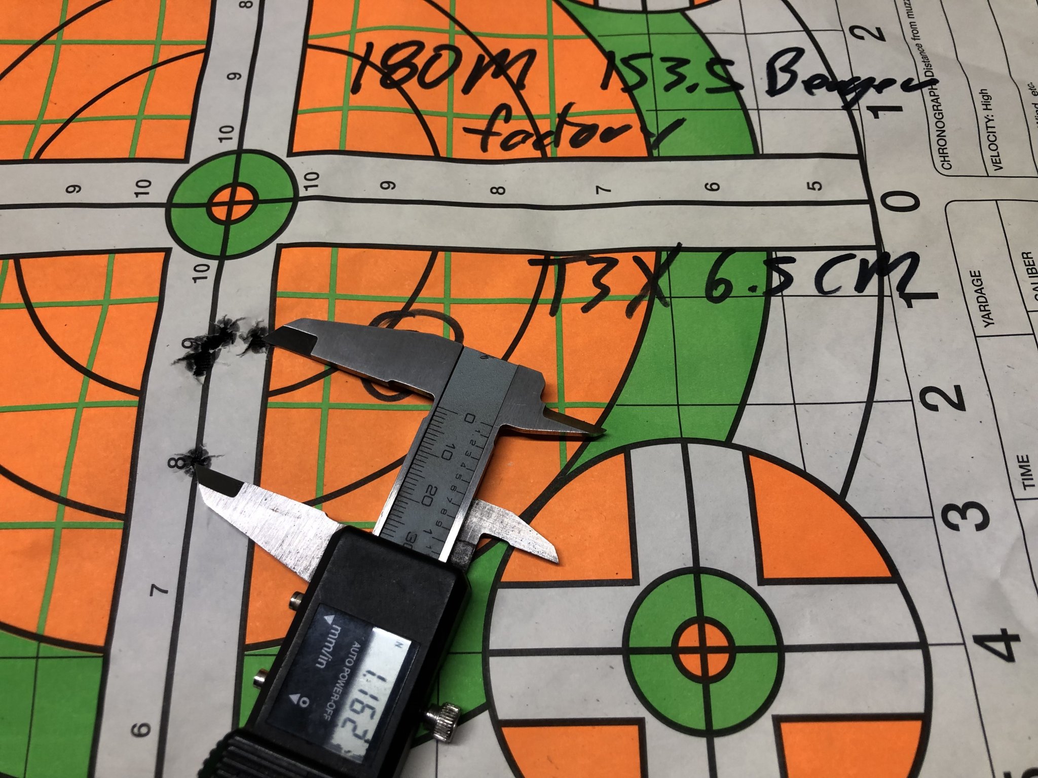

A reasonable assessment of one's weapon accuracy is shooting #3, 5 shot groups allowing 5-8 minutes cool down for the barrel between groups . If one has a spray and pray weapon ,makes little to no difference how many rounds one shoots .

Not an overlay but some numbers to correlate I reckon. If I did the maff right
Group 1- 1.01” or .97moa
Group 2- .99” or .95moa
Group 3- .85” or .81 moa
Three group average is .95” or .91moa
