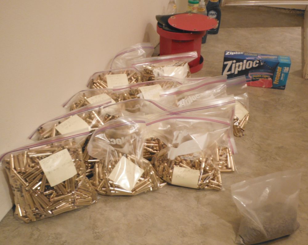

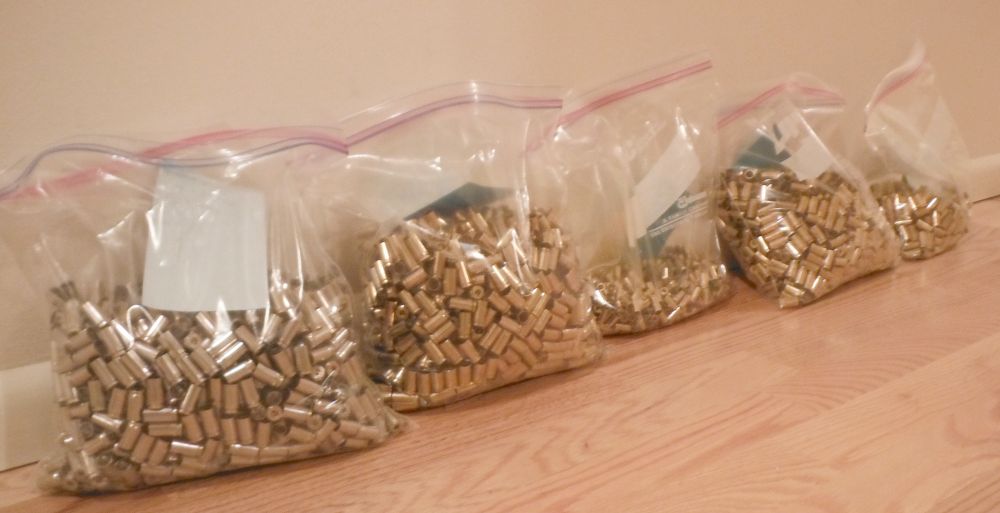

85 pounds of brass tumbled 30-06, 303B, 223, 6mmBR, 260, 270, 30-30 4-16-2014.jpgbrass b 5-12-2014.jpg
I did 84 pounds of brass last month and 35 pounds this month.
