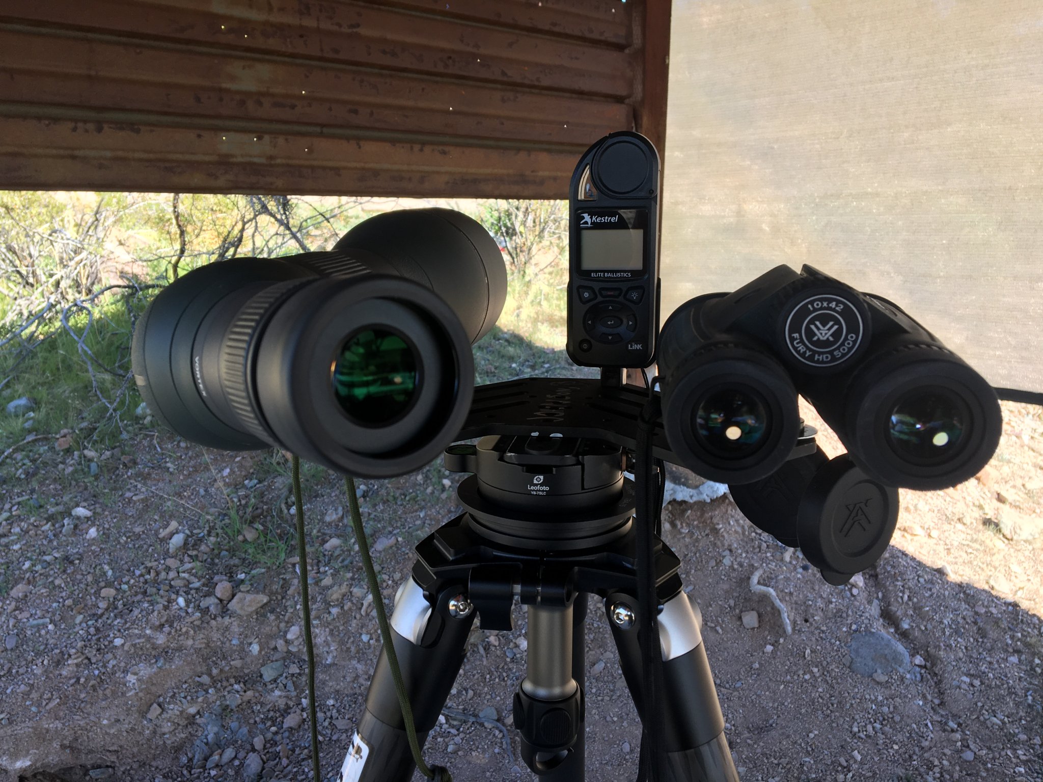

I started using mine to spot at matches and they work great out to 1000 yards to clearly see hits on steel. I was actually pretty impressed with the glass especially when mounted on a tripod. Could say something about a comparison with a well known set of binos looking down the same lane of targets but I know it would make the world blow up so I will not bring it up. LOL

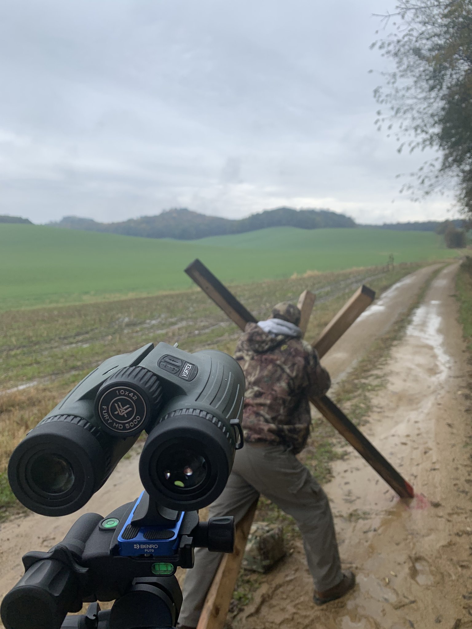

I bought a pair when they first came out, so far I've been happy with them. The LRF is fantastic, it will range over 2000 on rocks and trees and I've got 3000 on metal buildings, way farther then I'll shoot. I haven't spent a whole day looking for animals through them I've mostly used them at the range to spot hits on steel but the glass is pretty good, its not as good as a set of Razors i compared them to but still good. I did notice the slight blue tint to them but it doesn't bother me.
