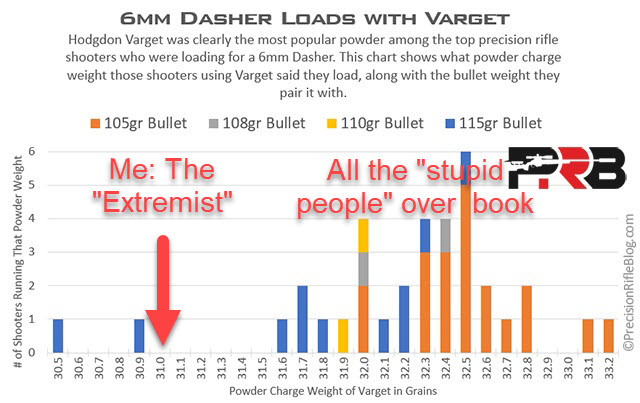

For example, with 6 Dasher, some books cap (Sierra especially) at like 2500fps, which is ridiculous slow even for a BR. So I would work up until I see a very faint ejector mark/feel a slight heavy bolt lift/start to see the primers flattening, etc, etc...just to know where the red line in the sand is drawn, then back down to a place where a few extra kernels here and there and some dirt in my chamber/rainy conditions isn't going to push the pressure envelope. That becomes my 'max' and I search for the best load lower than that. It's the first thing I do with any new caliber.
In terms of the Dasher, I hit 2980 with zero signs and could have continued stuffing a few more tenths in there easily and been safe, but I wanted to be slower than that, so took the best load between my new min/max @2860fps and never looked back (and have a load in the 2700s that rival that load). But at least I know where I am on the pressure curve, per se, and will never have an issue.
...but I wouldn't recommend settling on 2500 or 2600 or 2700 when your bullet/barrel/powder combination could reward you if you had continued searching for what it liked to eat and could have starting shootings 0s/1s @2950fps with zero signs of pressure. You won't know when you stop at book max that is sometimes drastically understated for obvious reasons.
