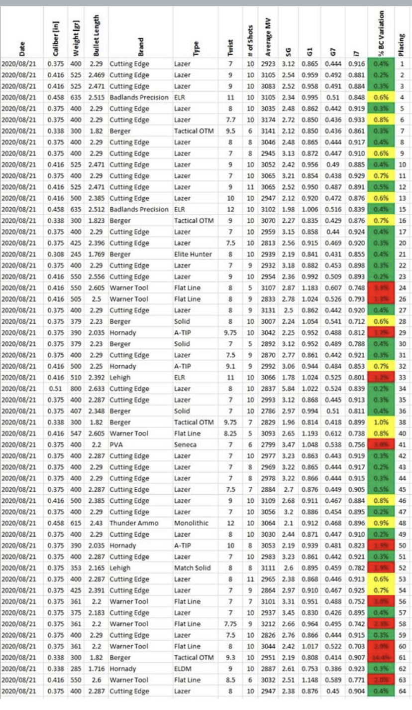

These are the results from the ringneck ranch radar session. It’s caused a lot of stir in the force when it comes to bullets. The inconsistency doesn’t just come from weights and dimensions. It has to do with design as well, how the shock waves interact with each other and how the air flows on the bullets. The numbers are the numbers, I have pointed out the flaws with this plenty in the past but people like to look at what they think is proof.
Interesting chart. I can certainly see where it leaves way more questions than it answers. There are only three .338 caliber bullets on there and the disparities I see for those three alone lead me to question the veracity of any conclusions drawn from it. The Berger 300 OTM is on there twice, once at 2829 out of a 9.75 twist and once at 2951 out of a 9.3 twist. They are to be compared to a Hornady 285 ELDM at 2887 out of a 9 twist...
Not much useful one could conclude using data like that, imo.
So while hard numbers are hard for me to swallow from that testing sessions for a few reasons, after talking with the guys from AB, you can trust the general trends. While they wouldn’t opening discuss the reasons, they did say that this is the general trend for the Flatlines. Now 2 weeks later, the same guys shooting the same flatlines shot some of the best scores on the first 6 targets at Spearpoint elr season finale. They struggled at the farthest target but I won’t say if that was a bullet problem or a shooter problem because the wind was stout.
Now if you really want to look at bullet selection from all angles, you can run the numbers of a cutting edge 400gr 375cal with a .865g1 and a Badlands 400gr 375cal with a 1.125g1 at the same speed. Run the high and low impacts at 3000 yards using a bc variation of .4% for the cutting edge and .5% for the badlands. See which one has the smaller vertical variation. This is a number for the variation that you can simply do nothing about. Even if all your bullets leave the barrel at the same exact speed this is the vertical you can expect to see over a give group
