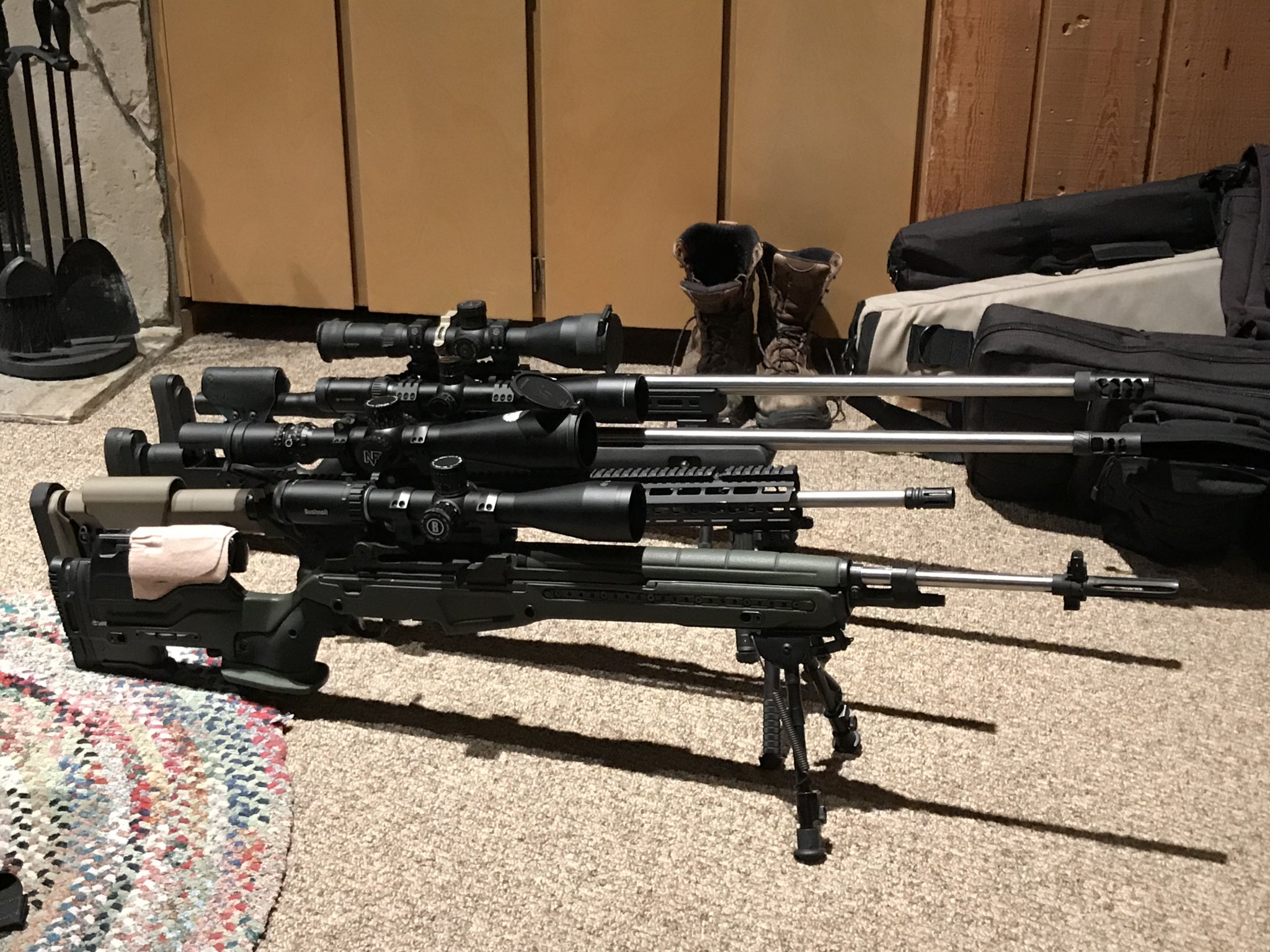

My smith is trying to talk me into a 16” 1/8
.308 bolt. He has a barrel ya see….
Good to know it shoots the 175s well.
I need another .308 like I need another ex wife.
but will choose the former over the latter.
