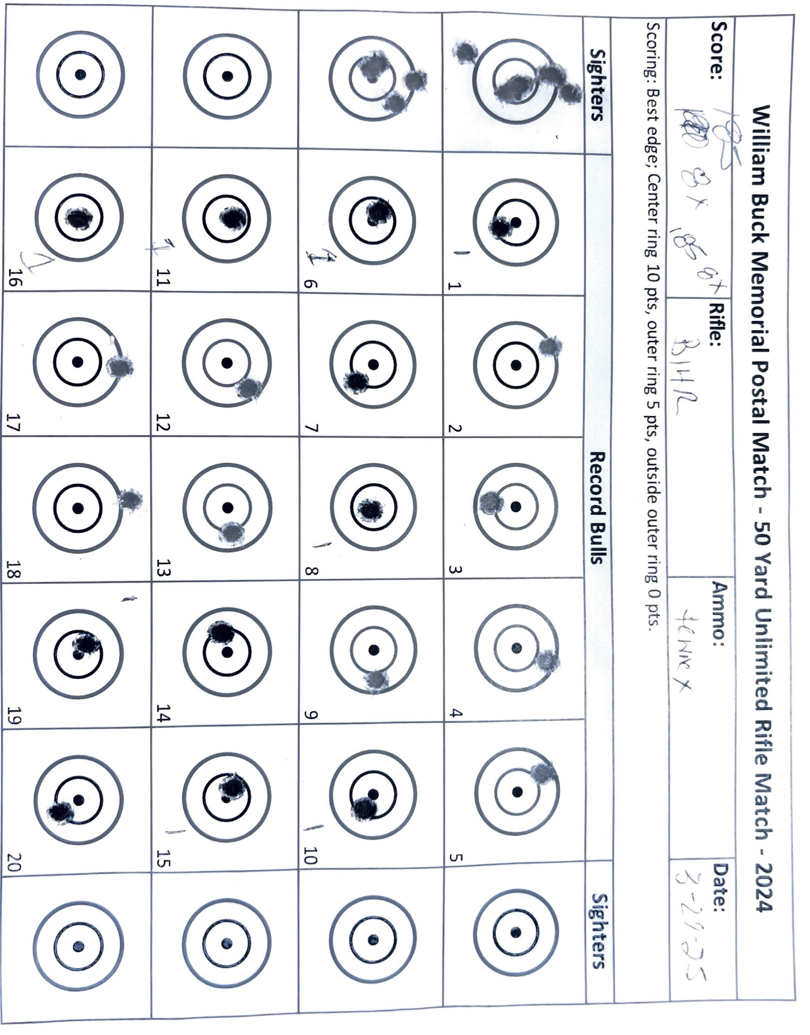

Man... you are making this downright difficult. ;-)
I'm including my only target for this month . . .
  • 3-29-2025 jBell Target.pdf
Reactions: BowChamp

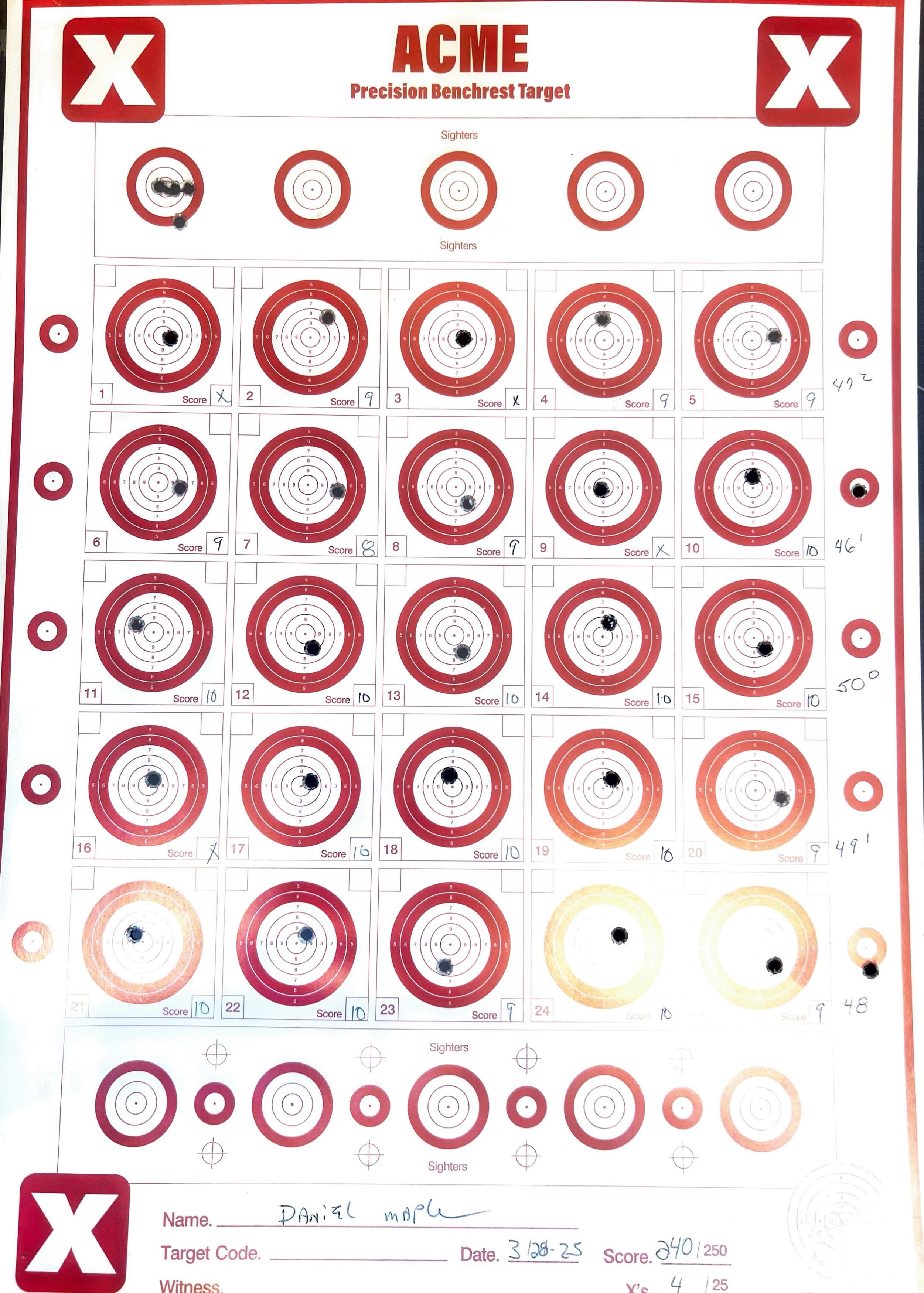

I couldn’t get the app to score this - after many failed attempts- app scored this 89 - 123 - and 179 - I know it’s not a great target-but really app it’s not that horrible!!
Beginning to wonder if my barrels best days are behind it - roughly 8,000 rounds on it (since December) - not feeling nearly as tight as it used to
Reactions: BowChamp
Hey Mr. Pudgy........
Not sure you can wear a barrel out with 8,000 rds.. :unsure: I have about 22,000 rds on my barrel and just getting started. :)
Keep up the good shooting!!
Pudgy, I assume you used your Bergara and Eley Tenex? If incorrect, I need the rifle and ammo sinfo so I can post your score.
Thanks!
I just couldn’t leave well enough alone- had to try again- grabbed my 9 year old sons rifle with a better scope - waited for wind to settle a little and tried the unlimited again. Second attempt was a little better. -
Nicely done. I be Grumpy and you be Irritating. At this rate you are going to force me to retire and spend more time practicing.
You are going to get Gdawg09 all fired up when I tell him you used a CZ.

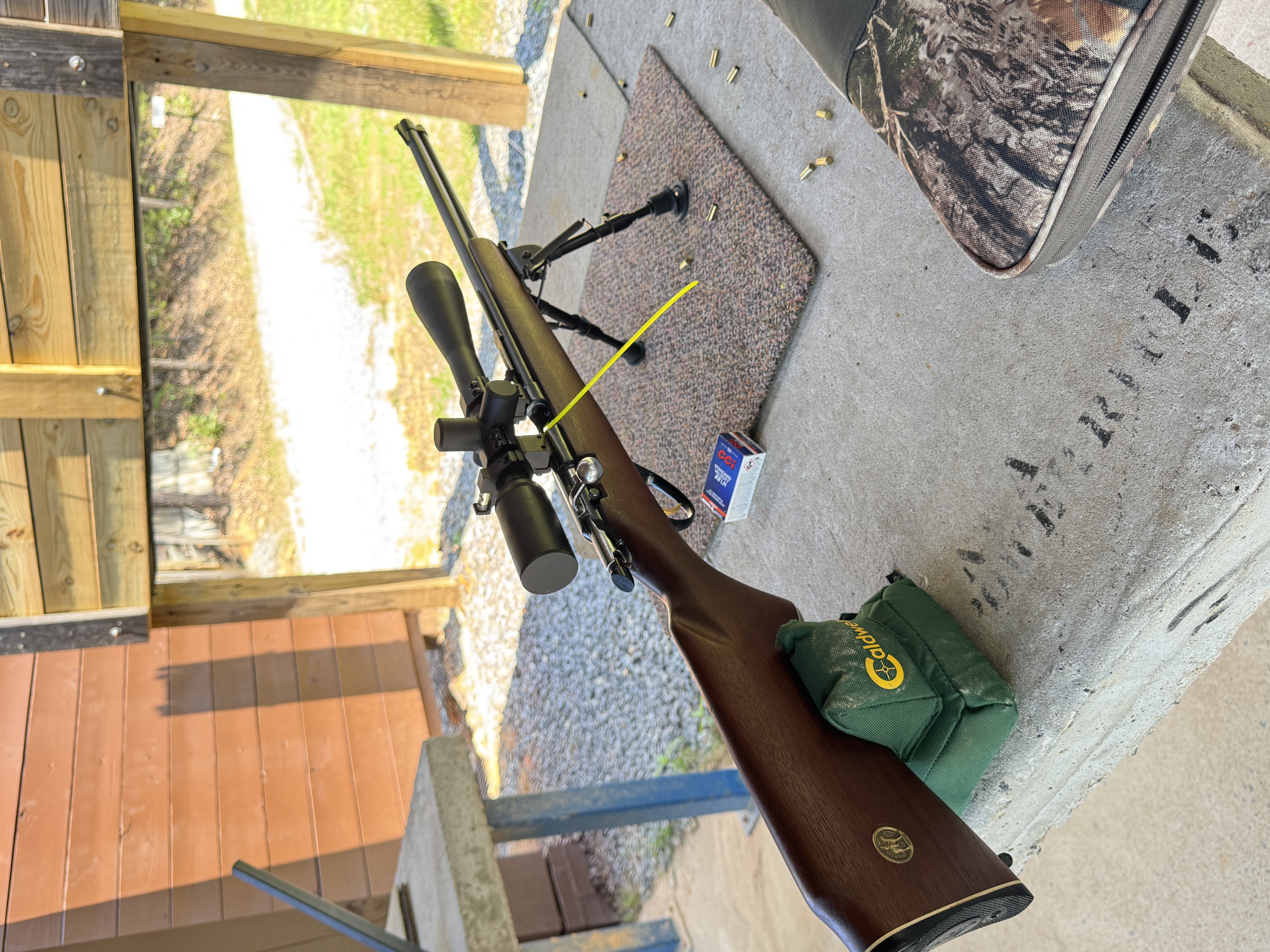

Good afternoon.
I shot my first Match Grade match today.
My new set up includes a new Criterion barrel from Whidden Gunworks. They took the blank and machined it for target match. I also had them to ammo test it to match me with the best ammo and lot at both 50 and 100 meters. The best match was Center X.
Whidden does a great job in their machining and customer service. I would recommend them to anyone needing a barrel.
The two shots I missed the 10 ring was due to me fighting a “floppy” target stand in a nice breeze today.
Otherwise I’m very satisfied that improvement lies ahead.
Reactions: BowChamp
Good afternoon.

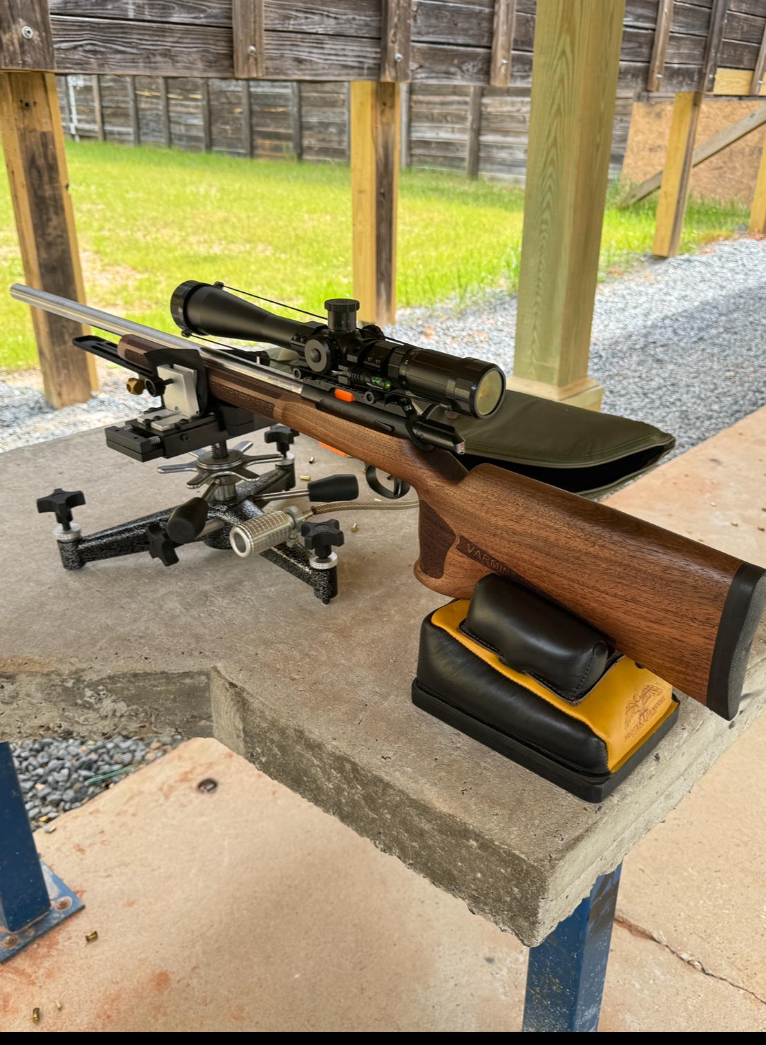

John, I have your score posted. Nice looking rifle!

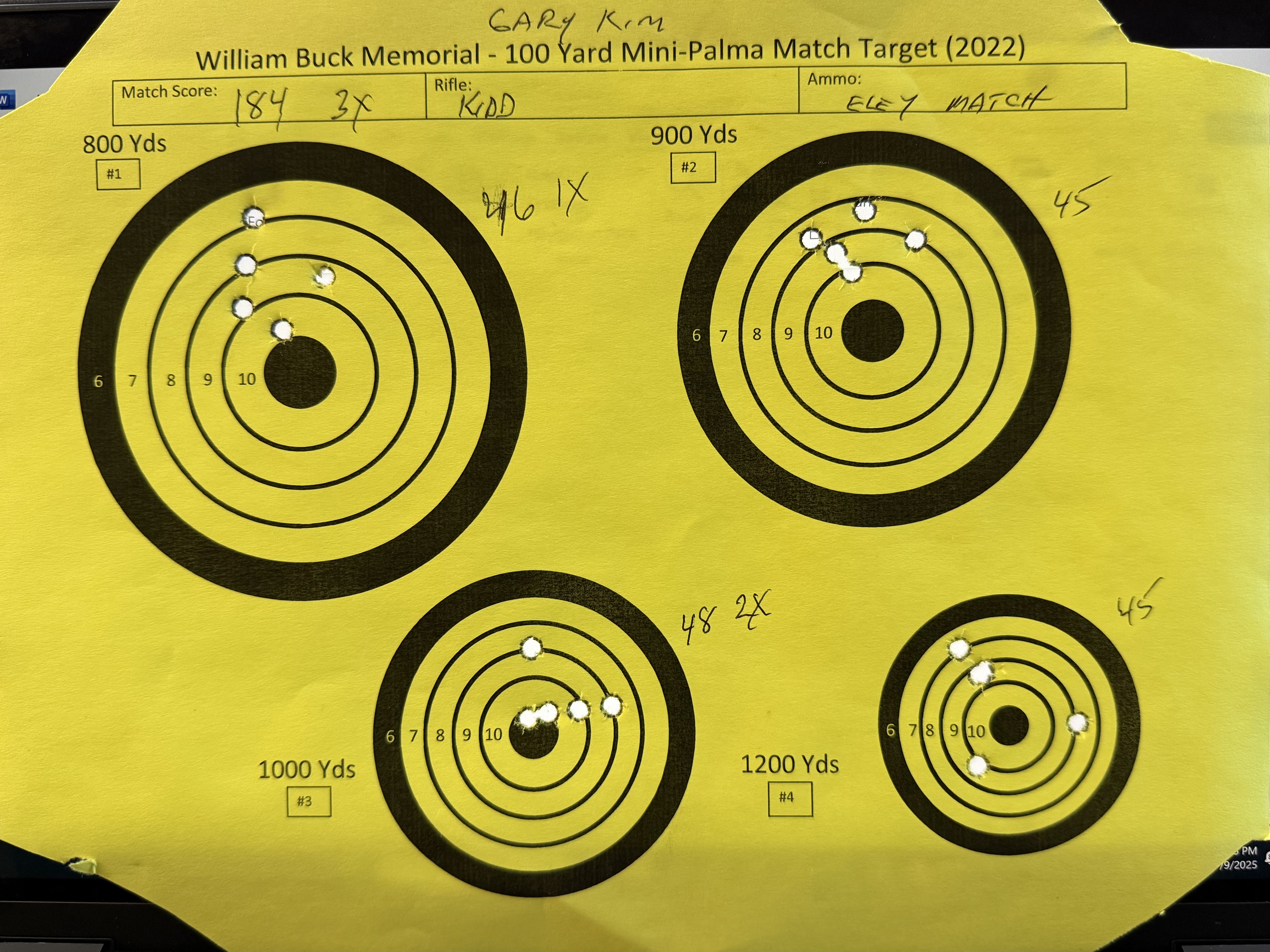

Been a busy month as I'm preparing to compete in a local NRL22 match, so it is a totally different experience than the benchrest.
Here's my latest effort at 100 yards.
Thanks for running this program.
