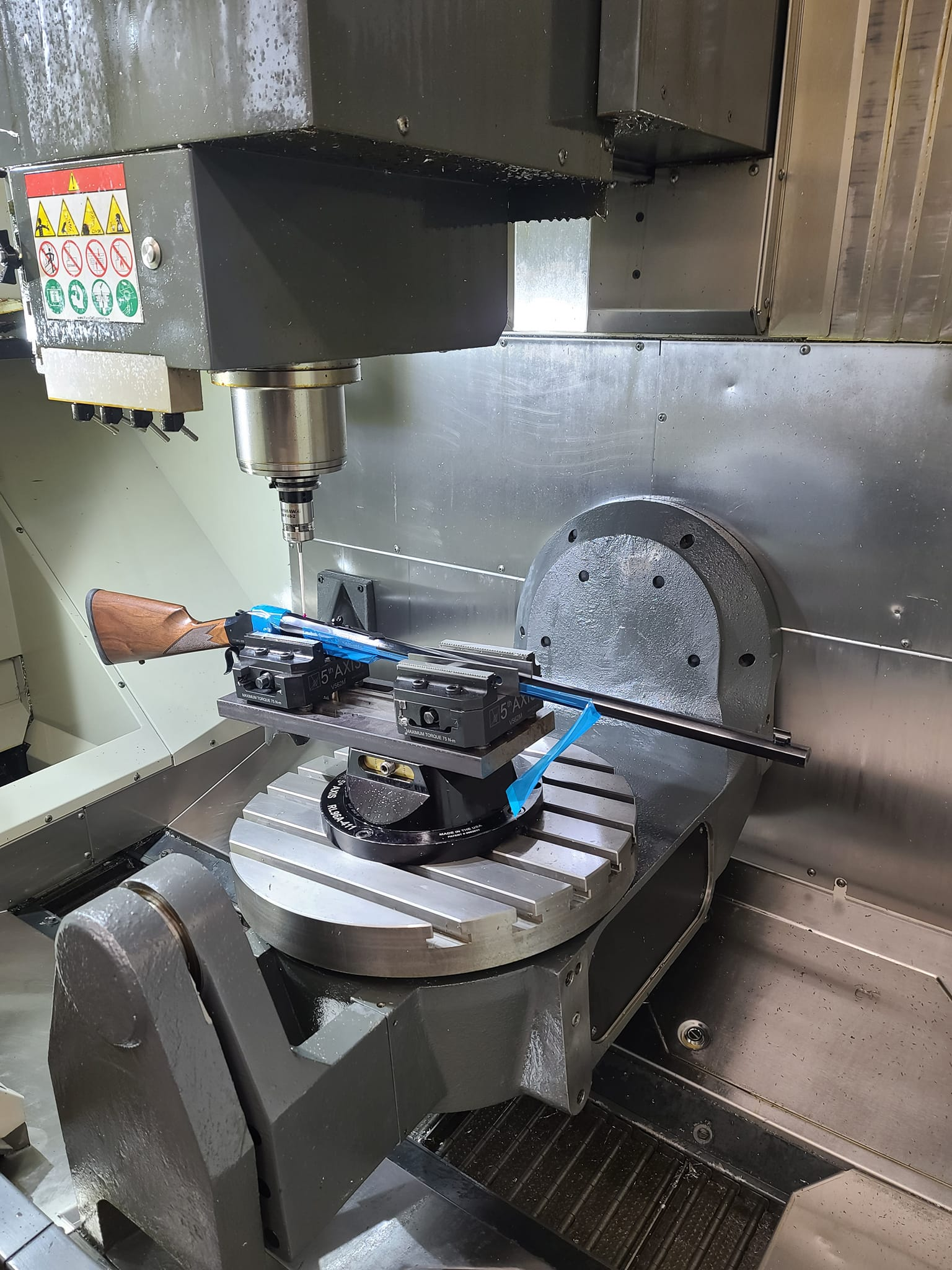

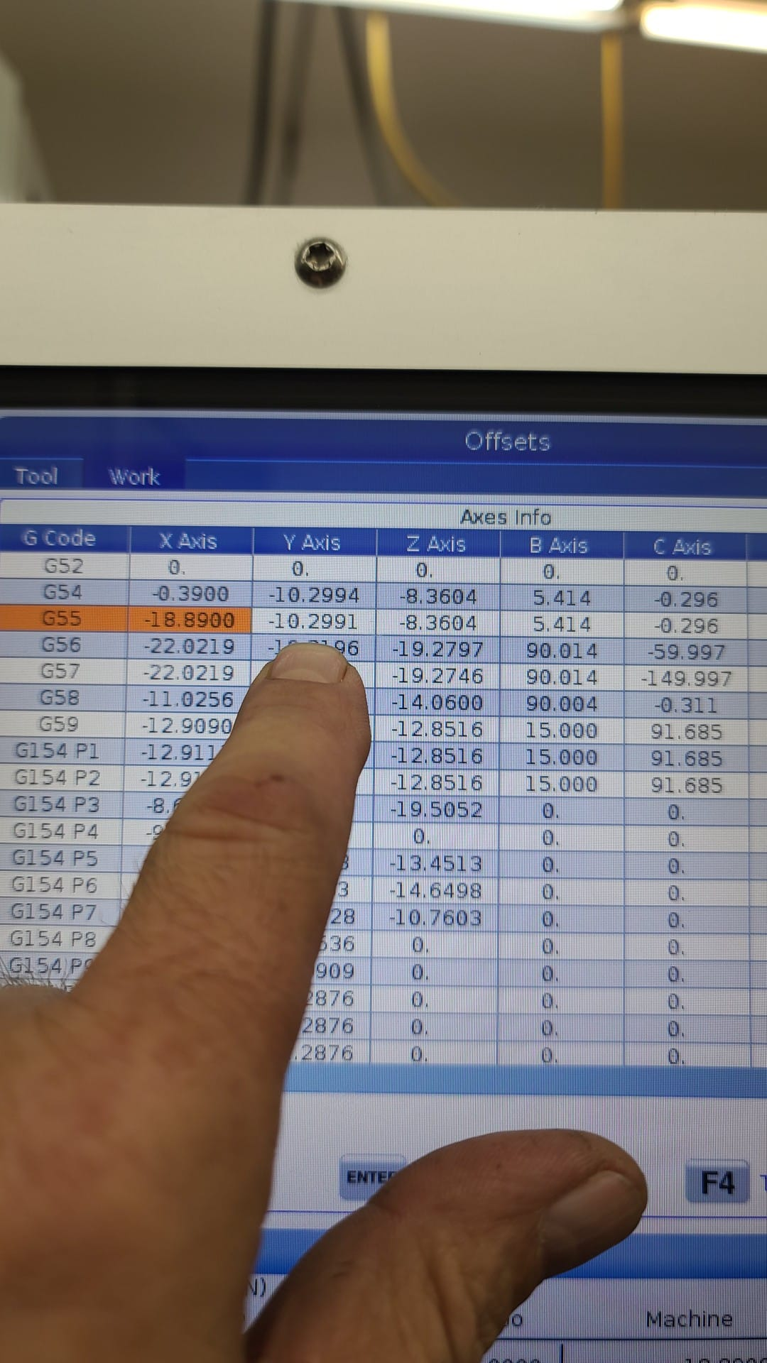

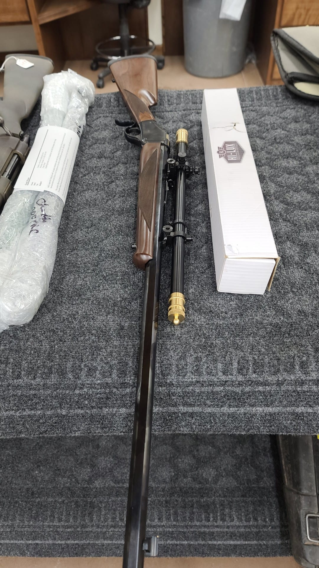

    Old school scope setup, so I used old school machine setup as well.

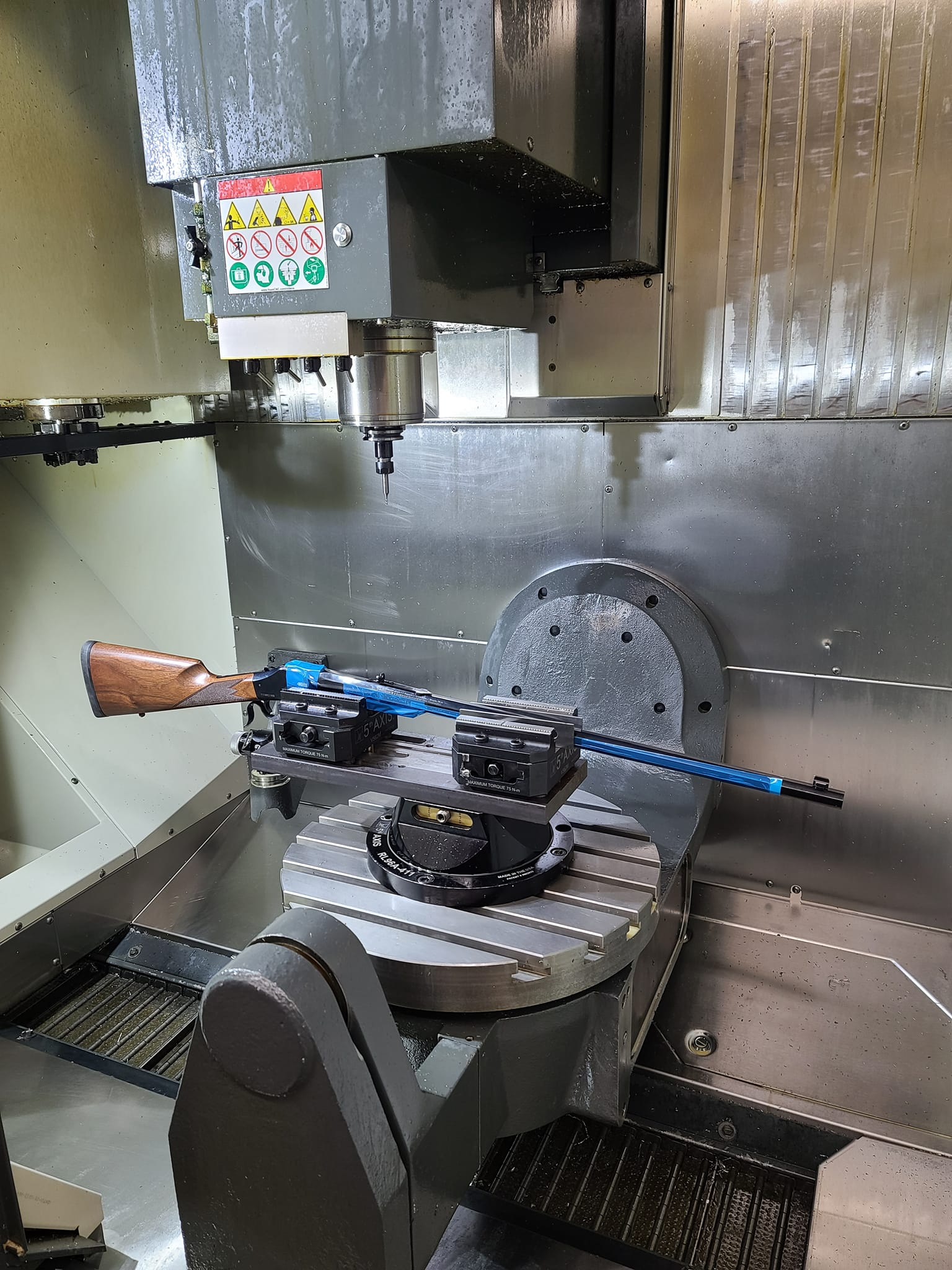

    I've had this machinist trig book for over 20 years. I dug it out today to see how close I could get it. After setting it up I verified with the spindle probe and it didn't disappoint: .0003" for position while aligning this thing in the C axis of the machine.
    Winchester 1880:

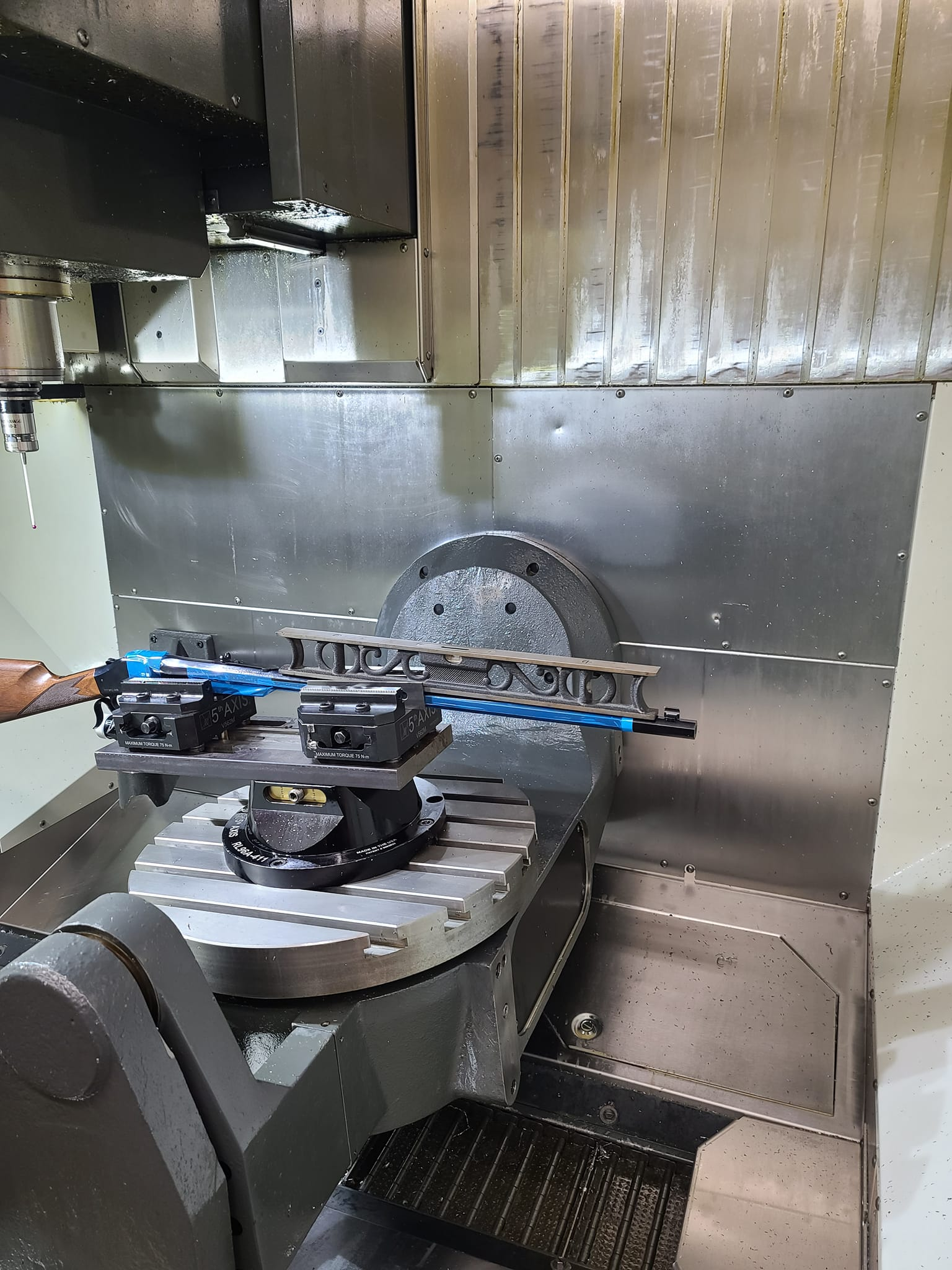

    Roughing in the B axis with a Starrett level:

    Trust, but verify:

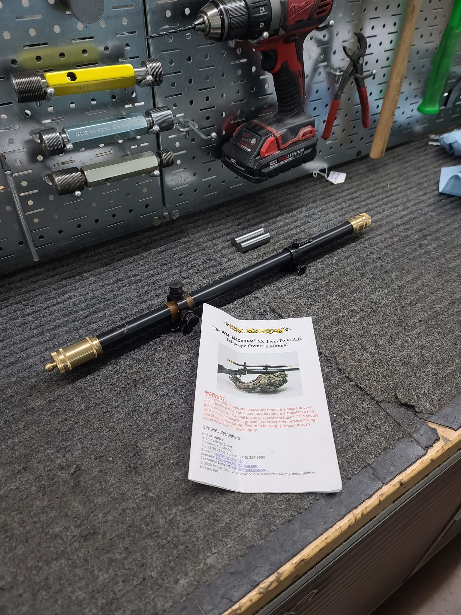

    I appreciate you sharing this. I’ve long been temped by the 3x version of that scope to top a Pedersoli Missouri River Hawken 50 cal with a 1 in 24 twist barrel or my Marlin 336 Cowboy 30-30 with its 24” octagon barrel. How fine are the crosshairs in that scope? My concern is that they would be fine at the range, but a bit light for actual hunting, although probably still better than open sights. Have you ever mounted this scope on a muzzle loader or lever action and or would you recommend it?
    I have no experience with this optic before installing it on this rifle. It's a 6x, and the objective lens is about as big as a quarter, so the light-gathering ability isn't much to write home about. The reticle (on a guess) is prolly 1/8th minute. It's pretty fine.
    I have a handful of Unertyls, and they are mediocre at best during poor light, so based on that, I'd say this is a fair-weather player.
    Reactions: KYAggie
    That’s what has kept me on the sidelines until I can actually look through one; which is probably never since no one really stocks them. I suspect the 3x might gather a bit more light and even with a very thin reticle still be better than open sights for hunting as both of these guns have a max range of 200 yards hunting wise. On the range it would not matter as much.
