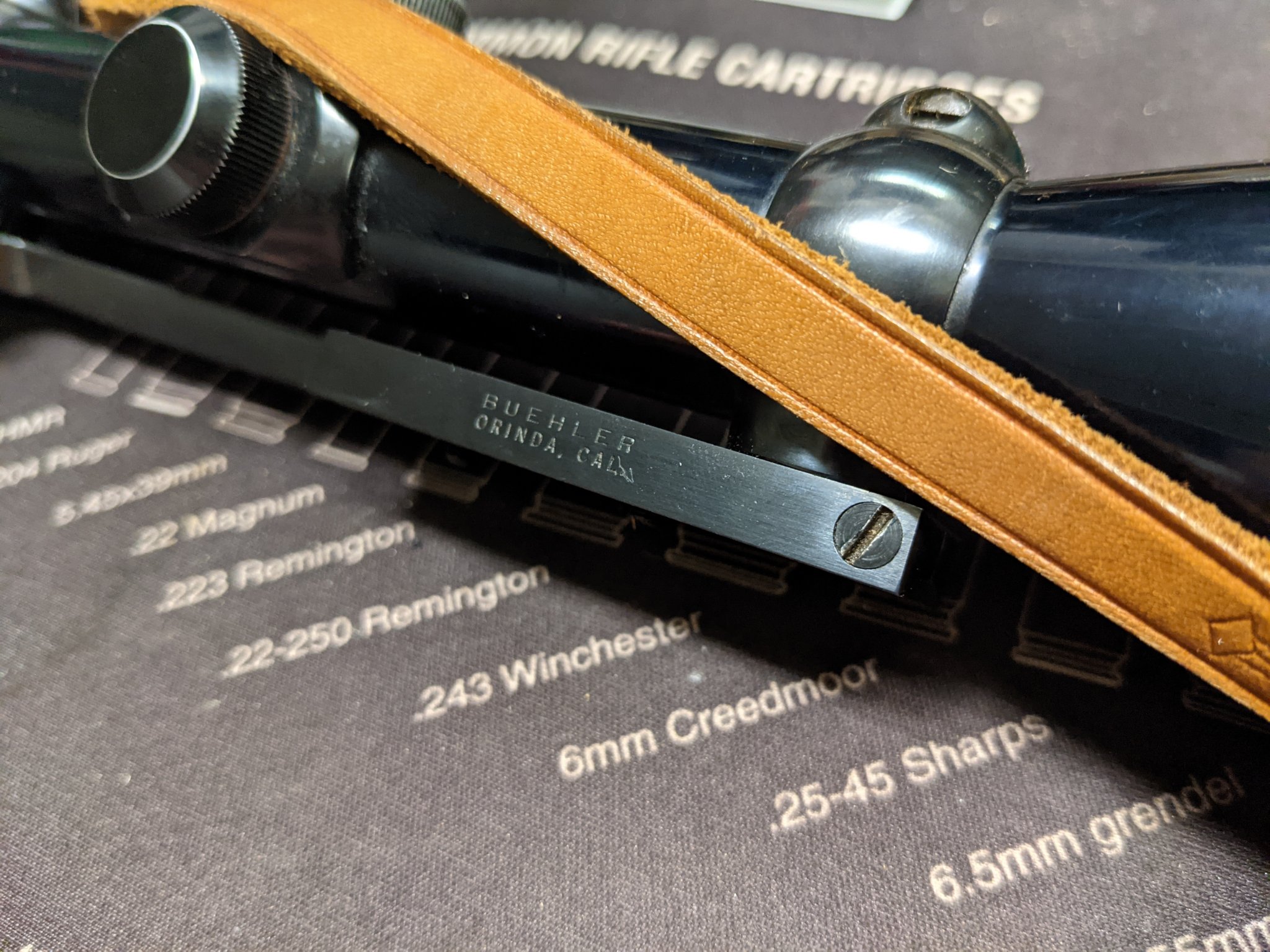

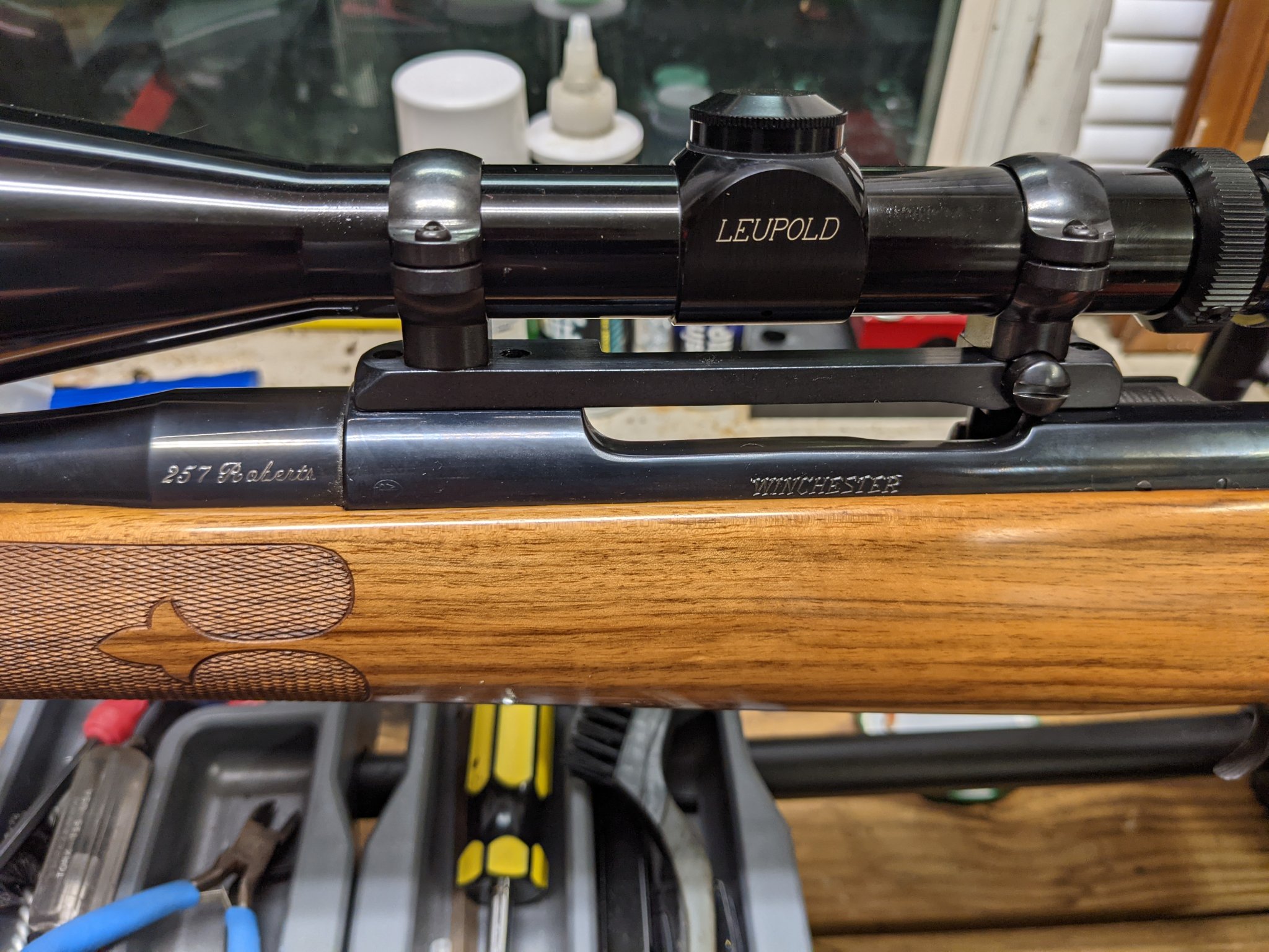

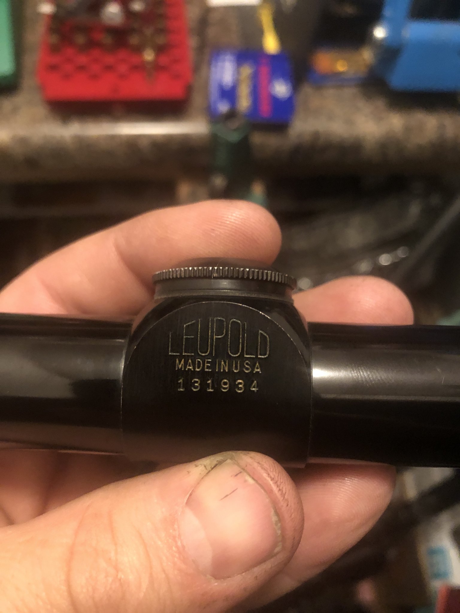

    The rings and base are cool. But some part of me wants mellow blued mounts for the scope….
    Its an old Buehler mount set up.
    Scope is a Leupold M8 4x.
    A blued Buehler would be slick on it. An old Leupold with the curved script would be cool also.
    Like this mount? And this Leupold?

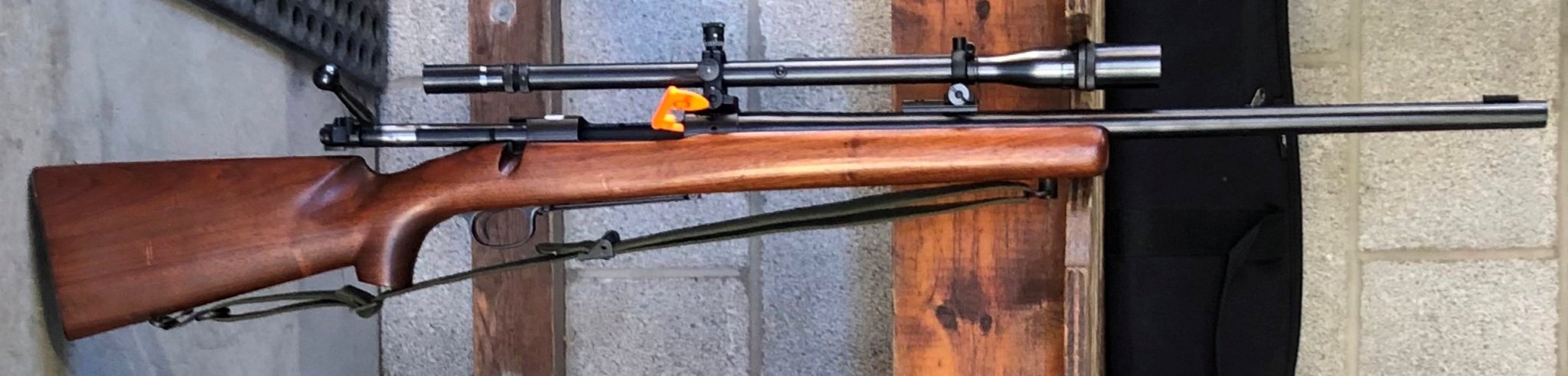

    55xxx, 1946 action, New bbl, later wood stock, bc I hate the low drop pre-war stocks...
    This is gonna be another working rifle.
    29xxx, a 40, still in pipeline to get its stainless bbl screwed in... Will b the slightly older twin...

    New chrome moly barrel, old school hot blue, off the receiver.
    Action is a 1940 that's been in my clutches 30+ or so years.
    Last iteration was 6mm Rem in a Marksman heavy stock, shot at Camp Perry in the 1000 yard matches.
    It's also bedded to that stock now, just in case.
    Working on finding a McLaine Unertl to play with from time to time,
    Otherwise it will wear a mk4 leupold like it's brothers. Until playtime..
    Started life as a 3006 sporter w a side mount scope. You can see the screw holes plugged. When I got it, the barrel was pitted to ruin inside.
    Should have kept the original stock, but... one of them divorces... then...
    Went 3006 hb in the marksman stock.
    Then 308 hb.
    Then 6mm hb.
    Now back to 3006.
    Old 70's properly treated never die... they just keep coming back.

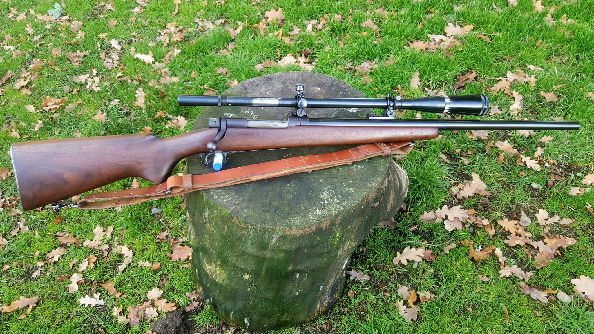

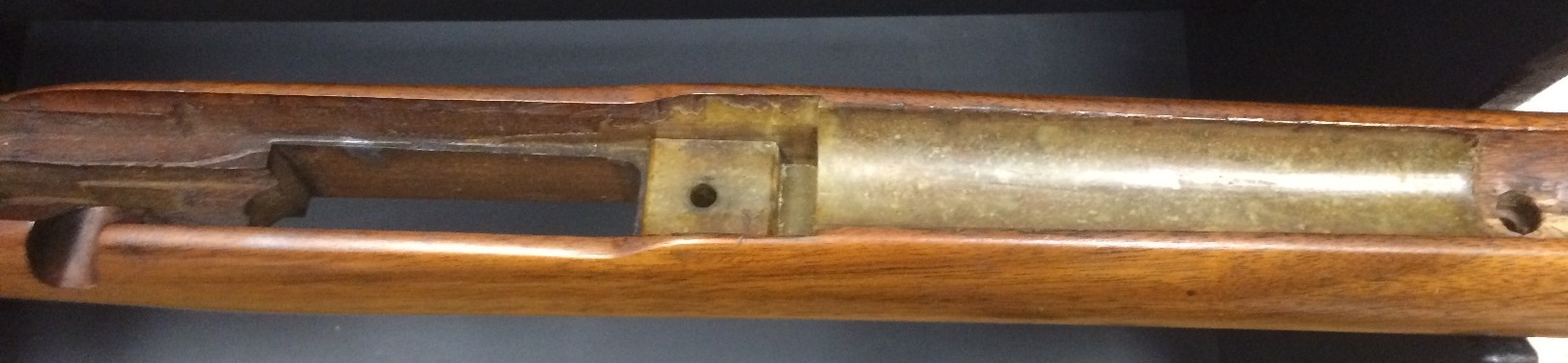

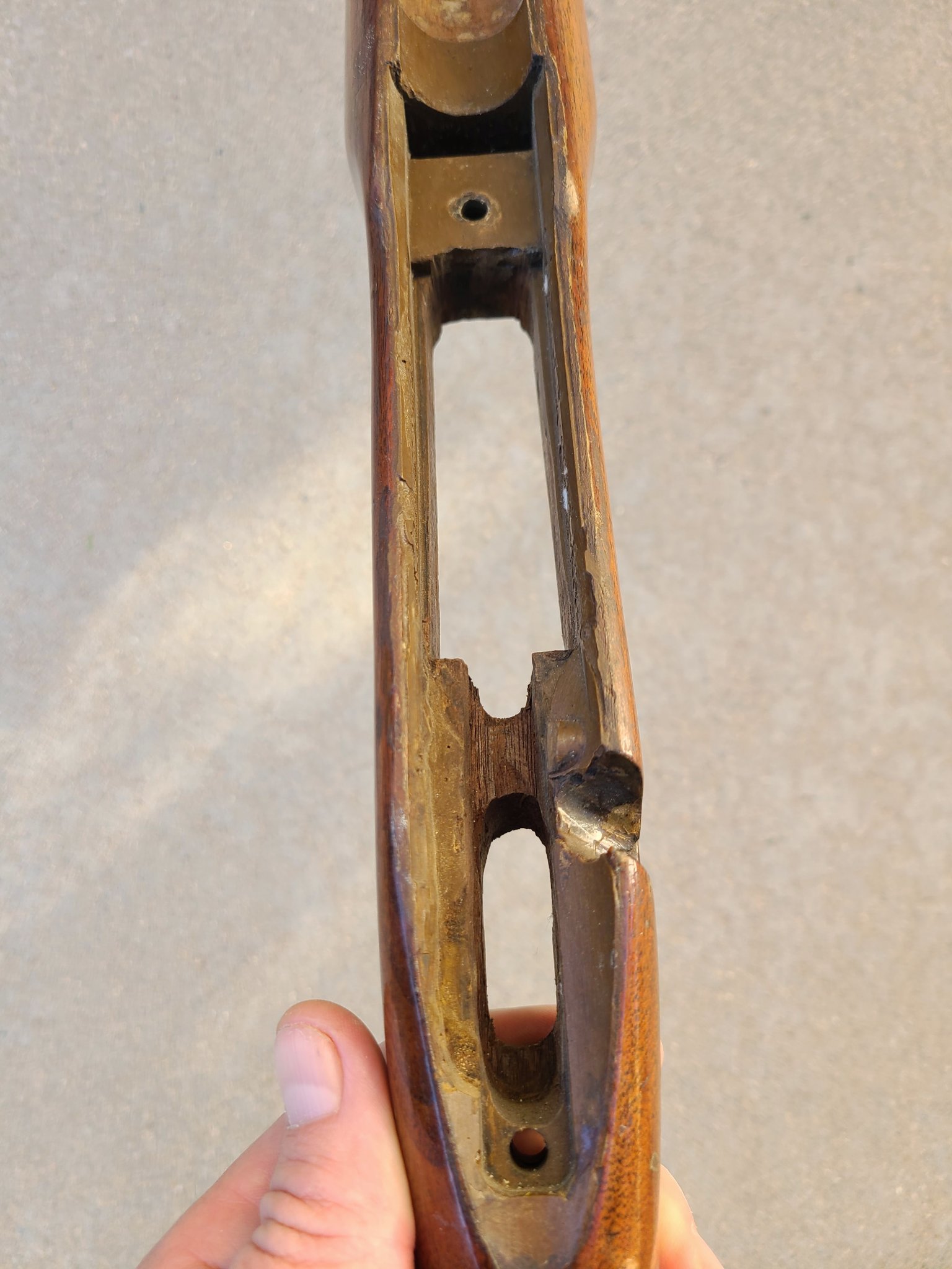

    Back in 2016 I found at a local store a late 1950's M70 "Featherweight" hunting rifle in 308W (serial range 299xxx). Price was nice, so it became a replica sniper rifle project. Bought a Douglas blank short chambered in 30-06, with the same contour as the old Winchester 'medium heavy' target rifle profile. Here's what it looked like after installation and bluing (a satin type finish - not glossy but not matte either). Barrel profile difference is notable.

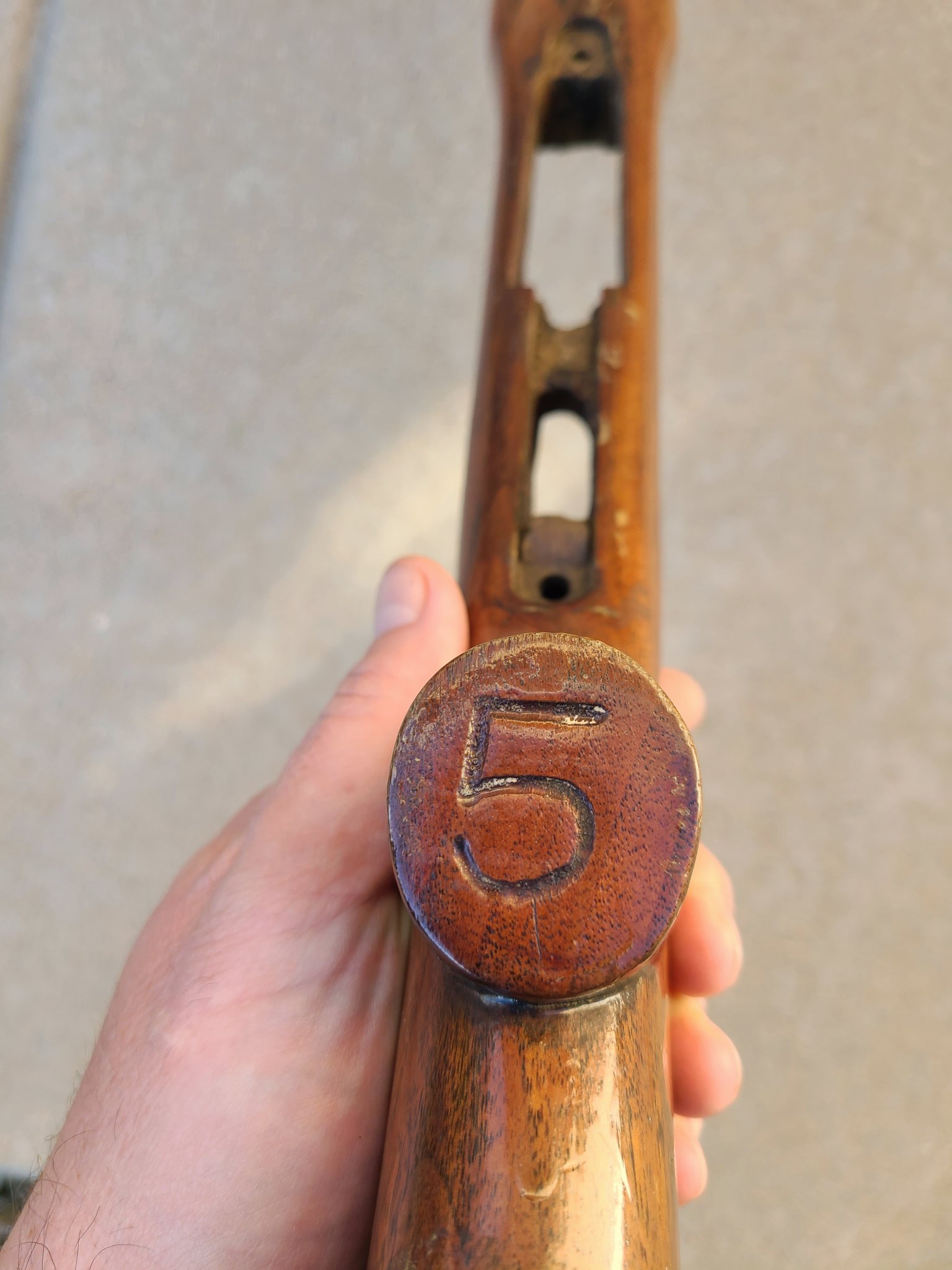

    I had an old Markman stock that had some 1950's era Accuglass bedding, so we cleaned that up and bedded my action in MarineTex.

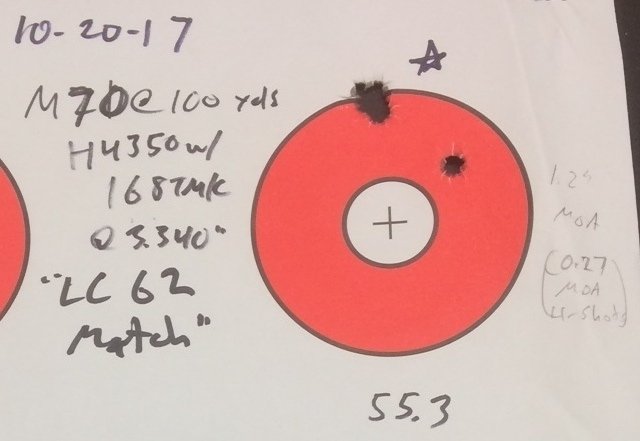

    ...and here it is at the range last year. Scope is an old Unertl 10x. I had the original silver mounts blackened, and it has Steve Earle scope blocks.
    Here's the pet load I developed for it in 2017 - just wish that 5th-shot would not have gone wide - but that was probably me, and not the rifle.

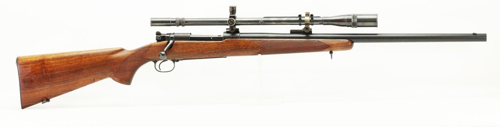

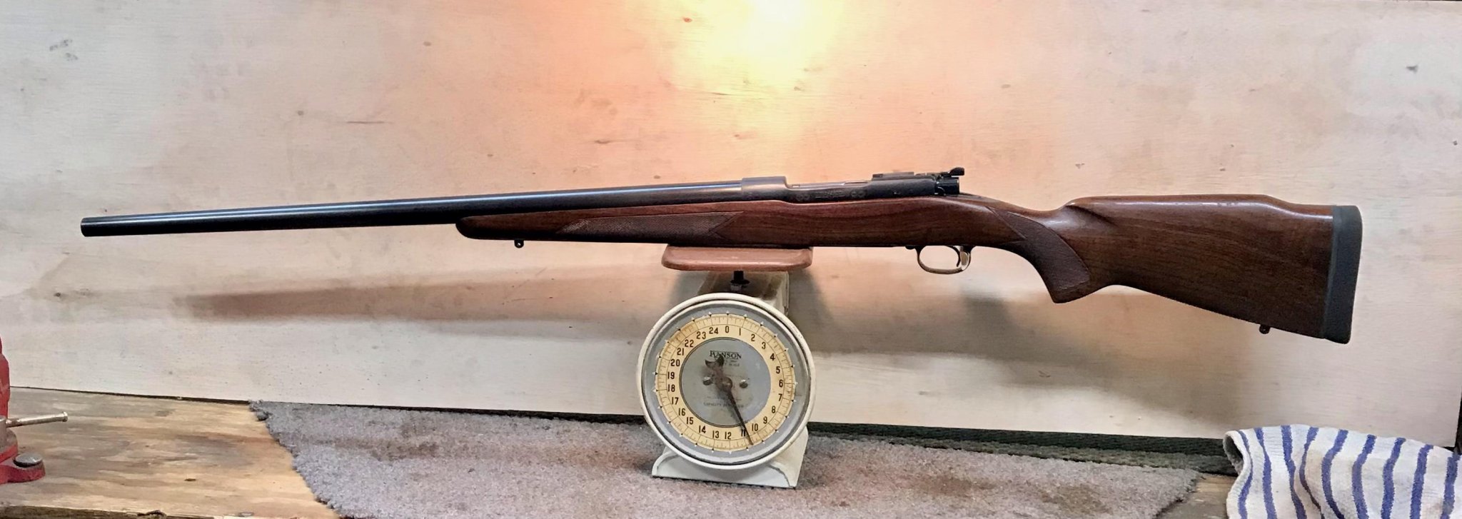

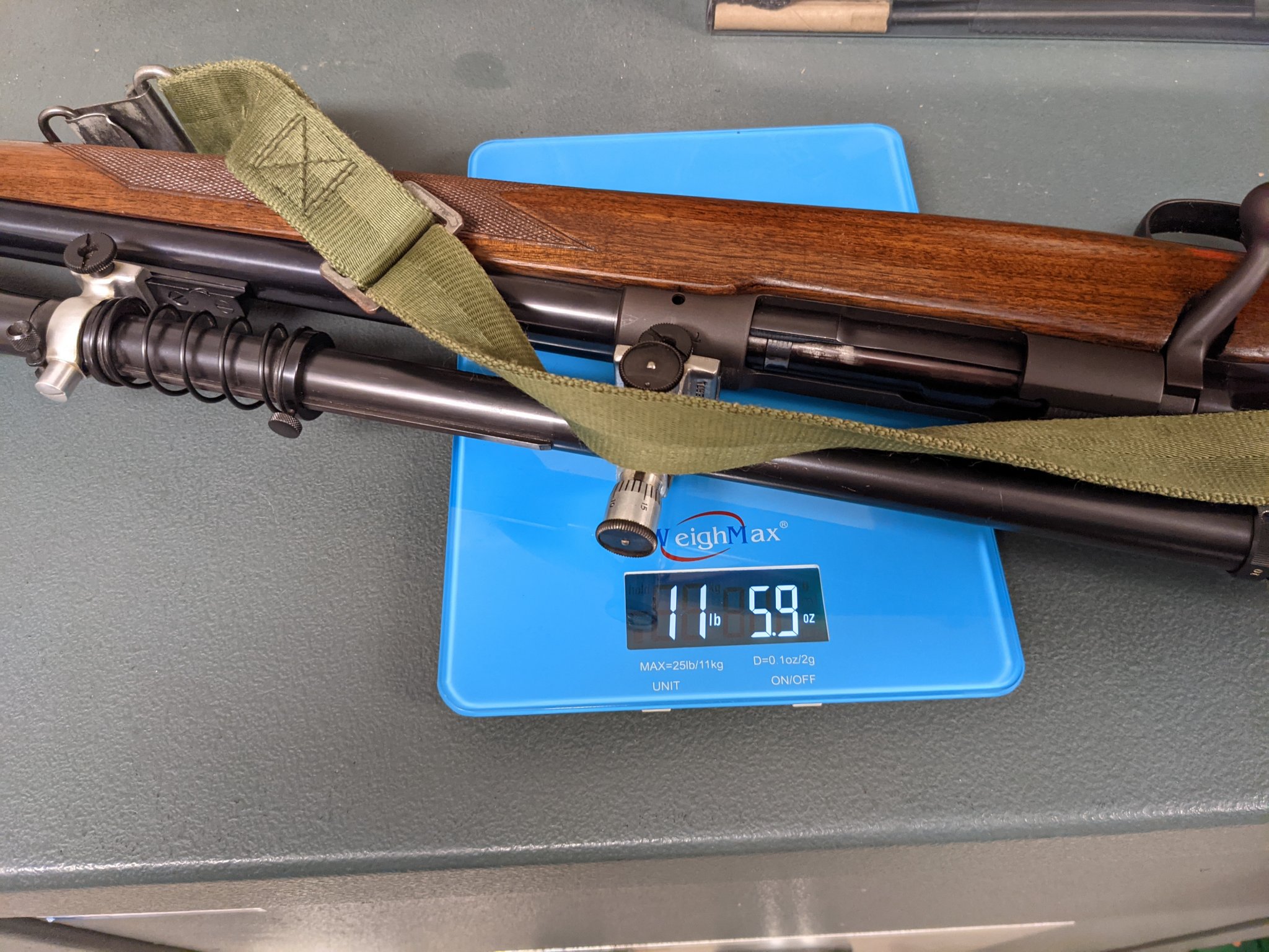

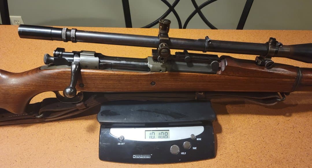

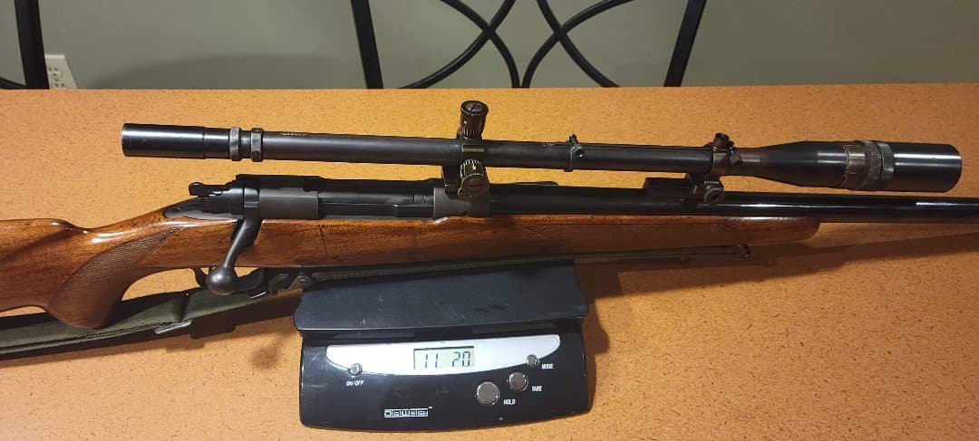

    These are crappy pics but at least show the weight.

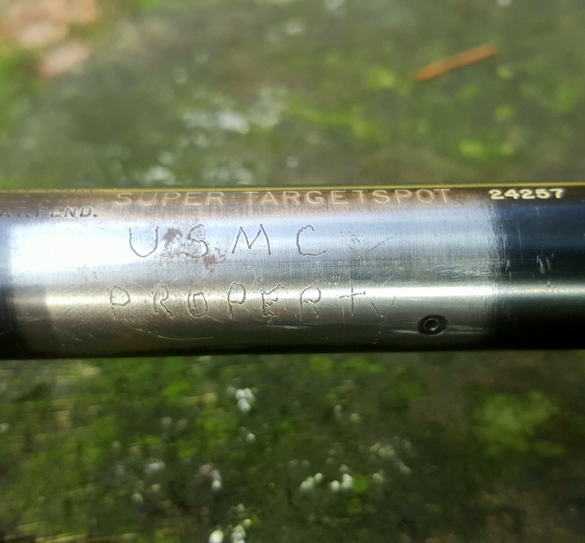

    First is LtCol Chandlers Model 70 with a 8X USMC Unertl. This is the weight. The serial is 18 digits off Ryan's Model 70 with the USMC Cash Sales slip.
    Second is the only documented Marine team rifle known to exist. It was a USMC International Match Rifle in 1927. Well the receiver was I should say. The Marines had about 12 of them and used them till about 1933. This one was used by both Col Cutts and Capt McDougal. In 1933 they were broken down for parts and the actions were kept for Team use. Later it was built into a Marine special Target and then was modified for the USMC Unertl. To show the weight comparison to a Model 70', I am including this. They are really about the same in weight.

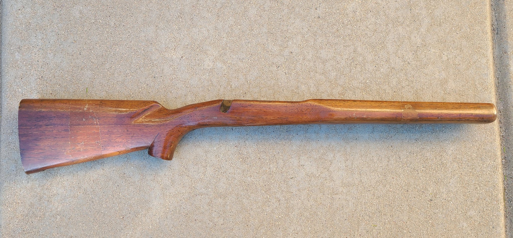

    Really kicking around purchasing a nice pre-war (1940) M70 in a 30-06 for a Nam sniper built. Listed at 2k so not horrible. Has the checkered sporter stock on it as well as the sporter contour barrel. Conflicted a bit on replacing the barrel with a 24ā€ Douglas Varmint contour but I think I’ll get over it. Fortunety the rear bridge is tapped so it sets up nicely for mounting a Redfield to it.
    My other option is just to use my current 1951 M70 ad a donor action / stock but wouldn’t be proper and that would bother me. šŸ˜‚ this is what I’m going for …
    I did pick up a Marksman stock in the PX yesterday from @RTH1800 but I hat probably won’t make it onto this build. Maybe onto the 1951 action later. We’ll see.

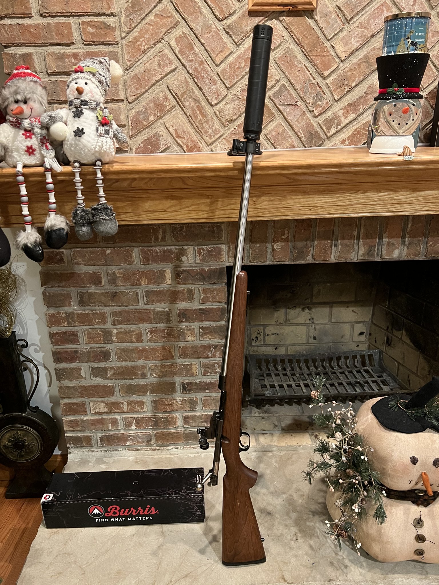

    Just got around to getting mine squared up, it’s a 1938 vintage that someone used as a Palma rifle. Receiver has pretty much every hole for every model 70 mount ever made and now sports a Douglas 30-06 barrel though it came with the factory original 30-06 as well. Stock was replaced with I guess a Boyd’s but is bedded in the recoil lug and first couple inches of barrel.
    Picked it up for $700 in an estate sale a couple years back, put a Timney in it since the safety didn’t work and got it threaded by my smith so now I can shoot it suppressed. Definitely not as nice as my Pre-War Sporter or Bull Gun but if I’m going to thread one I might as well pick the one someone already fucked up. Gives me a rifle I can suppress for our old school hunting weekend.
    That globe front sight sitting over the top of that suppressor is an awesome picture.

    When I had them thread it for the suppressor I specifically asked them to turn the barrel down to move the sight back. Going to shoot it this weekend and see how she does.
    Good luck with the heat mirage!

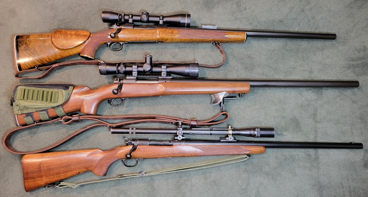

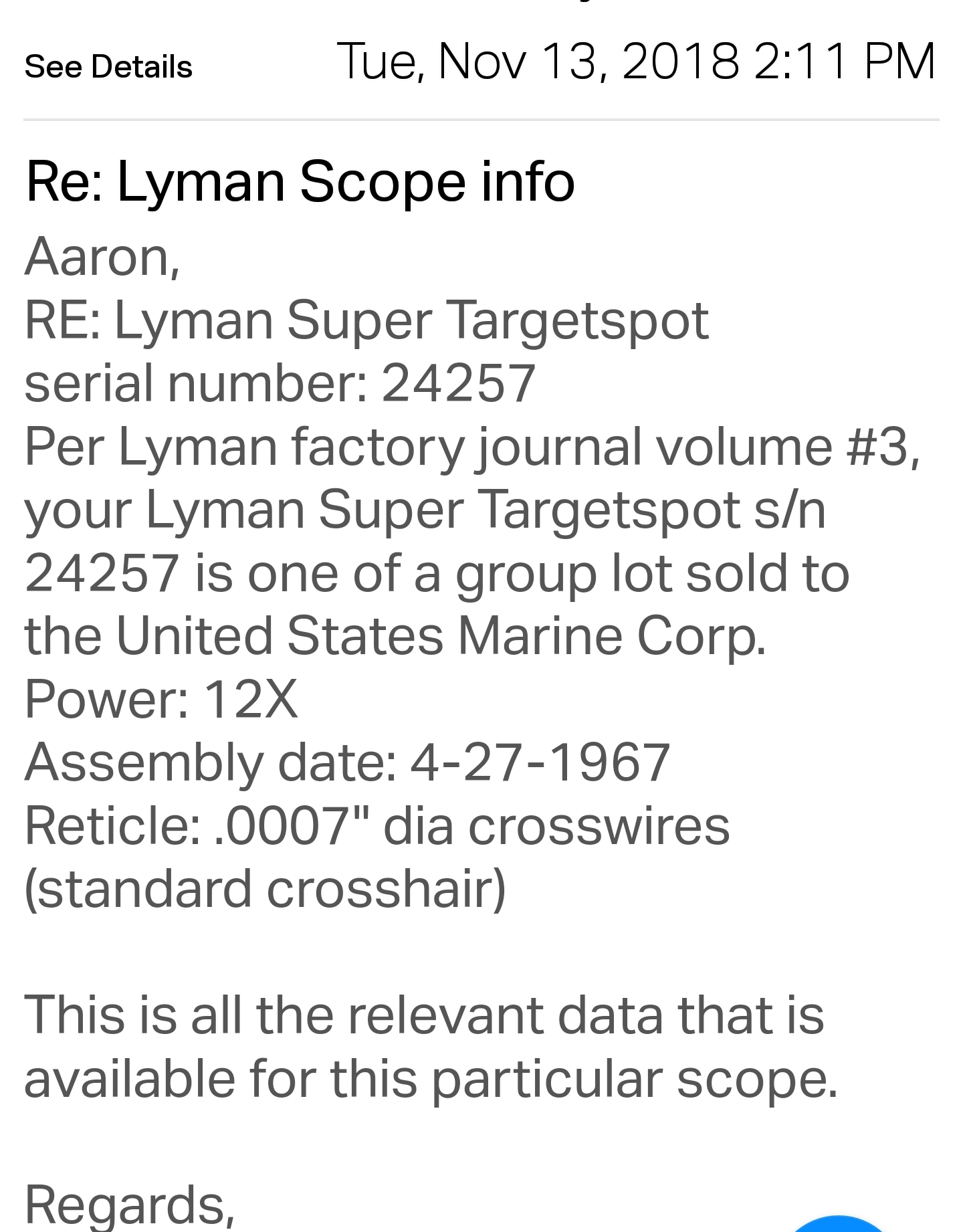

    This thread needs some more pictures...
    Top is a transitional in .270 that was my dads, I've often been tempted to put a Lyman Super Target Spot on it... but so far have decided to just leave it like he had it, yes he was left handed. The middle is a Target model in .308 that some day will transition into an FBI sniper clone, and the bottom is a Pre-War 30-06 USMC sniper clone:

    Delta,
    Wow! Looking at the top rifle, from "No Country for Old Men" many people had wondered whether or not it was a real thing to have a heavy barreled .270. Do you know any of the details of that top rifle?
