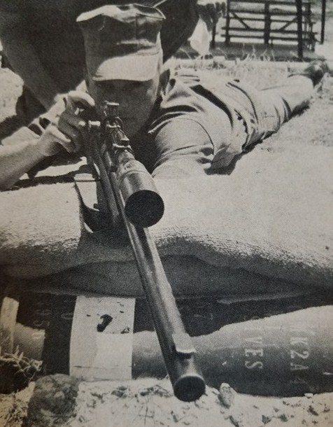

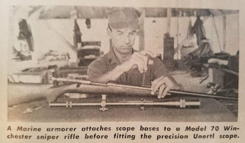

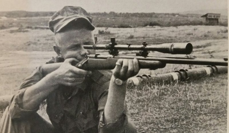

Another interesting to start to look for in these pics Phil. The WRA target barrels had two different types of front sight blocks. These were for the regular type lyman/redfield peep sights that were used on the Marine model 70 target rifles in competition. It looks from the 1954 team records I have, they used only the regular peep sights on the 30:06 model 70's. They used the 12x Lyman Super Targetspot on the Magnum model 70's.
There are two different variations of these blocks. The barrels before 1955 had a dovetail and the front sight was drifted in from the side. After 1955 they had holes for screws to screw the block on.
In some pics you can see the front blocks for the front peep sight. In some pics you can see the screws in the block. Which means they are a 1955 WRA barrel or later. Or possibly Douglas barrels had screw holes as well? I have no clue if the douglas barrels were drilled or not.
My 1956 barrel on my Marine 70 has the two screw holes like the pics below.

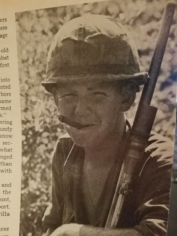

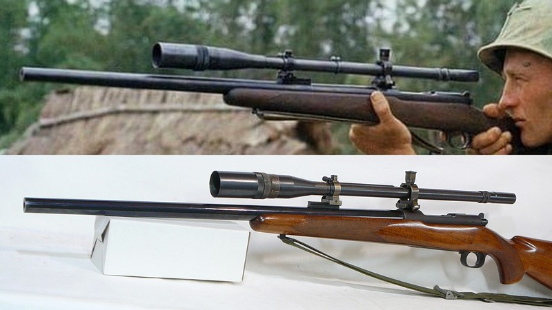

But something else to go back through the Nam photos and look for traits for. I wish my old computer hadn't crashed. I had a whole bunch of case studies and pics that aren't published. But I lost it all. The one pic of the front sight blocks is from Roger Rules book on the Model 70.
This one looks like a dovetail front block.
lol, I wish I knew a lot on the Model 70. Like I said earlier, something about the model 70 story in the books isn't right. But I can't figure it out. We just need time to let more documents to be released to the Archives.
But one thing I have noticed about every take off Marine WRA barrel I have seen. All have appeared to been reblued. They don't have the WRA commercial blued finish you see on the regular target 70 barrels. And one easy way to tell, the WRA target barrels from the factory, the muzzle isn't finished. The muzzle was left in the white on the WRA factory target barrel.
But every Marine Model 70 barrel I have seen the muzzle is blued over. So it's been refinished. And this is why I think why. When you see the pics of the Marine model 70's in the 1950's pics, the barrels are always in the white. I think the Marines bought them without finish on them directly from WRA, and probably later on blued them at the RTE shop probably in the same way the polished bolts were blued on the NM 1903's for the 1903A1 Sniper.
But here is a 1950's pic, and all the barrels are in the white.
This is just my hunch, and makes the most sense to me. I can't prove it 100% yet, but it seems like a very likely scenario.

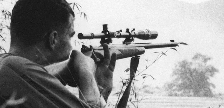

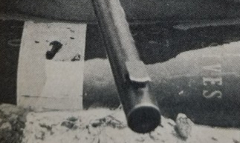

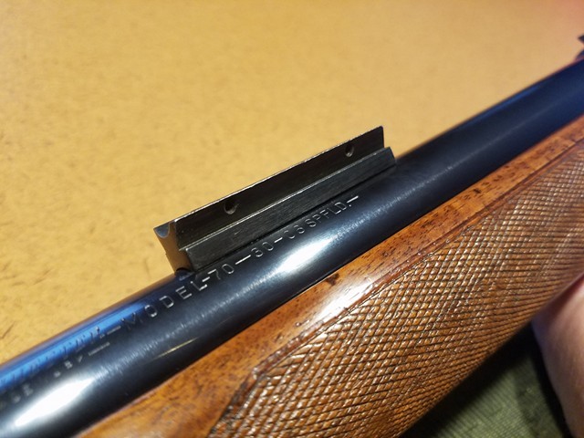

These are the screw holes for the front block on my Marine model 70 barrel. It is dated 1956. These holes were applied at the WRA factory on all WRA target barrels. I don't know if they are on douglas barrels or not, but I suspect the Marines drilled them if they werent. You can see these same screw holes in some pics from Vietnam.
This is the .360 WRA front barrel block. One way to tell it's WRA other than the U shape for the sight groove. They have dimples in the side for thumbscrews like on the A5. I call these holes a WRA dimple. I'm not sure the technical name for them. But they are for the placement of the pointed thumb screw like on the WRA A5 scope mount so the scope can be tightened on the block. On the other side is the half circle that lyman and Unertl used to tighten to the scope block.

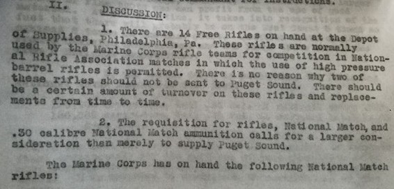

Where then, were all the "Free, high pressure rifles" when it came time to do some sniping in WWII, Korea and Viet Nam? Something is not adding up.
Van Orden and Lloyd did test one in their Sniper report for WWII. If you would be interested in reading that section of the Van Orden Sniper report, I could probably dig it out and post it. Actually I wish I had more time, I would scan the whole report and post it. Because the whole thing is sort of interesting. It's a couple hundred pages if I remember right. And Van Orden and Lloyd were the ones who ended up recommending the Model 70 with Unertl scope for the Marines. It was the headquarters of the Marine Corps who came back and said no, the M1903 was more than capable and accepted their recommendation for the 8X Unertl scope. But not the Model 70.
But what happened to the Free rifles is they were broken down for parts around 1935. See the "Free" rifles were basically like the International Match M1903 built by Springfield. Except the Marines themselves built them. They were used in the 1000 yard any rifle, any sight matches. Usually they were heavily modified and had either a A5 and around 1922 the Marines bought Fecker scopes for them. They used them from basically around post WWI, to around 1935 when the Marines bought their first Winchester Model 54's. I think it was 1935 when the Marines ordered all the Free rifles broken down for their individual parts and parts were put into storage at the Philly depot. I do know they didn't have that many of them, like I want to say 20 or 30 rifles total. I have counts somewhere but it wasn't a lot.
But it was mostly they didn't have many, they were only used on the teams for long range shooting, and they were broken down for parts before WWII. And they had been replaced for a very short period of time by the Model 54 WRA, and then that was replaced by the Model 70's around 1938. Which the fact that the Model 70 was the main 1000 yard match rifle by the time Van Orden and Lloyd did their report. That might have helped some in their decision as well. As the Model 70 they recommended was just the normal target model 70 of the time with the target stock.
If they probably had more of the M1903 heavy barrels they might have been used that variation instead of the NM's. Like the orders I have from WRA to buy the heavy barrels, and even Remington are always small orders. 5 barrels or 10 barrels. They just never had a lot of the rifles or barrels.
So it probably came down to the fact that the NM and special target Team 1903's were already in stock and they knew they could shoot, and so they ordered all the polished bolts to be blued and then all the rifles put into storage. Six months later in Dec 1942, they ordered the first Unertl snipers to be built on these team 03's.

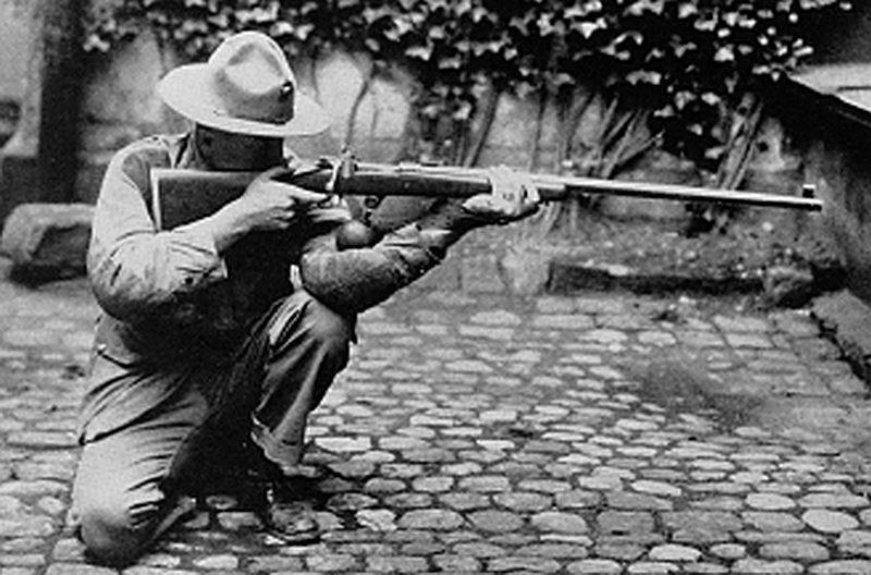

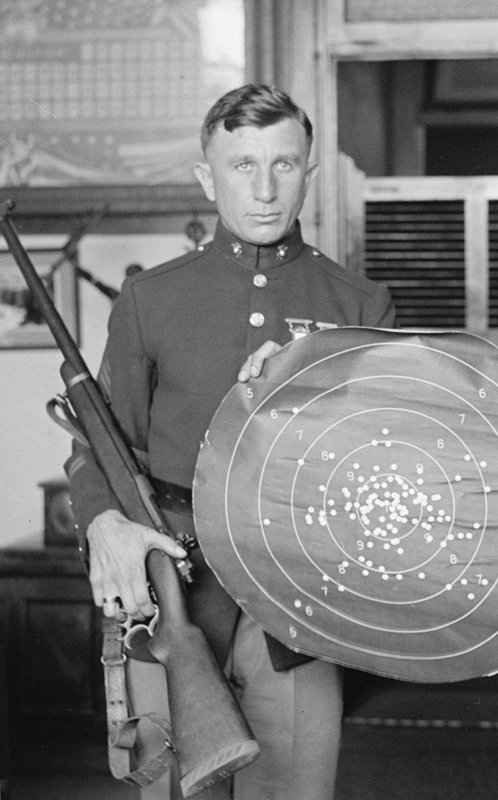

Here is probably a free rifle. The Marine detail they were basically their version of the international Match M1903. They just built them in house over buying them from SA to save money.
This is Morris Fisher with what I think is a Free Rifle probably built by the Marines. And another pic I think of a Free rifle. Somewhere too I think I have a pic of several wearing the fecker scopes. But I'm not sure where that pic is.
P.S. on a side note, notice the rubber buttpad? lol I remember when I first started to collect this stuff 20 years ago I had a big name expert tell me the military never once used rubber buttpads on rifles, and especially not on snipers. After finding a lot of the sniper trials pictures, I can't tell you how many sniper rifle trials I have seen for both the Army and Marines that the rifles had rubber buttpads. Like a lot of them have them. All the way back to the 1920's. lol

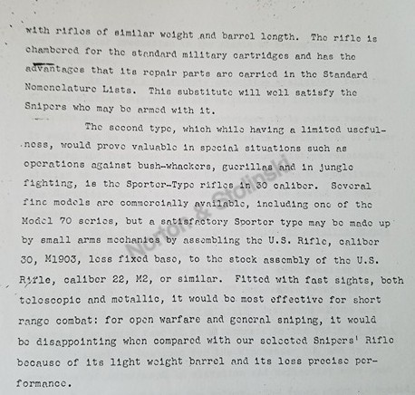

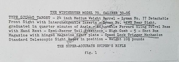

This is the Van Orden and Lloyd recommendation from their sniper trials. IT's actually long and detailed and what it does is test each rifle configuration individually and then makes recommendations at the end. I saw at the end a section that actually compares the Model 70 to the M1903 and I think you guys might find this really interesting.
Now note this Model 70 they are testing is a Target model Model 70. NOT the Sporter/Hunting model 70's that the Marines bought in 1942.

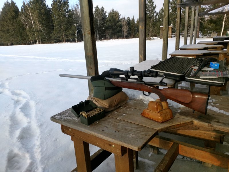

Of course, I had to shoot groups at 400 yds. with the Win 70:cool: IMG_20171224_152212095.jpg
The left is the Win 70, 2 groups and the right is my Sav. FCP in .223. Nice group with the .223 except for the stupid pull off and up to the right.
Here's one of the range:

But this showed up on Facebook last night. A brand new Model 70 pic that I wasn't aware of before.
Reactions: cornhusker86
That's an awesome picture.
Im guessing it's a Douglas barrel also with the heavier profile than the Winchester style ones.
Basing that on the lack of front sight block (not that that's certain) and with this and the 3rd Mar Div Lance Corporal it appears the barrel at the receiver ring is close in diameter. The Win barrels with the block show more of a step from receiver ring to barrel.
Thats my supposition anyway.
Steve its too bad that picture doesnt have a wider field of view.
I see a second M70 peaking out at the bottom of the frame.
That sniper is dual wielding his rifles.
What a Boss.
What a Boss.
Oh good catch, I didn't see that. And the pic looks cropped for sure. I wrote the guy who posted it and asked where he got this pic. This is a new one to me, and I have no clue where he got it. But it's about one of the best model 70 pics as most are black and white.
If I find out or find a better version I will post it.

Looking at the points the Marine has his scope mounted I wonder what the adjustments were.
I was thinking rear spot was 1/4 inch and front would be something else.
The height of bases listed by Unertl seems different from what I have seen for the M70s, the receiver block was the same for all (0.185"), but the Target barrel block 0.360", and the Bull Gun block 0.262". Am sure that Steve Earle will know what you need when you determine what barrel diameter/contour you are putting on it. Must admit it has been a lot of years since I've looked for the information.
I used to know the measurement on the 6'' position, but it eludes me now and I'm too lazy to go look it up. But it is recorded several times in the docs I have seen. A lot of you guys are shooters and I'm sure someone knows. If not I can always go back and look if someone doesn't know off the top of their head. But the Model 70 has the two position front block. The rear position towards the receiver is the 6'' on center position. The front of the block towards the muzzle is the 7.2'' on center. The 7.2'' on center was used on the 1903A1 Unertl and is usually the most common. It makes the click adjustments 1/4 inch at a 100 yards on the USMC Unertl.

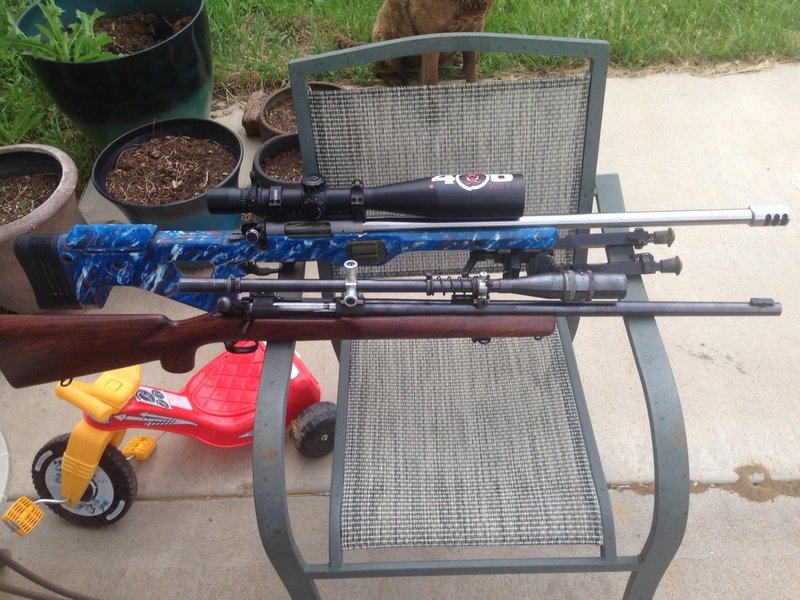

My contribution, but in the target stock. Thing kicks like a freakin mule. Worst recoiling rifle I own. No wonder they adopted Rubber pads.
I did an "Old School vs New School" pic. Over 50 years and the accuracy is darn near the same. Ha.

Also you have to throw this in there as well. In 1944, the Commandant ordered the Quartermaster to sell 371 Model 70's. So the ones acquired in 1942 less two. Now this order is approved and I have no mention that it was cancelled so for all intensive purposes it should have been carried out. But you can't prove it happened or disprove.
The only thing else I can add, the ones in NAM photos are early rifles. Basically they pretty much suspended most model 70 production from 1942 to 1945 for the war, and some of those early model 70's could have been sold for a few years post war. But soon after the war end, WRA redesigned a good portion of the Model 70 features, like the stock, the safety on the bolt, and the rear of the receiver. Plus other mods. From what we can tell in the NAM photos they were early rifles. I think at one time I had figured that the early features you see in the Nam photos had to be serials less than like 60,000 or 70,000. Something like that. Because serials after WRA re-designed and didn't have those early features.
And the Army looks like they acquired a lot of model 70's during the war as well. And the Army was even trialing them as a sniper in WWII. I have the docs where they tested them. Heck the Army had a version of the 1903 Unertl sniper as well. No one even knows about them yet. They look a fuzz different than the USMC unertl. But still the Army had one. But the Army could have had Model 70's in storage and all it took was a simple line item request and they showed up on the Marine's doorstep. Weapons were flowing back and forth between the Army and the Marines all the time. The one thing I have learned by digging in the ARchives, is nothing was exclusive to one branch. You see the Mairnes rebuild 1903's and build snipers for the Navy. You see the Army refinish Marine 1903's. You see the Army rebuild the Marine 1918 BARS into the 1918A2. You see weapons shipped to the Marines from the Army and Navy and then recalled to which branch shipped them a year or two later. Nothing was ever static. If one branch had it, any other branch could acquire it from each other easily.
There is just so much we dont know. And I think the books have butchered a lot of our topics. I think if more of dig in the archives we are going to rewrite a lot.
But here the order to sell all the Marine model 70's acquired in 1942. The books say these were the rifles converted to snipers. But yet here is a order to sell them.
