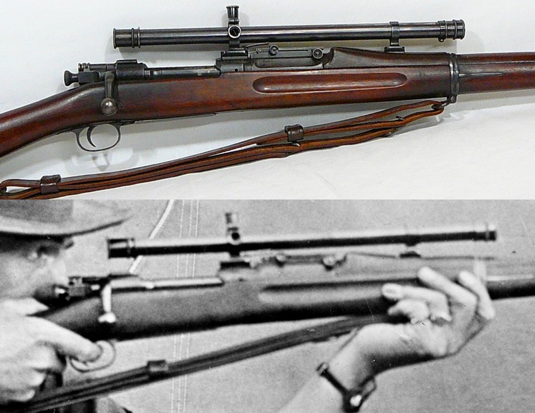

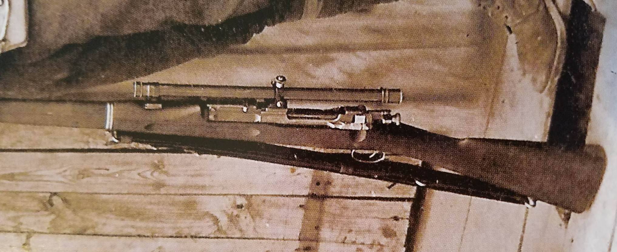

It's the scope in the lower right hand corner. The A5 with the different mounts. The Mann Niedner was a conversion on the way the scope was mounted on the m1903 rifle. Franklin Mann invented a tappered style base that mounts a scope on a rifle. It's a wedge design that basically locks without any screws or anything like that. Each peace is a wedge and under recoil they tighten on each other. It's a very secure way to mount a scope.
Franklin Mann and Adolph Niedner both worked together and Niedner used Mann's tappered block design on many rifles he built to mount the scopes. In 1916, Mann Passed away, but Niedner continued to use his design. In early 1917, Adolph Niedner did mount 150 scopes on Marine 1903's in Philadelphia. But it's not for sure 100% he used this tappered base design on the MArine rifles, as Niedner used everyone's design. But it's assumed he probably did use it.
After Niedner was fired from the contract in June 1917, the Marines contacted Winchester, and WRA mounted 500 A5 scopes on rifles for the Marines by late 1917. These rifles used the normal commercial A5 #2 mount and the Springfield Marine Bases produced by WRA. Which placed the A5 scope at the normal 7.2'' spacing, compared to the early WRA design of 6'' spacing. The Springfield Marine bases produced by WRA are almost identical to the John Unertl O&E used on the WWII 1903A1 Unertl snipers. I believe John Unertl copied the WRA springfield Marine bases for the 1903 in the 1930's as they are almost identical and only have minor differences in the way the scopes mount.
The Army in January 1918 Contated WRA and requested the exact same rifles the Marines had received in 1917 off WRA. So the Army shipped rifles to WRA, and WRA mounted the scopes the exact same way they did the Marine rifles. In the end the Army received 900 rifles.
The one M1903 rifle above is one we believe was part of the Marine 500 order or the Army 900 order. There is really no way to say for sure. I personally bleieve it to be Marine because of the serial number and the close proximity of Marine snipers in that serial range. But there is no way to prove it. These rifles are pretty rare as we know of 4 rifles that are complete that still exist. 3 in private hands, and one in Cody museum.
You first start to see the Mann Niedner rifles in photos of the Marines in late 1918. Which they were the regular A5 scopes where the mount was converted to the tappered mount design. And they used a little different plunger and micrometer design.
It is unclear if those ones pictured with the MArines in late 1918, are some of the 150 that Niedner had mounted in early 1917, or they were ones that were starting to be produced at the Philadelphia Depot.
The Marines had ordered a bunch of spare A5 scopes off WRA and started to receive them by summer 1918, and they had atually sent Marines to WRA in 1917 to learn how to mount scopes back at the depot.
The Marines did copy the Mann Tappered block design off Niedner, and made slight changes to the blocks, and called them the Marine Tappered block design. These Marine tappered blocks were produced at the Depot through at least the mid 20's. Even though some Mann Niedner rifles were last built in 1941 to be used for training for the 1st and 2nd Marine Division. Even though those were probably built using recylced parts.

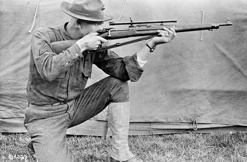

Here is a really good pic of a Mann Niedner A5 sniper in France. I suspect this post the Armistance, but it is undated.

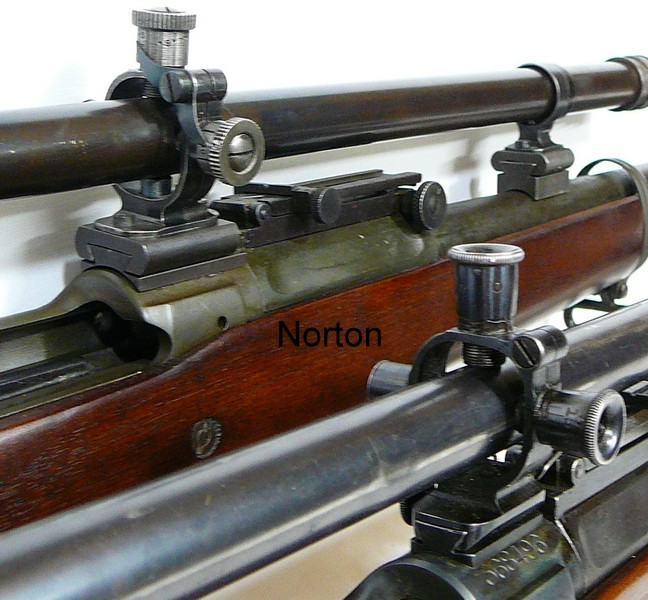

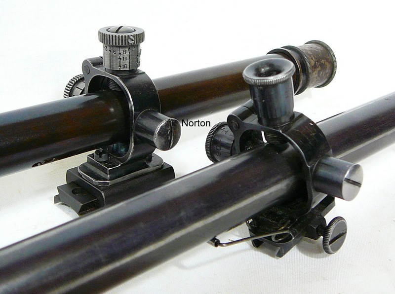

This is the Mann Niedner covnersion of a A5 next to the regular A5 in the #2 WRA mount.
They basically took the WRA #2 mount, and cut the bottom of it off, and then attached the wedge bases. They then just roughly screwed it in from the top and then staked the screws.
They got rid of the grasshopper spring on the commercial A5, and drilled the base for an internal plunger design. They also removed the commerical A5 micrometer knobs and installed a set of easier to read knobs with a pointer that made them sort of click.
This was a pic I took of a comparions between the Mann Niedner conversion (top) and the WRA style (below). The top is just a standard rifle with the Mann Niedner blocks and scope sitting on it. I just wanted to see what it would look like next to each other.
I've only seen two Mann Niedner rifles that I though were real. According to the Marine docs, almost all were broken down for parts and don't exist anymore.

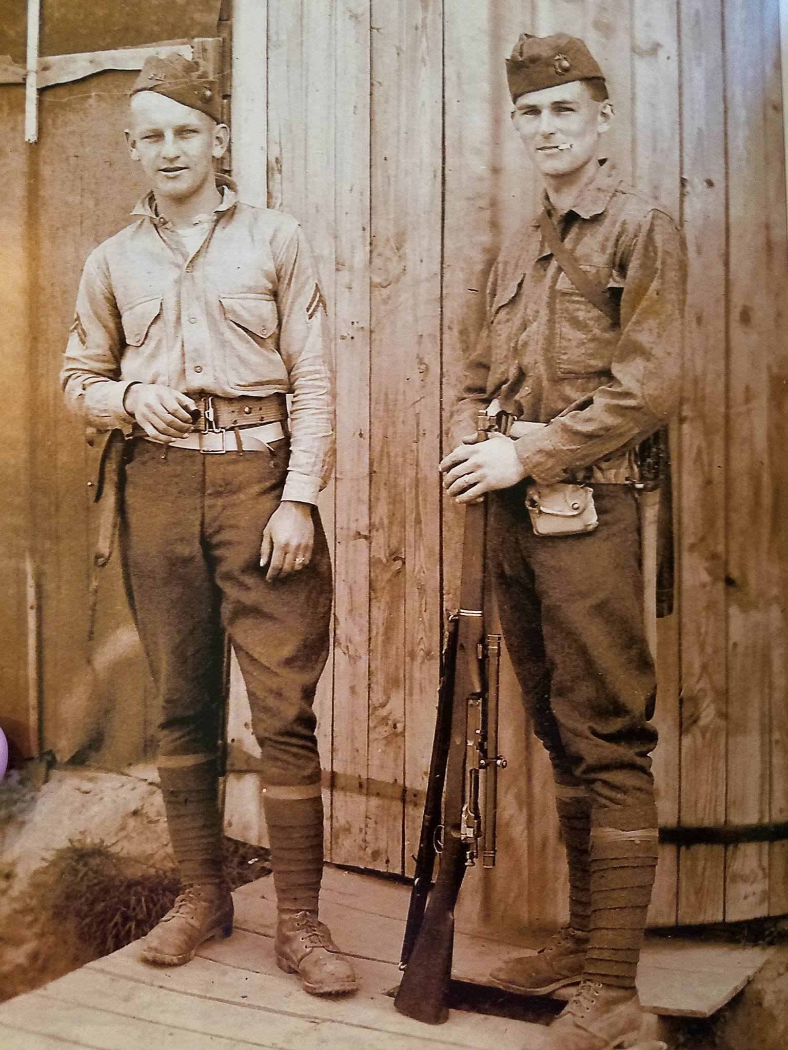

This is the Winchester design photographed in France in late 1917. The pic is dated at the ARchives at 1917. But it could be possibly taken in Jan 1918.
I do have a pic of this type of rifle too with the Army stateside training. It is the pic of them at the bottom shooting on the range. Which was their intended purpose by the Army, but some of the Army A5's did go to France, as I have the counts of them over there.

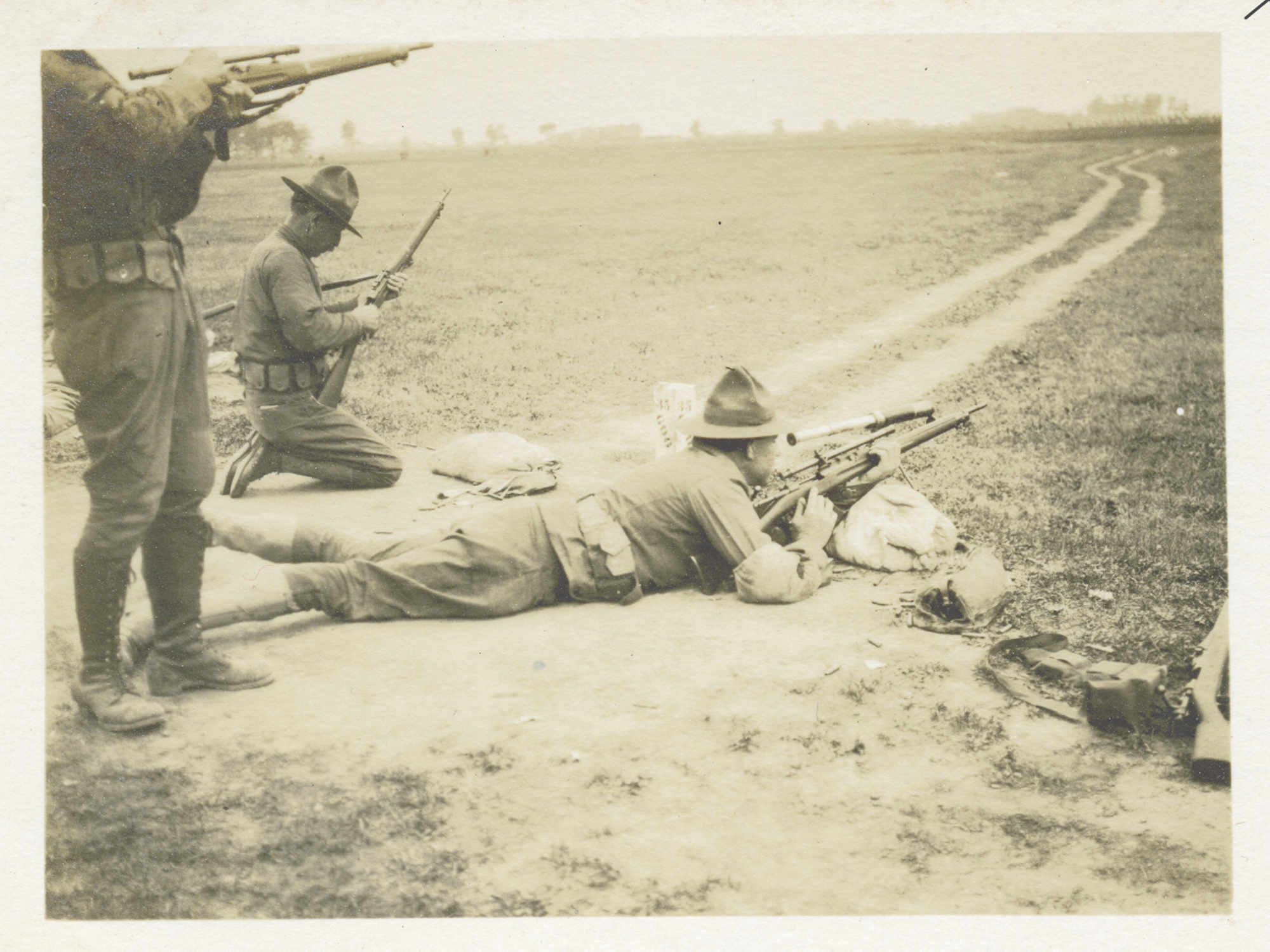

This is the Army pic of them being used stateside.

Interesting thing is the cartridge looks like a 30-40 Krag not the 30-06. your picture above does not show an action like this and there is enough to see in your pic to see that it isn't.
This was a photo I got online that said it was a Mann-Niedner. But, I honestly do not know. Most of the action pictured looks very different, with the exception of the firing pin knob, from the 1903
This may well be a different Mann-Niedner collaboration as they did do a lot of work together before Mann's death.

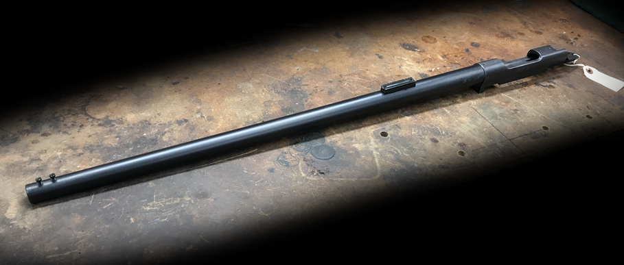

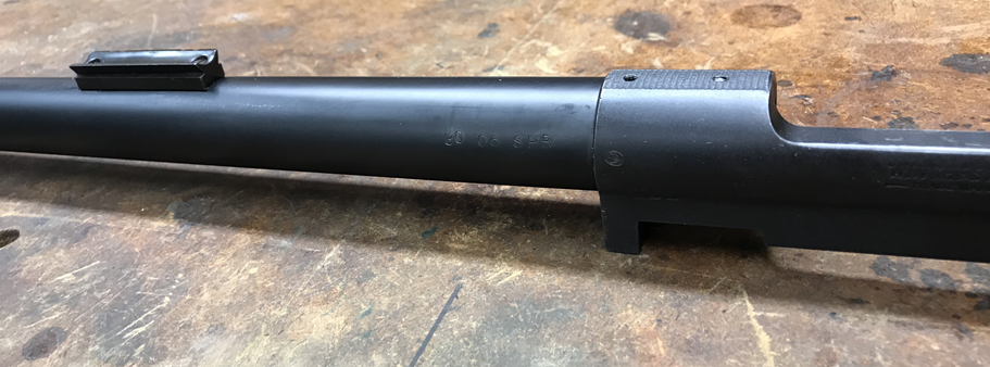

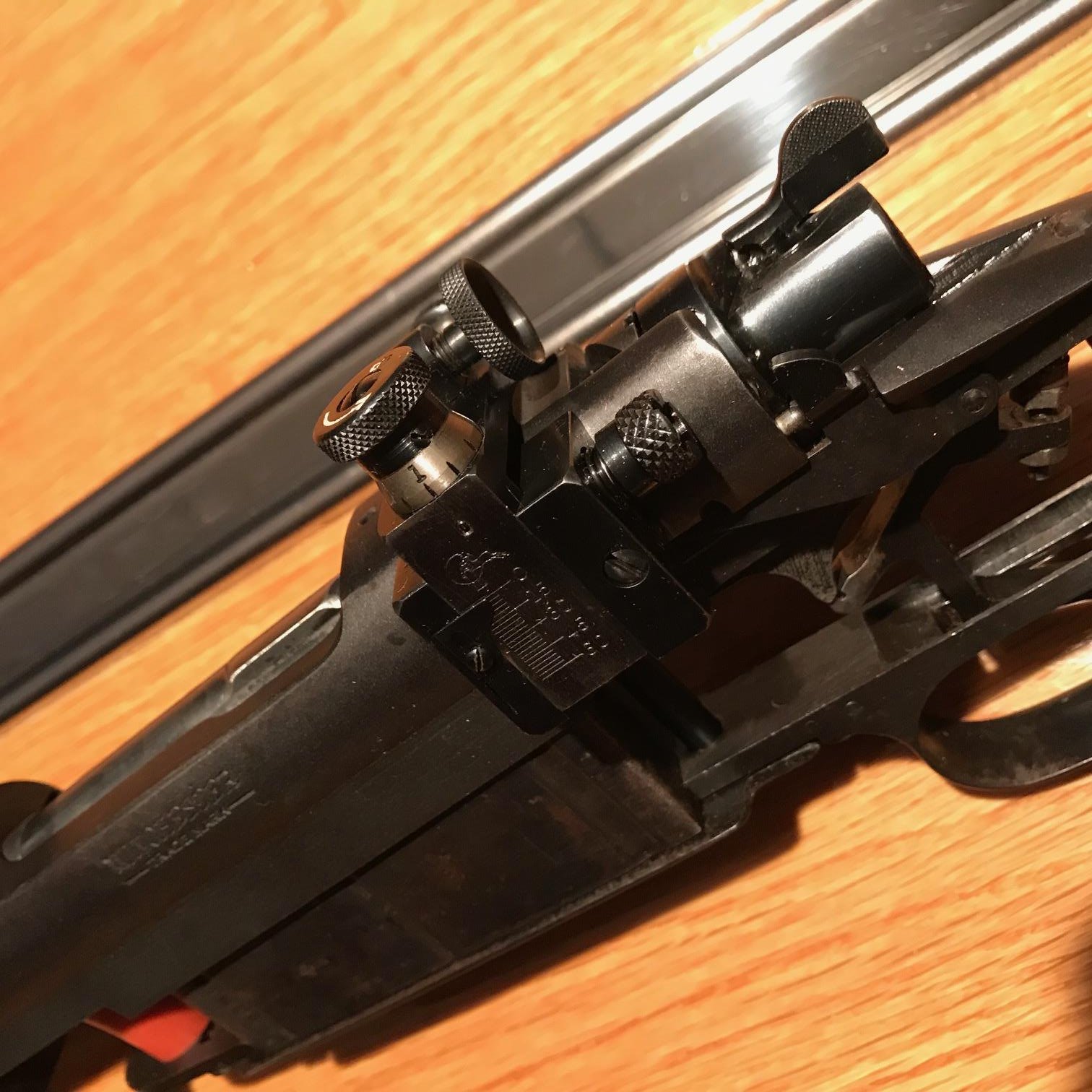

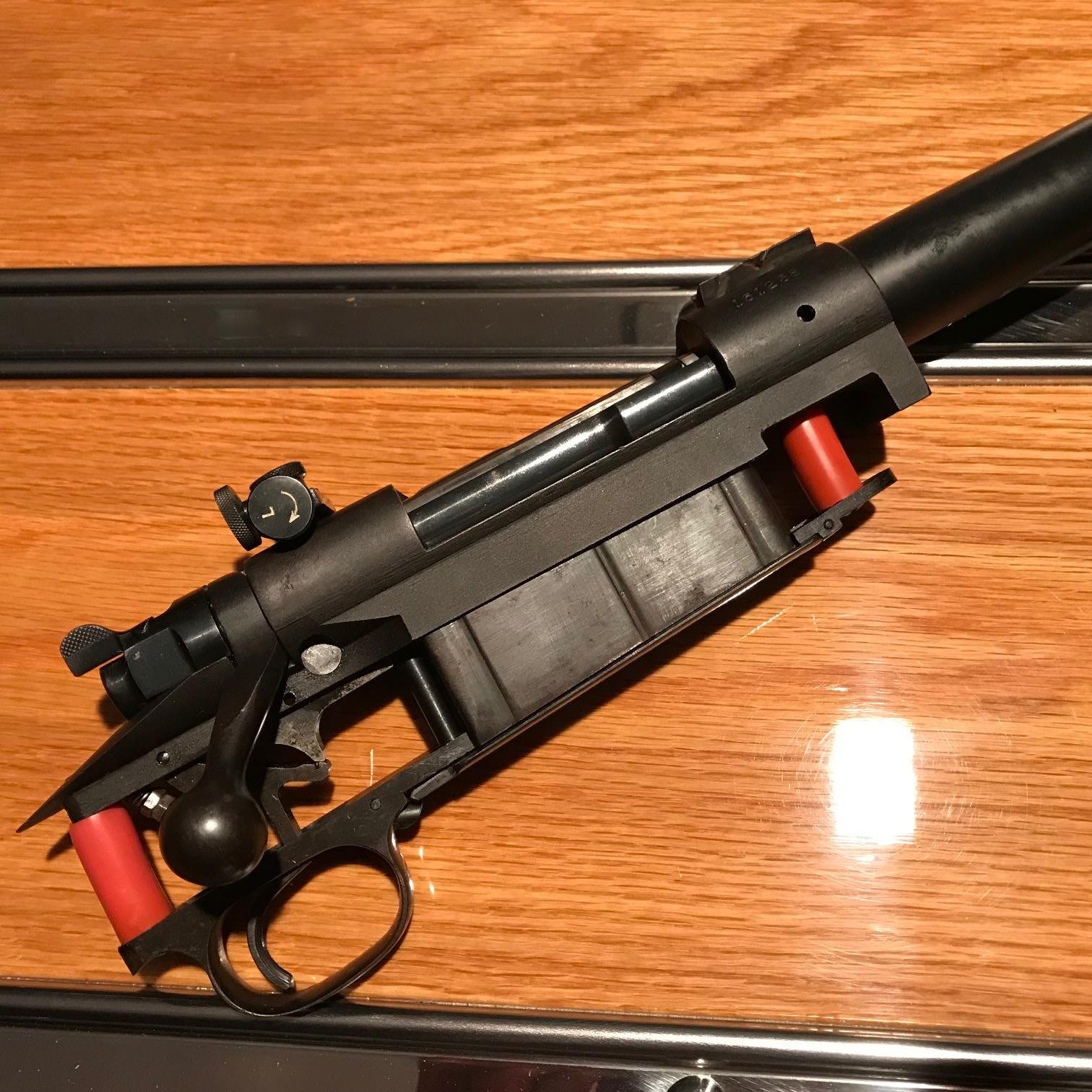

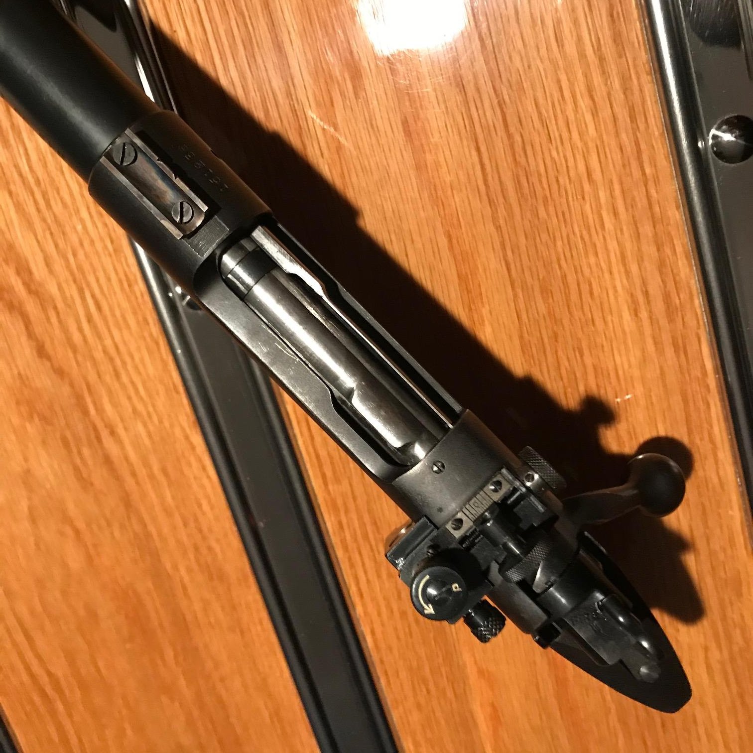

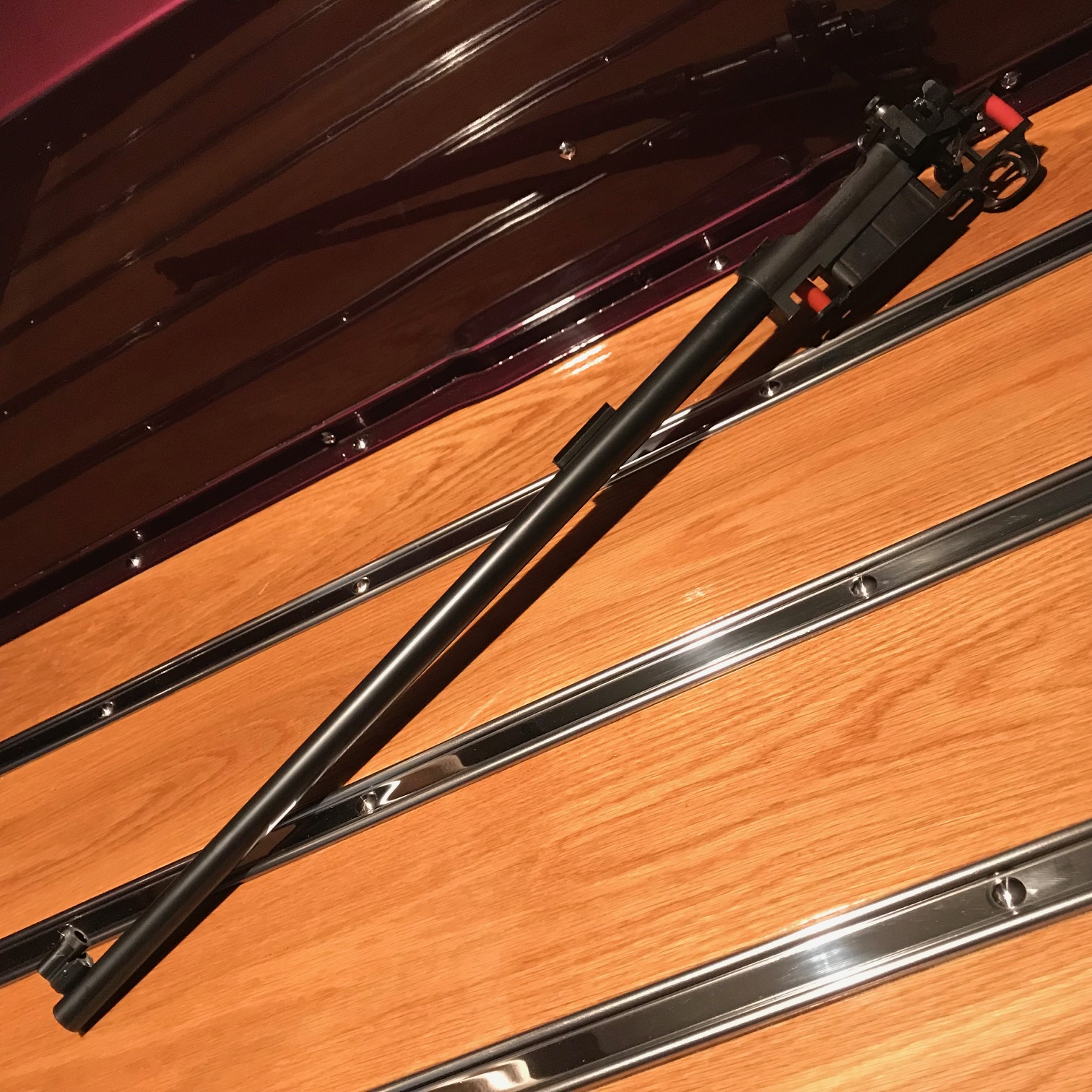

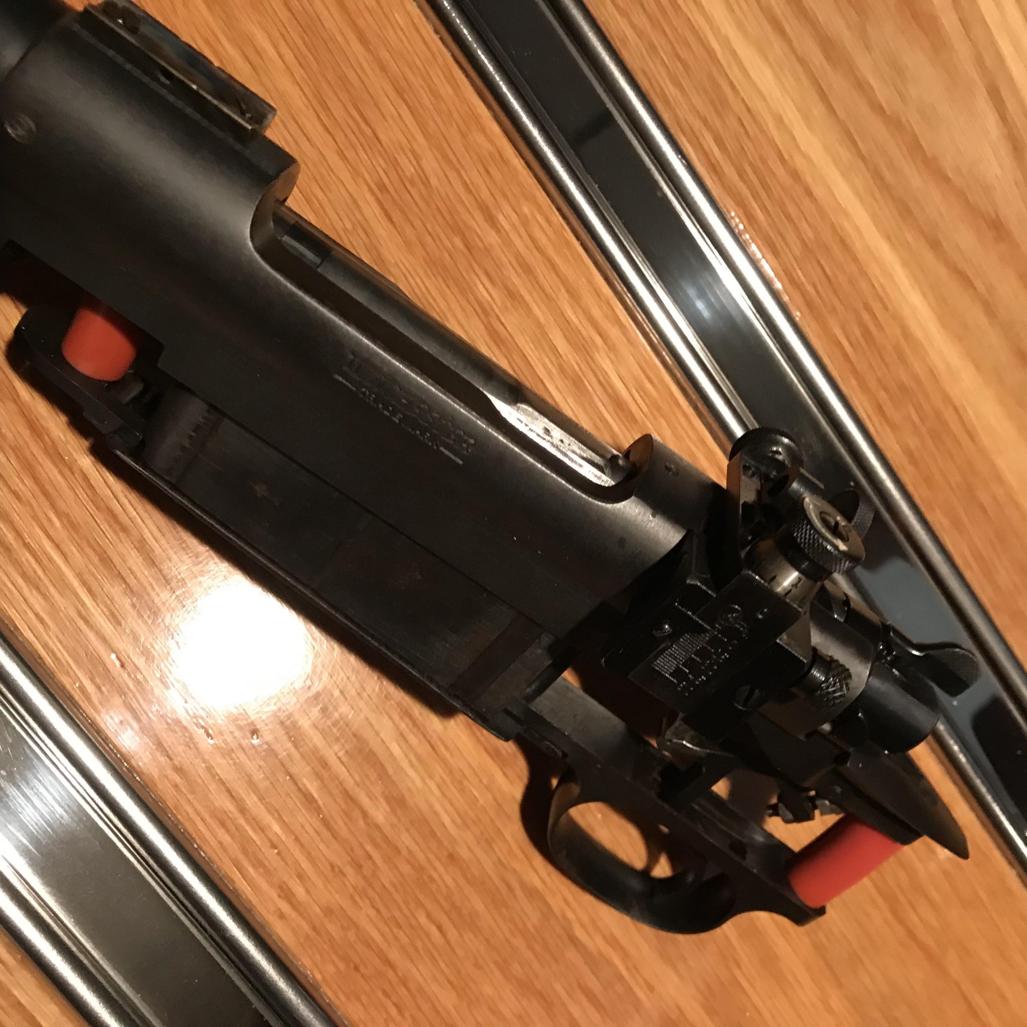

but we are back in build mode with some action blueprinting.......
THAT ...is one hot lookin' oiled beauty.??

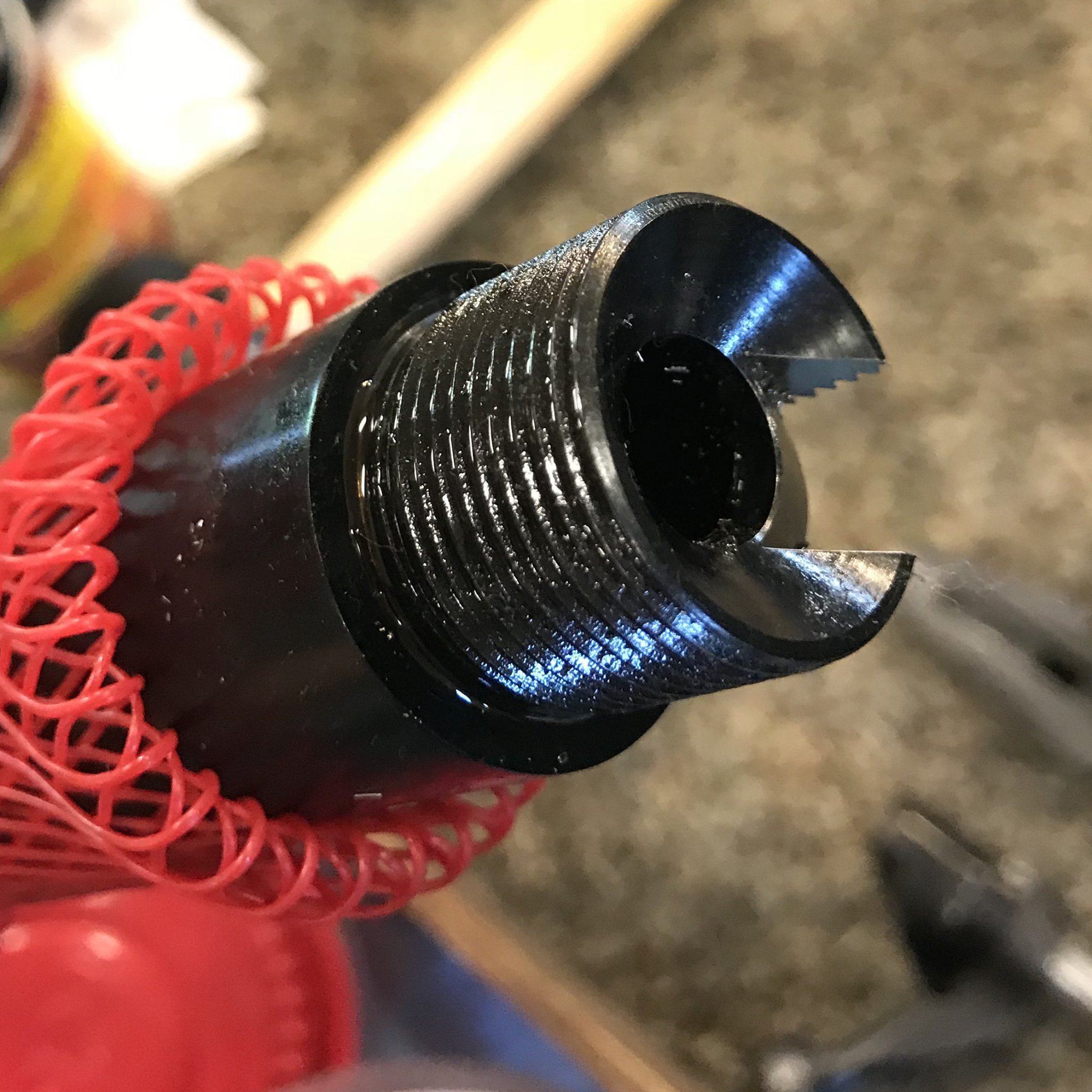

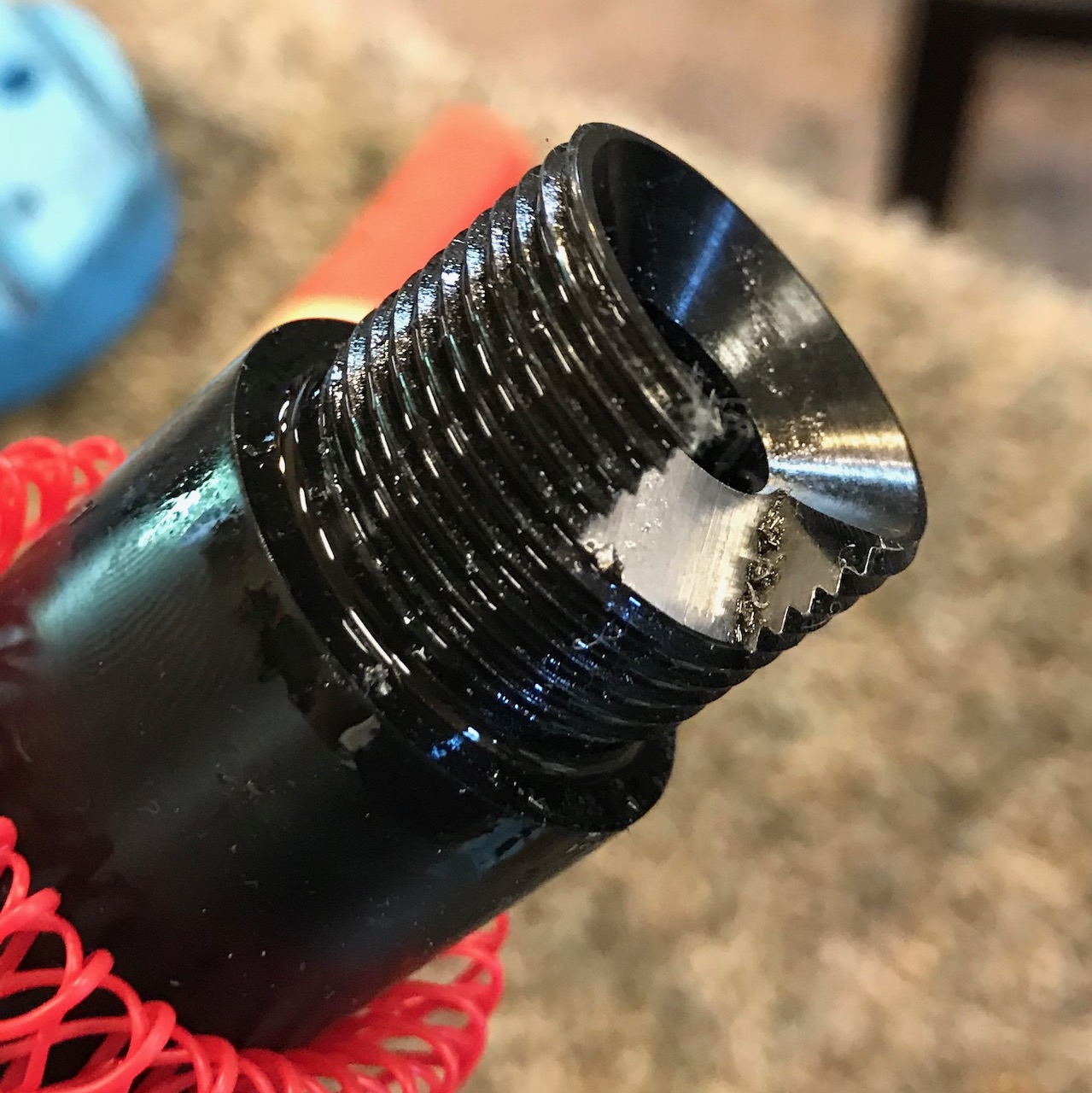

Ive got a picture somewhere of the jig he uses to do the extractor cut, it looked like a great way to finish it real nice.
I sent him pictures of the USMC extractor cuts made on replacement barrels and they were pretty rough. This loos nicely done.
Contacted him last week he has cut the chamber with a match reamer.
I had sent him some of my reloads that I feed my Garands and 03s with and they were a tad too big for his match reamer.
He has a more generous chamber reamer coming in which is fine by me. This rifle will shoot just fine without the match reamer and making special loads.
Kind of surprised by this as I reload on a Dillon S1050 and hit the sizing die twice. Once to deprime the second time to final size and trim on a rapid trim. The Dillon rapid trim dies are pretty tight, close to small base capacity. I size for the Garand so about .003 under fired size. I have never had a feed issue in the Garand or the bolt 03s.
That must be one tight match chamber die.

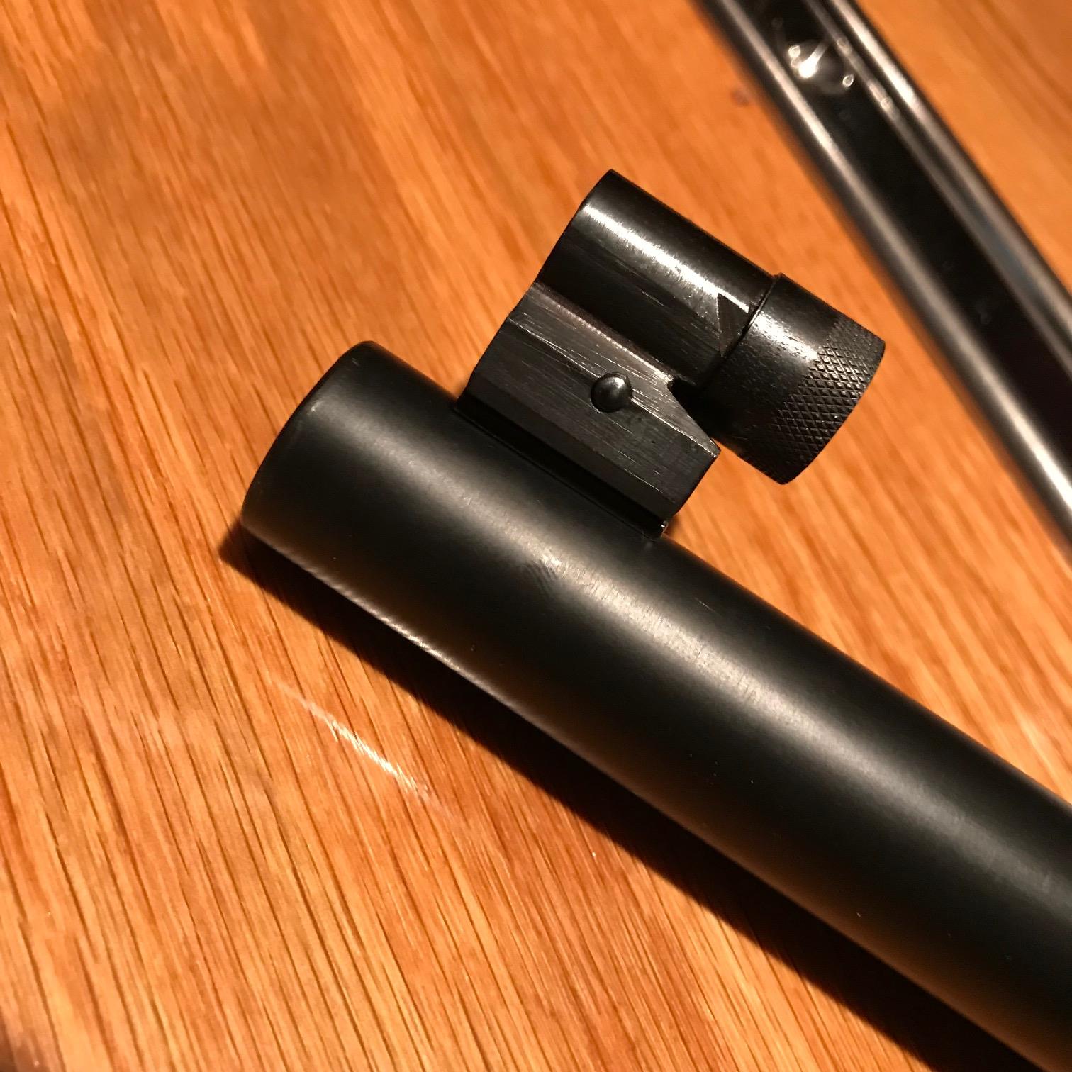

I will post some pics soon, I have scope blocks, front sight block, barrel, and a Unertl 10X in USMC mounts incoming...thank you for the lead on the parts!
Ohhh, you did good on the Unertl 10X. Now that you have yours tell me your hunting ground so I can go looking.
and before anyone critiques the builder regards the barrel marking.....
If you look back in my build guide there is a picture of a Douglas barrel marked by the Marines in this same manner.
I wanted that "crude" look the Marines came up with after realizing crayon wouldnt last.
Reactions: camocorvette
Looks Great...I really like the sights!! I may have to give some thought to getting a set of those also : )
