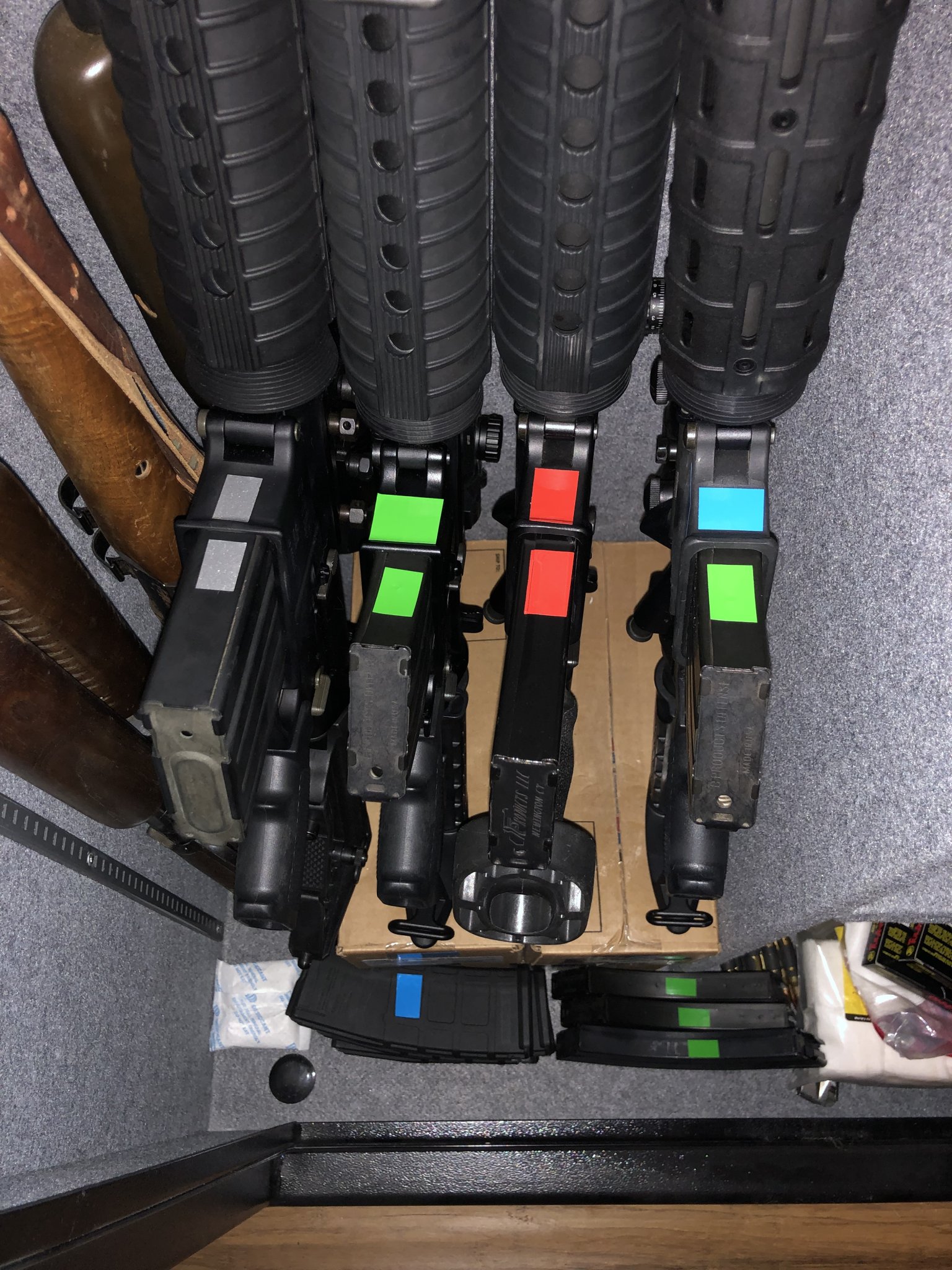

My issue is cross contamination. I have so many 556 guns and magazines that I know I would get shit mixed up and blow a barrel. For that reason I have shyed away from it, even though I use 350 legend and 6 ARC/6.5 G. Since neither of those are HD guns, chance of mixing stuff up is much less. Especially under stress.
I use a color/coding system for caliber of weapon, their mags, and the ammo. It works for handguns too.
Reactions: Earnhardt
