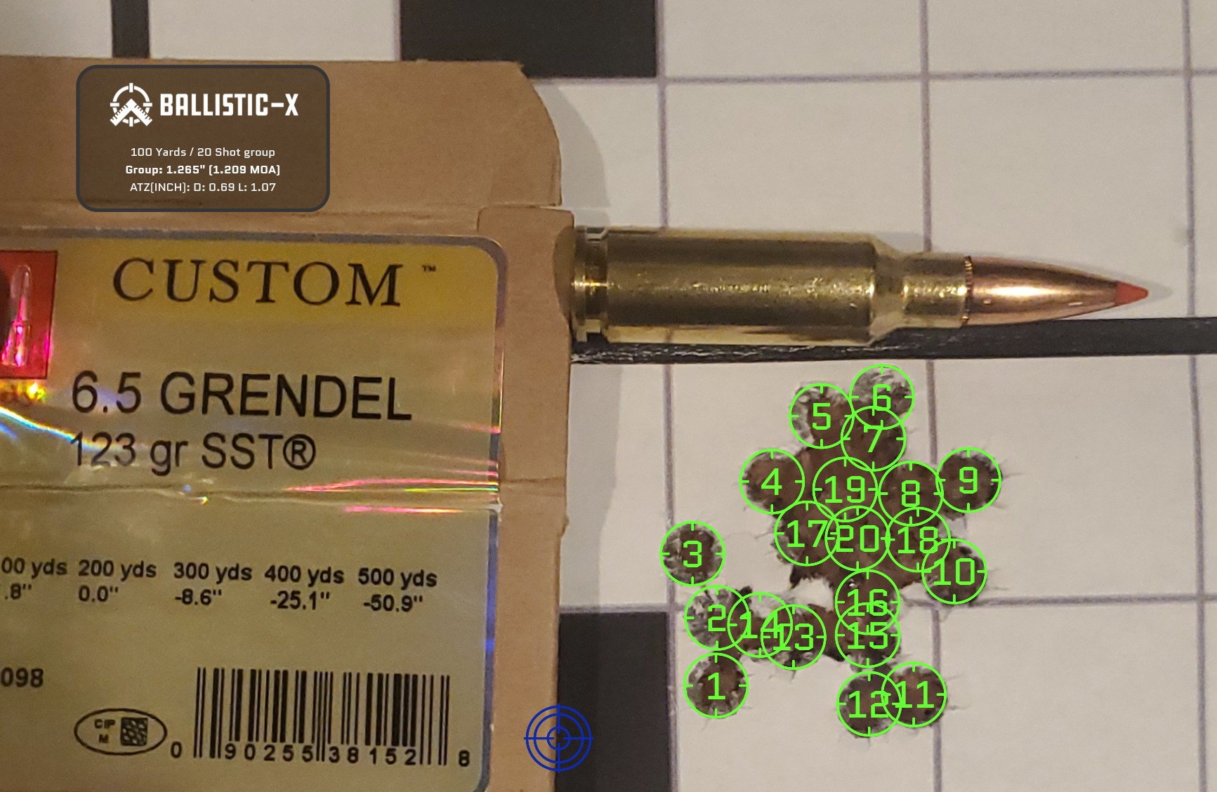

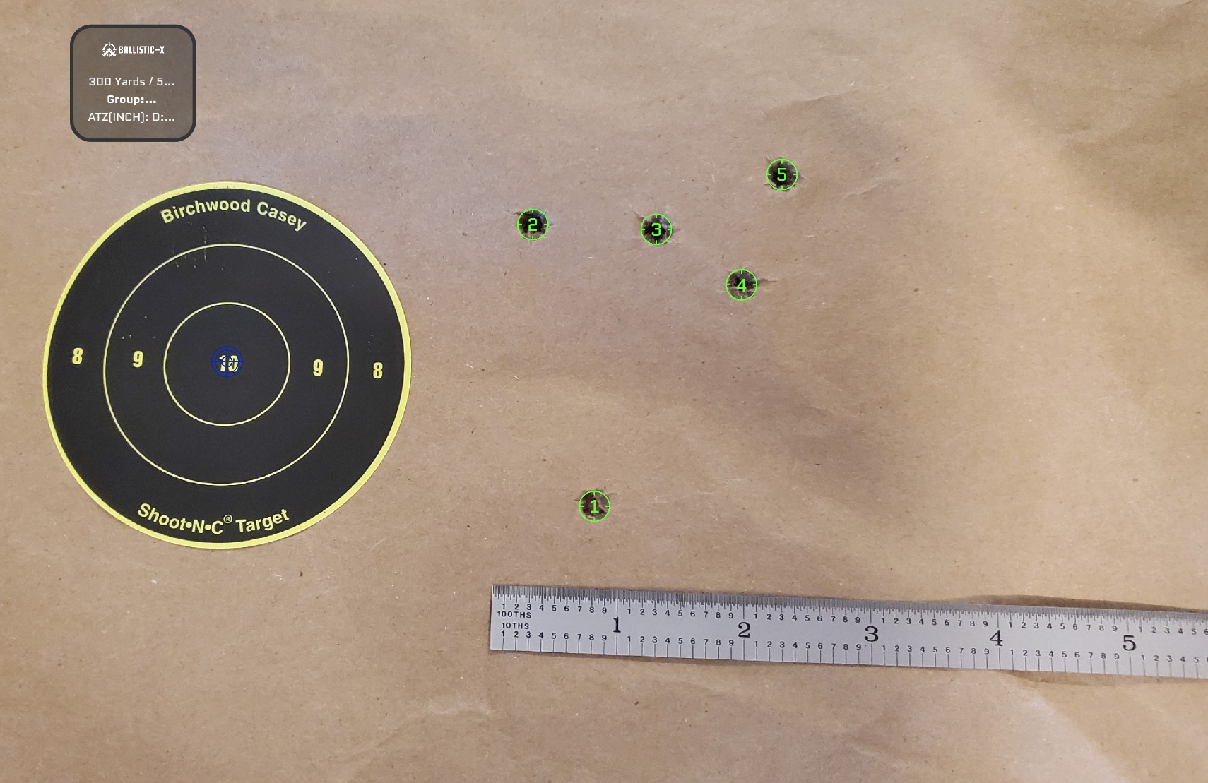

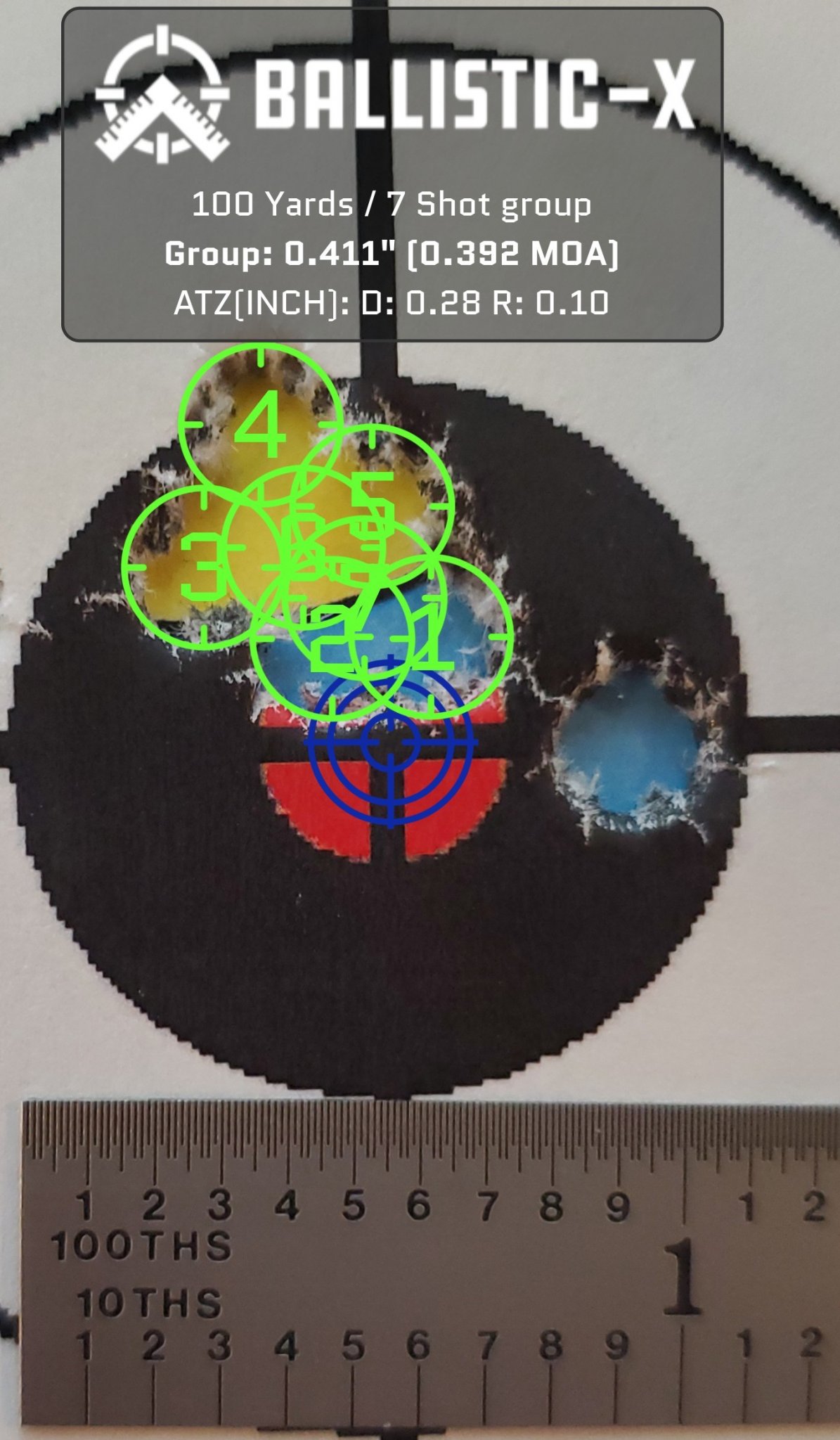

I went to the range this very day.
I'm hard pressed to ask for better results. Getting 2550-2600 out of the SST and 2600 and change from the Underwood.
I have found the Underwood to shoot ~ 100 FPS faster out of the shorter barrels, i.e. 12.5 SST is 2300 ish, Underwood hits 2400.
This is 105 yards with an old man at the helm making the rifle look bad.

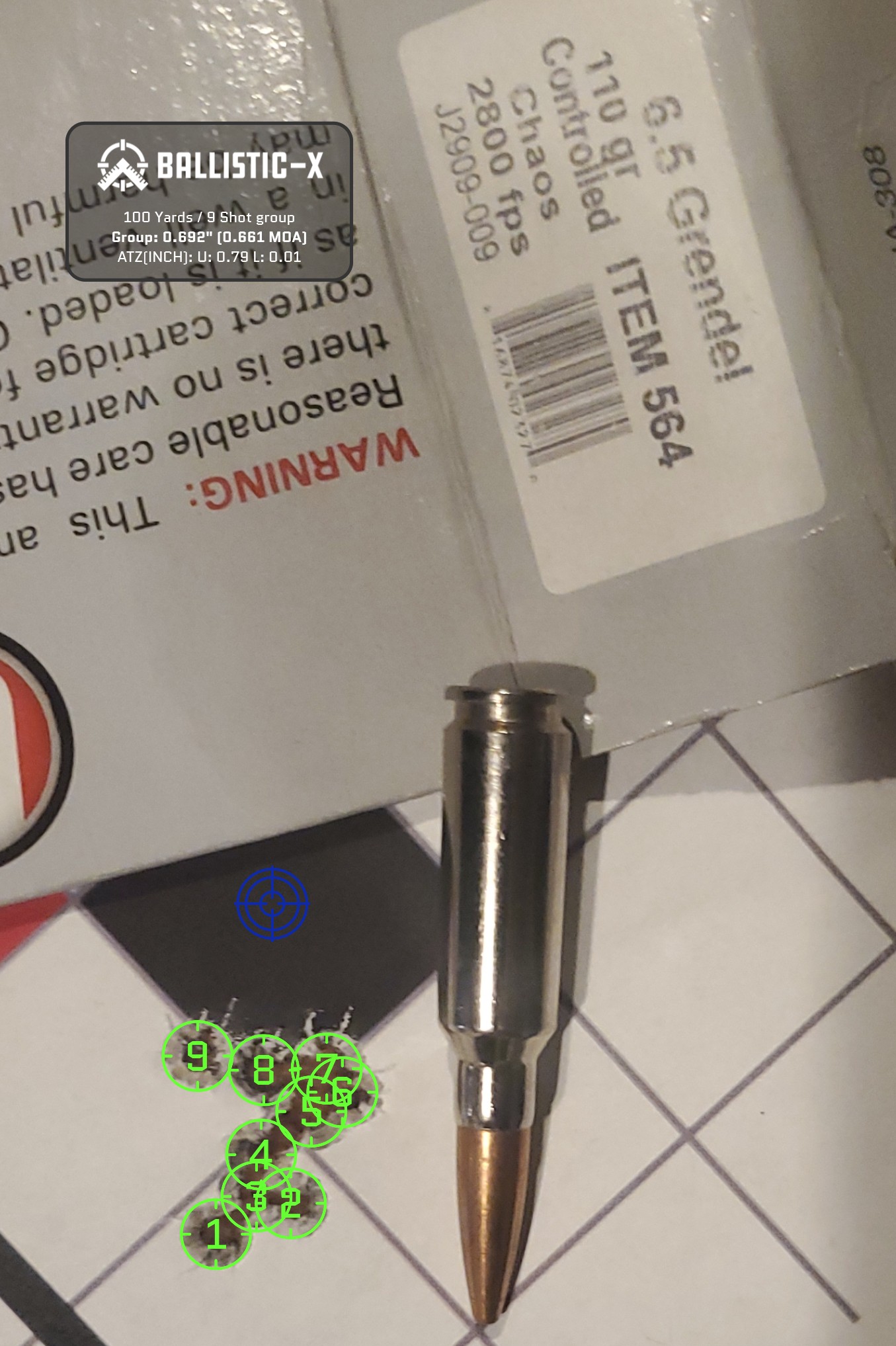

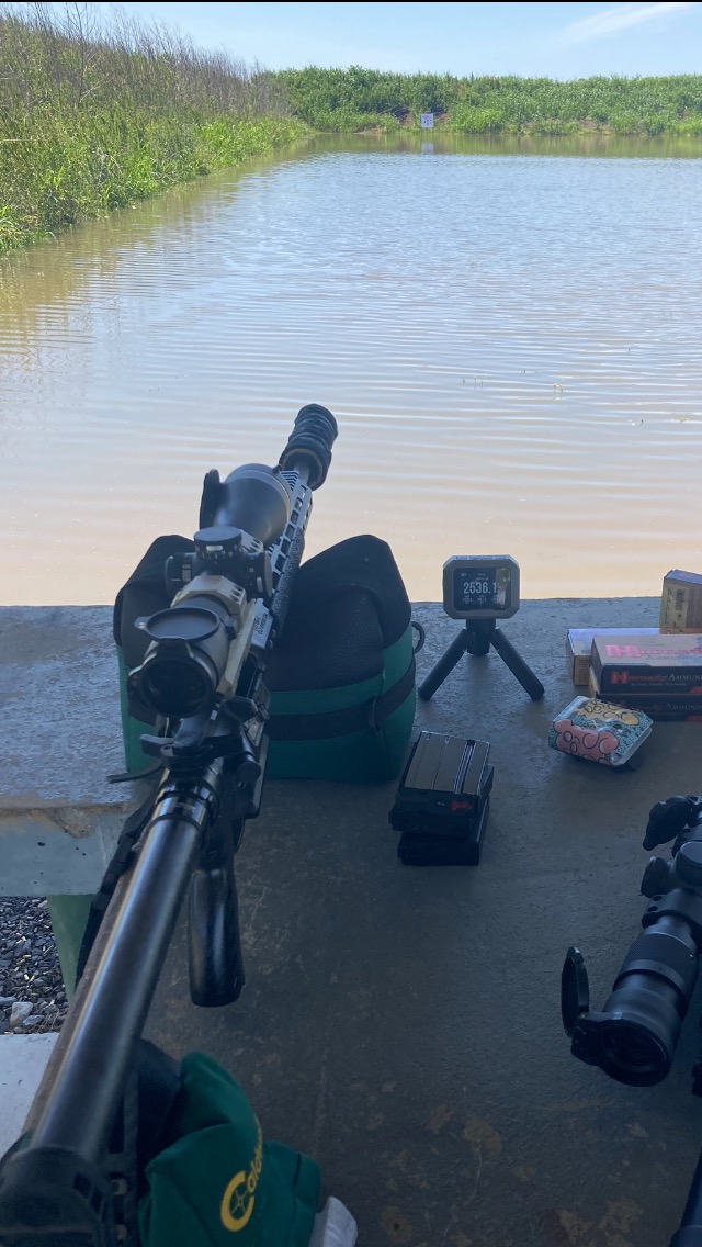

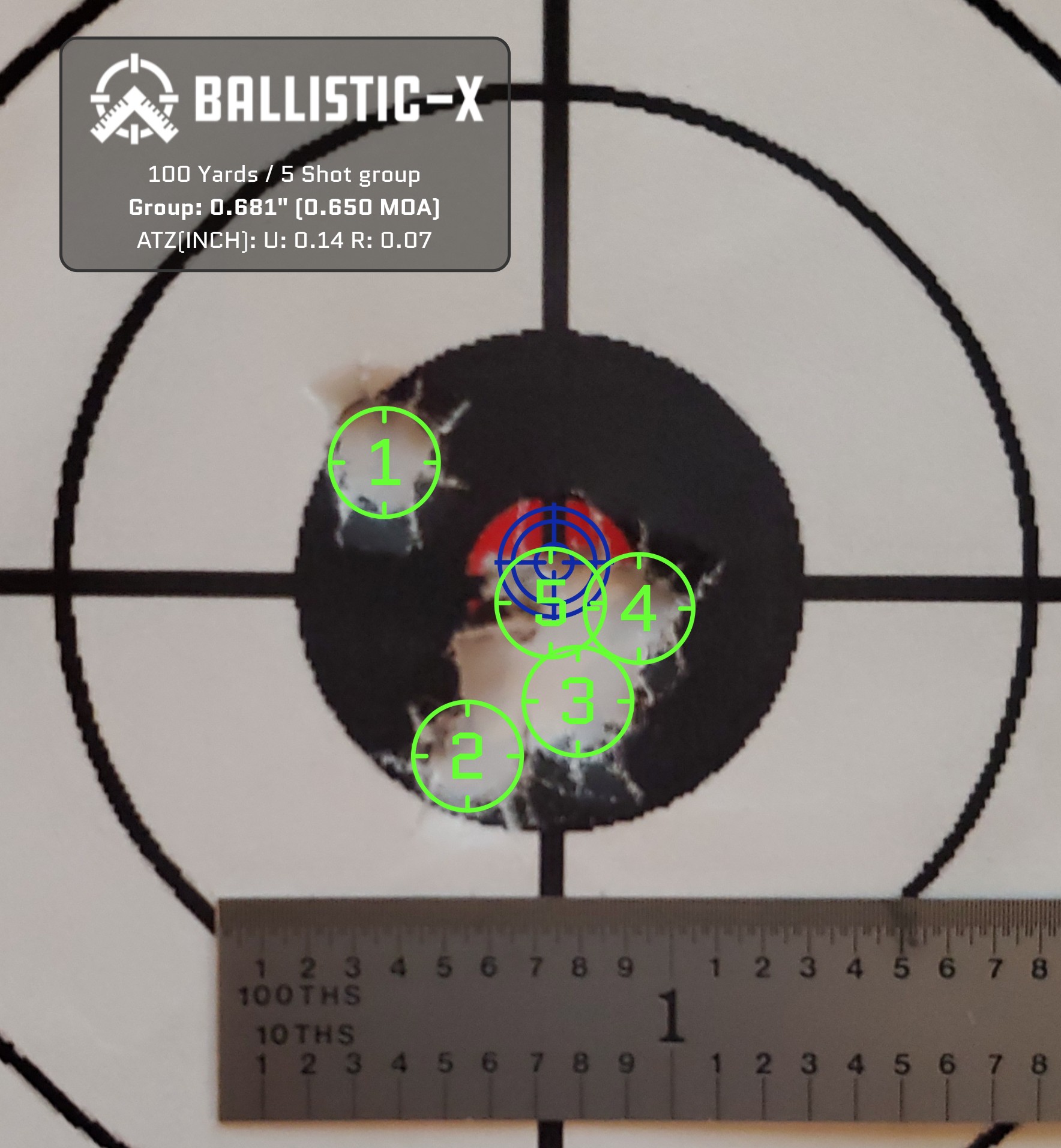

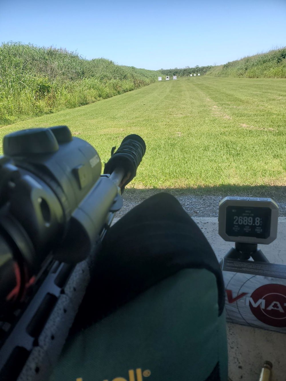

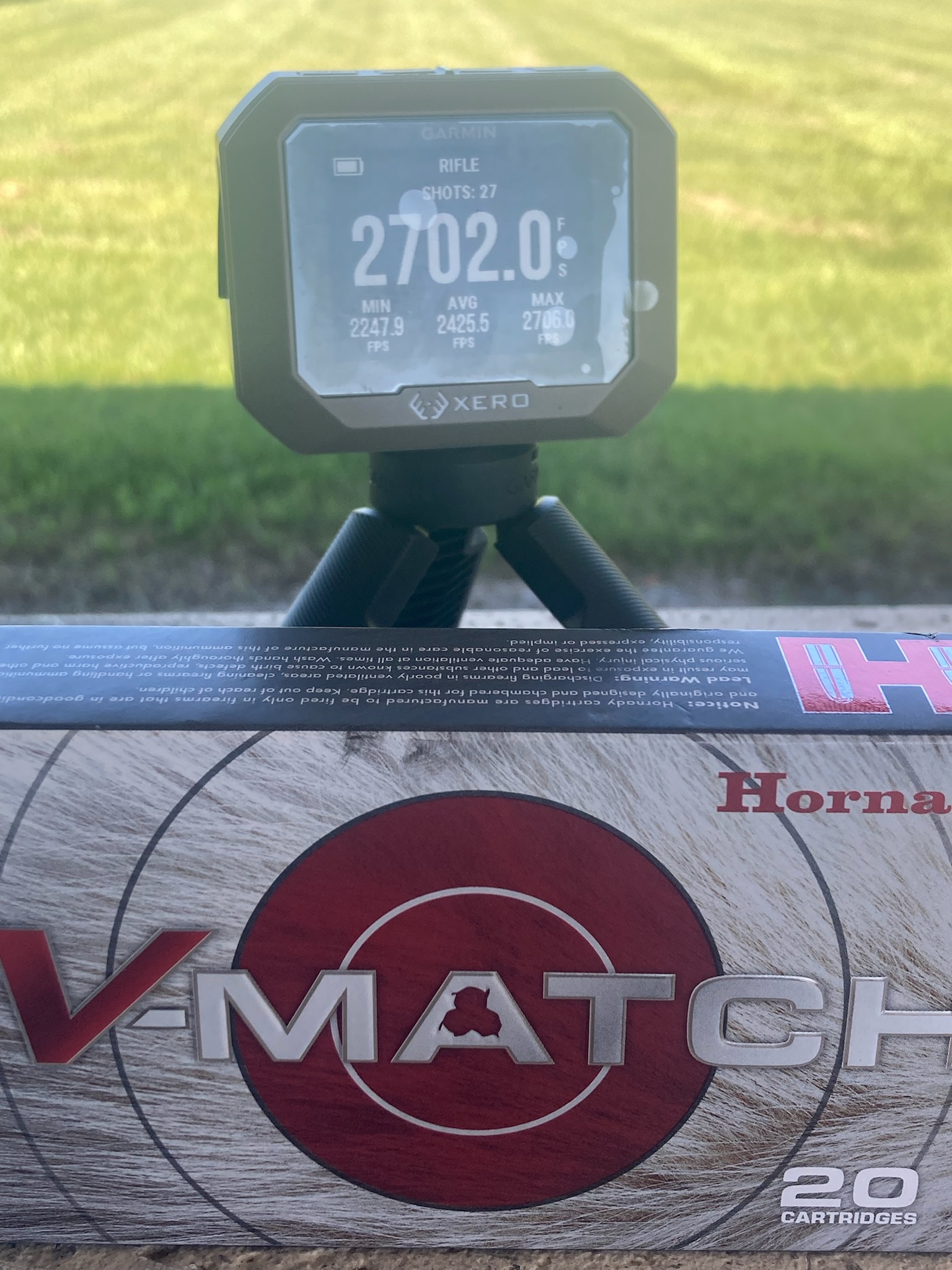

Not only would I get into the Grendel again in 2024, I couldn't be happier with it. We're getting married in the fall.
I had a great day at the range. This was all shot with a 20".
I'm bound and determined to shoot a sub half MOA 10 shot group. The gun will consistently hit .6 with Hornady SST, ELD, and better than that with Underwood, but I've got more SST than the rest. Forgive the group that disregarded that lil guy. I put 7 in the group I wanted then threw 8 and 9. I don't even want to talk about 9.
I'm getting 2690 - 2700+ out of the Hornady 100 Vmatch. It made 2450 out of a 12.5".
SST is 2550-2575 from the 20", 2275-2300 from the 12.5".
I owe someone at Steiner a beer. Its more a story for the clip on thermal thread but I would have never put my VX-6 on the Grendel as it has lived happily for years on my 308 bolt gun... in a safe.
I initially threw it on the gun for what I thought would be one hunting trip in a cheap mount. I've come to realize they're meant to be. The varmint reticle is a perfect match - zero'd at 100, the drops are dead on at 200, 300, 400 and 500. Stayed sub MOA at 300 and 400, and I suspect I'll be able to do the same at 500 and 600 next go round.
I need a better mount, and to get my scope dead level, but I suspect that this combo will be super excellent out to 1000 yards. I knew I didn't get that custom dial made yet for a reason.
Be it a short gun or a long gun, its a fun gun.

Any hoot some velocity results in the 24” BHW 1-8 barrel.
100 gr ELD M we’re no joke with PPV . 2,880
Actually hit 2,920 but at 2,880 three gr less.
120 Gr PPU CFE. 2680
123 gr SST AR comp 2676
130 gr PPVand AR Comp 2550
140 Grain AR Comp 2,423
Now I’ll have to start building ladders in 5 round groups at 100 and 200 yds. For starters. Very promising. My 20” BHW barrel run approximately 100 fps slower

I have 16" version of this barrel, so far it's seen Hornady Black 123gr and Hornady Amer Gunner 123gr and it likes both of them. I've taken it to 1k on a calm day.
