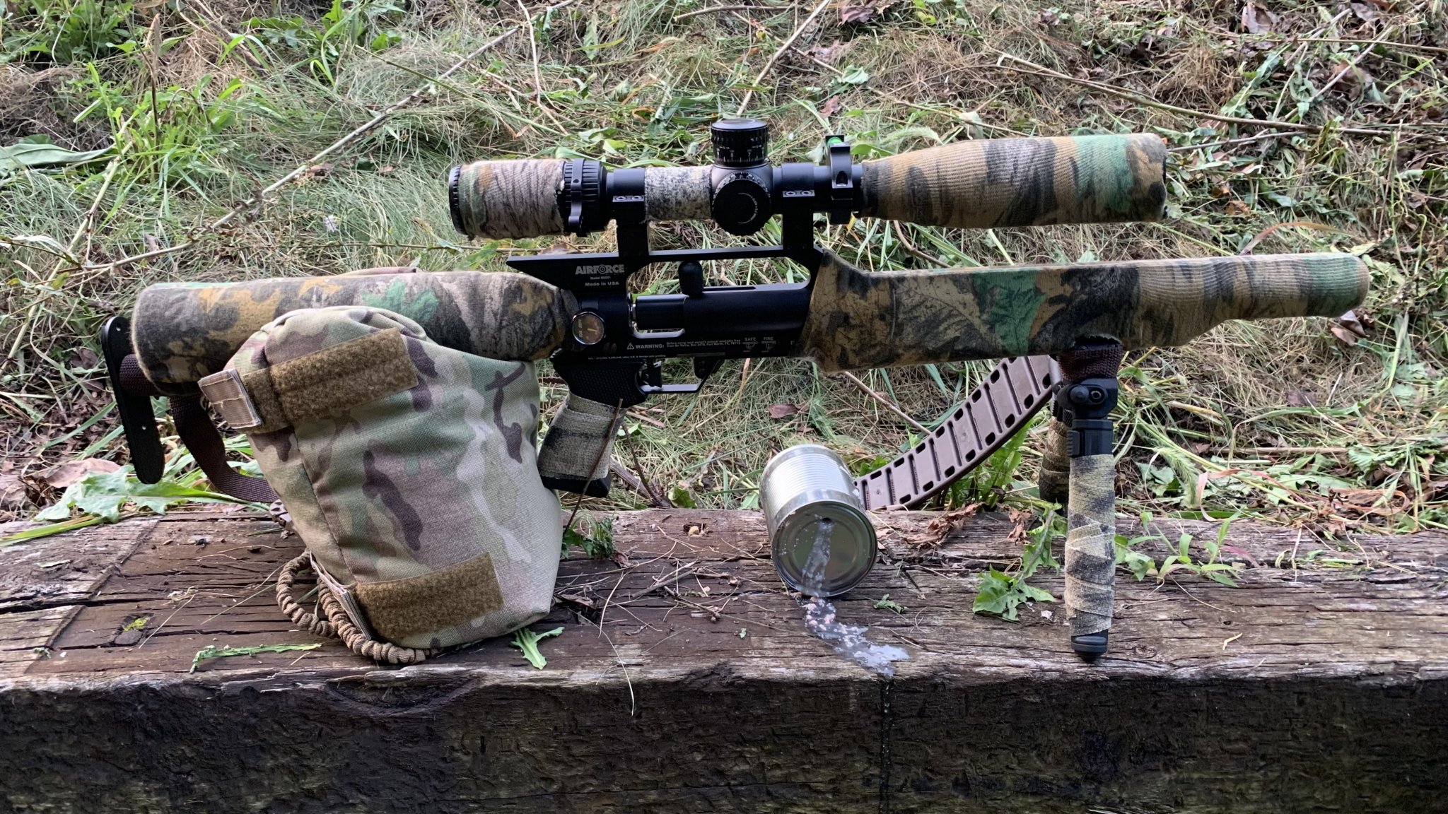

What bipod are you using and is that an MDT night vision bridge holding it?
That is a GRS bipod and a Sabre tactical rail, just like woogieman said. The black night vision rail comes with the rail and the brass on is sold separately. I needed that set up to be able to use the Nightforce wedge. It is 46 mils to get to 600 yards with this set up and I only had 34 mils up on the scope.

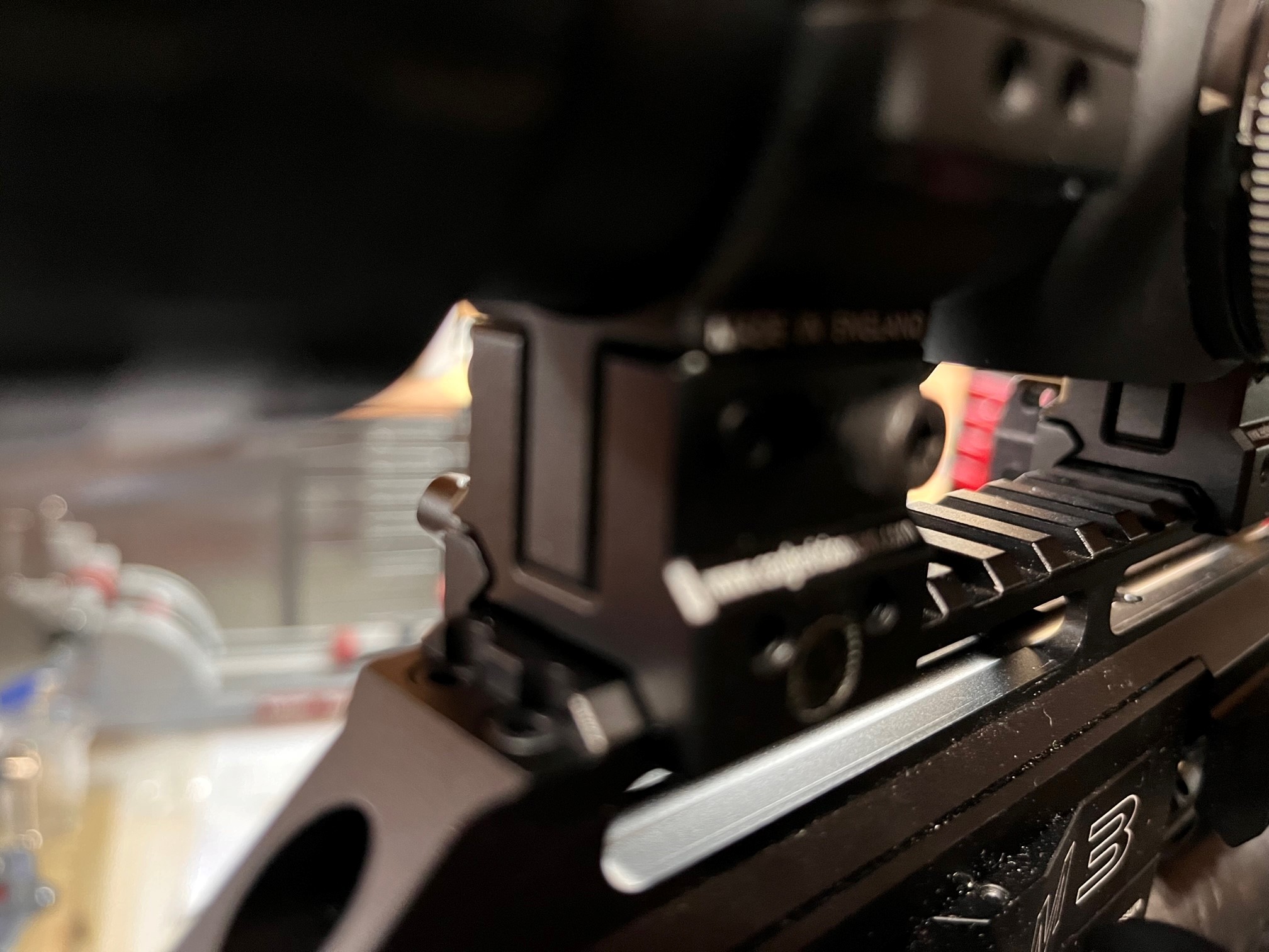

@Drumie is the rail with the wedge an FX part or other maker?

Here is mine. I am getting great results out to 600 yards with this set up.
View attachment 8164792View attachment 8164807
Looks like your forend has been drilled/tapped for multiple bridge locations, but I'm not seeing that feature in other Panthera pics. Is that something you did/had done? I'm looking to run one with a thermal clip-on; details on your bridge(s) setup please. ;)

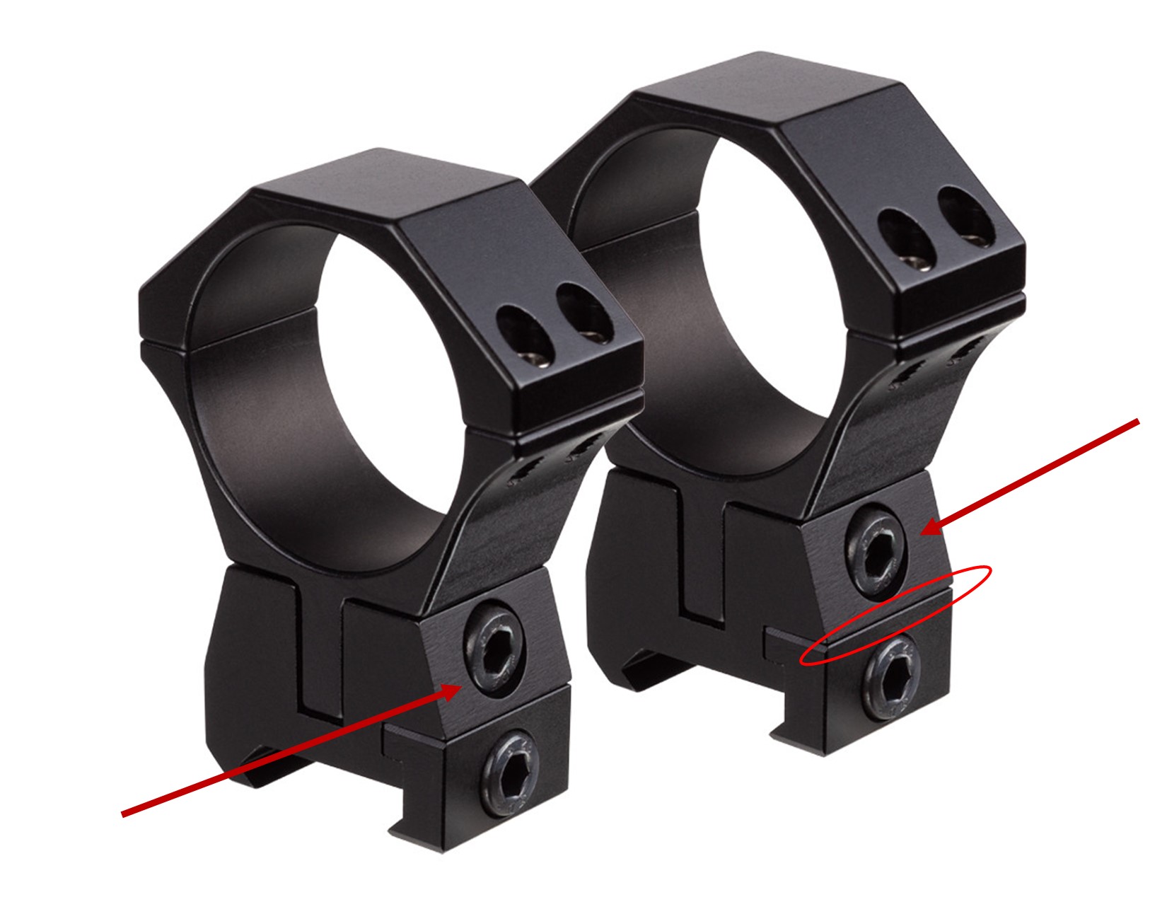

It's hard to describe in writing but the bases are clamped on with the allen screws. I torque them to about 45 inch-lbs. Those are the very bottom screws on the base as everyone knows. Sorry, I'm not trying to insult anyone's intelligence but like I said; it's difficult to describe in writing.
Look at the allen screws that the arrows are pointing to in the photo below. Those are the screws that, when tight, keep the rings from moving up and down. When loose, they allow you to adjust the elevation of the entire scope, instead of the reticle.
When you attach the base to the rifle, keep those screws loose enough to permit the mounting of the scope.
After you have tightened the base (bottom) screws, put the scope in the rings. Note this is my method and others may choose to do it differently. When placing the scope in the rings get a good idea of how far forward you want it mounted for proper eye relief but keep all of the screws loose to permit movement and prevent any binding on the scope tube.
At this point the only screws that should be tight are the base screws.
Before leveling the scope and tightening the ring halves. you will need to tighten the screws that the red arrows are pointing to. Don't worry about an elevation point for now. You will do that at the range. Make sure that they are bottomed out in the assembly. Then torque those screws to about 35 inch pounds.
Now you level the scope and tighten the ring halves down to the specs the scope manufacturer recommends. I use 15 inch pounds.

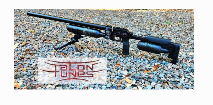

Here's a photo of my AirForce Talon SS, using the FX rings, before I put a Talon Tunes moderator on it and added the Thermal scope. I read a lot of complaints on the forums about the extra effort people go through the add picatinny mounts to the receiver of the AirForce airguns to get the proper height but nobody seems to take my recommendations for the No-Limit rings seriously.

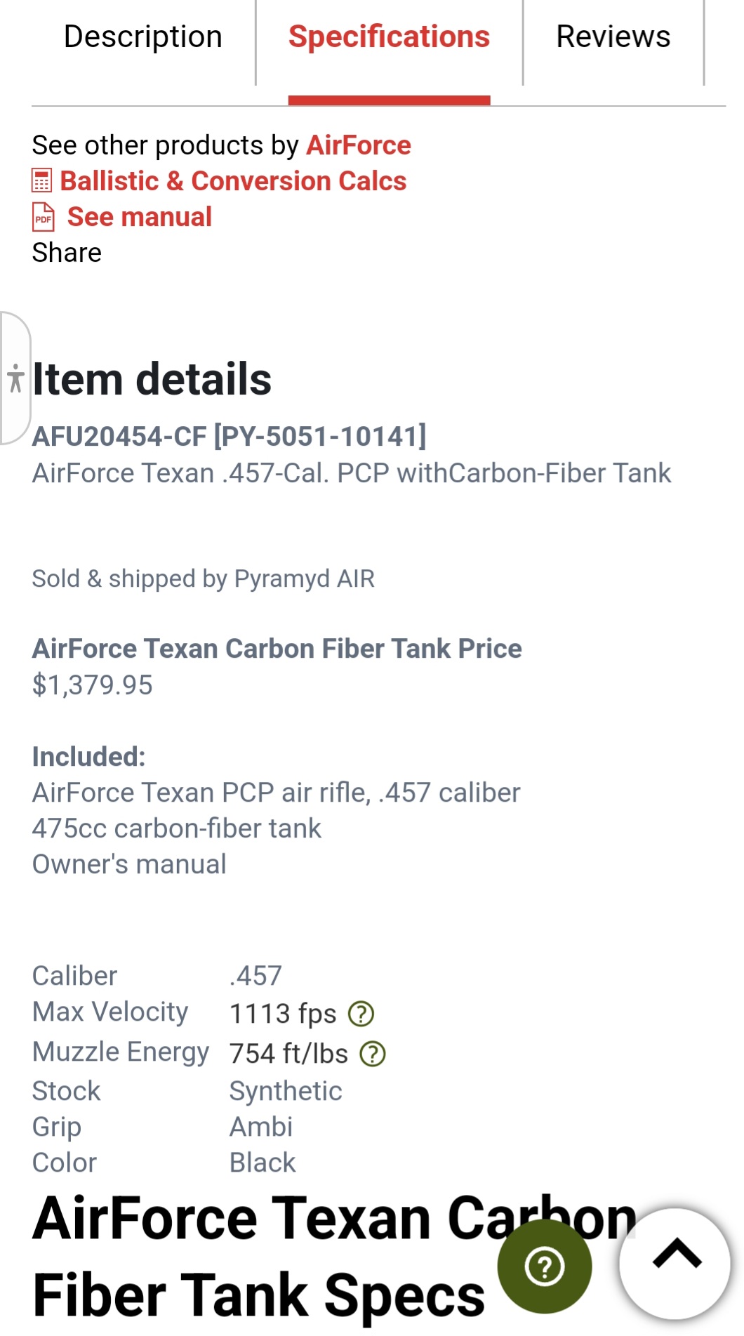

I am seriously considering selling 3 of my 6 pcp's to get that one. I hear the 35 cal does almost 1000 fps with over 800 fpe and is a tack driver at 100 yrds! Yep, that's all I want...until the next newest comes out!
@Mike Weldon 800 fpe? I can’t see it. Can you clarify what you mean?
Yeah, to get 800 fpe at 1000 fps...you need a 360 grain pellet / slug. They don't make 360 grainers in 35 cal. Even if they did, to get 800 fps you would need to blow so much air it would be a one or two shot wonder per bottle in the Panthera. I say it's a typo.
Reactions: Mike Weldon
I think the site I was looking at, which I can't find now, typo'd the fps instead of the fpe. They do make 300+ grain slugs for 357 though and well over 400 grain for 457, I have many boxes of them for my texans which will get those numbers, but I don't think that rifle will load them single shot. I'm going to attach the specs for one of my Texans for ya.

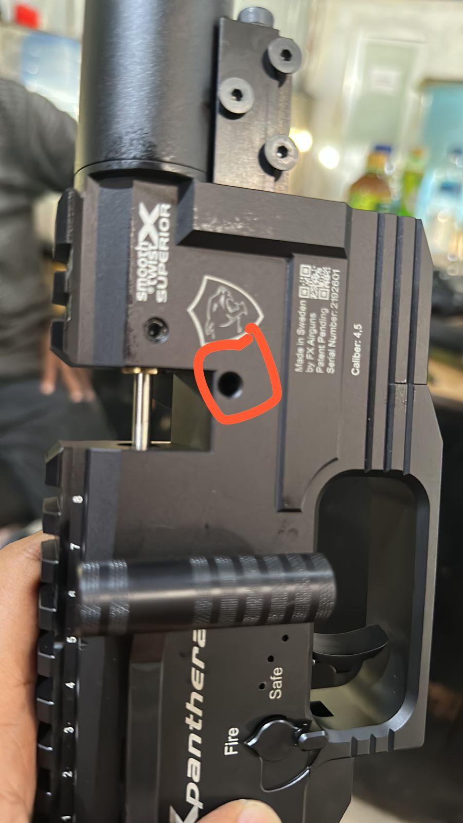

I want to ask what is the function of this hole why is there wind out ?
That is the venting hole for the hammer and valve. When the hammer is released towards the valve it will create a high pressure in front on it so during a shot you will feel so air coming out there. But if there is a continuous flow of air then you have a leak ;)

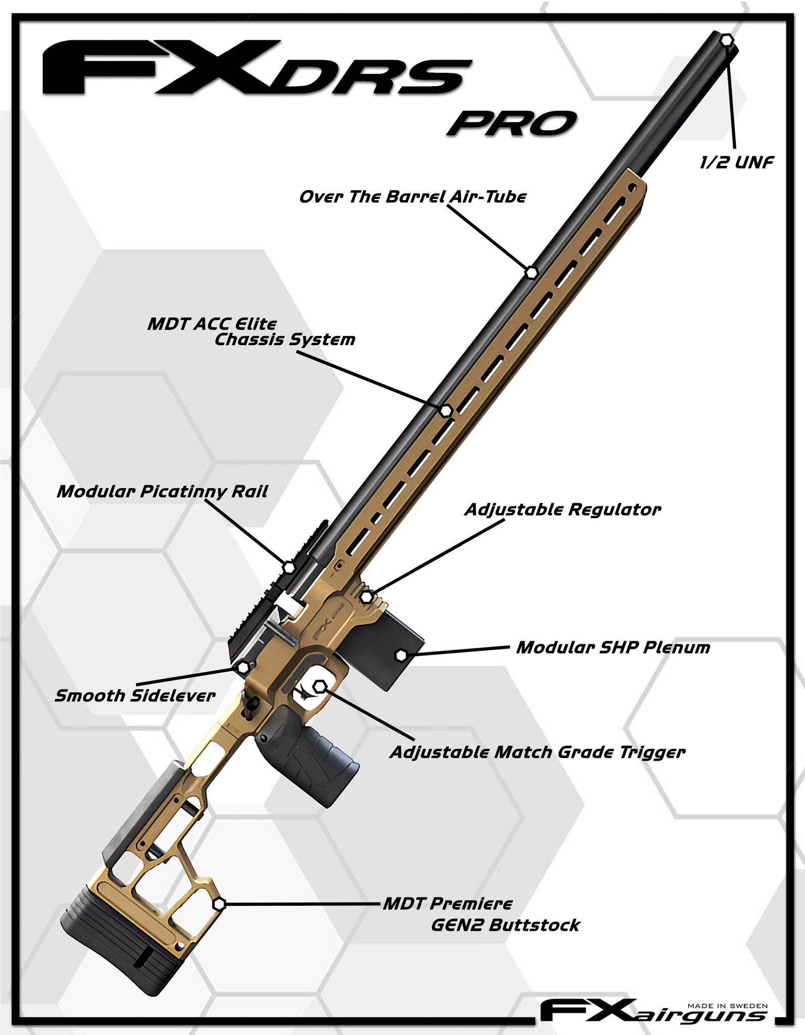

It is probably like the other FX offerings. The illustration, above, shows 1/2-UNF at the muzzle. So I would imagine that it would take a moderator.

Agree on the fact that they are higher than the typical rings. That's not a problem if you have a chassis with an adjustable cheekpiece.
I'm sort of low-tech with some air rifles. So the AirForce air rifles are notorious for not getting a good cheek weld to look through the scope because it's too low with a regular set of rings.
The only fix is to get the dovetail-to-picatinny rail adapters or the FX No-Limit rings. I don't know if Eagle Vision makes the rings for a dovetail rail.
Anyway, the FX rings are perfect for the AirForce platform.
As for the airforce bottle/cheek weld, there is an adaptor available that attaches where the bottle does, drops 45°, then horizontally to attach the bottle. You gain a couple inches lower for cheek weld. I forget the manufacturer but Piramyd Air sells them.
I saw that. TalonTunes sells the adapter. However, I think the simpler approach would be to use the FX No-Limit rings. The height is perfect with those rings.
Yes I'm sure the no limit rings are the way to go. I am good with just tall rings but will probably get no limit sooner or later. I've already emptied my savings multiple times with my rifles and supported equipment! I need to have a garage sale with all of the "almost" what I really wanted or needed stuff sitting in my gun room.
