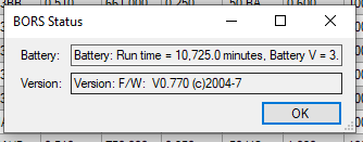

Also, Bullz-aye, I tried manually changing the COM port parameters in device management like you mentioned and they didn't reset when starting BBS, even running in admin mode. However, I got the same V .... V F/W:0.770 (C) 2004-07 reply seemingly regardless of the settings. Seemingly no change with BBS 2.0.0.27 (Dated 4/24/2014) versus 2.1.0.3 which checks out with what you're saying about the "V2.0.0.26 is said to require F/W V1.5.0."

Well that was the trick. Thanks for the note on installing the packages separately, the main installer shows a nice "This setup cannot run on the current OS." I ended up only installing the BBS 1.0 package on a windows 10 machine. I tried the FTDI installer and the dotnet 2.0 but they both gave weird errors. This however ended up being inconsequential.
Plugged it in and it worked straightaway. Was able to create a new cartridge and successfully uploaded it to the BORS. Of course the 1.0 software is missing some nice to haves from the 2.0+ versions; the option for G1 vs G7 and the entire 'Advanced' and 'Range Card' tabs being the most noticeable, besides slight UI tweaks.

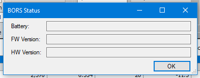

Of course the communication error using my BORS with the 2.0+ software makes sense as the upgraded software is looking for different data fields than the early firmware is responding to. (left image from the 1.0 software, right from 2.1 with no communication)
Thanks y'all for the help with all this, especially for the ancient copy of BBS 1.0. I'm looking forward to getting out to the range with some custom cartridges loaded and put this old brick to work.

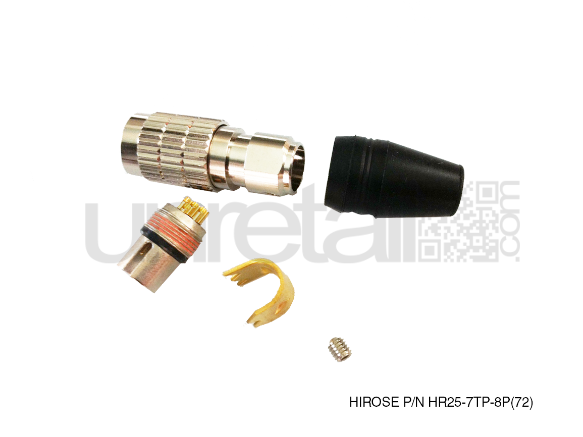

That part is for a panel mount application. What's needed is a cable mount solution that has both a backshell and a cable gland. See the attached image. The gland helps to keep dirt and moisture out. Save yourself the Sales Tax when buying this Genuine Hirose Connector from the same guys that sell the BORS® Data Link Cable at unretail.com
