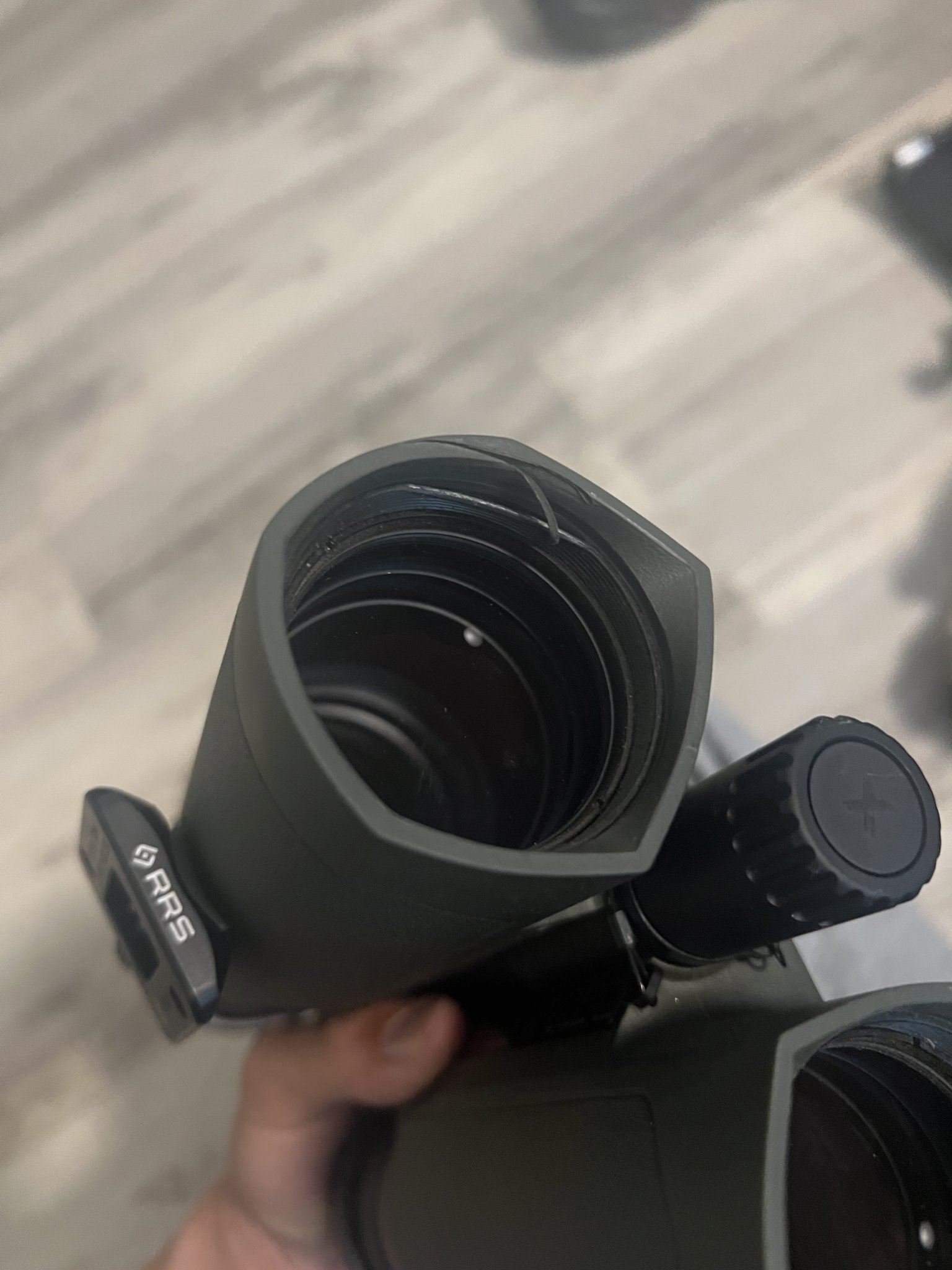

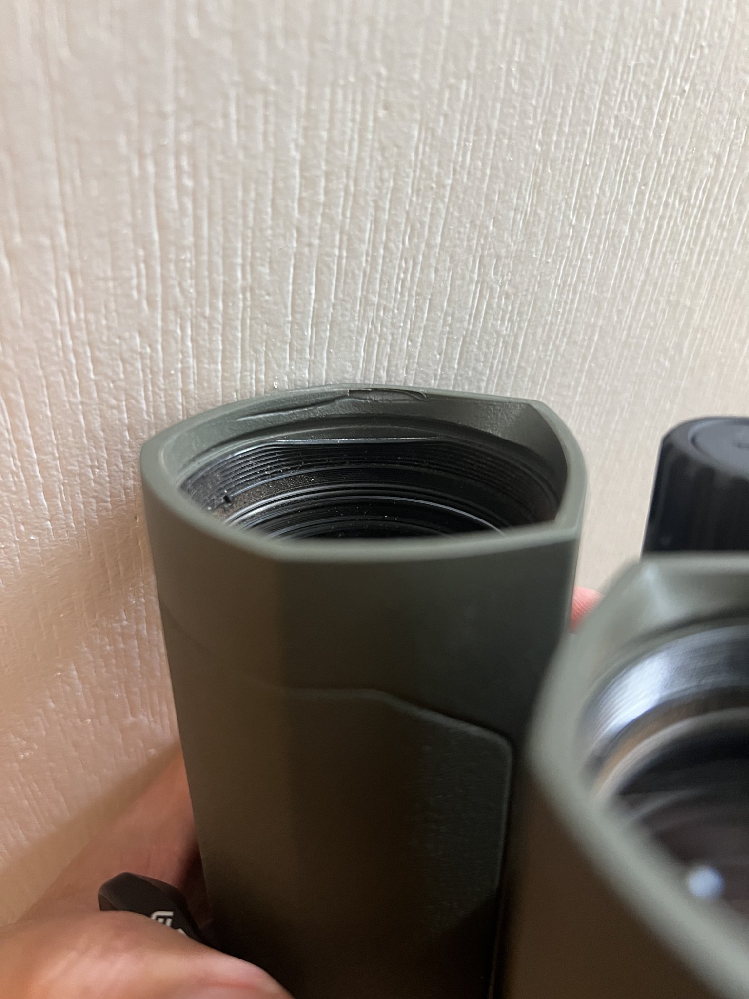

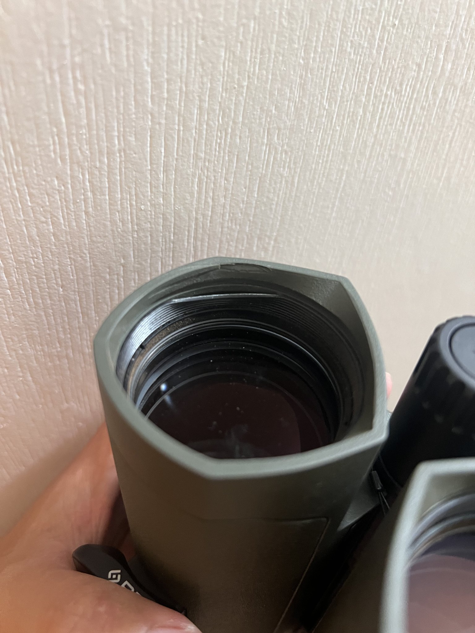

Happened at a match. Really bummed about it since i was planning on using the range extenders
  • Sad
Reactions: Ichi and 96C
